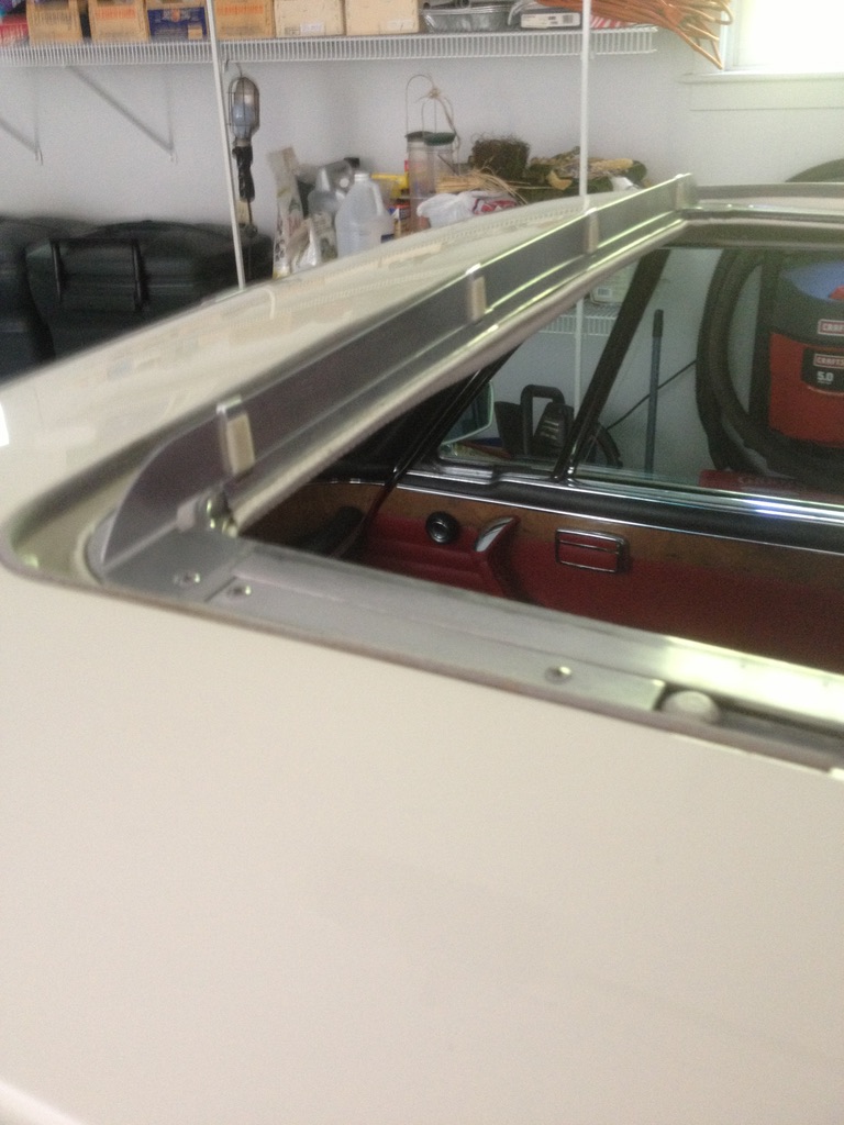

To my knowledge there is no trim or seal that runs along the sides under the suroof. The headliner is glued to the roof under the the rails.
