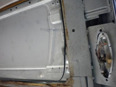

Here is a side view. I'll take a picture with the sunroof removed once I get it back from the garage.

execmalibu
629
2
There are about 25 rare small parts along with numerous special screws that you need!
If you are missing all of those parts you are in deep KaKa! Those parts are very rare and are unique to the E9.. The parts ALL need to be correct and installed or the roof will jamb...
The best bet is to find a rusty car with a sunroof and take everything... I repeat everything! Especially the tiny little special screws,washers, clips, cables and plastic slides... This stuff in all unique to sunroofs
If you are missing one tiny piece you will be SOL the first time you try to work the Sunroof...

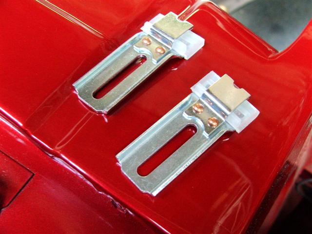

Sunroof Clips
Thanks Dave, it looks like the volvo cables will do the trick and then I only need the gaskets and clear plastic slides. Does anyone know if these are still available from La Jolla?

DaveG
173
0
Interesting... I don't think my e9 sunroof uses anything that looks like that....Or maybe my memory is just bad.....It does have a plate that is that shape but it doesn't have a plastic piece attached....I'll be re-assembling mine in a few weeks. I'll look in the box of parts this weekend....

adawil2002
5,187
3,050
Brunswick, Maine
DaveG
Those pieces are the front rail glides that screw into the knurled front height adjustment nuts.

Rail Guides
Yes, this picture came from the 2002 site with excellent details about how to reinstall the roof. I'm headed over to a junk yard to see what parts I can find from a mid 80's volvo and wasn't sure whether these bits would translate.
