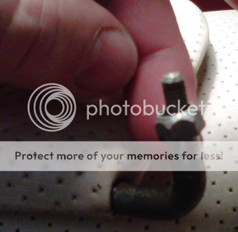

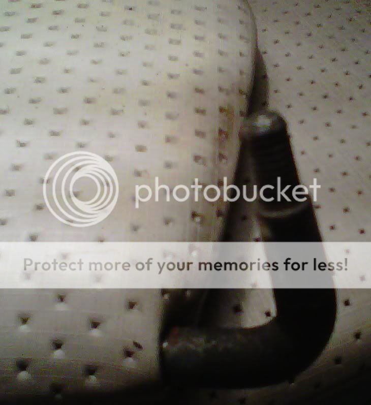

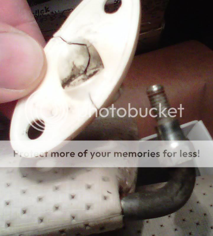

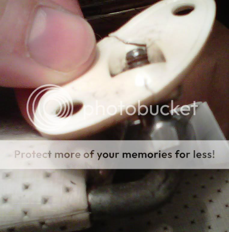

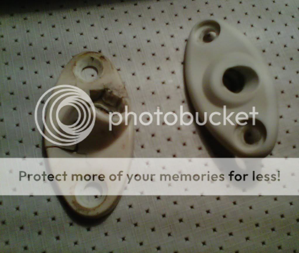

i dissasembled the old sunvisor to understand the mechanism, and i found this:
the pivot, of the fixed side, this is the one that is usually sticked to the strange nut you will see next
together with the nut (it is not exactly a nut, because it has not a thread inside):
now the old broken plastic support
and the spring plus the retainer
finally you can see the replacement, a newer plastic support in which the nut has dissappeared, and the function is done by the friction between plastic and pivot exerted by the spring:
hope it helps understand the problem

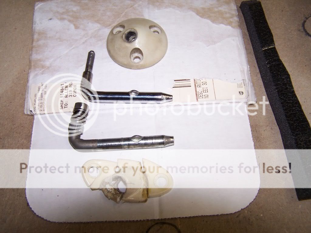

Update...pulled the visor from the car, had a visor from a P1800 in the stash, so disassembled this first as it seemed to be kind of the same, other than the fact that the mount is way more stout than the bimmer plastic bit. The pivot rod is virtually identical to the BMW. I will reassemble using a proper stainless nut vs the cheesy spring steel crap-ola
nut(?) that is OEM once I find a new or used pivot mount (possible e3 -2002 bit as well?)
The visor
Just for giggles,
Here is the mount used on the P1800 as well as the pivot rod (s) for both the E9 and Volvo.
The coupe bit required destructive disassembly, no worries as it seems it was broken and epoxy'ed before (as the spouse was quick to observe) Hmmm...I drive the coupe for fun, when the "gotta be there at 1600 hrs" I trust in my old benz. Stout. For the spouse, the Volvo is the dog hauler of choice.
Hate it when I see bits from cars of the same year, more or less, and obvious of the same supplier origin...well...sometimes a lot to be desired from the BMW engineers in as far as being "stout"
Maybe saving weight to use a two point vs three point mounting fixture?
