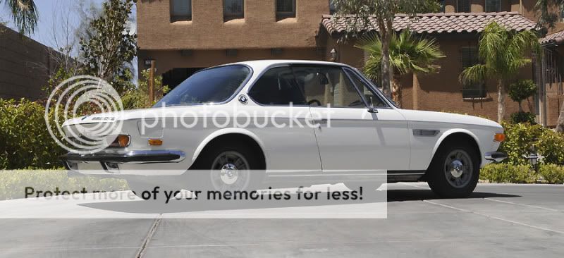

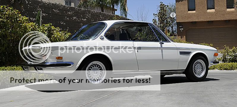

Here is my new baby after I gave it a really good wash, polish, and waxing.

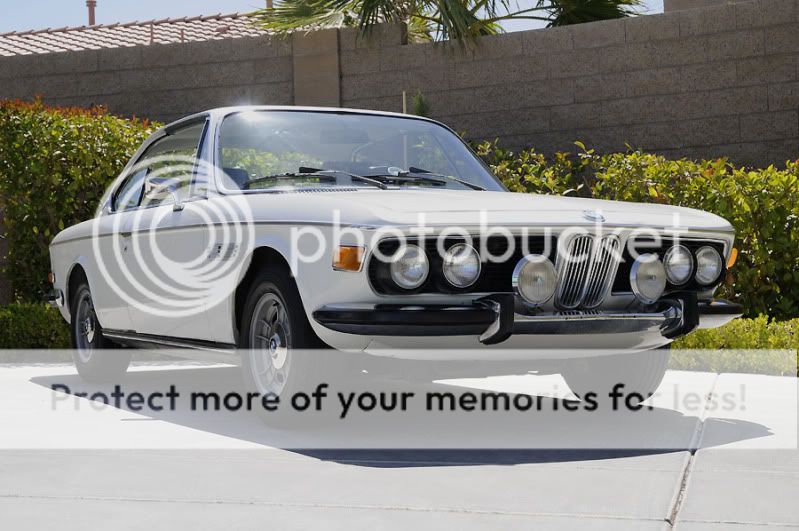

Still has the original Hella rally lights and they still work fine.

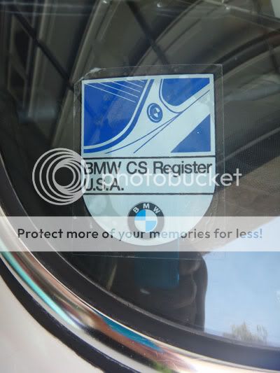

Checking with BMW, I found out that the engine vin-2263920 in my car is from an Italian delivered 3.0CSI built on December 11, 1972. There is a sticker on my rear window from the very old CS Register, and was wondering if anymore knows more info on my vehicle from the old CS Register.

I checked both VIN's for a reference in the old register and nothing came up unfortunately
