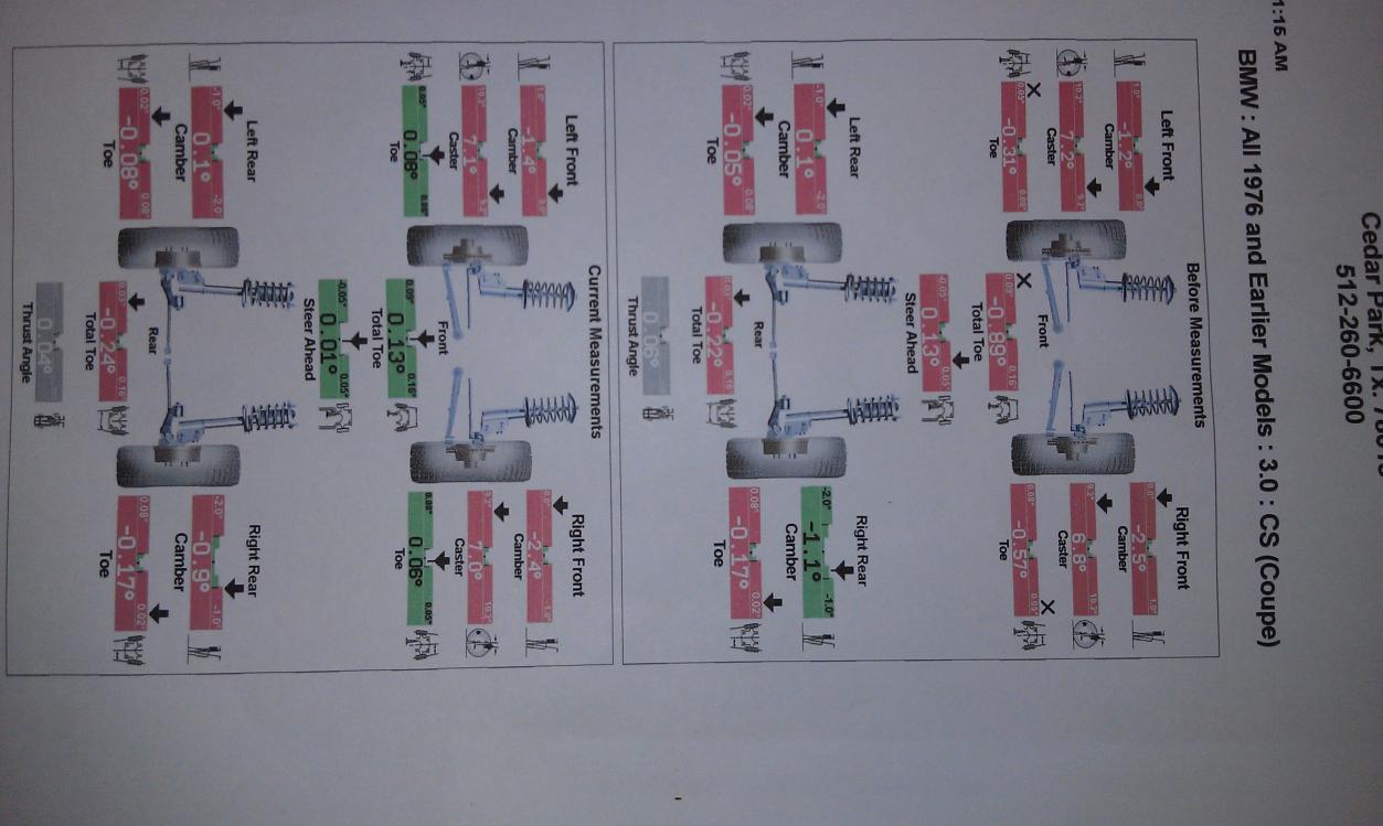

I took the old gal (with new cloths) to a pretty swank shop where they do lots of exotics. The car was very well received and I had the alignment done. I now have that "push-back" feel from the wheel that I was looking for though the test drive was only about 6 miles back to work and the road was very straight.
This is what I have done to the suspension, besides replacing every single bit of rubber under the car (even those little pieces that go around the fuel lines) and the parts I have used and the alignment results. Both as reference and for comment. After looking at the alignment results some may say the car was rolled... more than once, but I'll leave that up to you all.
So,
All new bushings, new control arms and all new steering components less the P/S box, brakes, rotors, calipers, and wheel bearings. Wheels and tires new- 16X8 with 205/45/16 on all corners. New front sub-frame, new Bilstein inserts in front and HD's in the rear, Carl's springs (2011)-all corners, neg. camber plates from CN, CN strut brace, ST Suspension front and rear sway bars- hope I did not forget anything.
The results from the alignment are below.
You got to lower the rear to get some decent camber! At least -2 deg and don't forget to squeeze the toe-in to get "in" and not out, otherwise it will give quite poor handling, like snappy over steer and no grip when cornering.
Cheers
Anders
Thanks Anders, with the results in my last post what would you recommend I set the toe-in at? The alignment helped allot but I took her for a more challenging run yesterday afternoon and the best way I could describe the ride was "not confidence inspiring" in that when I took a corner-left or right-the car felt like it wanted to keep turning and did not provide enough movement back to center. As a result I had to steer the car into the corner and steer her back to center. Would you consider this classic over-steer? and would the slightly wider and taller tires necessitate the increased toe-in?
