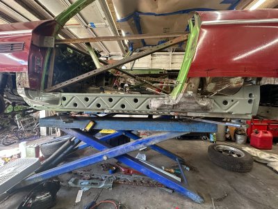

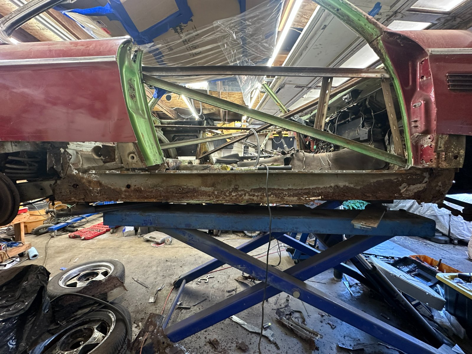

sympathetic restoration on a 73 CSi

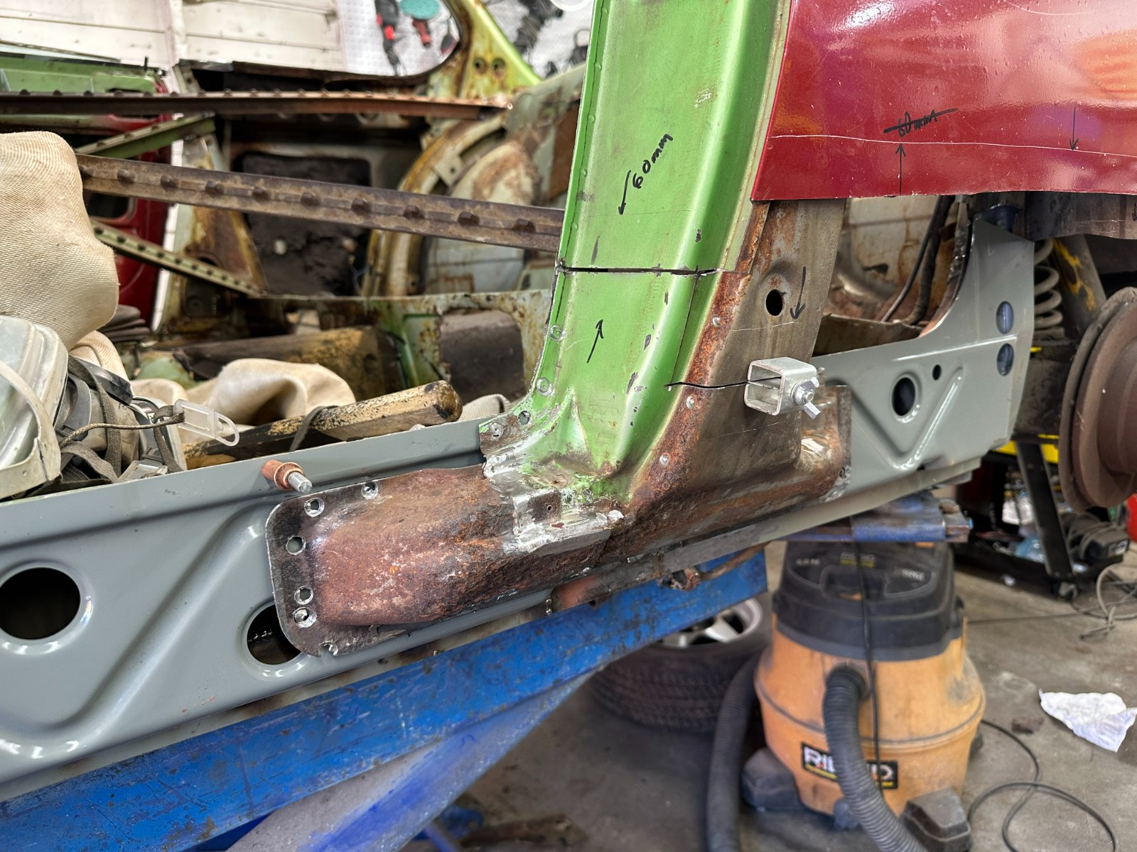

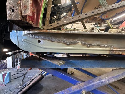

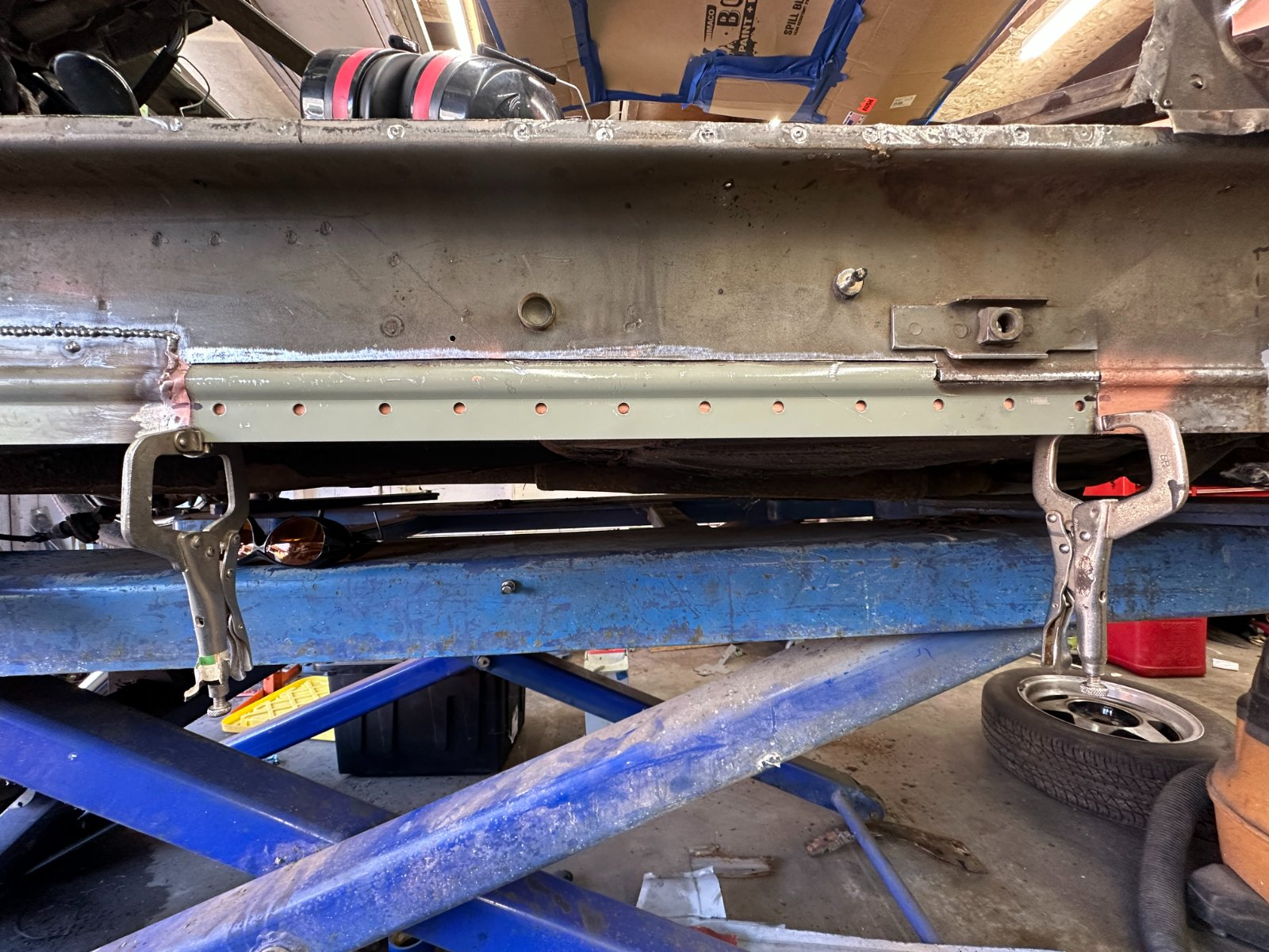

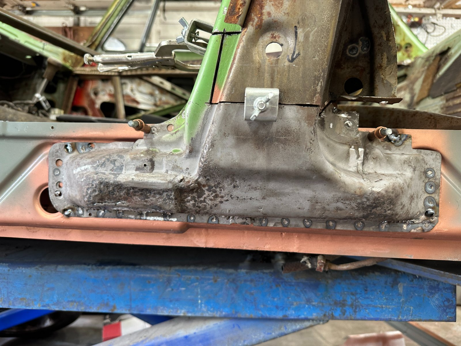

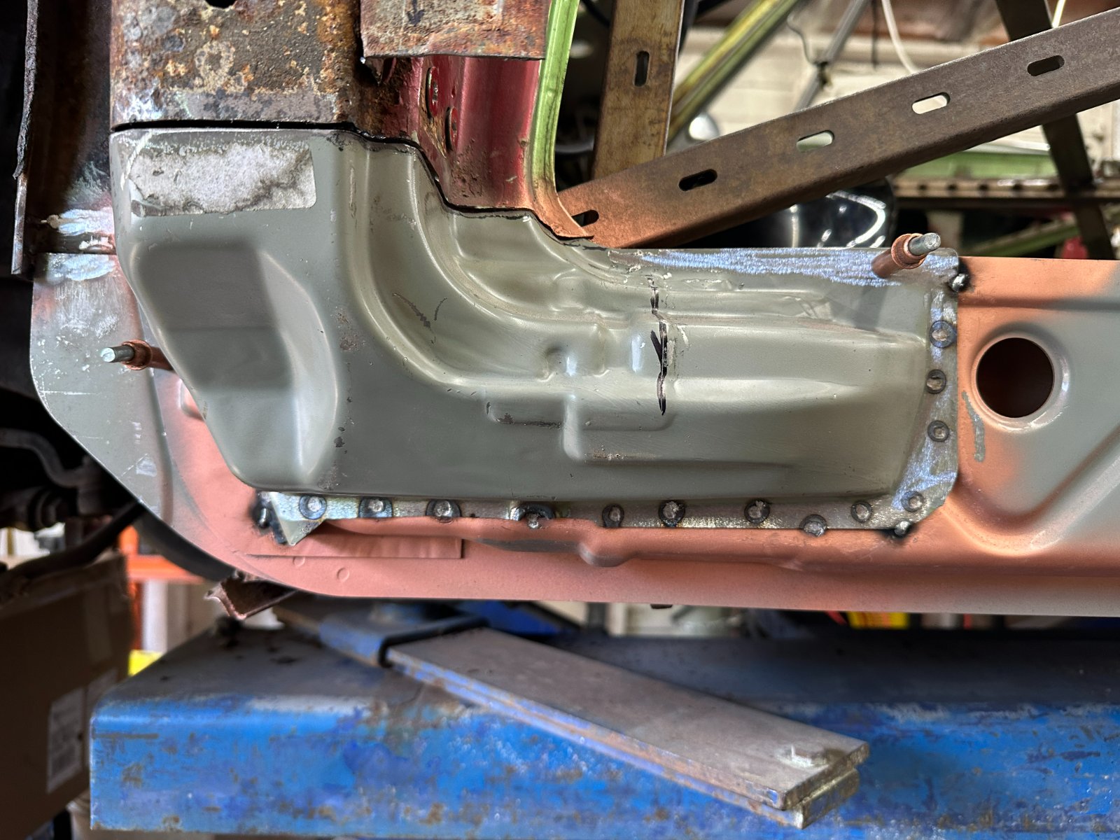

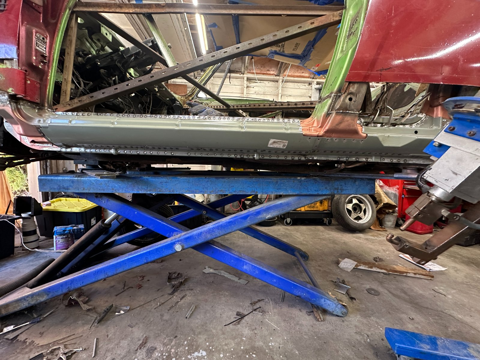

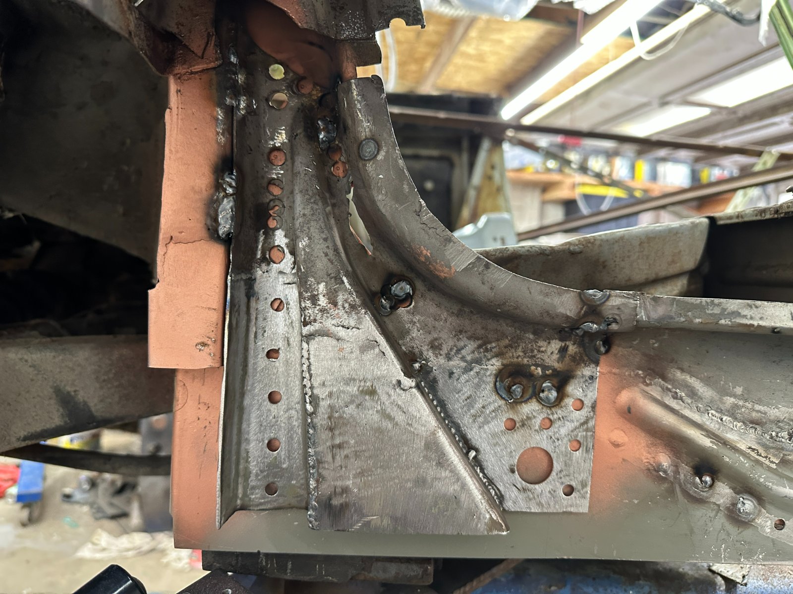

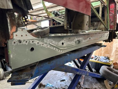

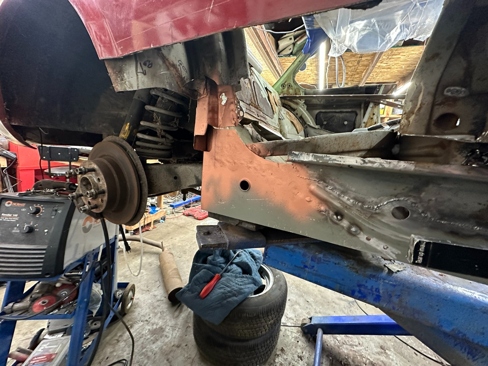

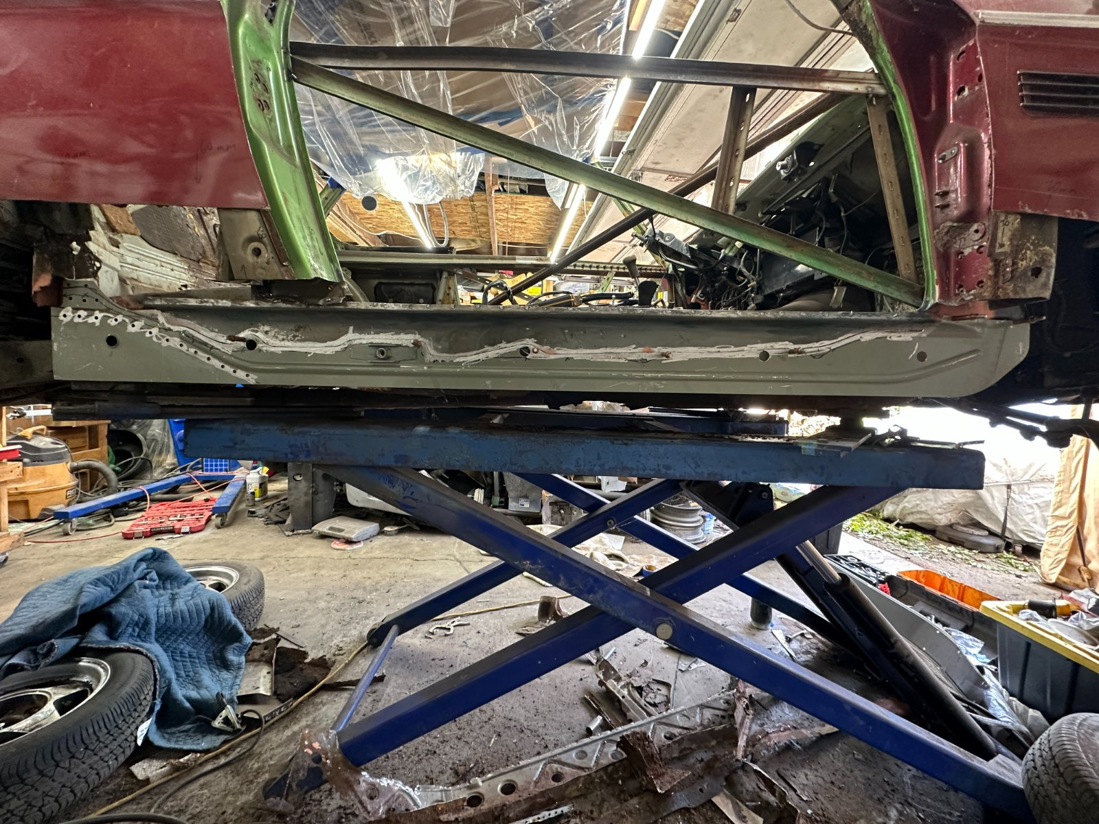

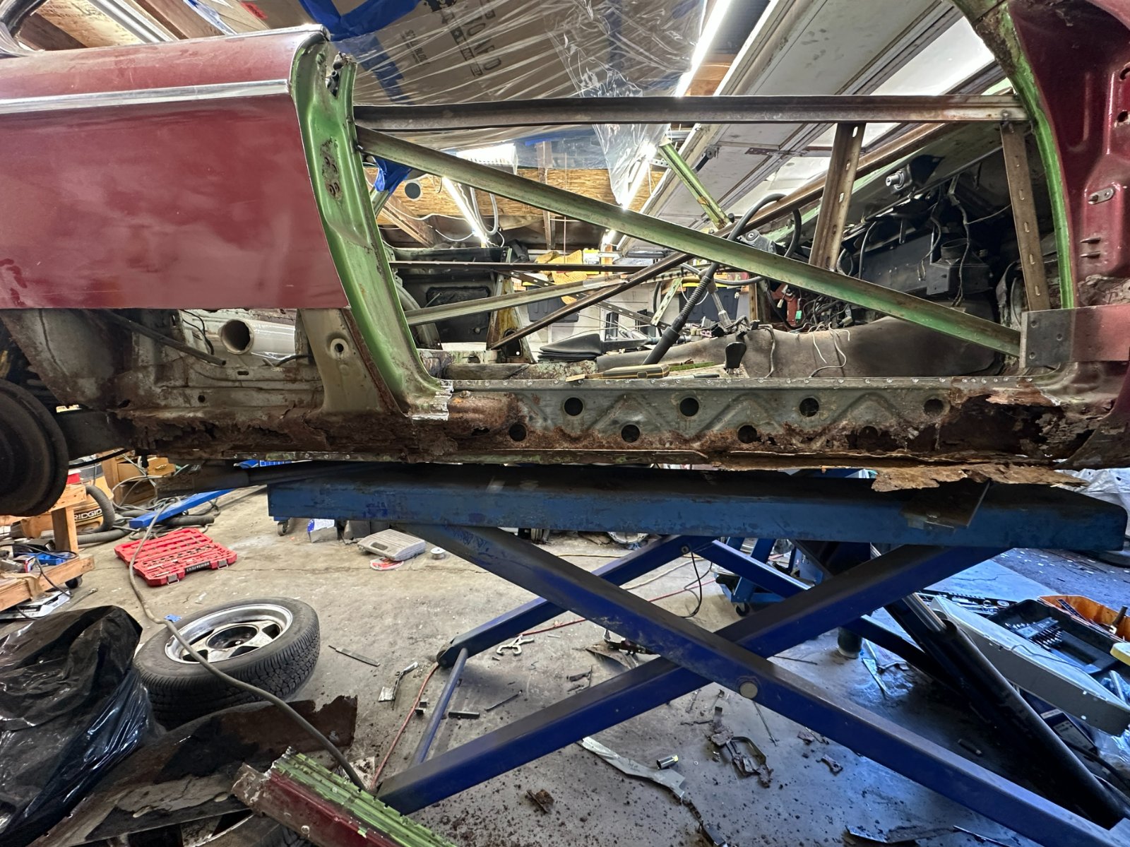

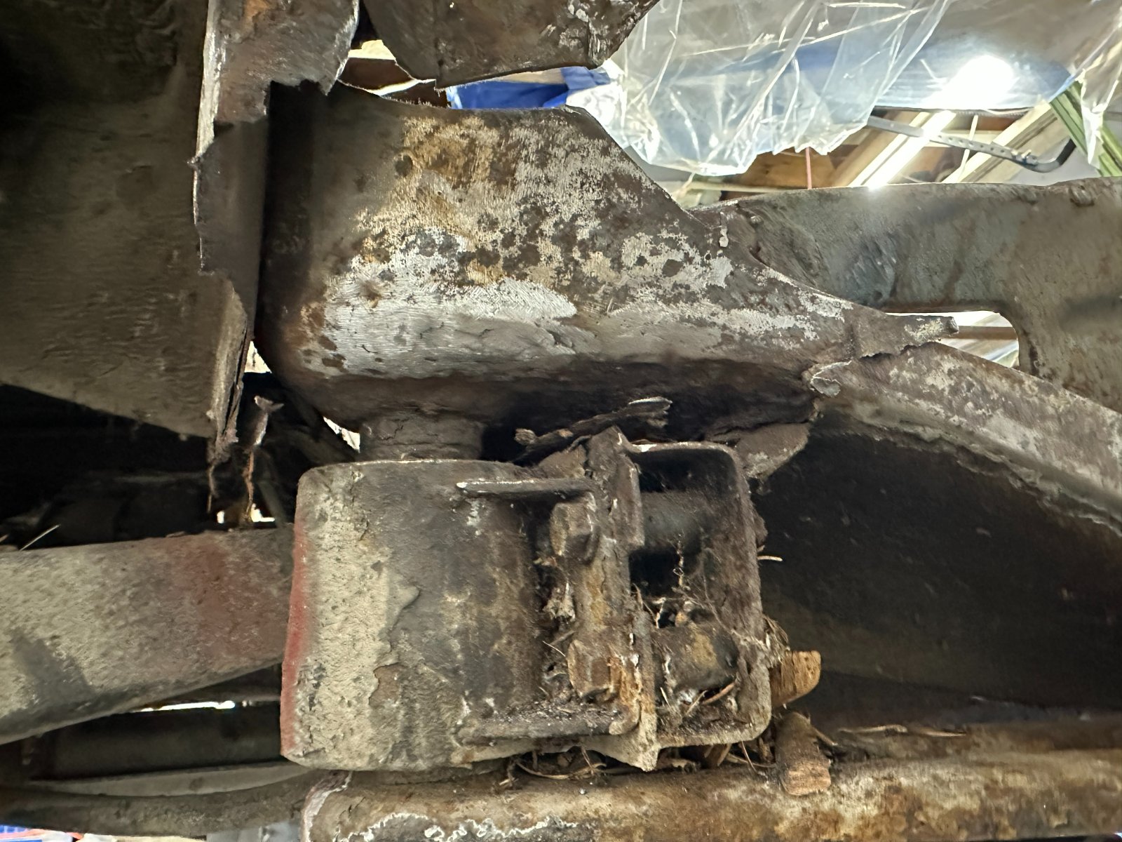

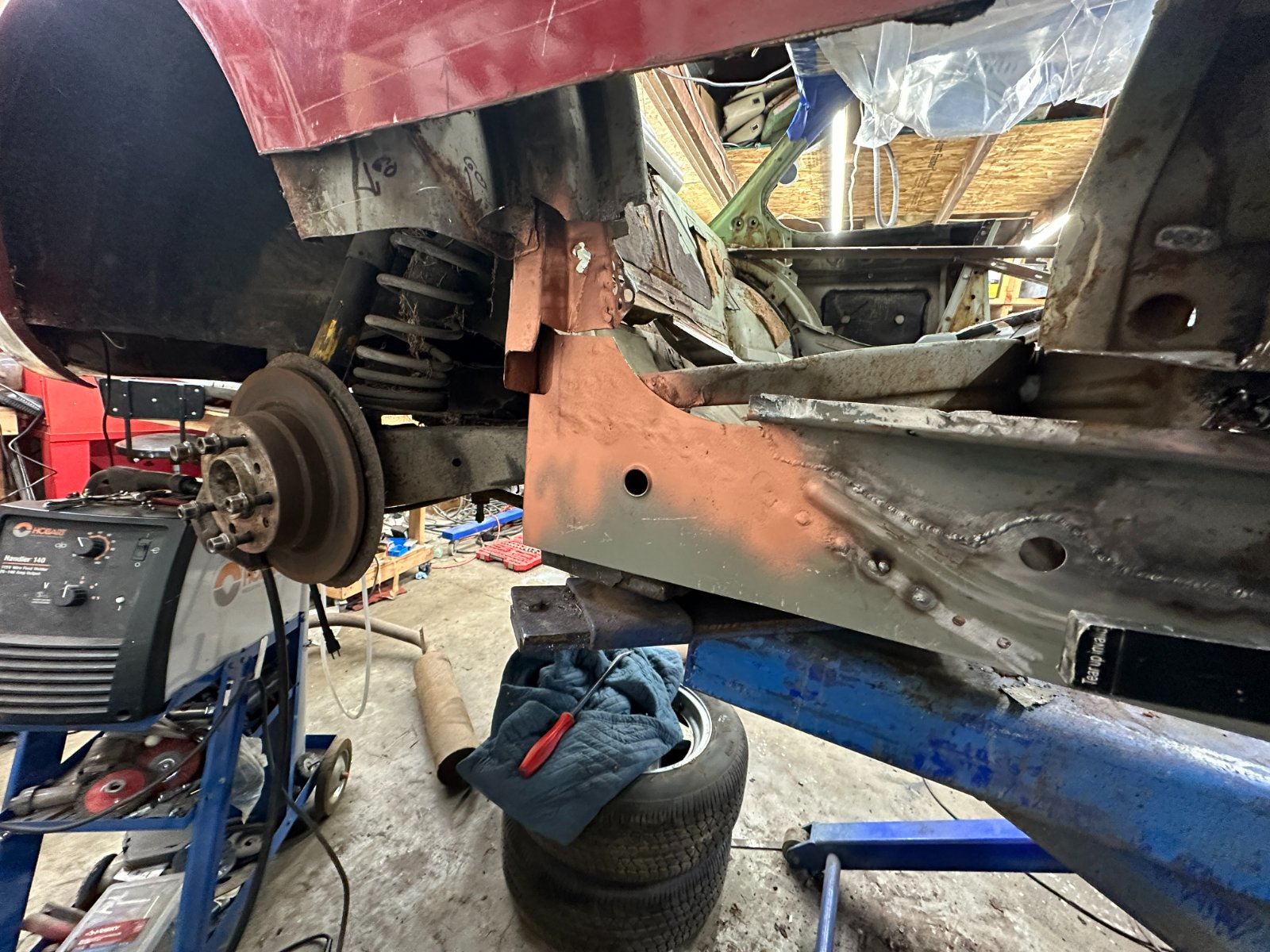

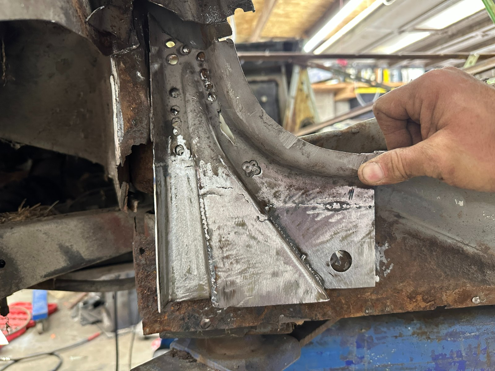

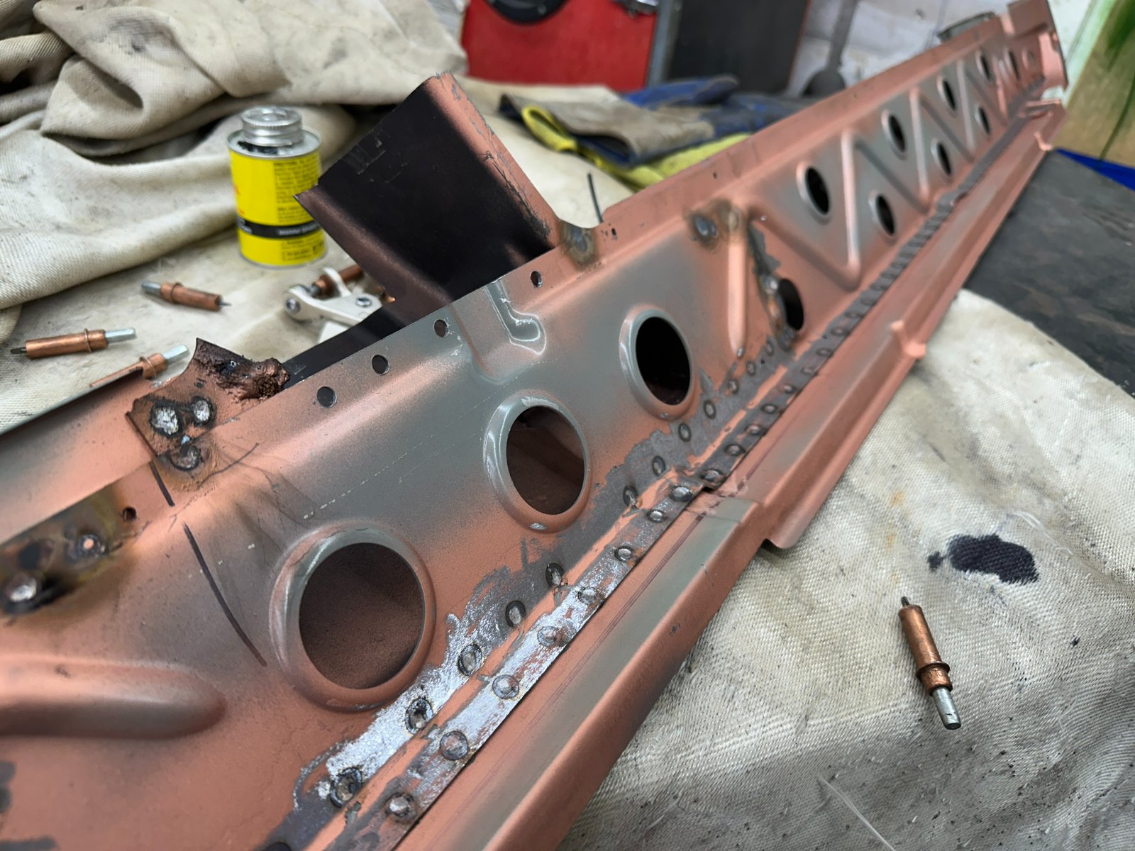

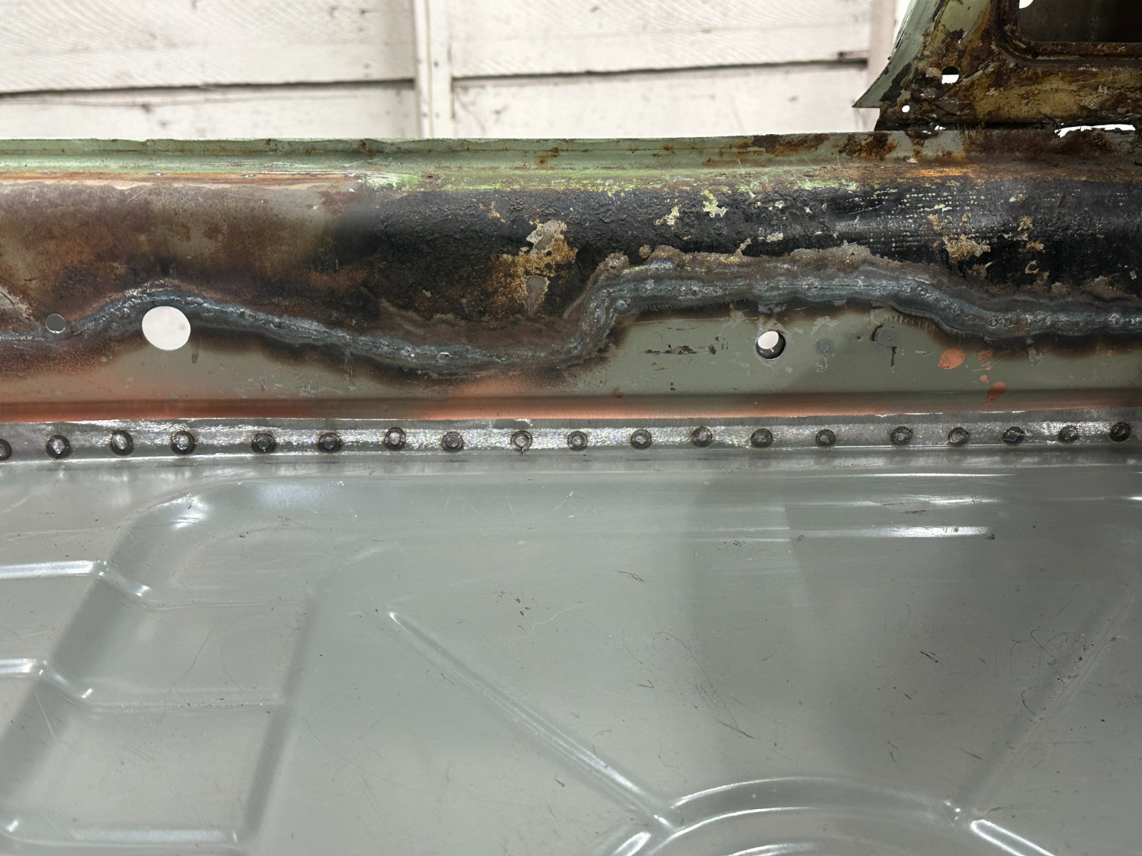

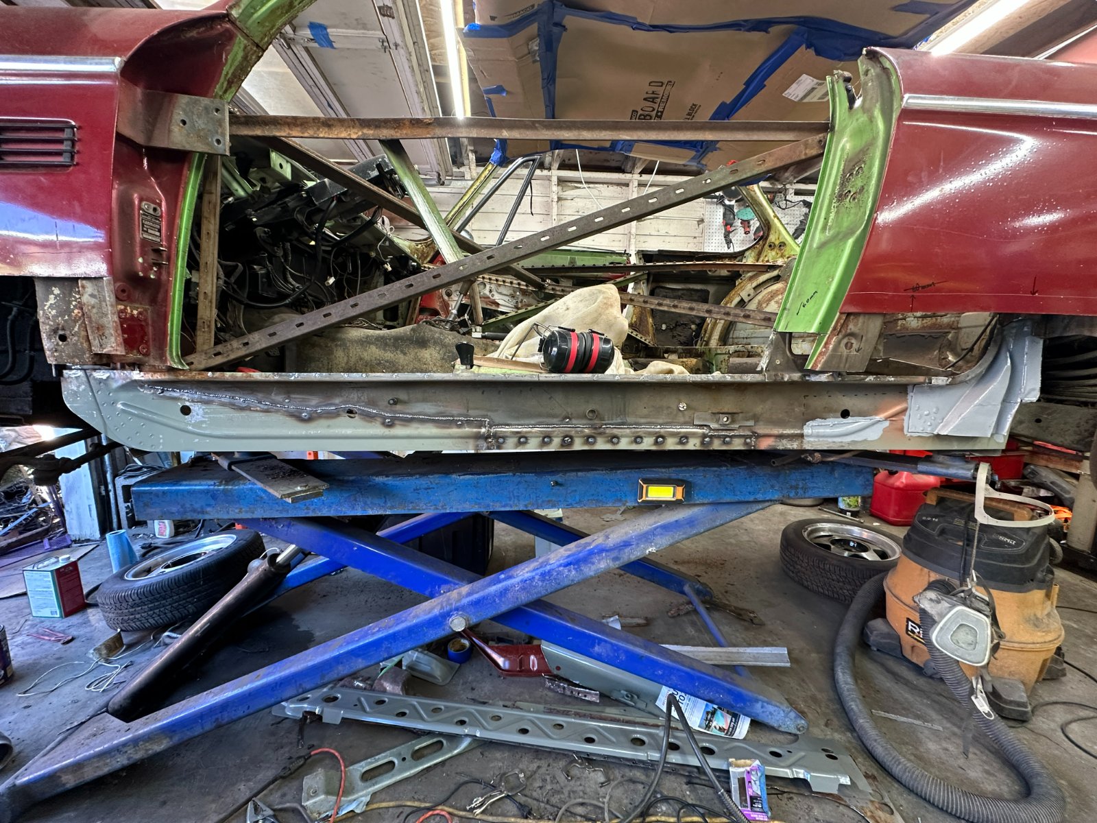

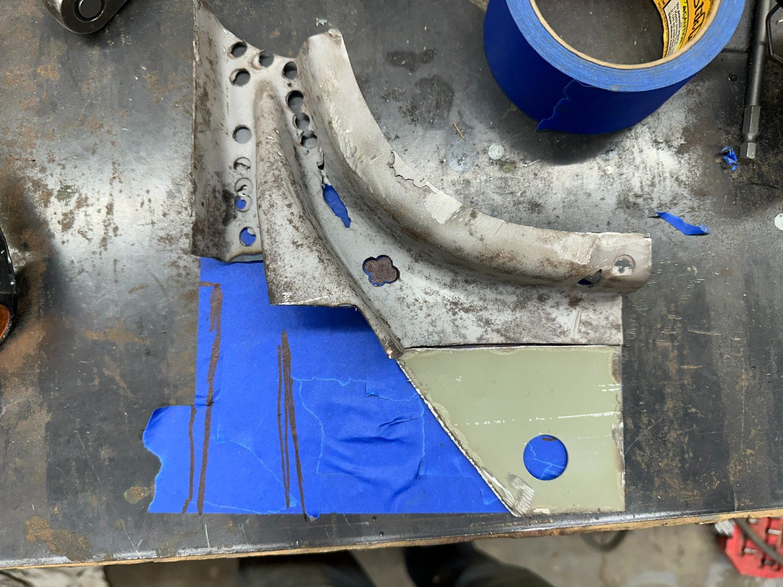

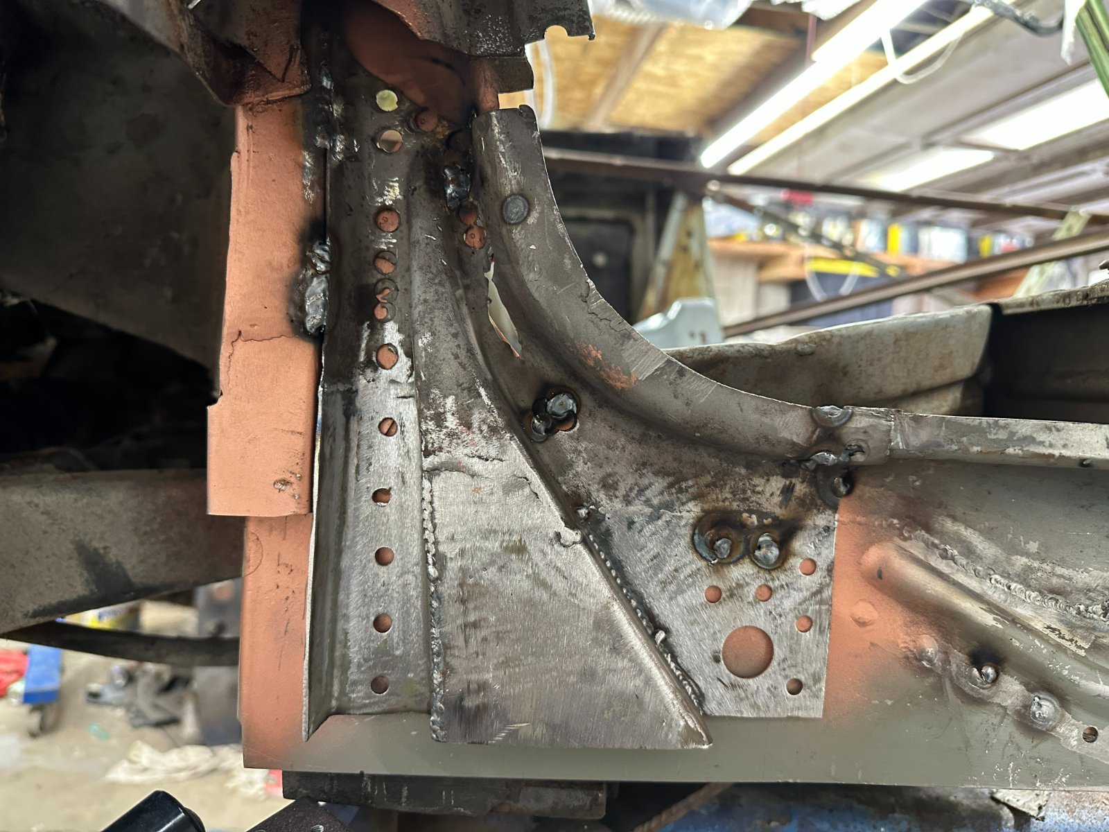

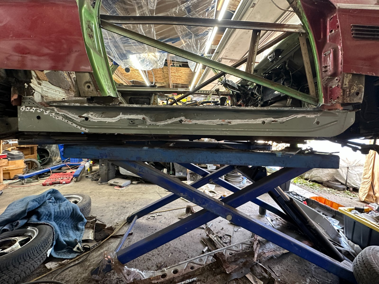

All done patching up the driver's side inner rocker. This went smoothly and I'm glad I went ahead and bought the full inner rockers from WN rather than trying to fabricate patches as I'd initially considered. I kind of hate cutting up expensive new parts but I'm sure this saved an order of magnitude of time, and it was really nice to see the front section fall into place as there was a real mess there before (shoddy old repairs combined with not just rust, but some collapsing due to ill-advised jacking).

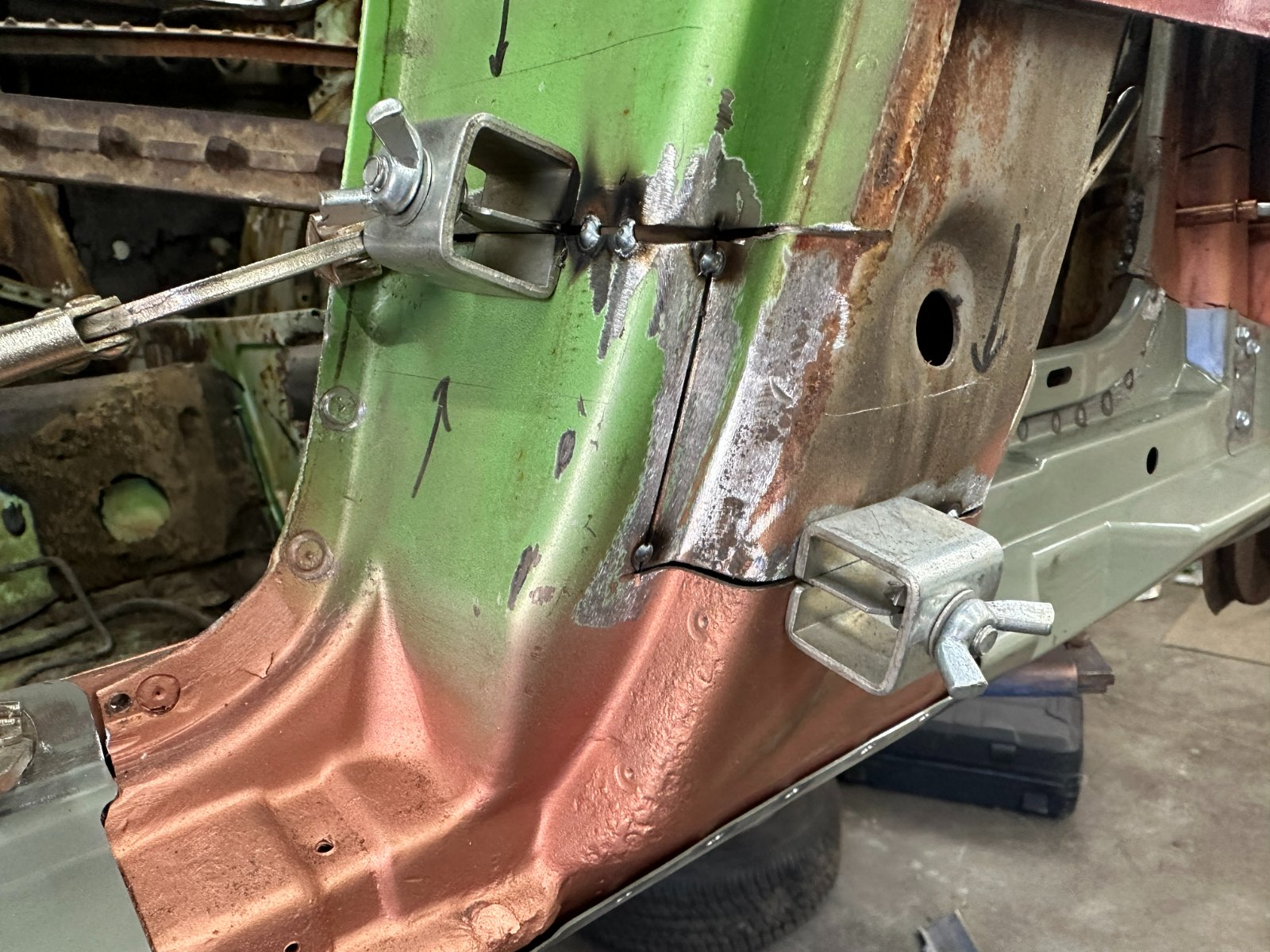

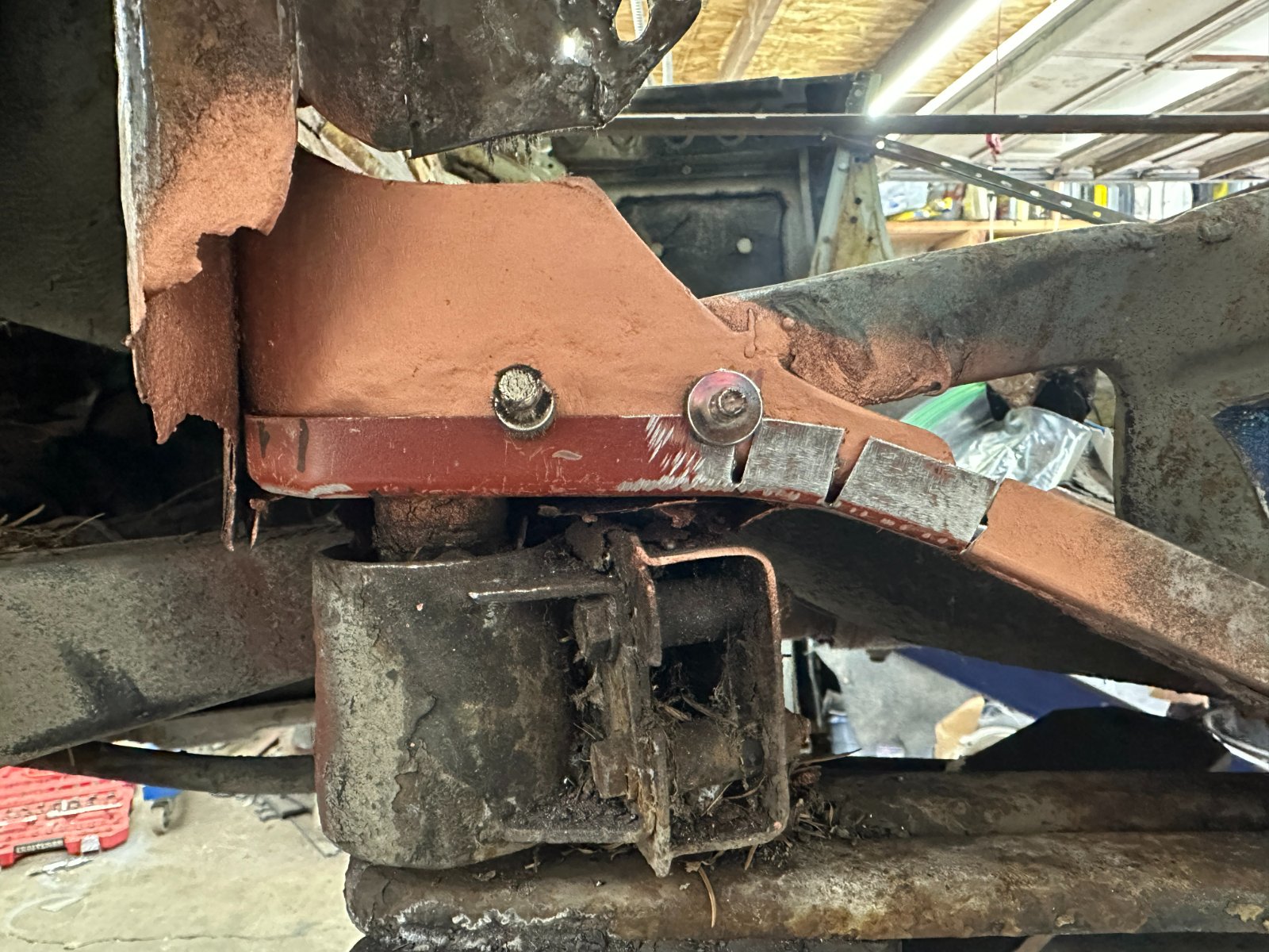

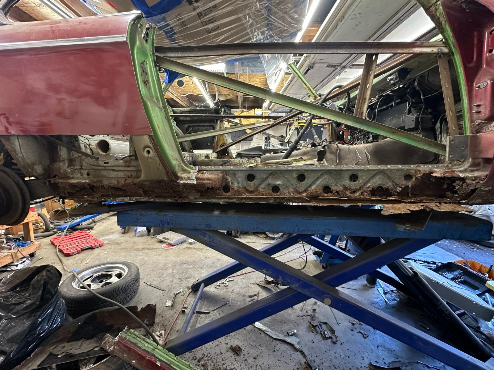

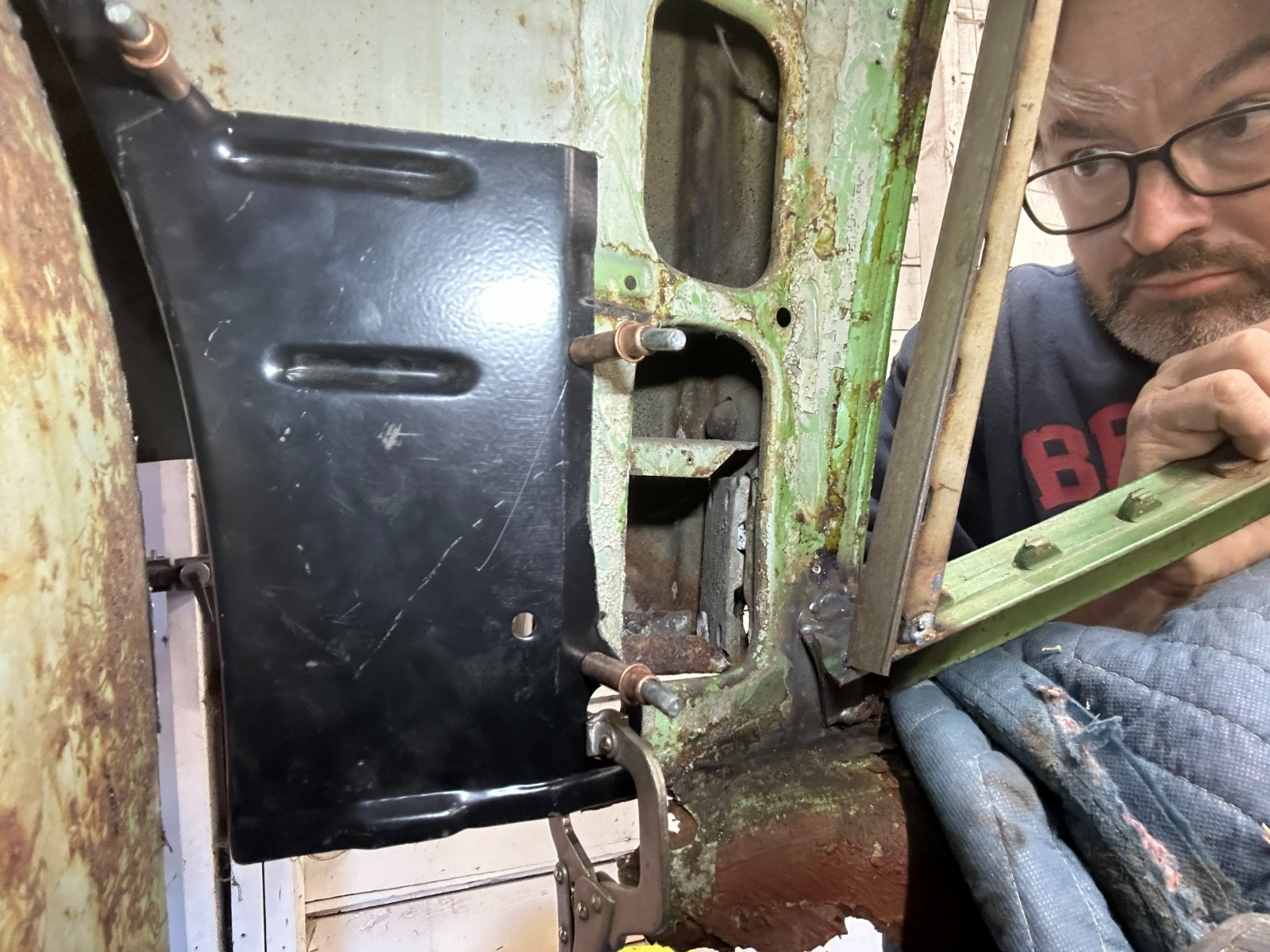

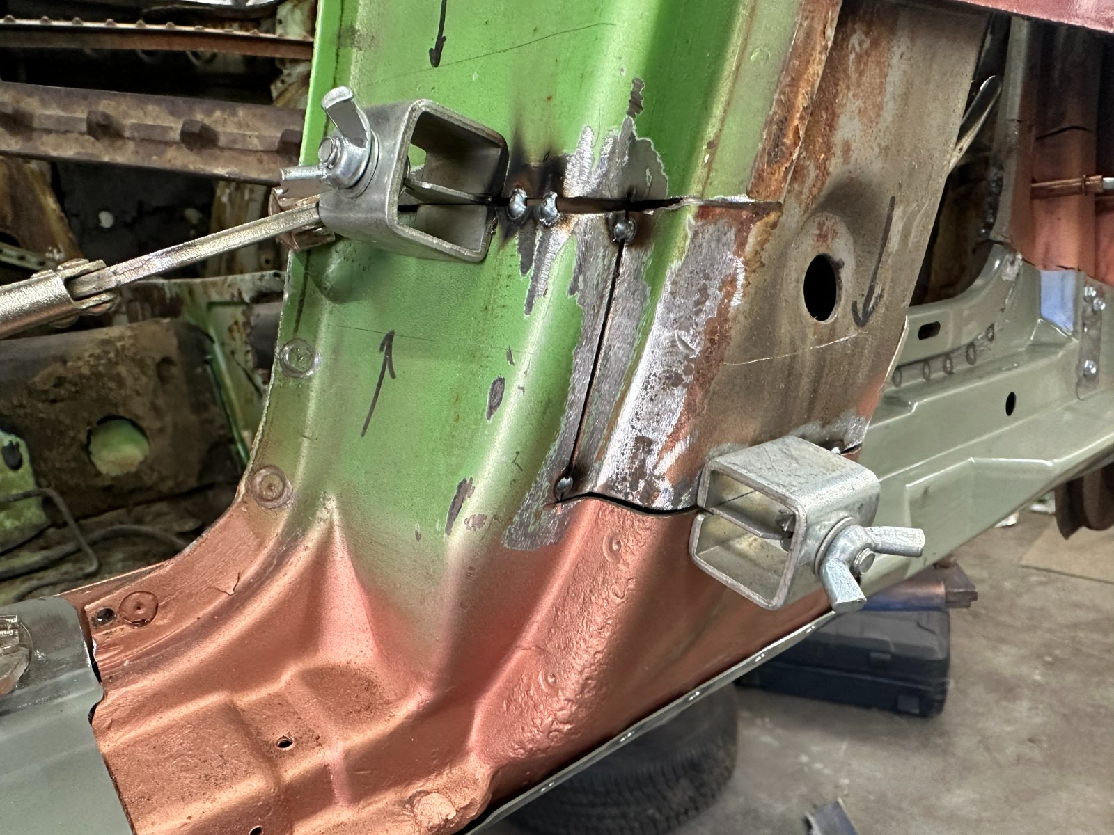

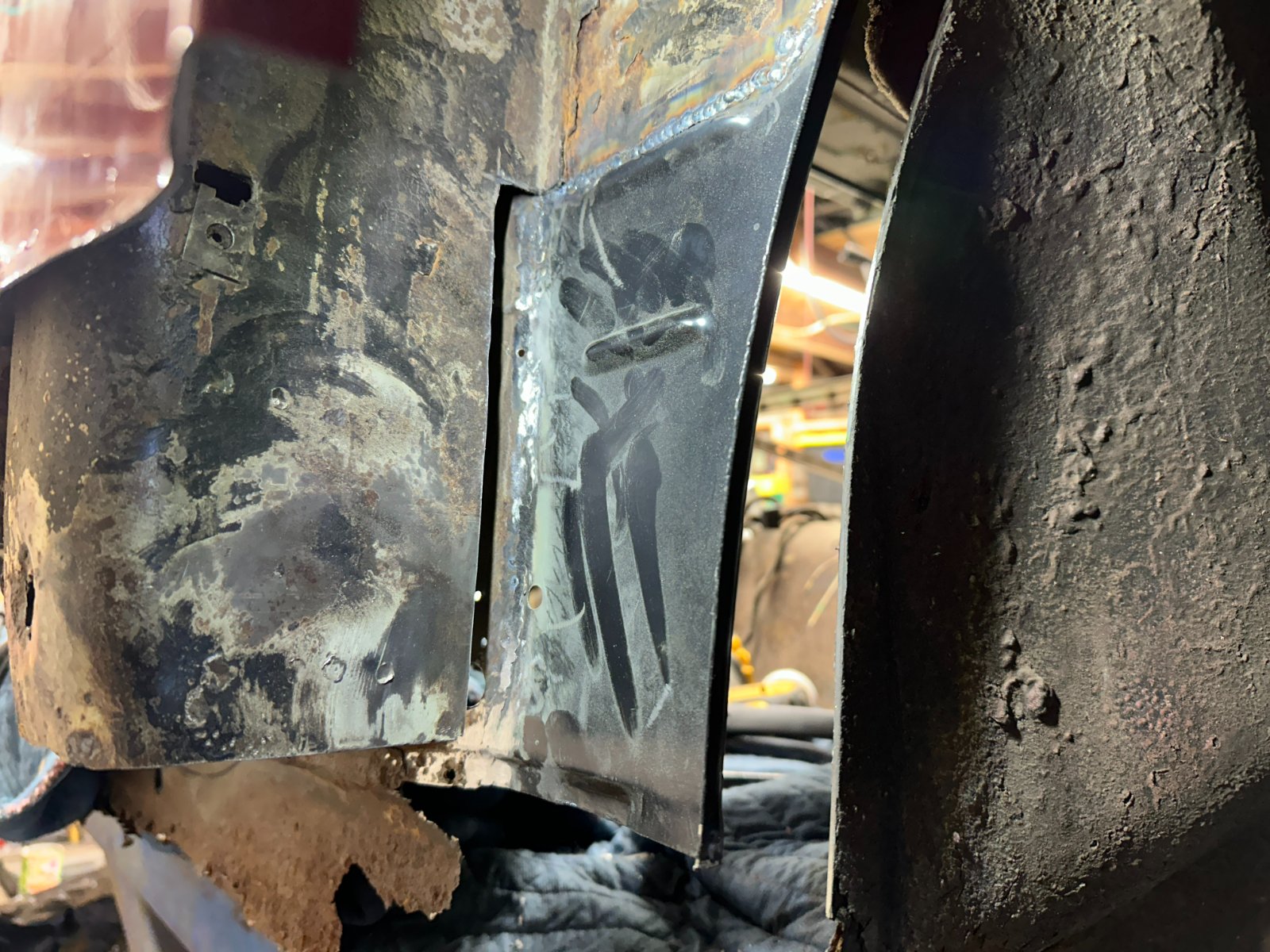

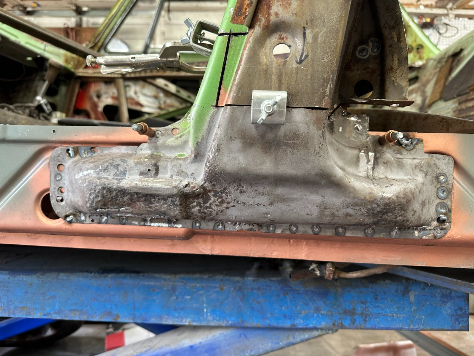

I've started fitting up the new intermediate sill, and the original b-pillar support, which was in fine overall shape, just needed one patch and a new lower flange. My plan is to use the method I saw on @nosmonkey's thread of assembling everything from the intermediate sill out off of the car, then spot-welding it all on as one unit. This should make the lower intermediate-to-outer-sill welds a lot better and save a bunch of time overall, in addition to being how the factory did it of course. I bought and fixed an enormous old spot-welder a while back with just this sort of thing in mind, but I haven't actually used it yet, so we'll see how that goes!

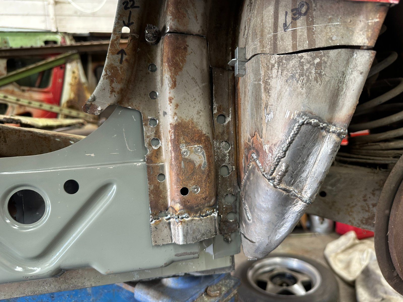

I agree Dave. I did section one of the new rockers I got from WN. Felt bad doing it but it wasn’t worth tearing the entire side apart after I saw that the inside was in good shape.
Sometimes you have to known when to stop.
Wise man.

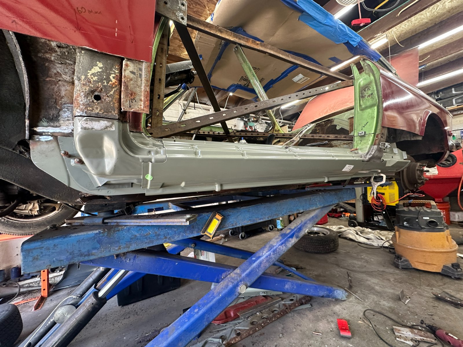

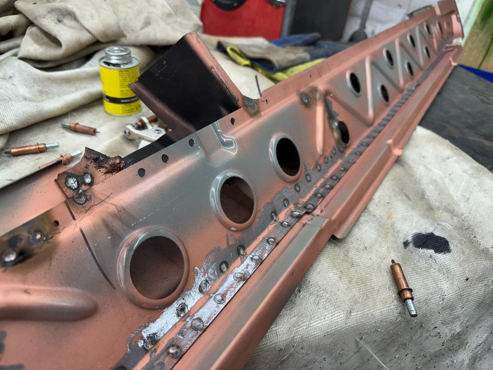

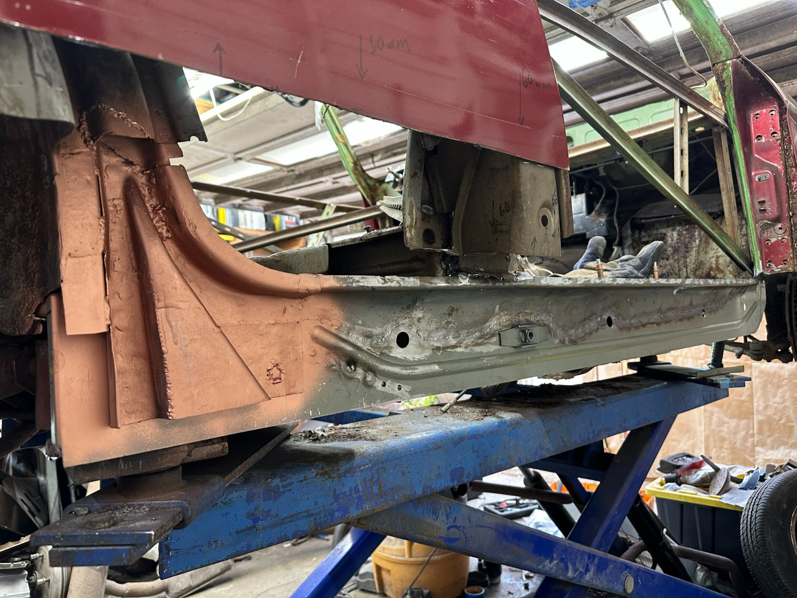

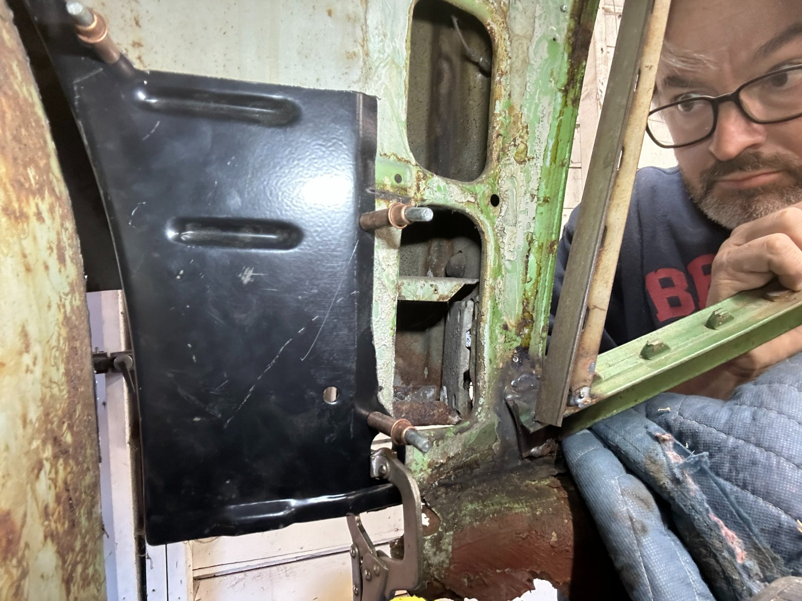

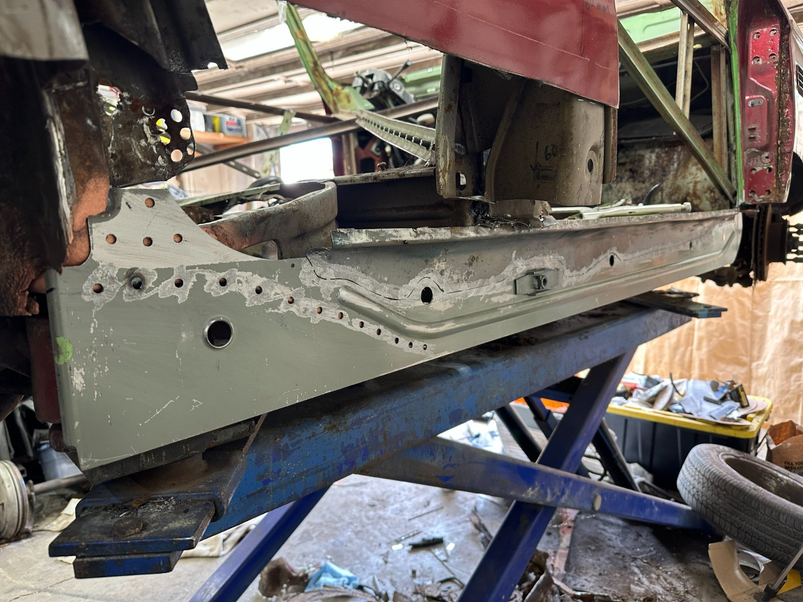

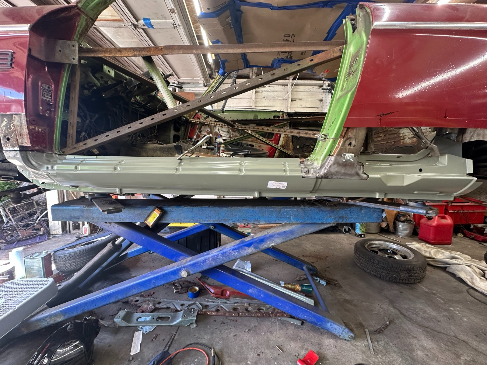

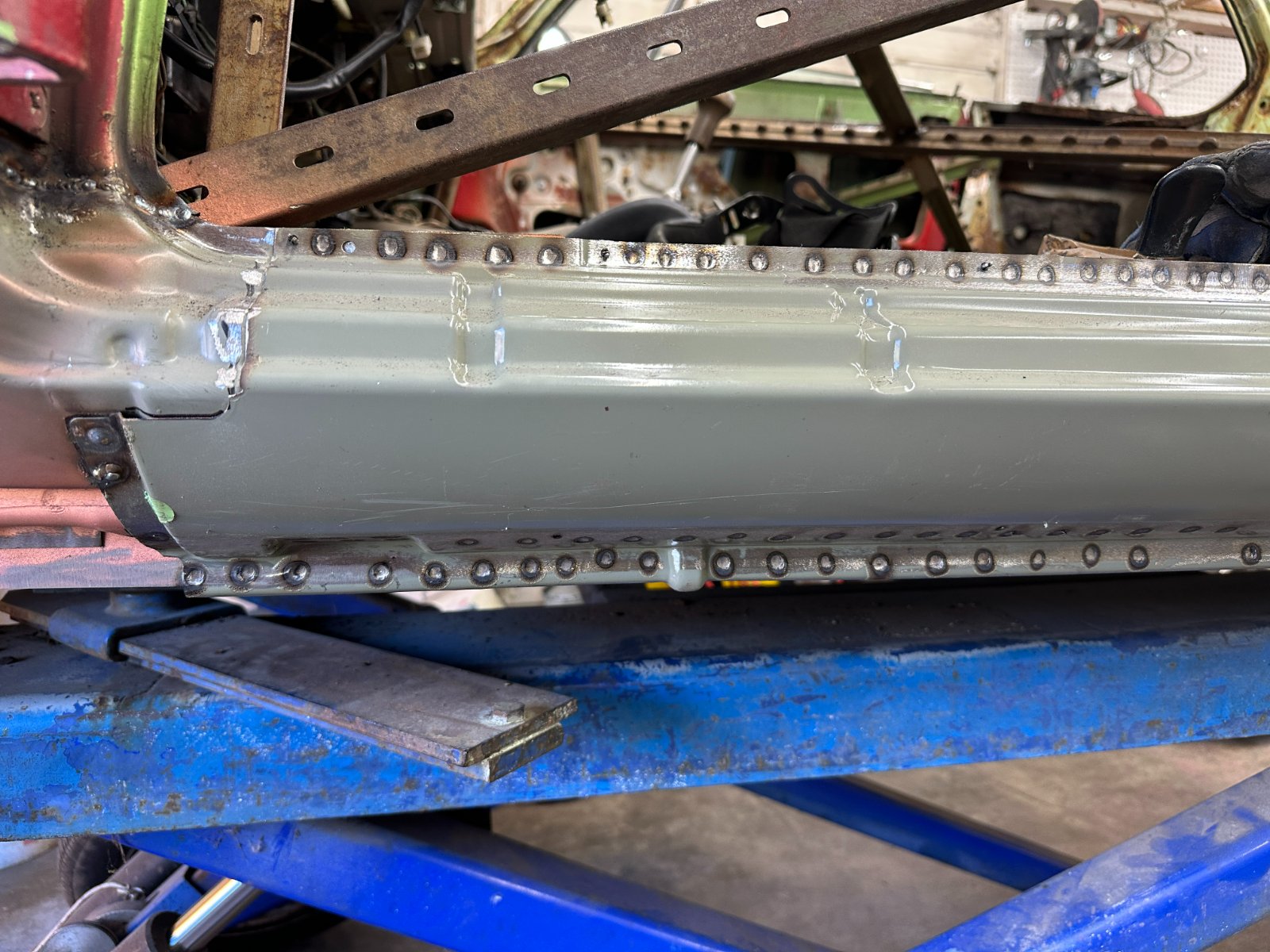

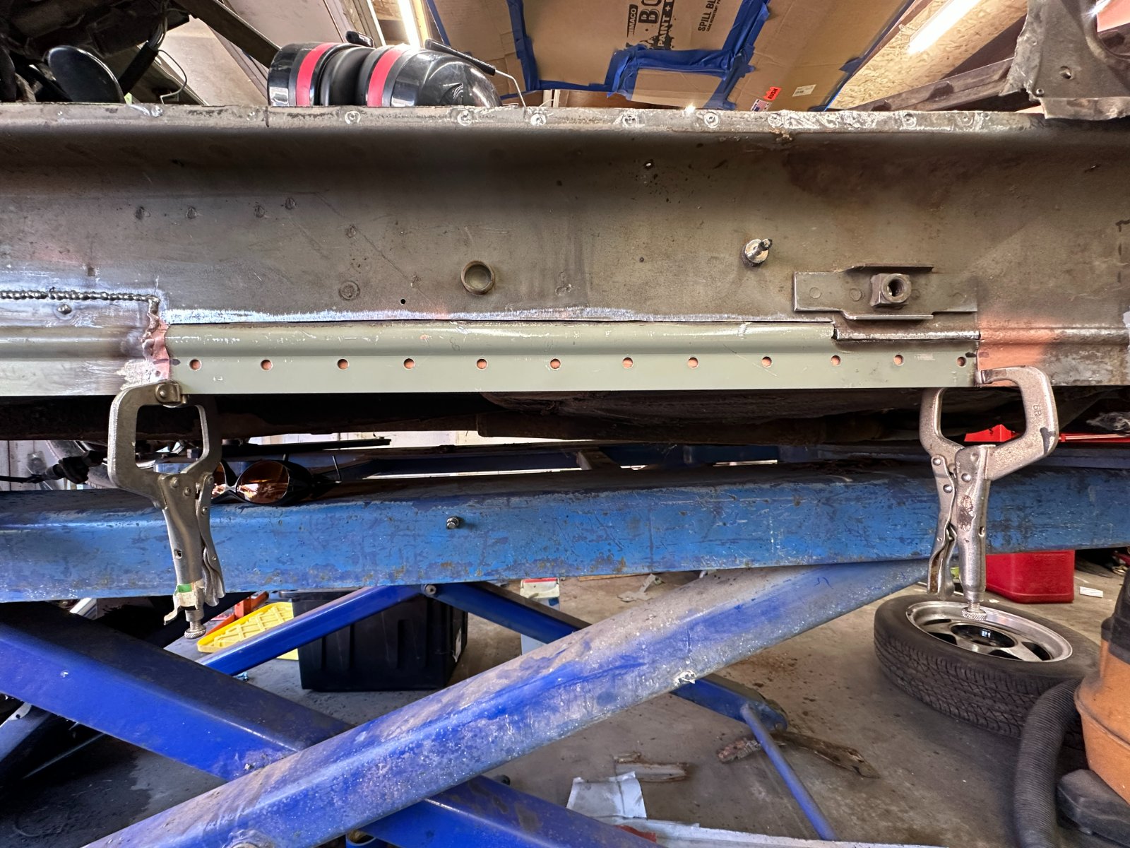

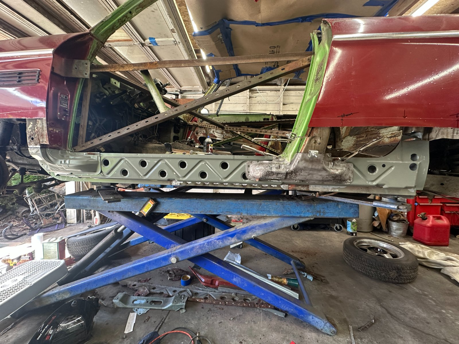

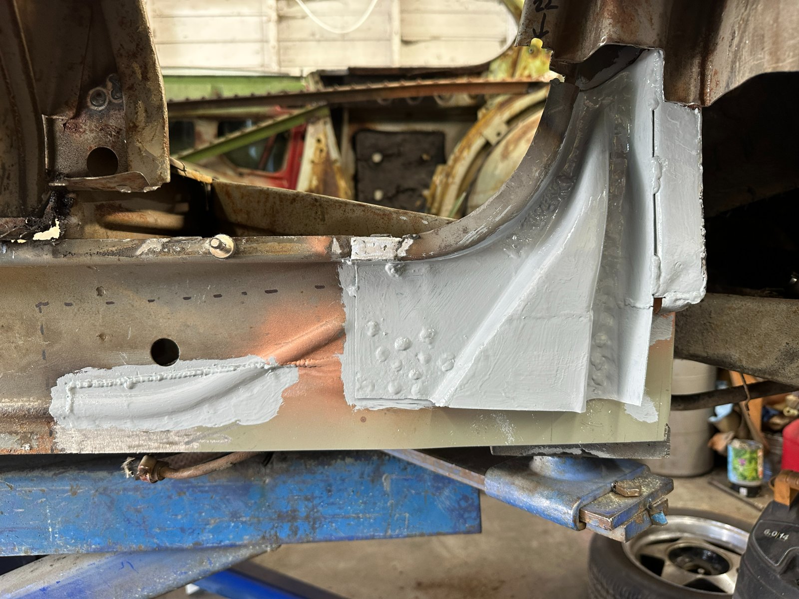

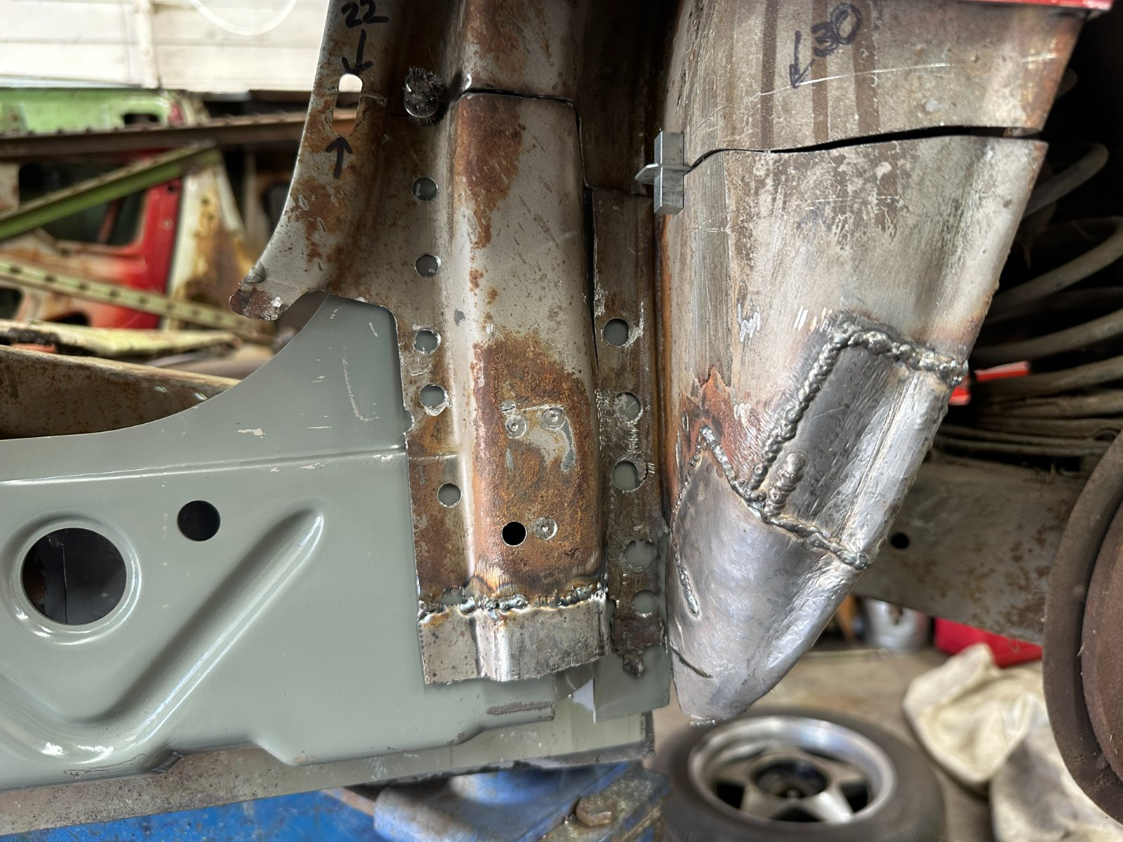

Getting close to being ready to button up the driver's side sill. Pretty much everything is set to turn over to the spot welder with the exception of the rear inner wheel arch, which I'm in the process of fabricating patches for and rebuilding (it's not really visible in the photo, but it's in two pieces right now from when I removed everything). I'm headed out of town for a week and a half, though, so that'll have to wait until I get back.

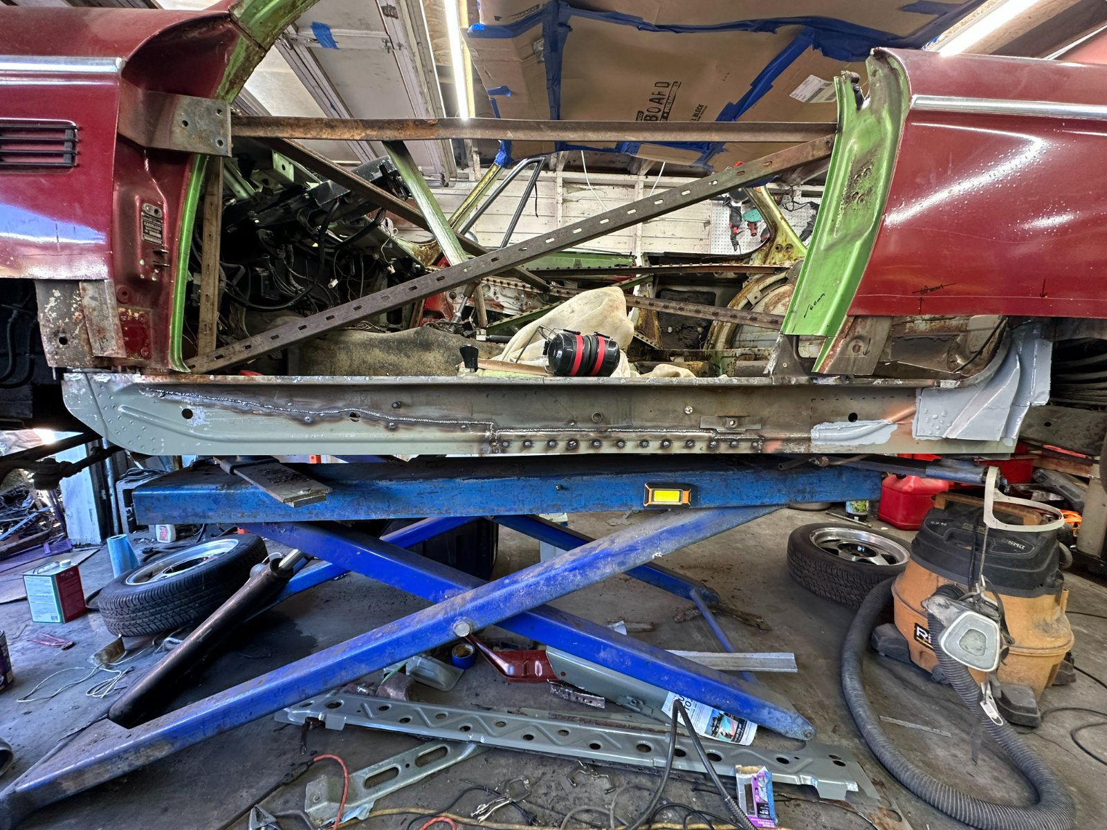

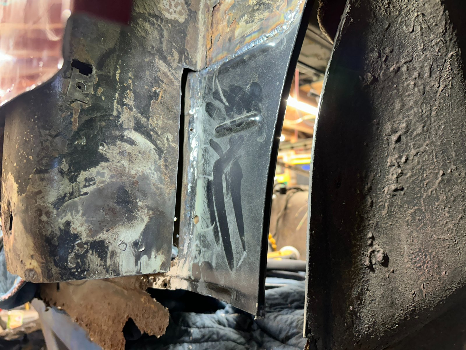

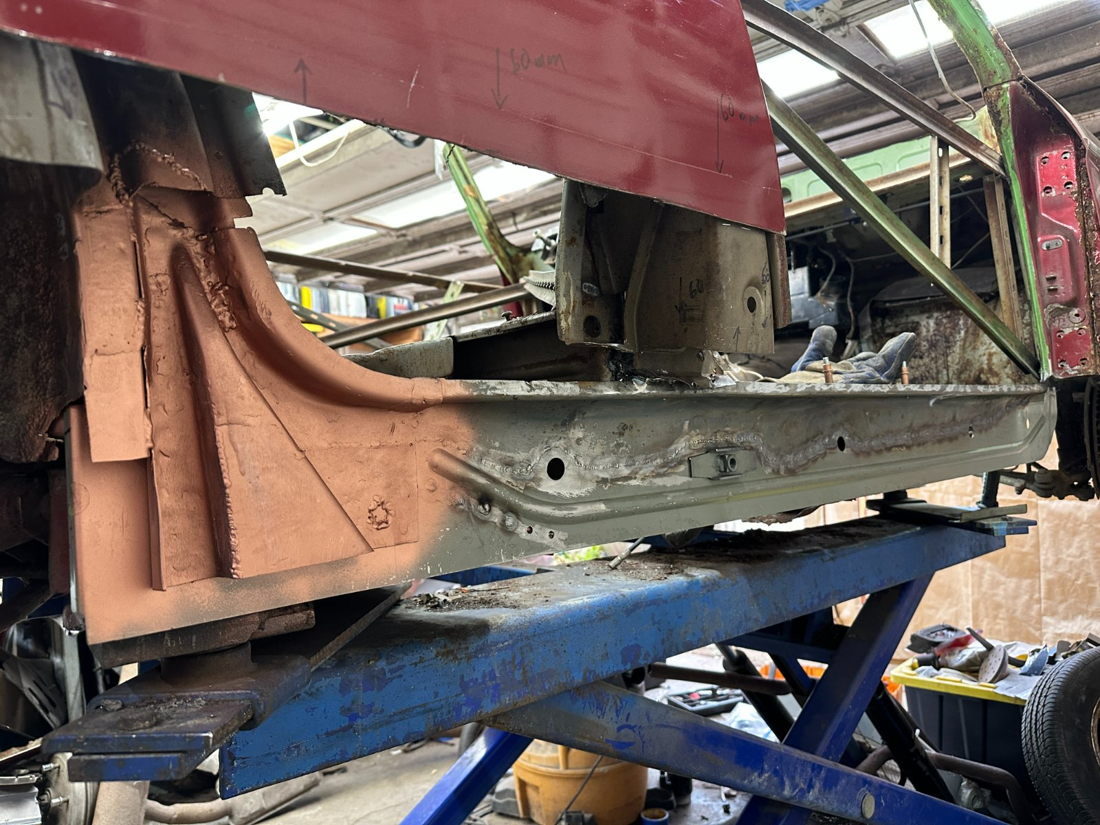

I came home from vacation to find that part of my garage ceiling had collapsed (!), so I've been dealing with that as well as various other projects, hence the delay. All is pretty much back in order now, though, so I've started to make progress again.

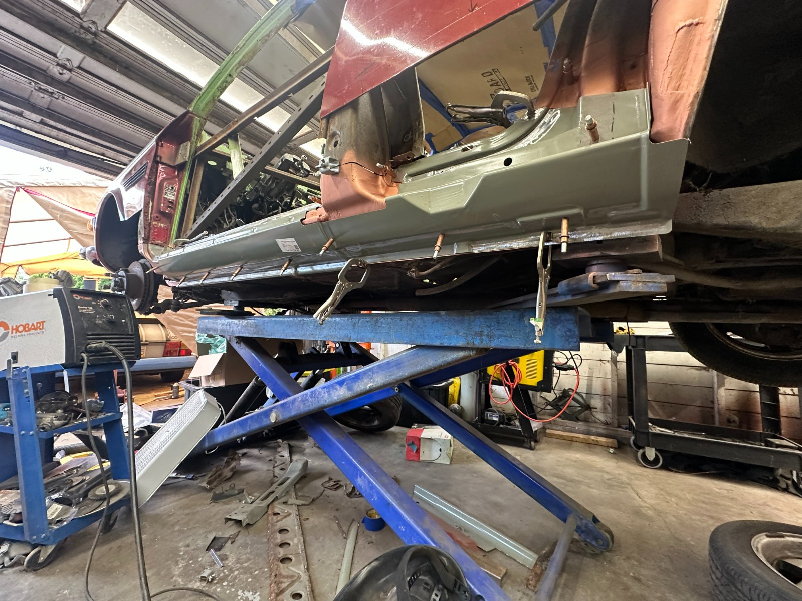

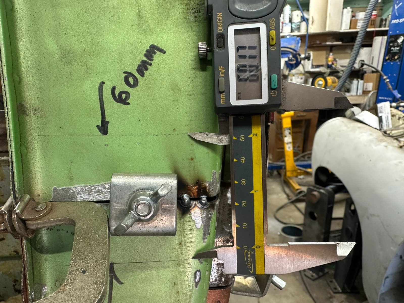

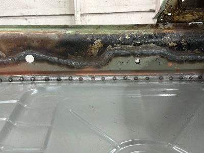

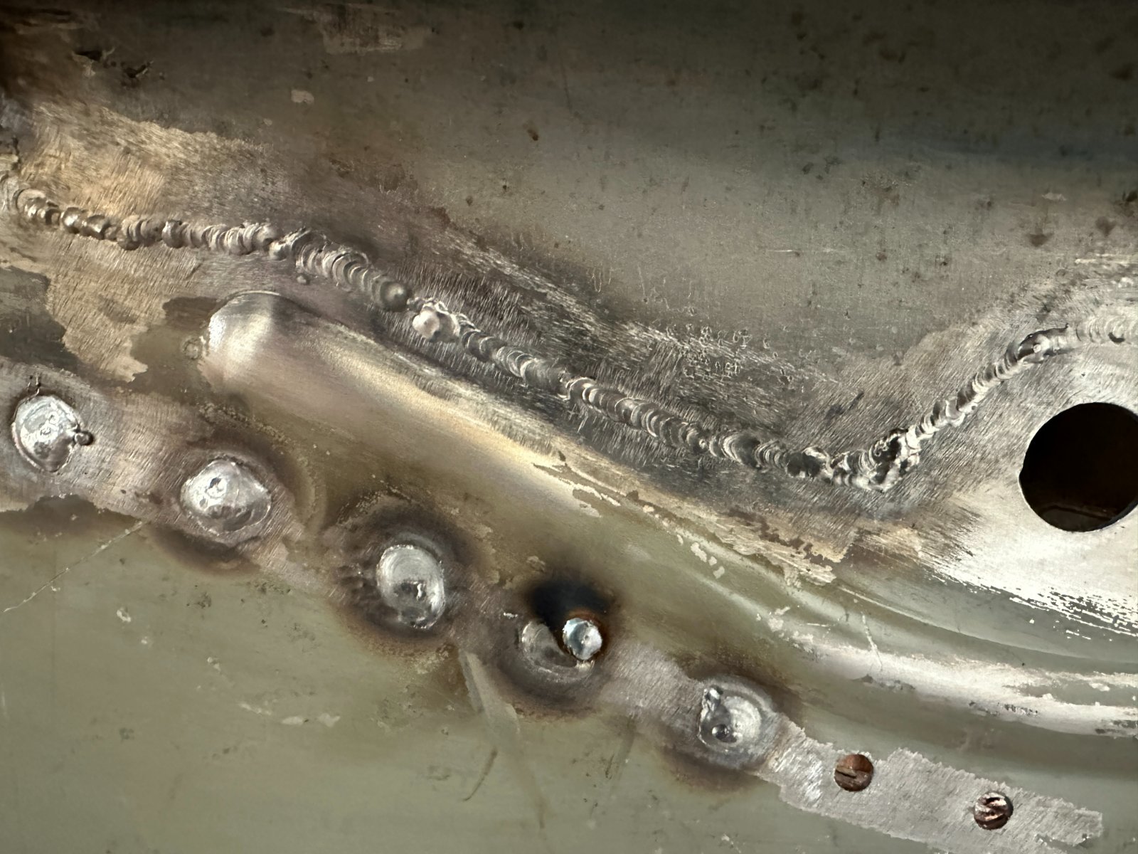

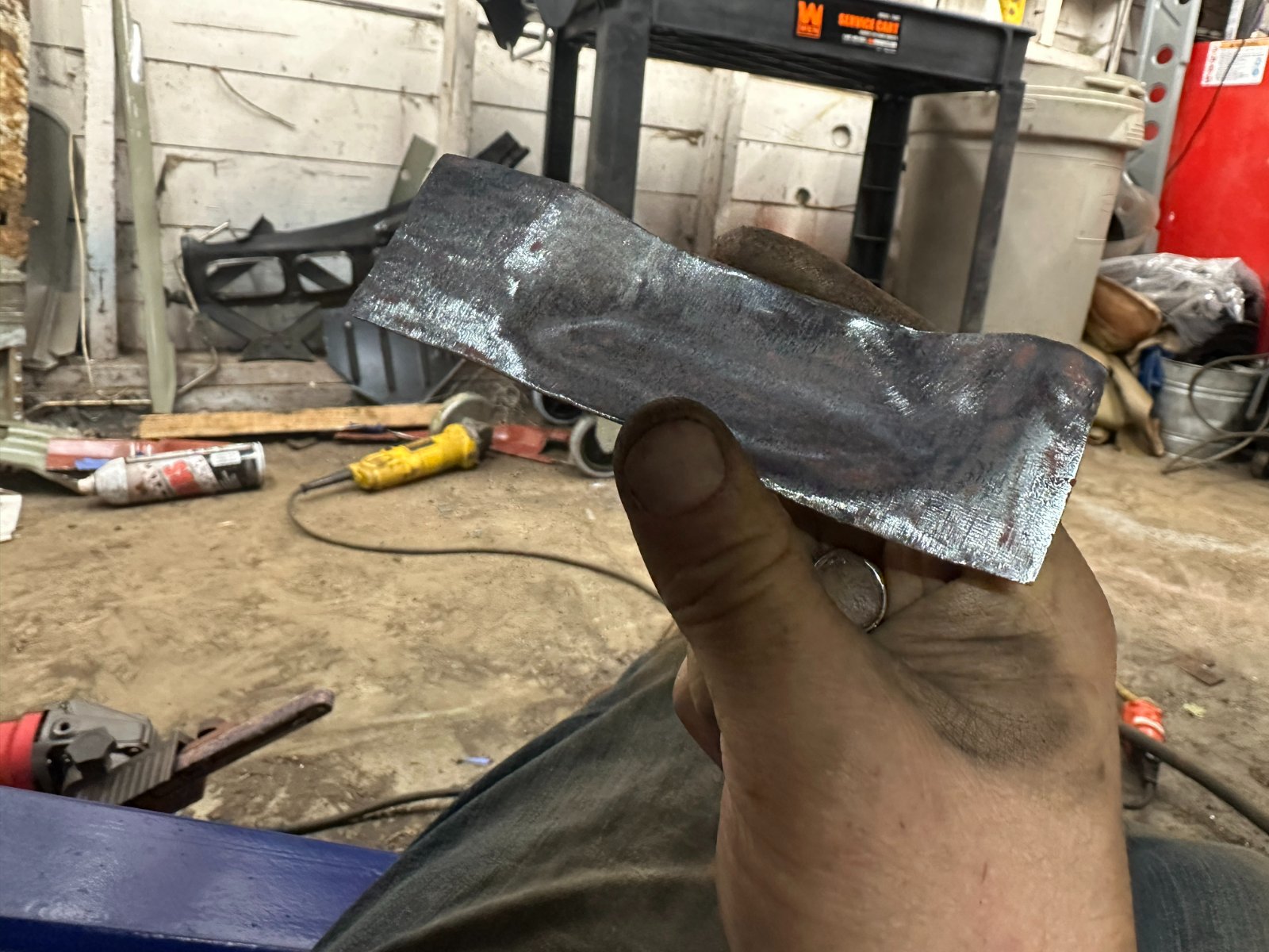

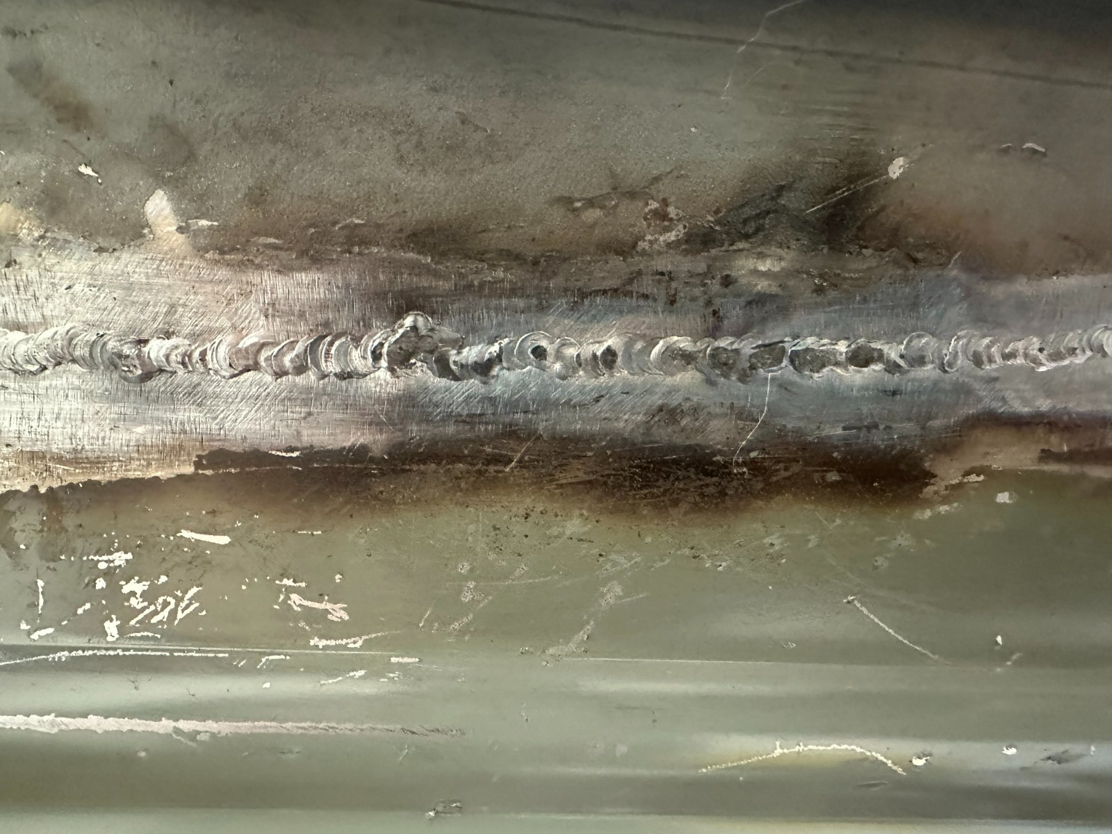

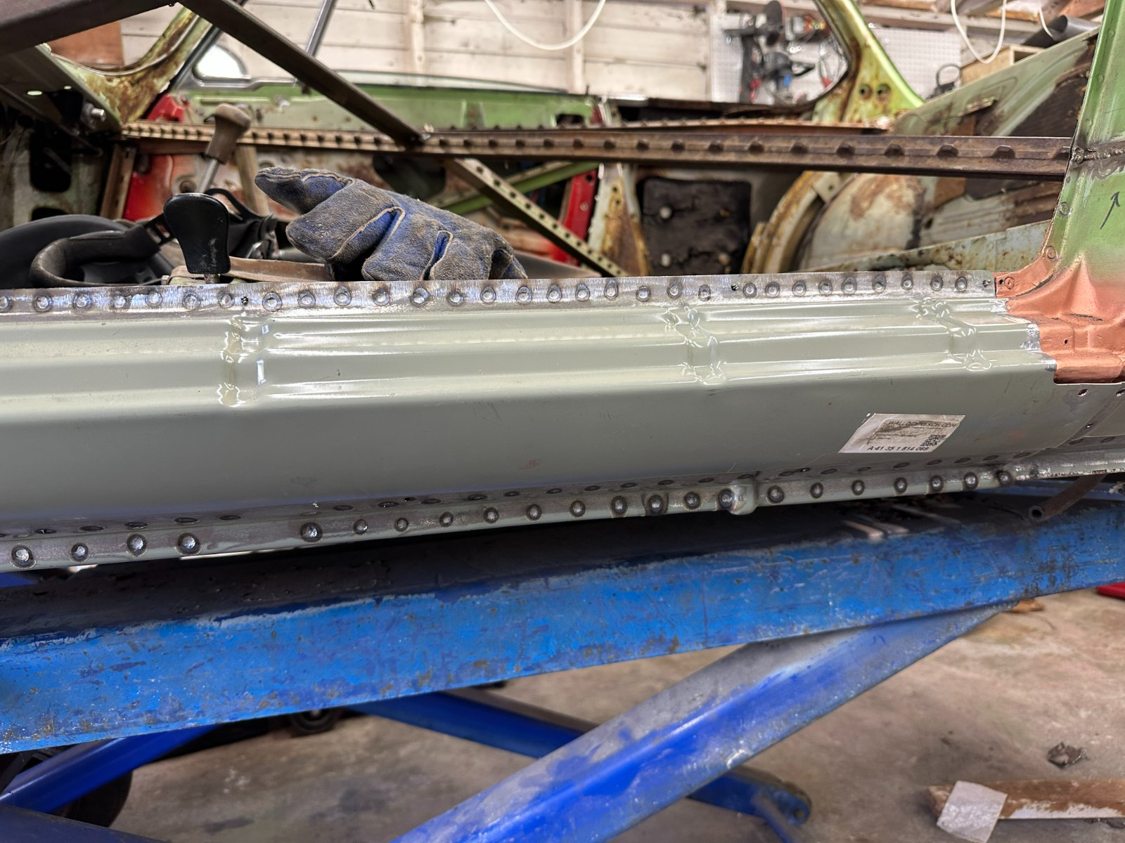

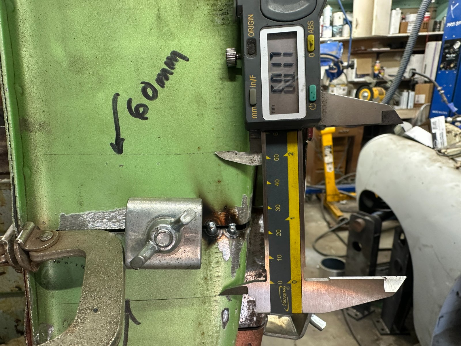

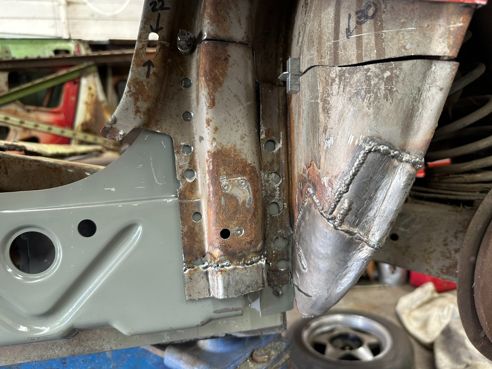

I finished patching up / fabricating that tail end of the rocker assembly where it interfaces with the inner wheel arch (this took me a long time, mostly due to second guessing myself and lots of measuring, adjusting etc). After a lot more back and forth with test fitting etc., I finally committed and tacked the a and b pillar supports, as well as that tail end section, to the intermediate rocker. And then, finally, it was time to bring out the spot welder for its first real use since I resurrected it.

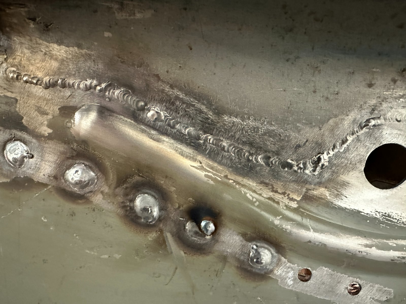

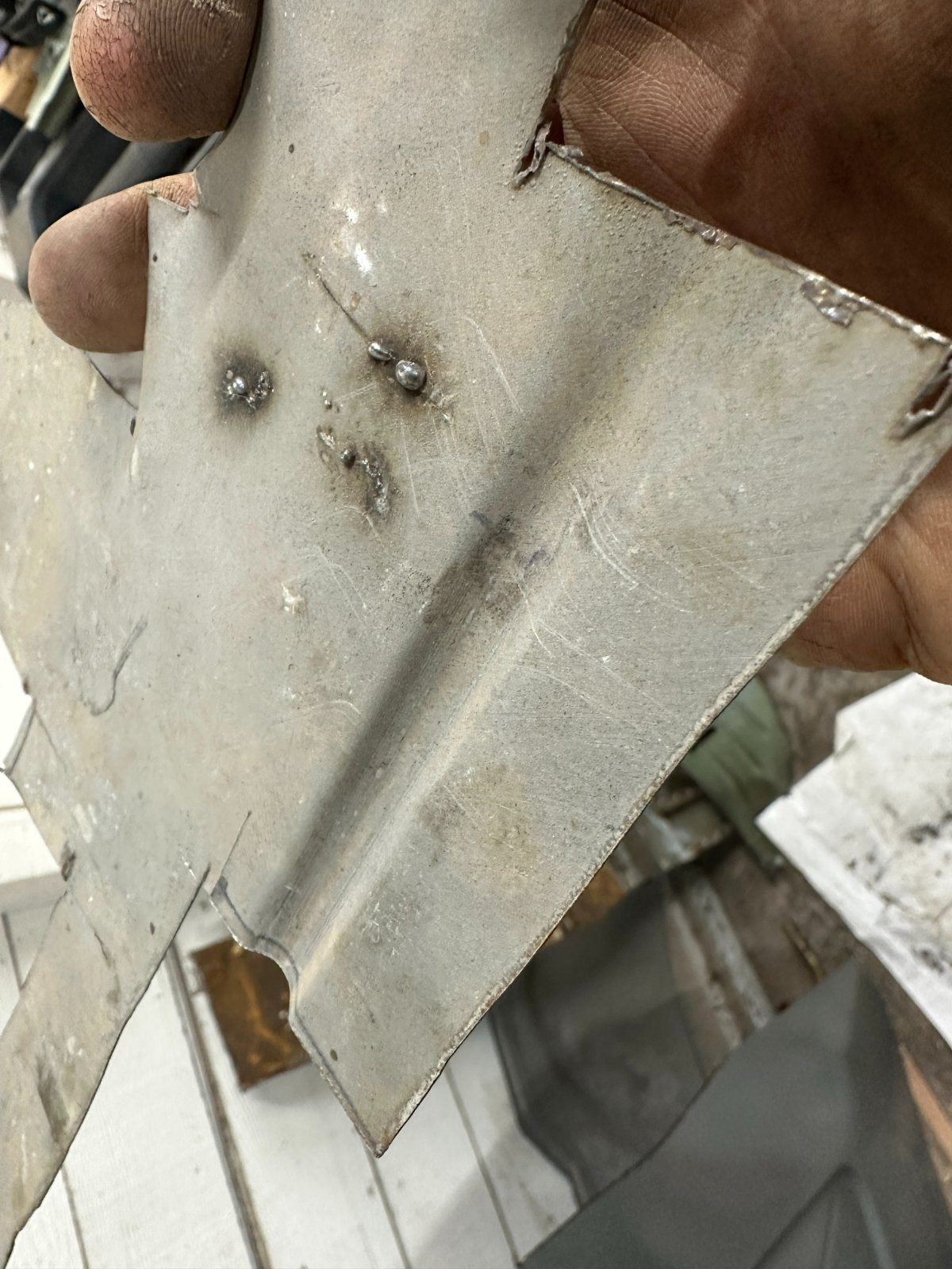

I did a bunch of testing settings on scrap metal until I was happy with the "nugget," and then went ahead and spot welded those sections together. And then finally, after still more fitting, adjusting and tweaking, spot welded the outer rocker to the intermediate assembly.

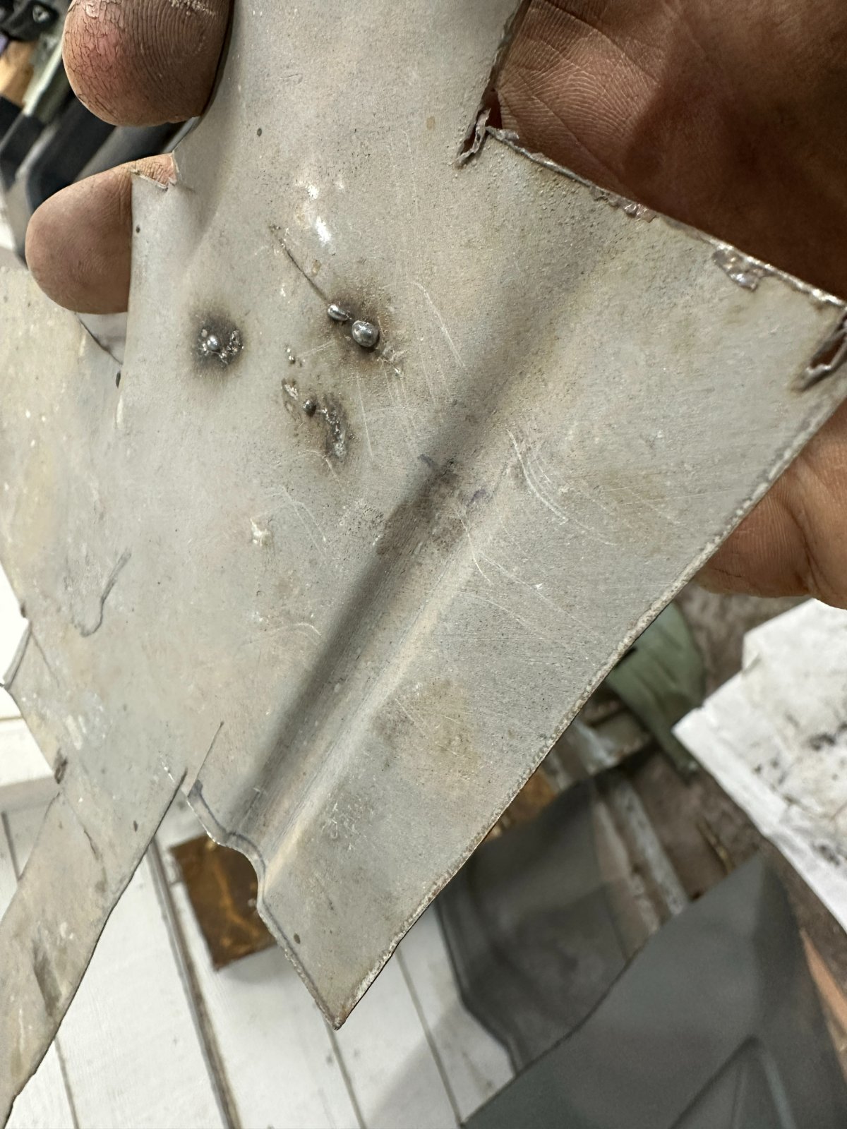

I realized too late that while the spot welder has no problem going through weld-through primer on the inner surfaces of the things it's welding, I guess it's not conductive enough for the electrodes themselves. So, I had to sand that off of the inner and outermost surfaces not long after applying it. Live and learn (and probably should have known better in the first place).
The next step is to re-mount the whole assembly, and then weld up all the but welds where I cut the a and b pillar supports initially. Then spot welding along the top and bottom flanges, and seam welding in the various spots where the factory did. There'll still be a few places where I have to use plug welds but nothing like what I'd be dealing with without ol' spotty. It take up an enormous amount of space in my garage, but it now seems clear it's worth it.
I'm alternating between this project and getting a Lemons Saab some friends and I have built ready for a race the 30th-31st. It'll be our second one and I'm wrapping up our various improvements from last year -- should be fun!

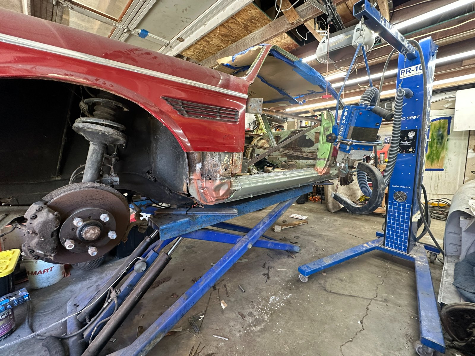

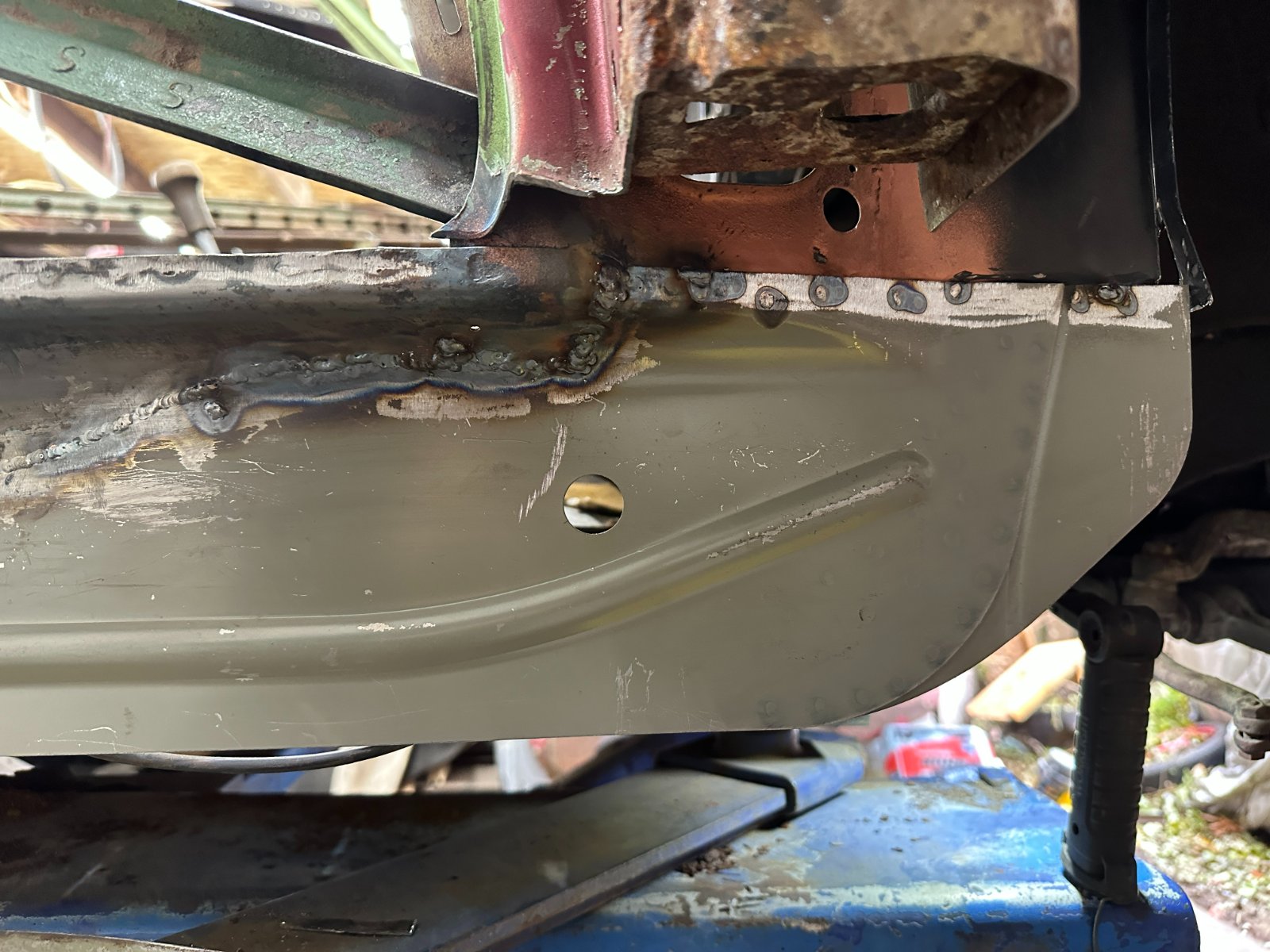

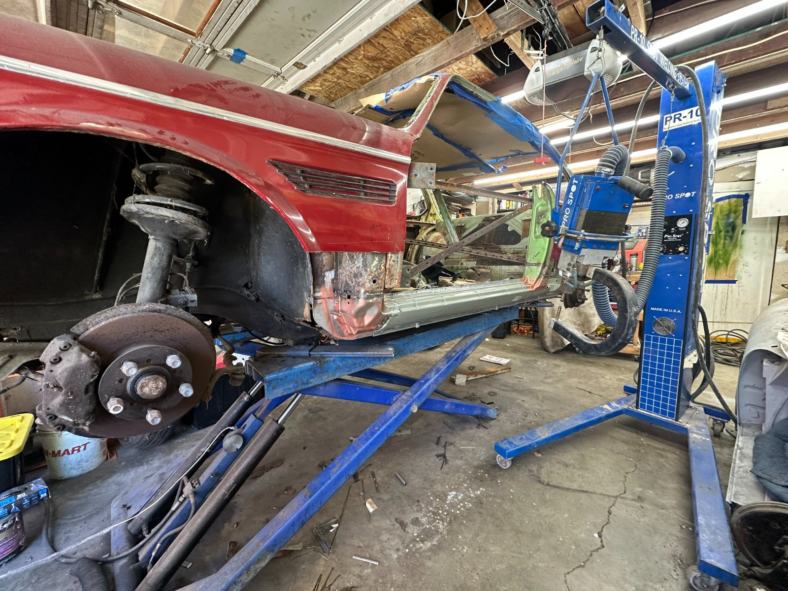

Really nice progress, and your spot welder sure makes it looks nicely original too. It's a beefy one for sure, looking at the size of the spotwelds!
One of the best traits of a spotwelder is the no-need to dress welds afterwards. Zap and done!
Thanks! And yes it's great... no gas to worry about either. The downsides are it's awkward as hell and kind of a workout to use, but I'm really glad I picked it up. I might eventually sell it in hopes of finding a smaller one (I've seen them in a different form factor where they're more like a cart instead of a crane) but for now it's working out really well.
I have a hand held 240 volt version that's just manageable by my own in easy places. Works wonders but t's still to small; it can't sandwich the 3 layers of the sill.
When I used it upside down on the trunk panels, the seam behind the bumper, it was soo undoable that I bought a spring balancer to go with it.
I think I will eventually upgrade to a 380 Volt system that can manage the sills.

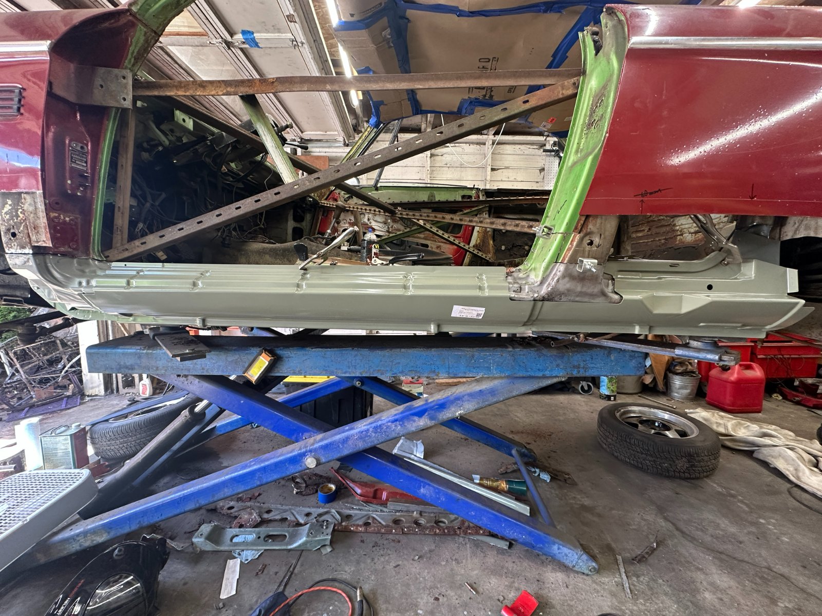

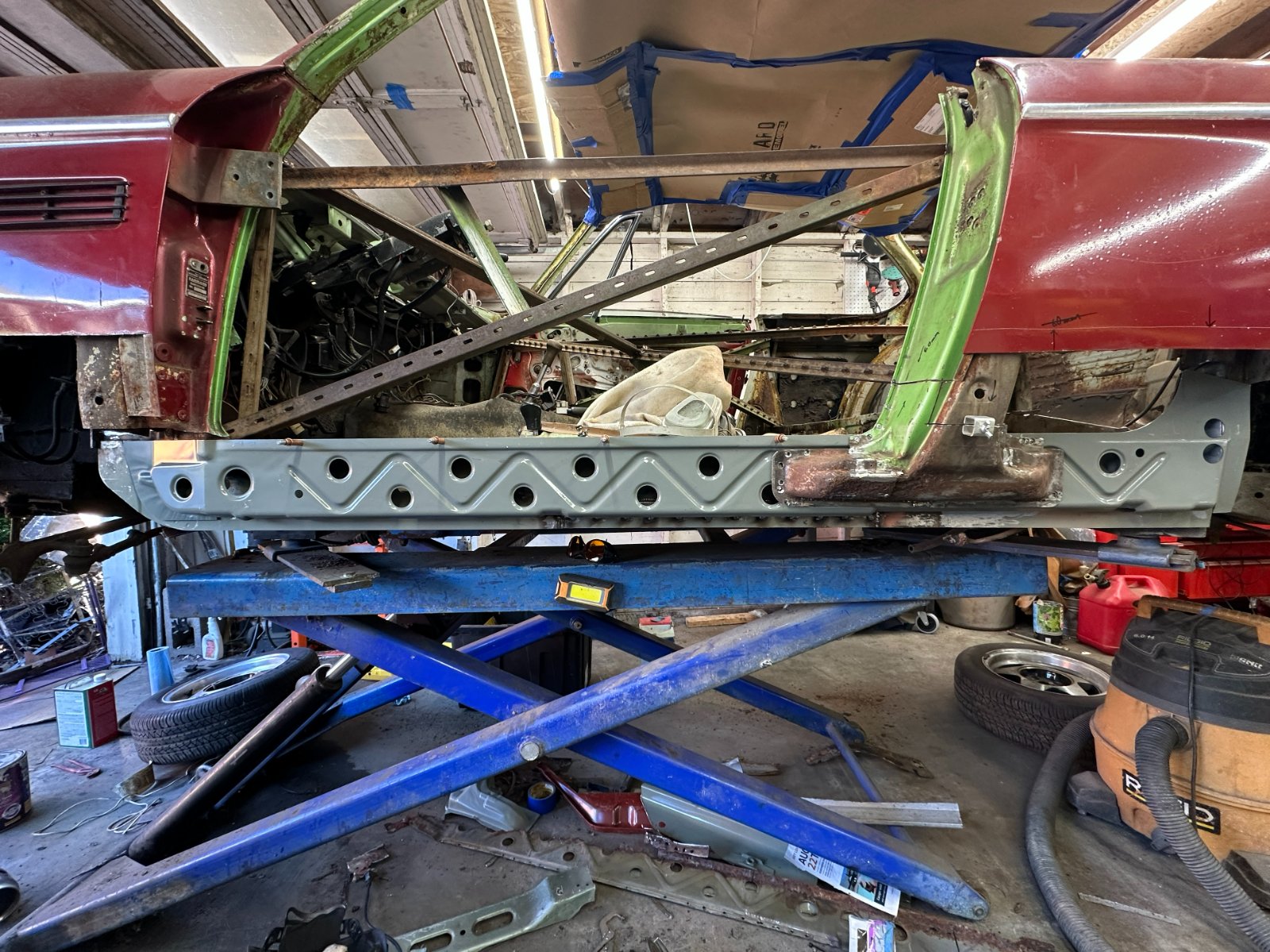

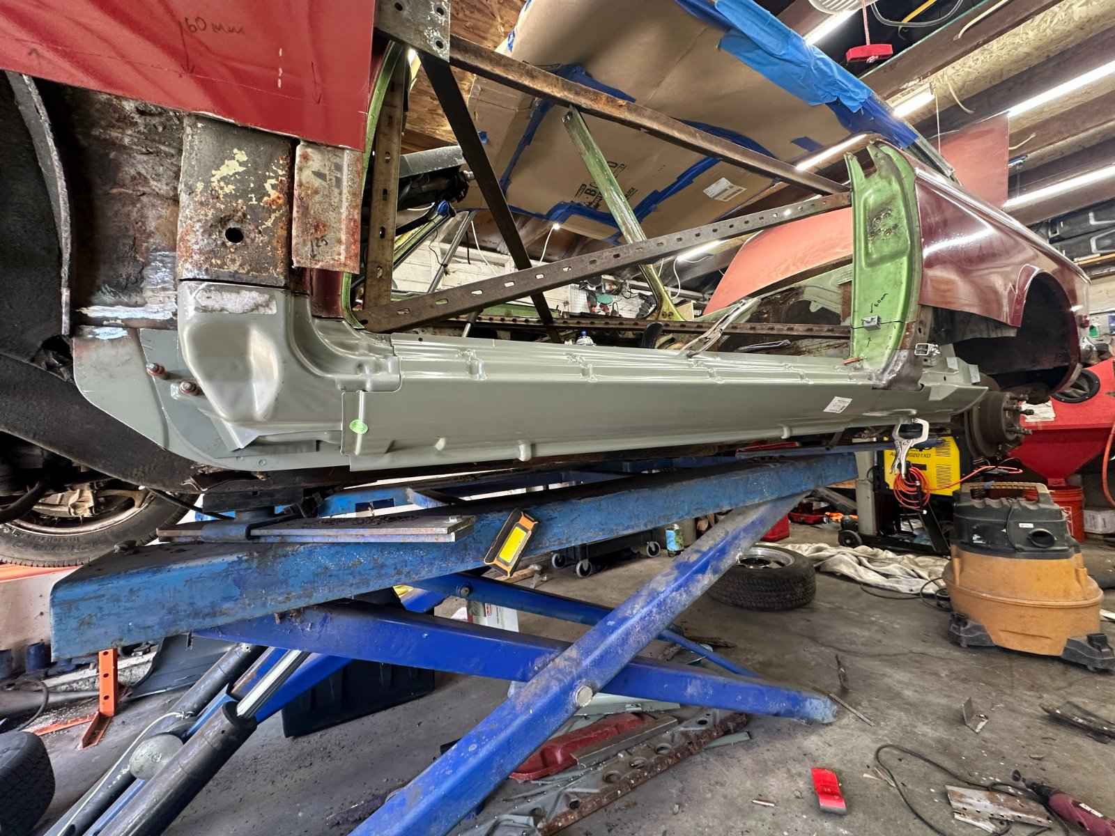

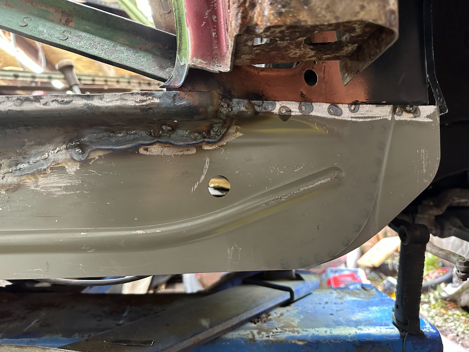

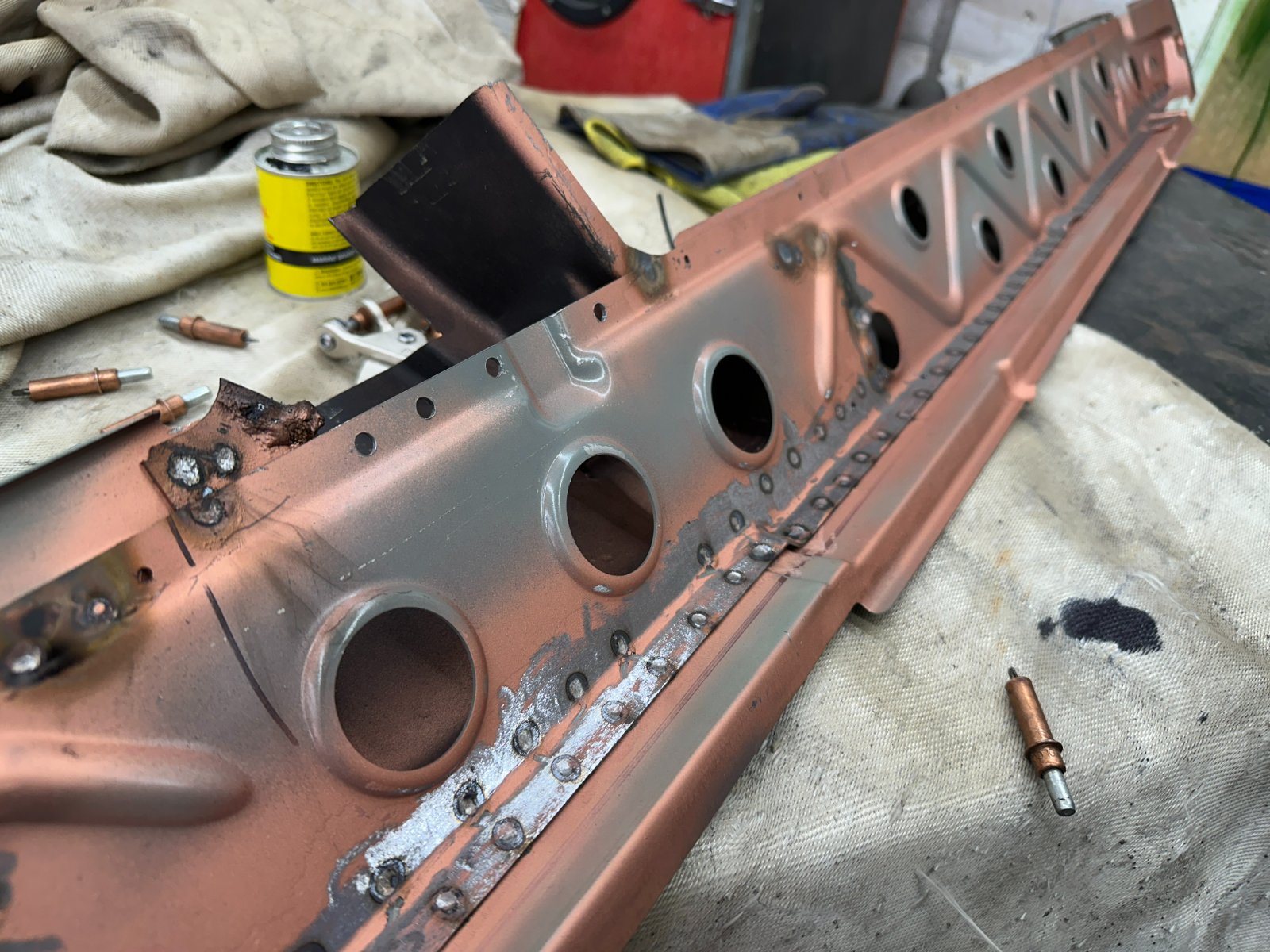

On image 4499 it looks like you prefabricated the outer sill with the thick inner still. And that assembly is placed to the car. Wasn’t that a non welded area originally. It looks so unusual for the original manufacturer (Karmann) the get the complete sill (4 pieces) assembled.
By the way: you made much more stiffer sill! Not bad at all.

Yup, that's what I did, having gotten the idea from @nosmonkey 's thread. I'm pretty sure that flange was welded originally, judging by what i found when I took everything apart. That's the main reason for pre-assembling the sills... for easy access to those welds (made even easier with the spot welder of course).

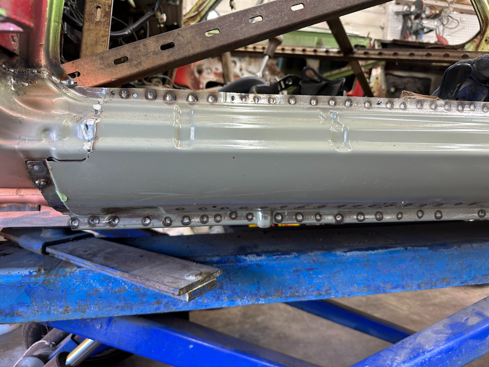

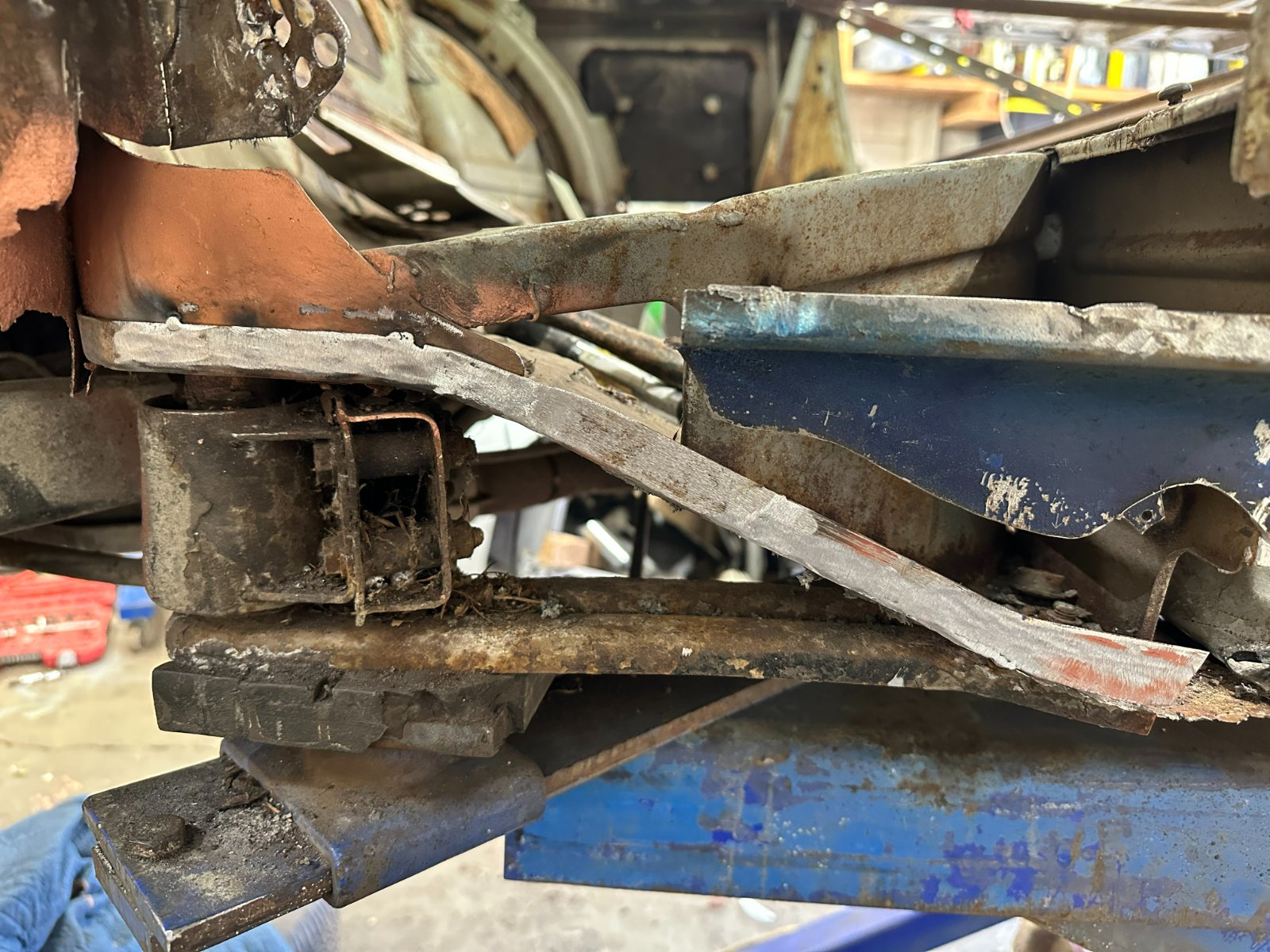

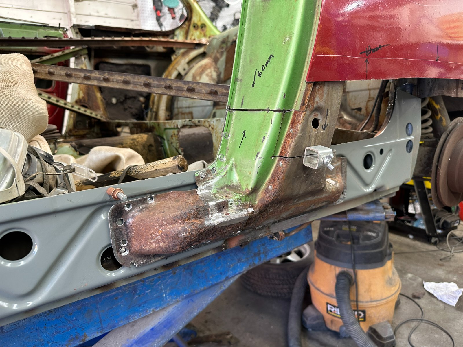

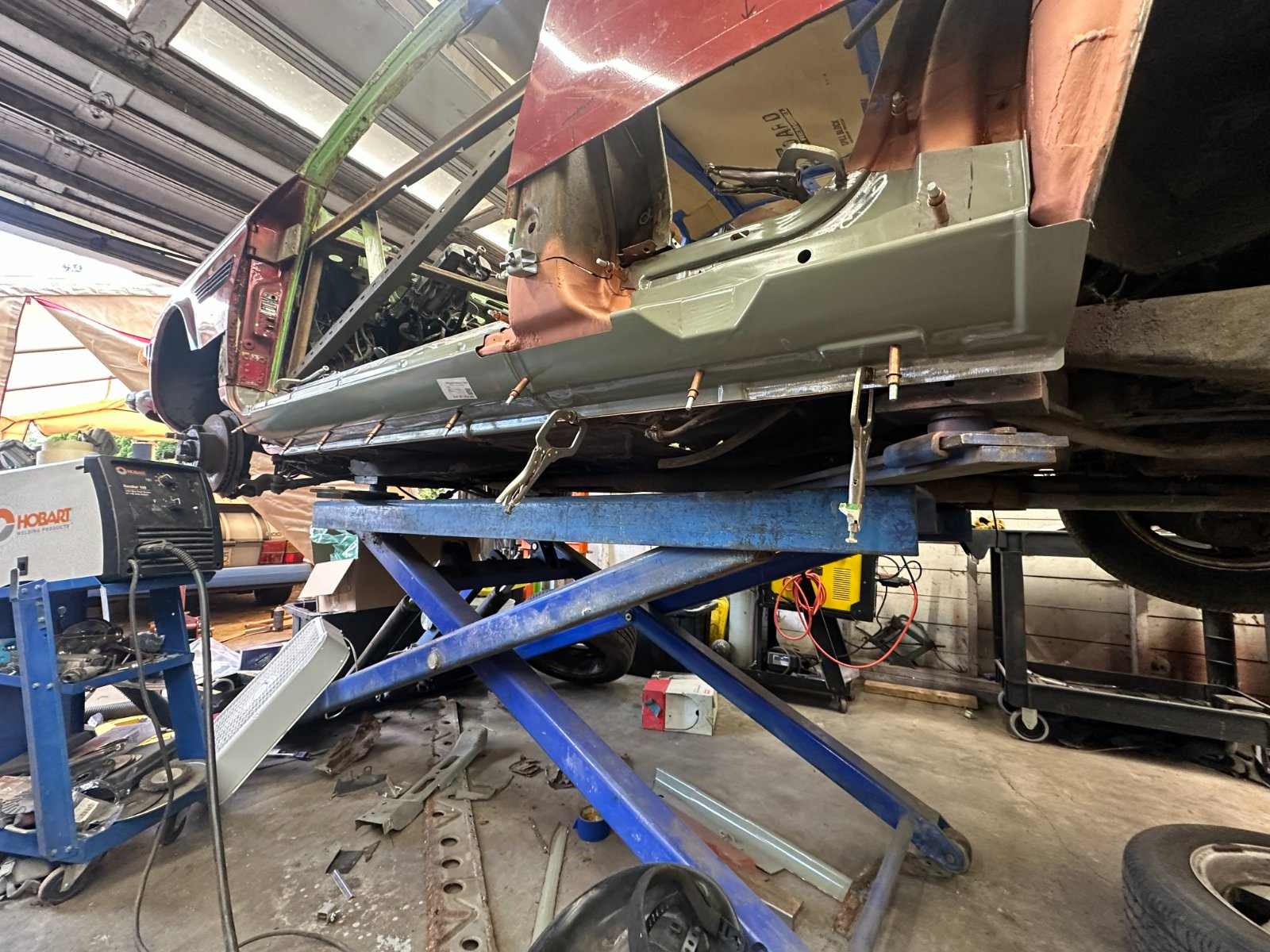

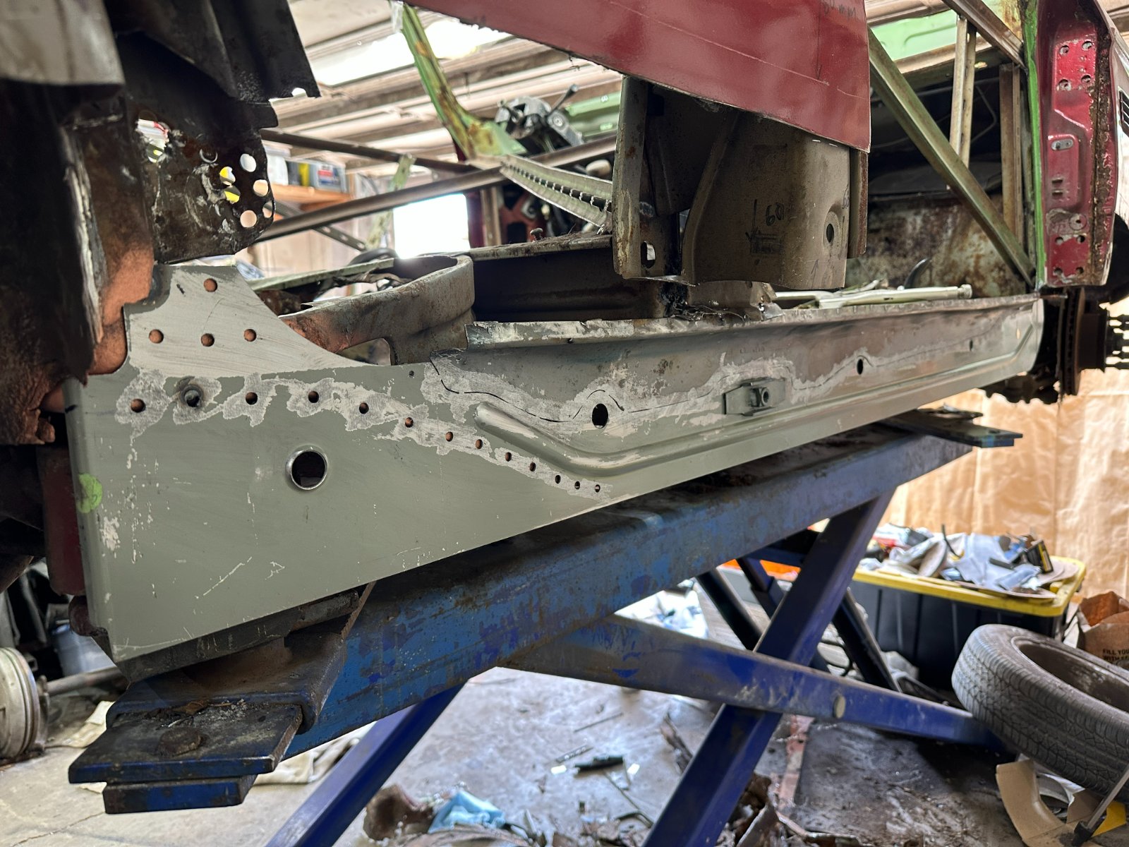

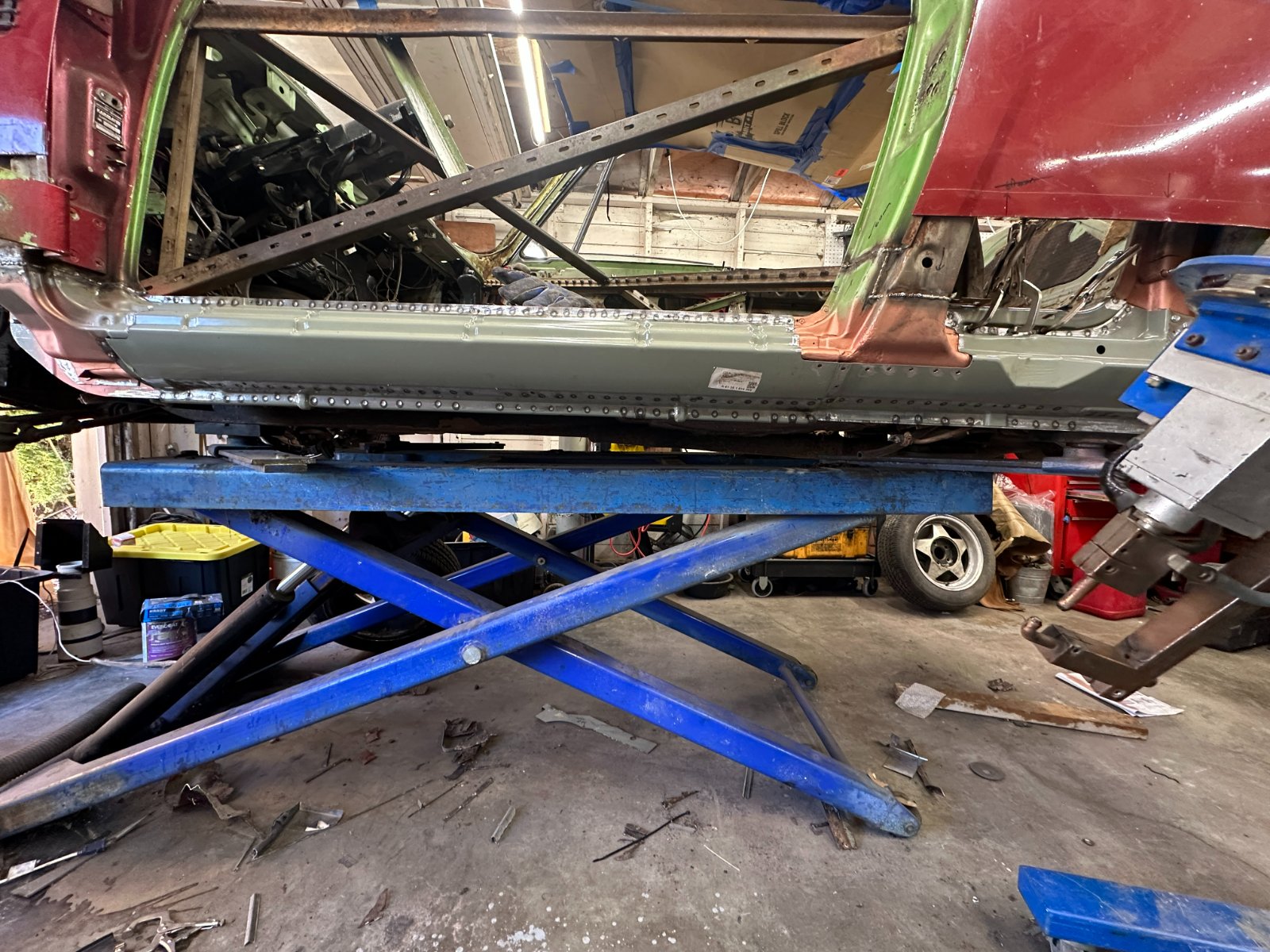

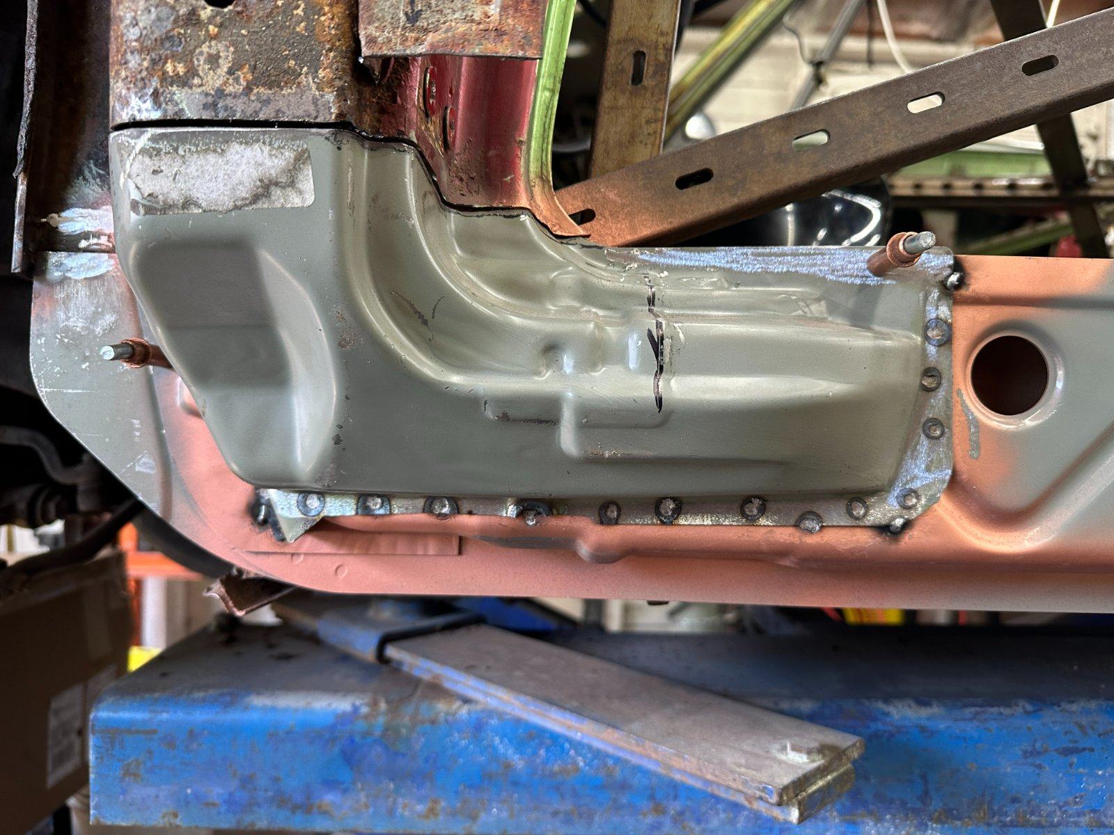

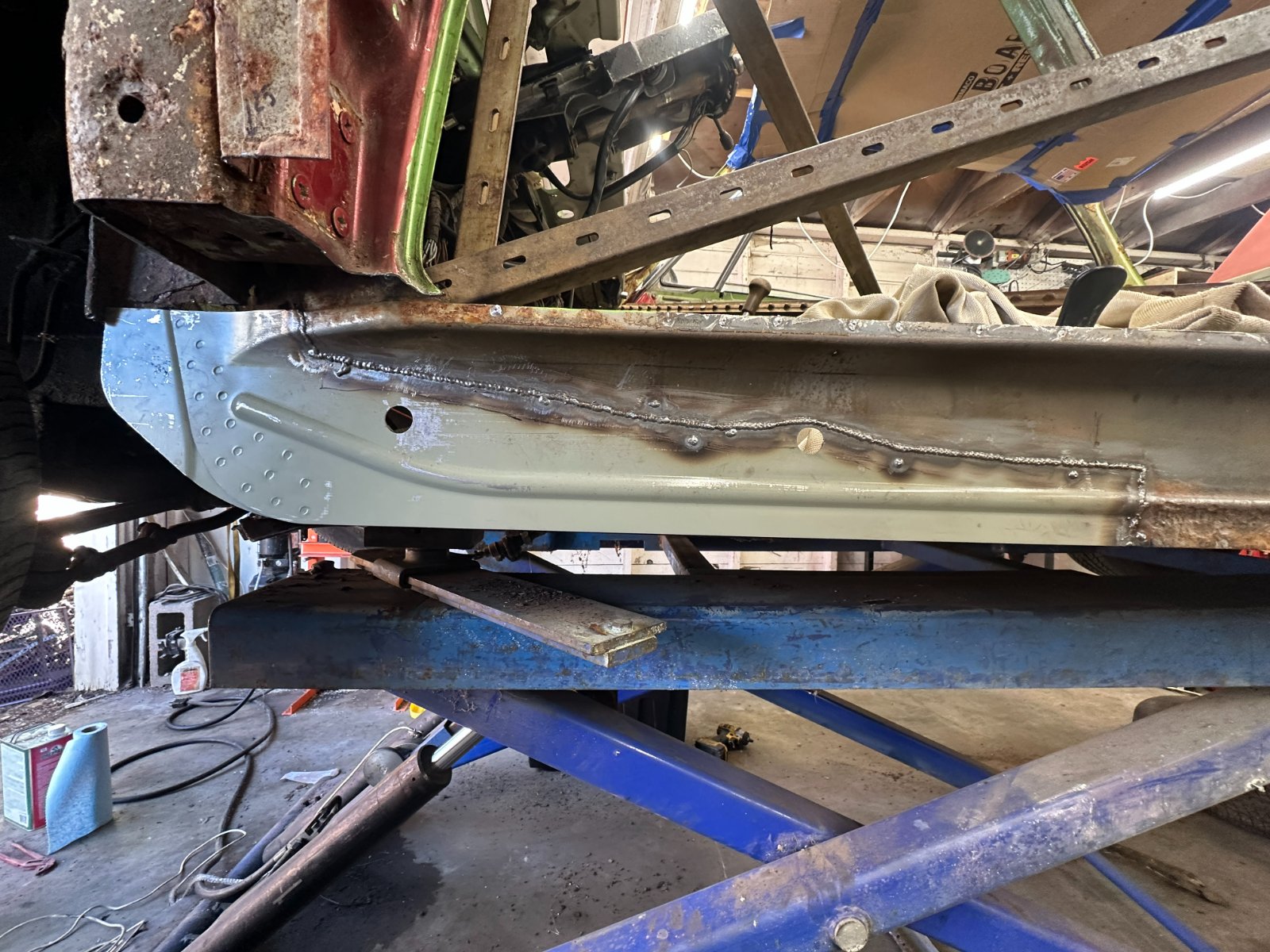

I got the whole assembly (mostly) spot welded in today. There are a few places where the electrodes couldn't reach, or where I hadn't cleaned the surface enough for good conductivity. I'll finish it up soon and then on to the passenger side.
I was really happy with the way I was able to get the butt welds lined up where I made the cut on the b-pillar support. Within .17mm of my pre-disassembly marks!

I've been busy with other projects, a Lemons race, a road trip, and finding and temporarily (?) adopting a stray dog, but have pretty much wrapped up the driver's side and have finally started digging into the passenger side rocker. It's in pretty similar shape to how the driver's side was... a little bit worse but not in any way that'll matter much once I start building it all back up.
I should have a good run of time to work on it here for a bit so I hope to knock this side out fairly quickly. After both sills are done, I'll pull the drivetrain and put it on my rotisserie to address the floors.

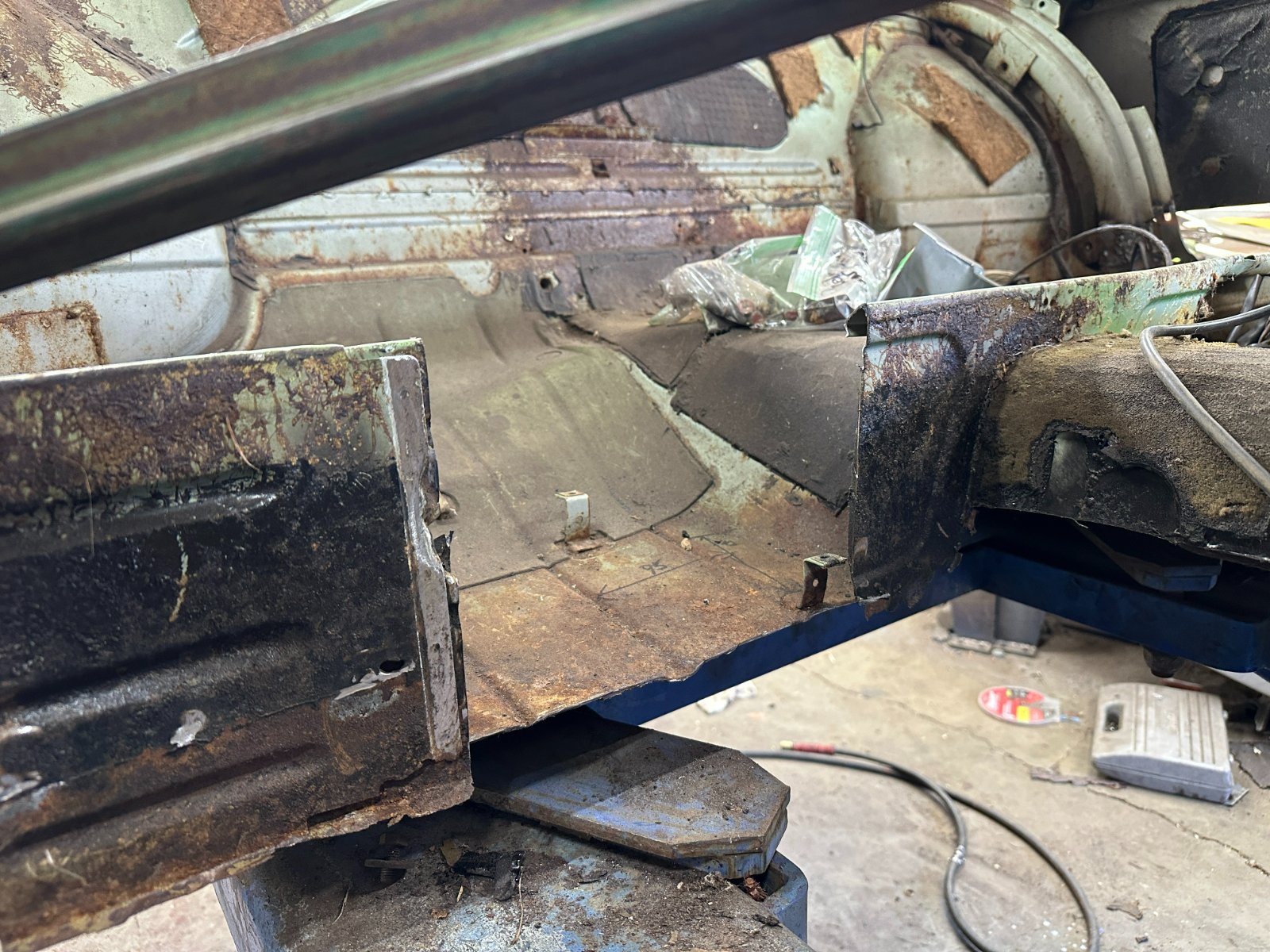

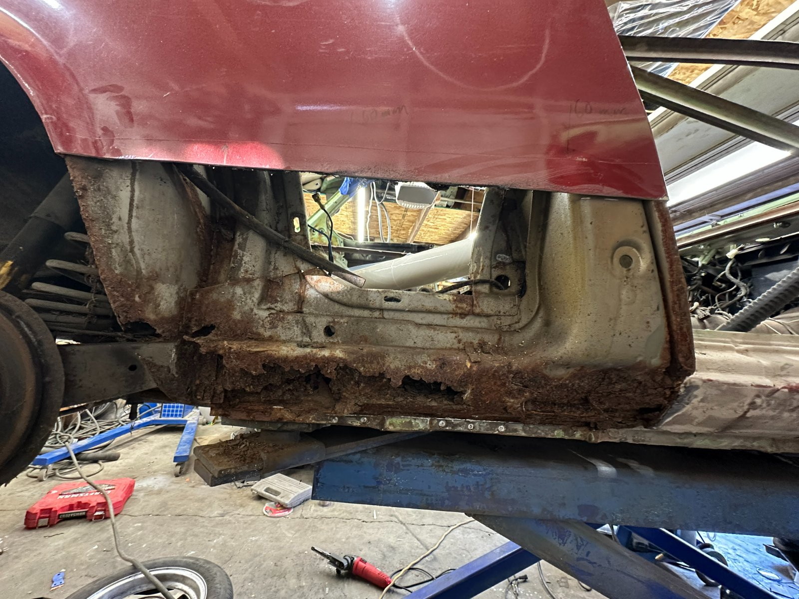

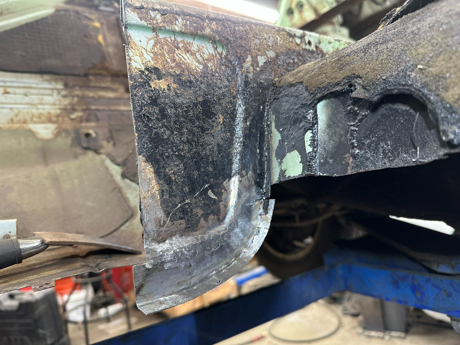

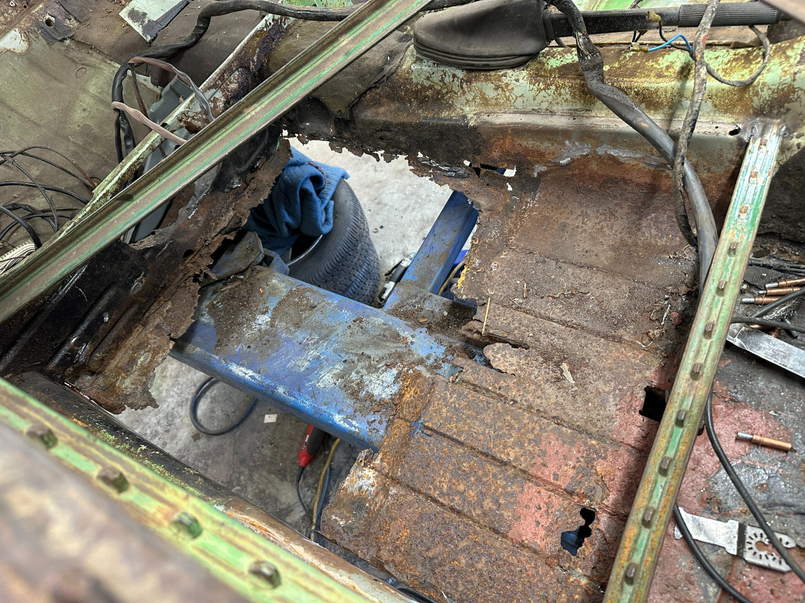

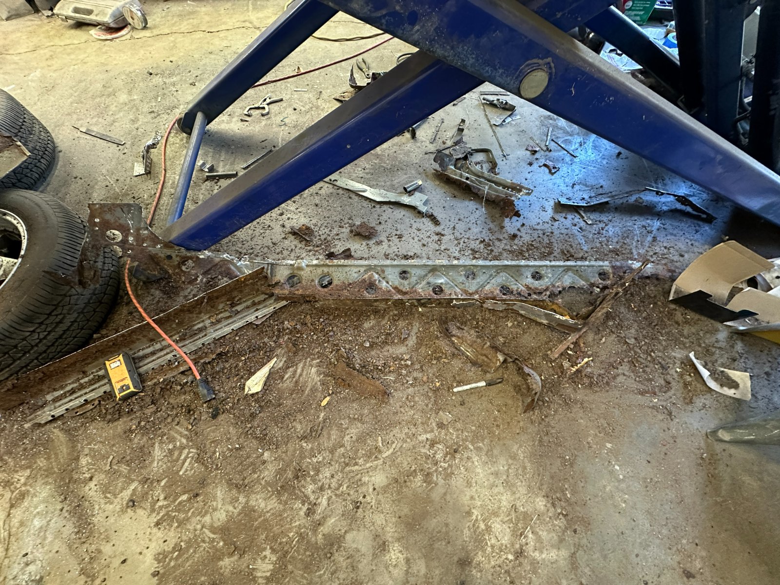

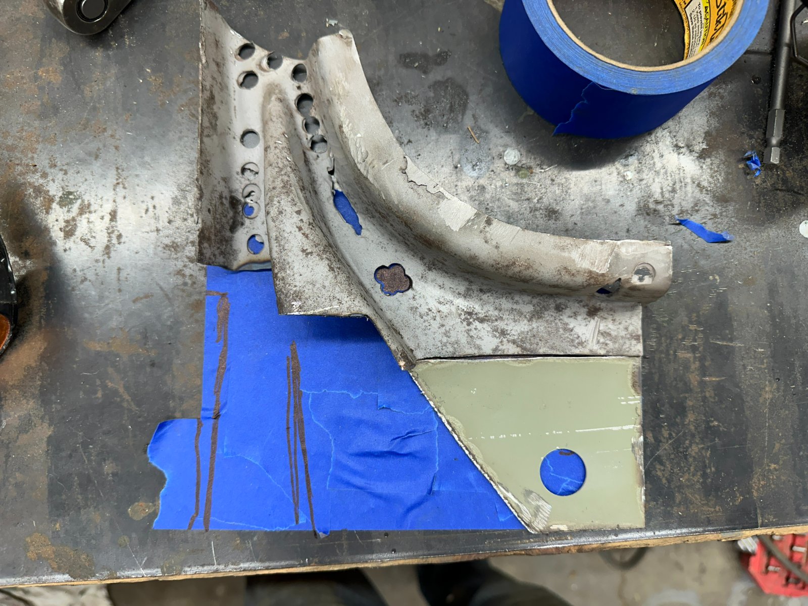

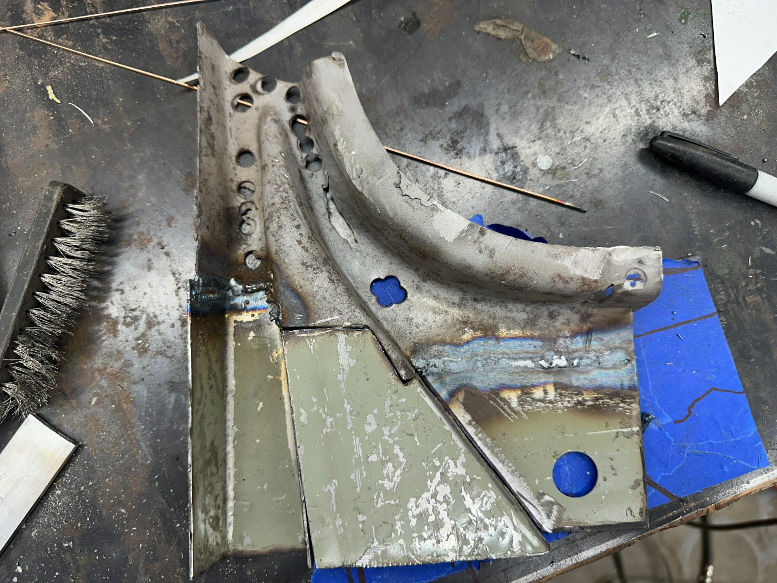

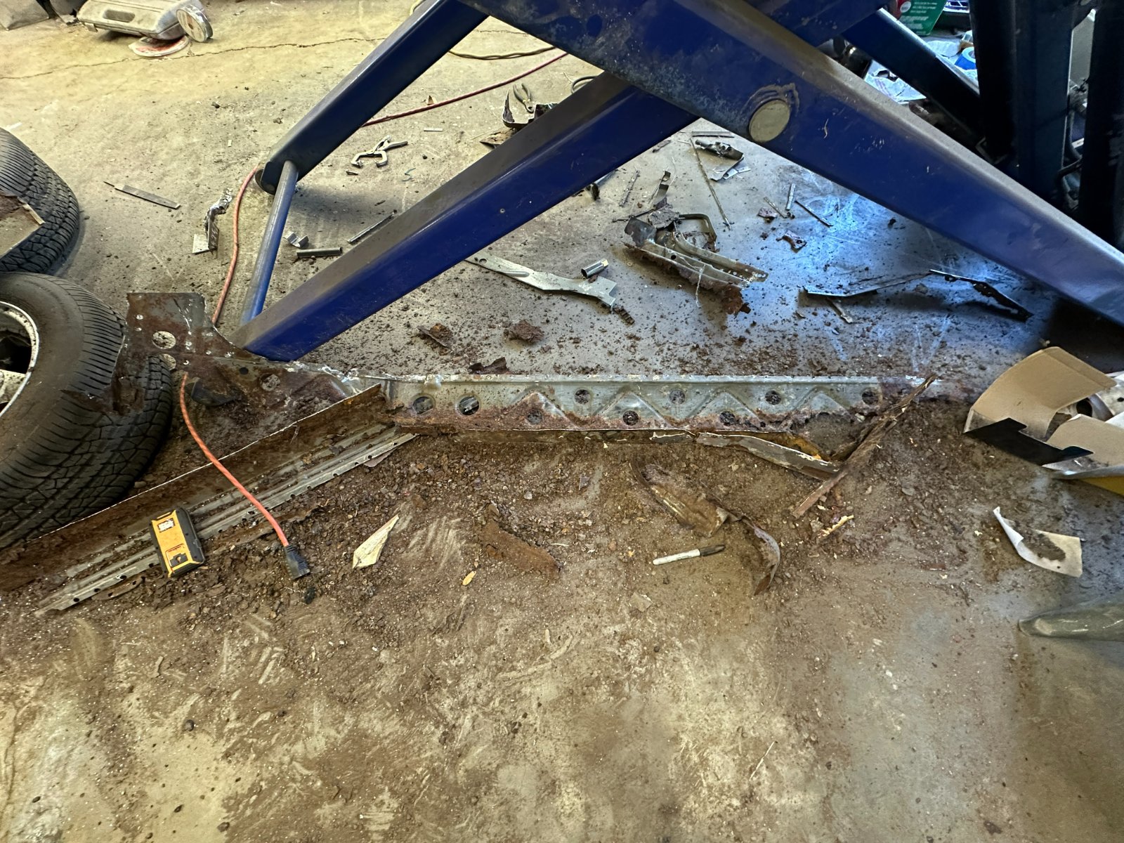

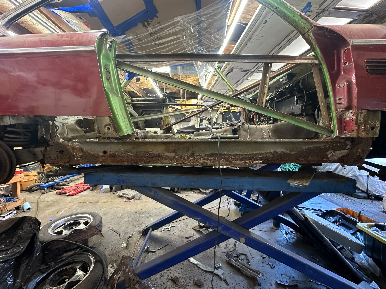

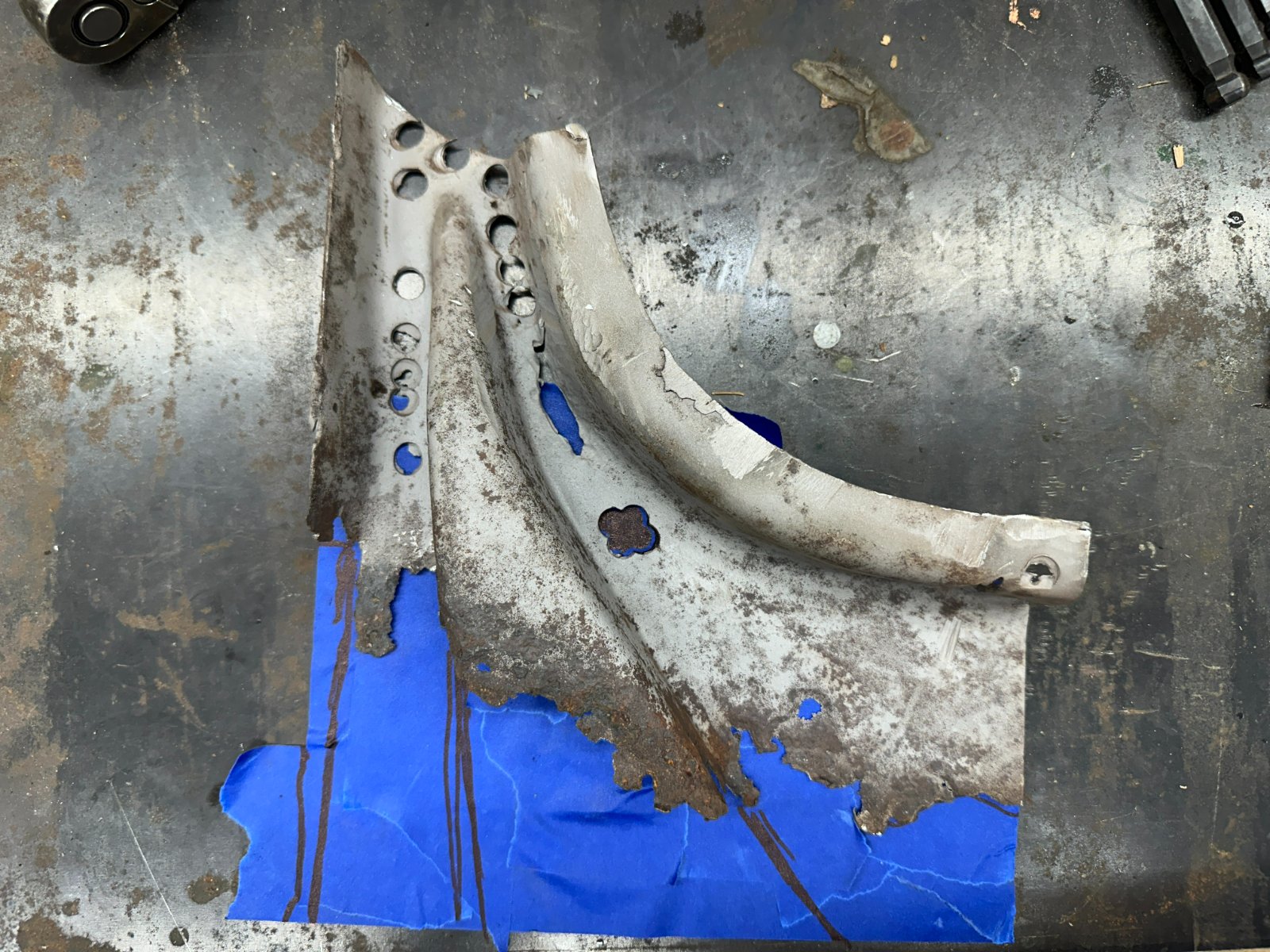

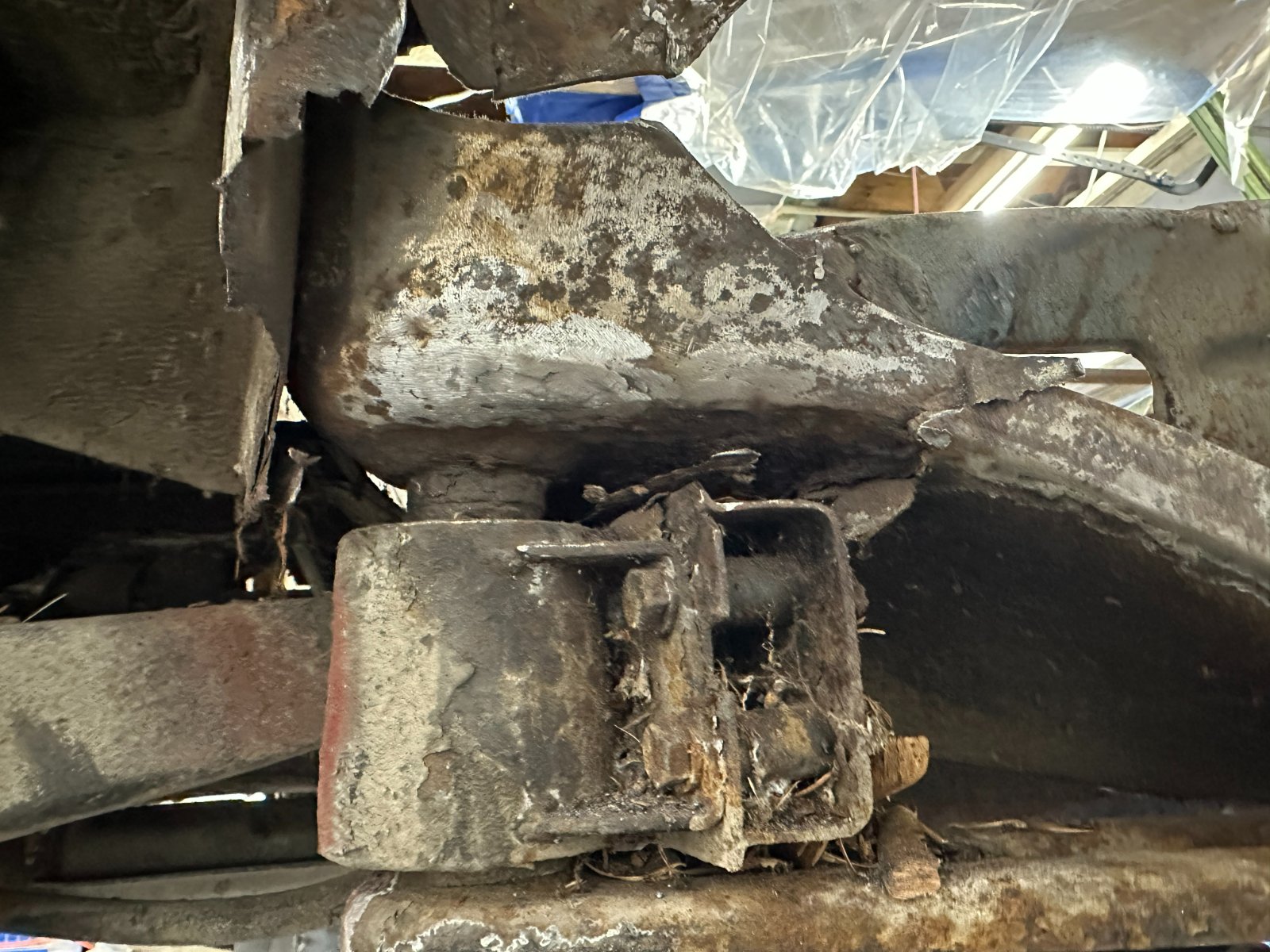

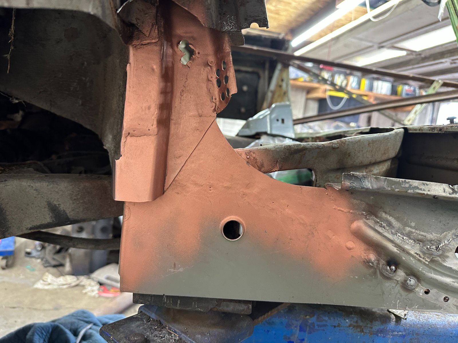

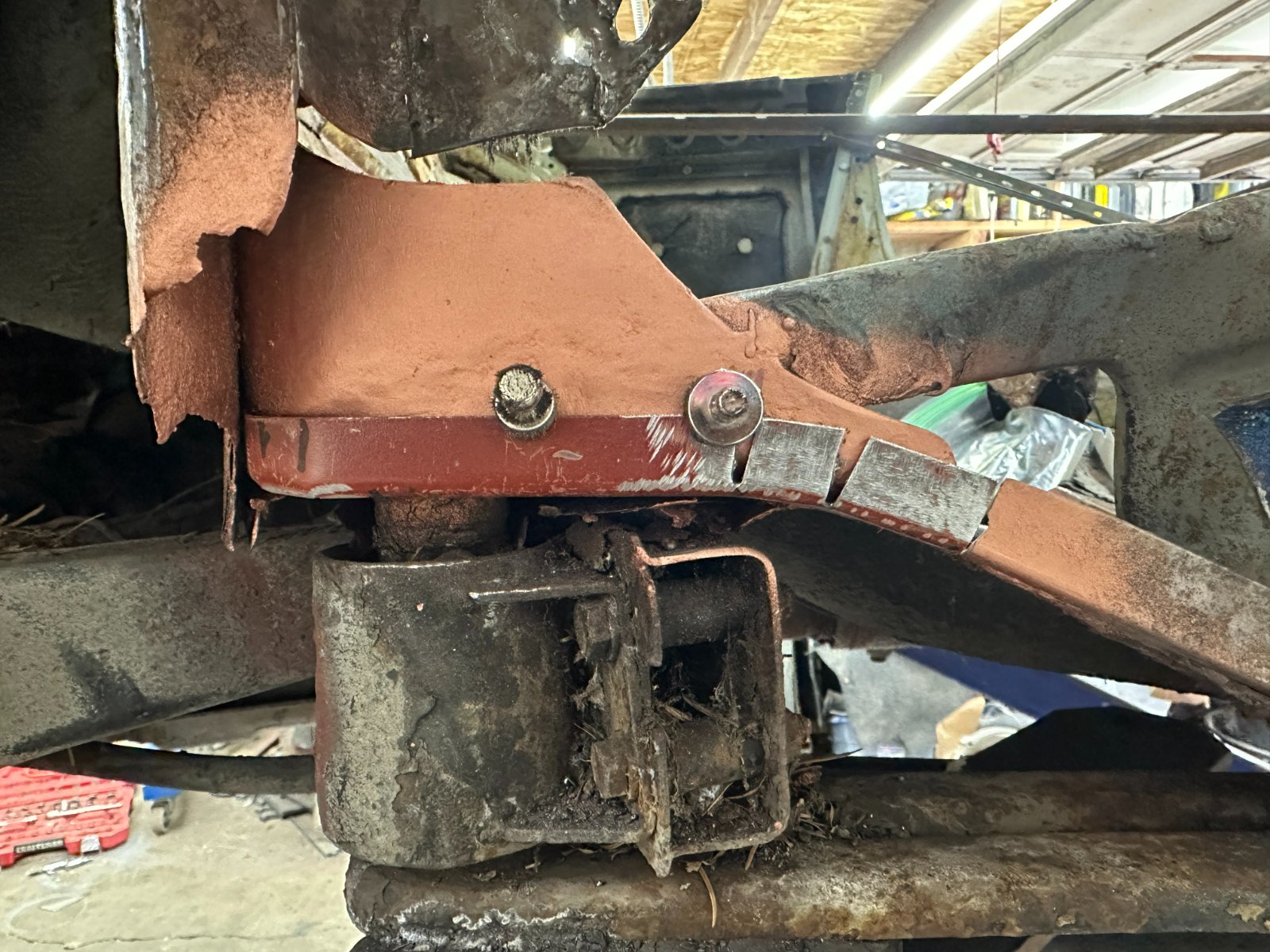

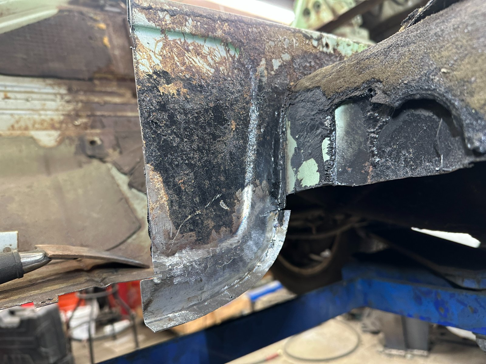

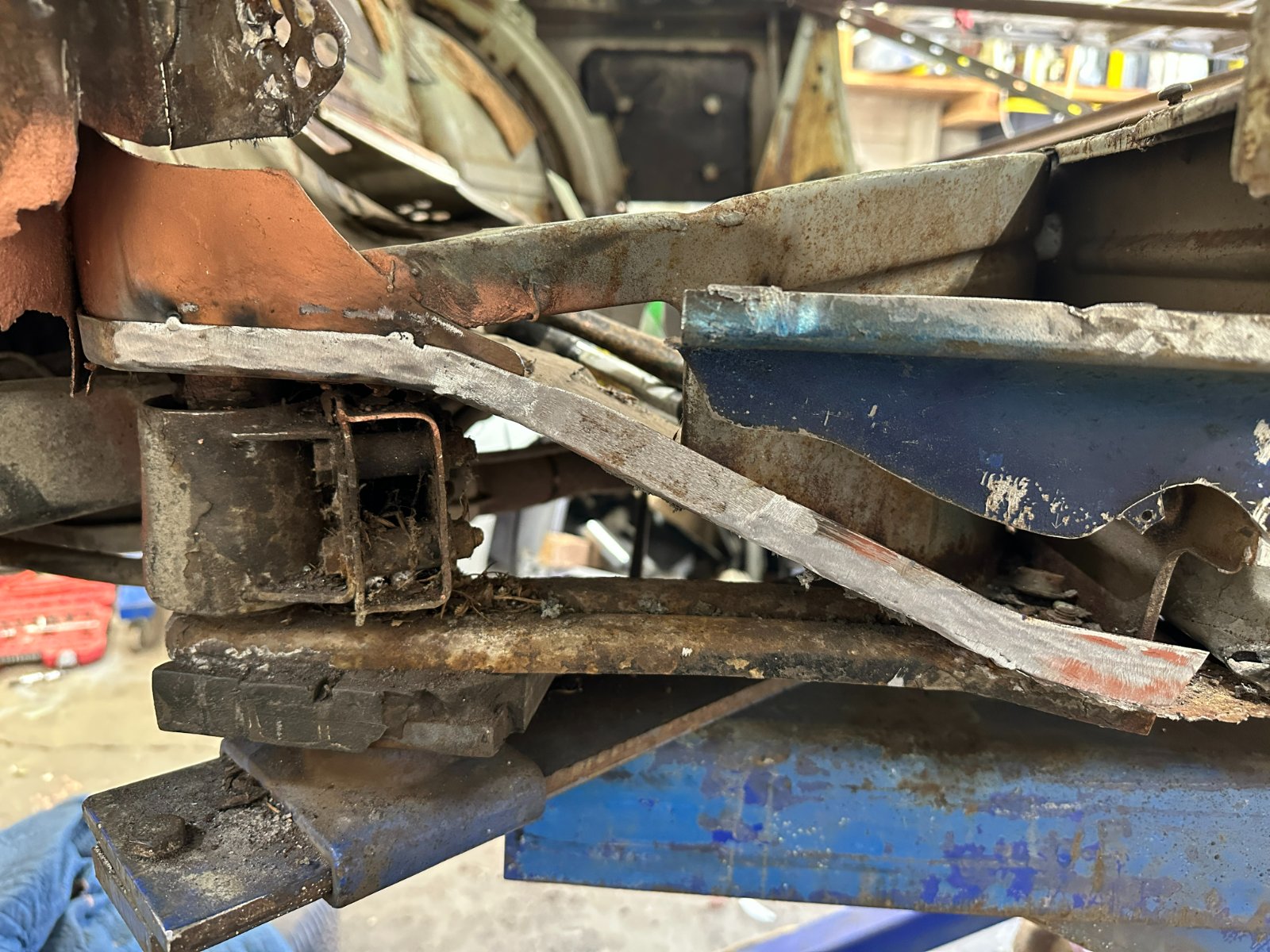

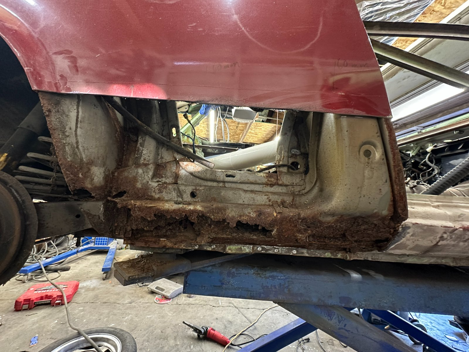

Moving right along, I've got the passenger side rocker fully stripped down now. It's definitely worse than the driver's side was, but not enough to matter given that the corrosion doesn't extend beyond what I have replacement metal for.

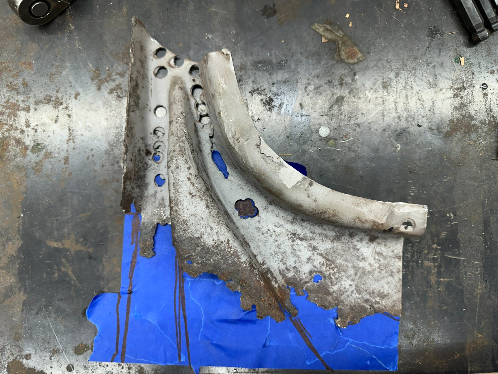

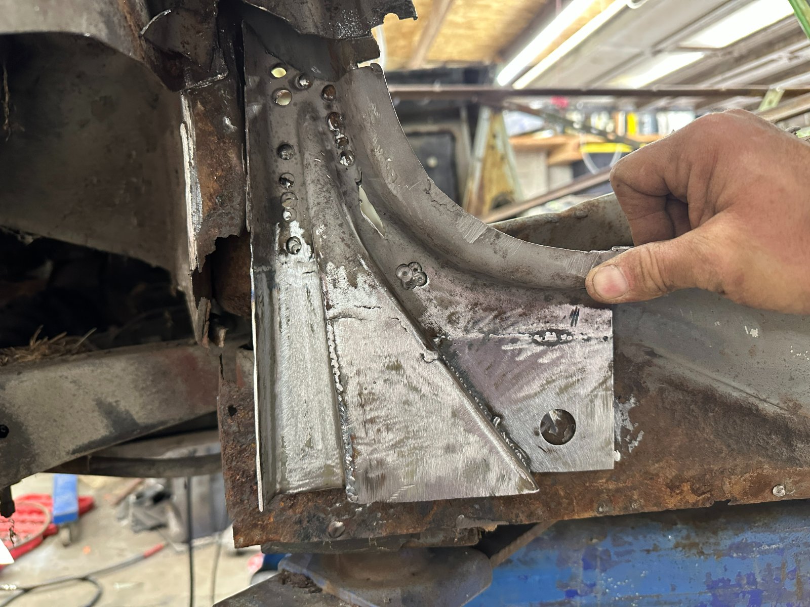

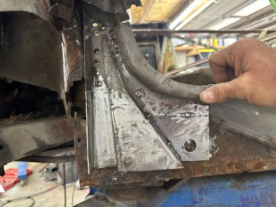

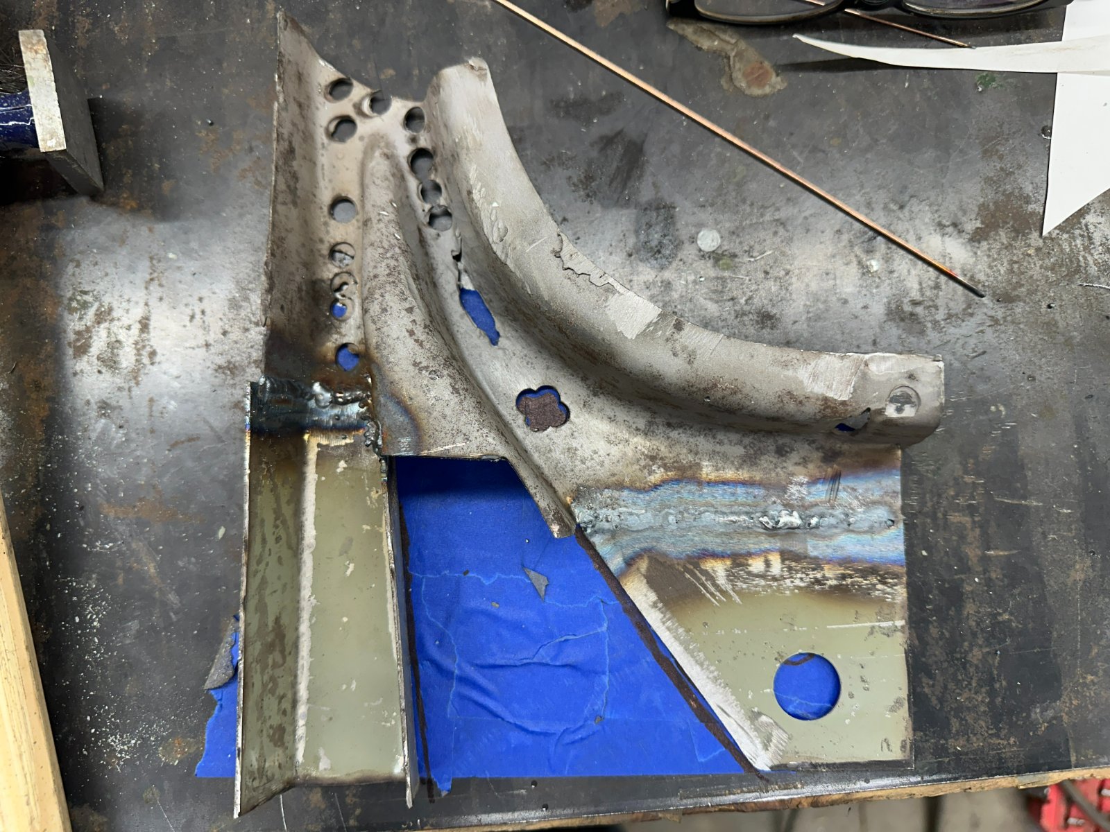

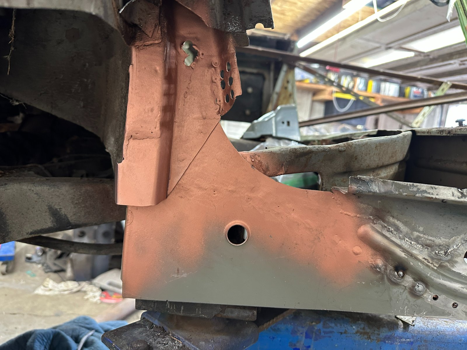

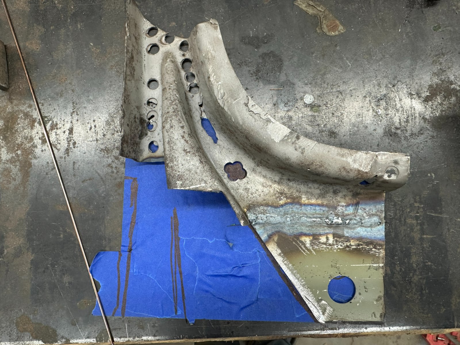

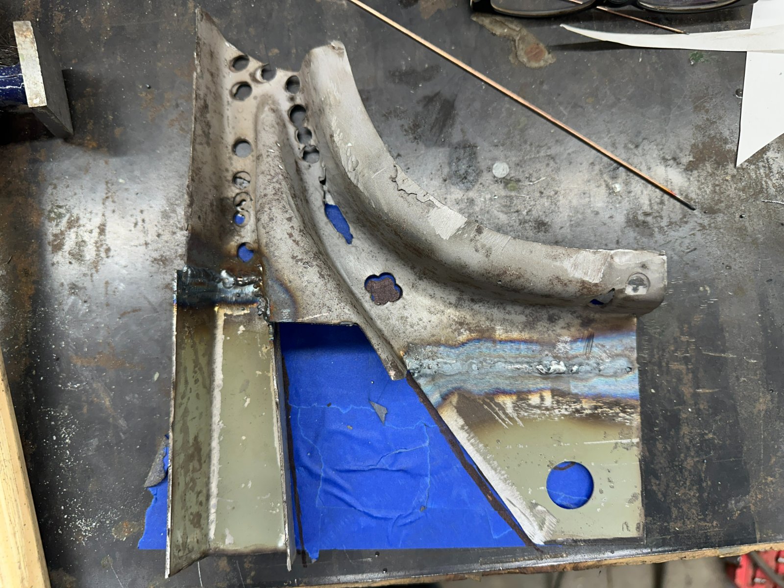

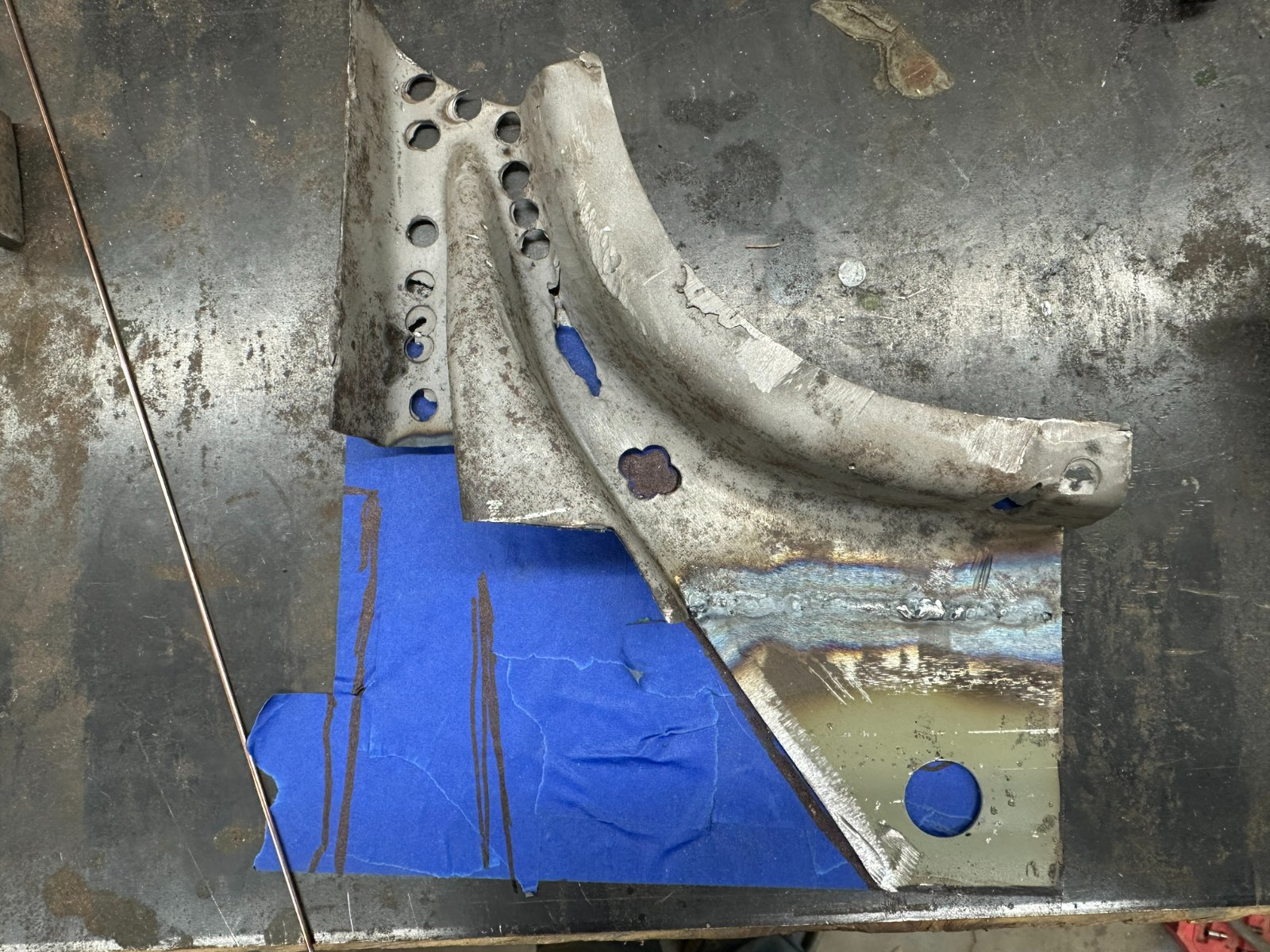

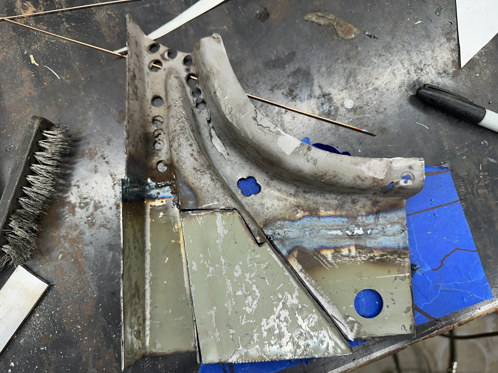

Today I rebuilt the triangular brace piece that sits behind the intermediate rocker. I used leftover metal from the driver's side inner rocker as it's the same thickness. This piece was significantly worse off than its driver's side counterpart, but there was enough left to figure things out pretty easily along with a tape template. I'm practicing my tig welding where I can on parts like this, but this was at best a 50/50 mix of mig and tig. The large hole is just a relic of the inner rocker I used for this metal; it'll become a jumbo plug weld eventually.
Next step will be to fit up the portion of the new inner rocker I'll be using (probably about 80% of it on this side) and get that welded in, then there'll be a few more things that need to be fabbed up in that rearmost area before I'm ready to fit the intermediate rocker and the a/b pillar supports.

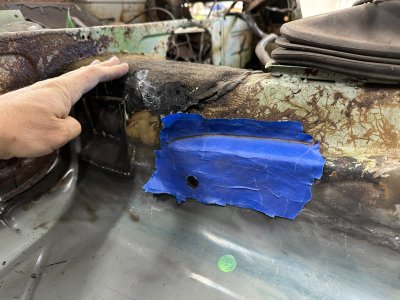

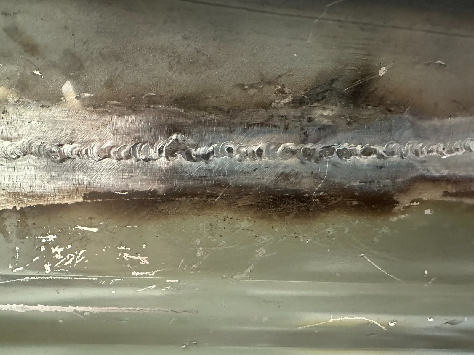

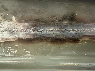

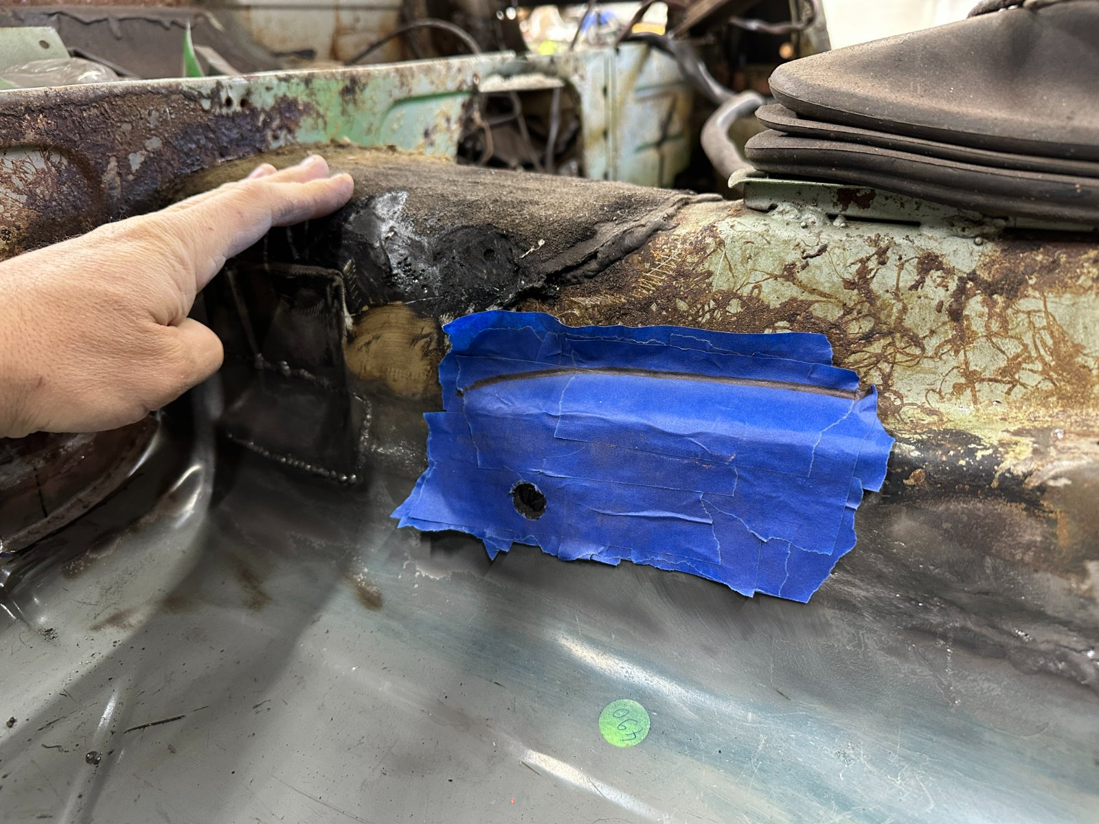

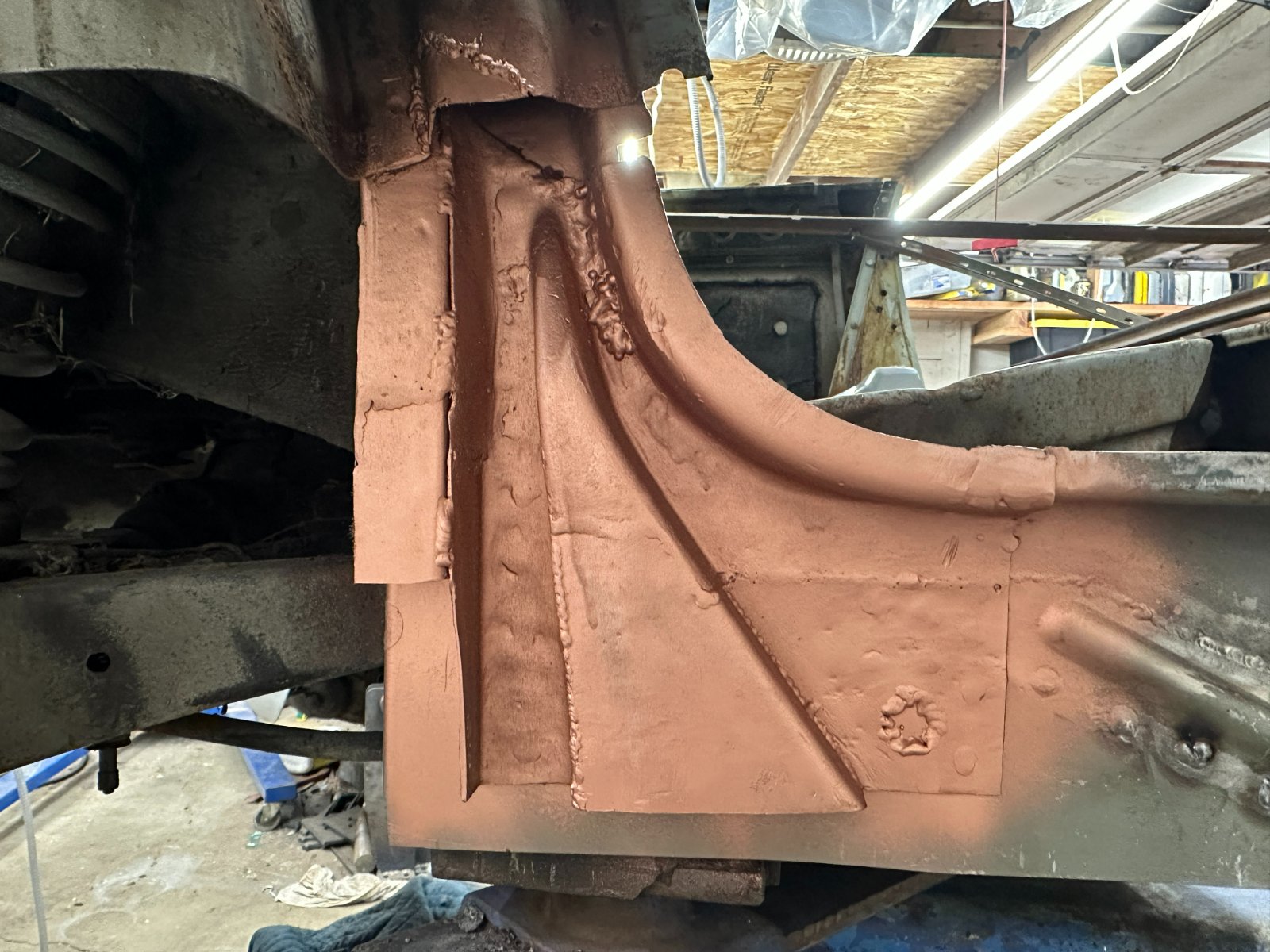

Some progress... I've finally finished reconstructing the inner rocker. The rust was quite a bit worse on this side. After removing the rusted portion of the inner rocker, I found that I also needed to rebuild the flange on the floor section that surrounds the subframe mount. Up front, I sectioned in a repair panel behind the a-pillar support, and reconstructed part of the flange on the pillar.
I sectioned in the large inner rocker patch using a method I've seen Ryan Kraws of Crucible Coachworks use on youtube, which involves cleco-ing the patch on top of the existing metal, scribing a line around it, and cutting out everything EXCEPT tabs that surround the cleco holes. Then you can cleco the patch back in and tack weld in between the tabs while squeezing the panels flush, remove the clecos, cut the tabs with an air saw, and proceed from there. This is an effective method if you're going to TIG the panels together because it allows you to fit things up with a very narrow gap.
I had intended to do this with my inner rocker patches on the driver's side, but my TIG torch broke just before I got to work on that. I've gotten a new torch in the interim so I was able to use it on this side. It went really well for the most part. I'm still learning TIG but this was a really long section of weld and most of it came out pretty nice and with great penetration.

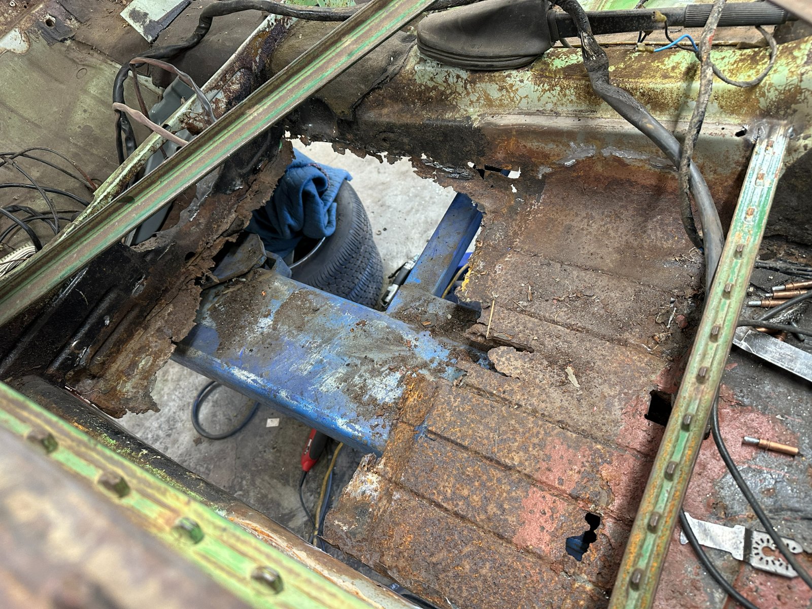

On this side I've decided to tackle the floors before completely rebuilding the sill. They're in much worse shape than the driver's side and I think it makes more sense to do it in a way that will allow me to use the spot welder on the floor-to-inner-rocker flanges. That means I'll need to remove the seat support, which is next on my list of things to do.

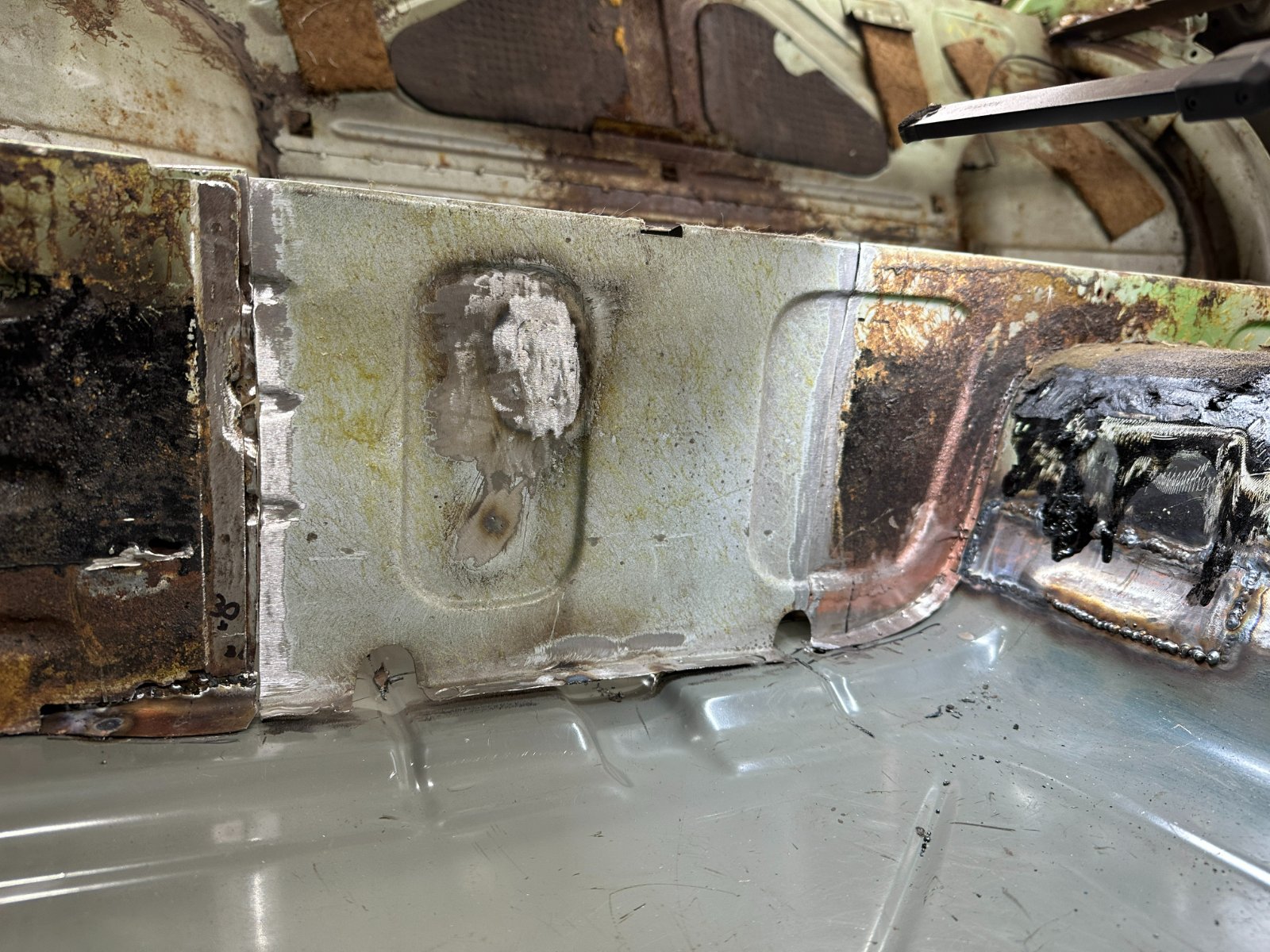

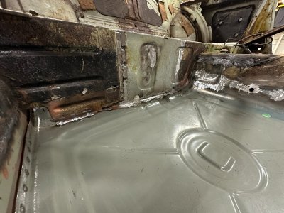

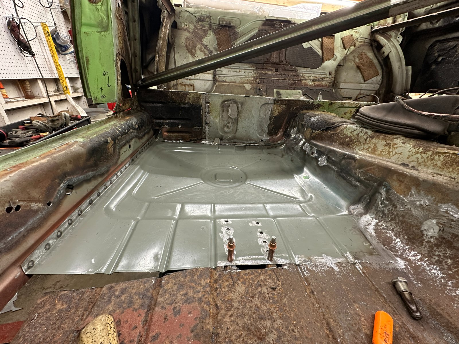

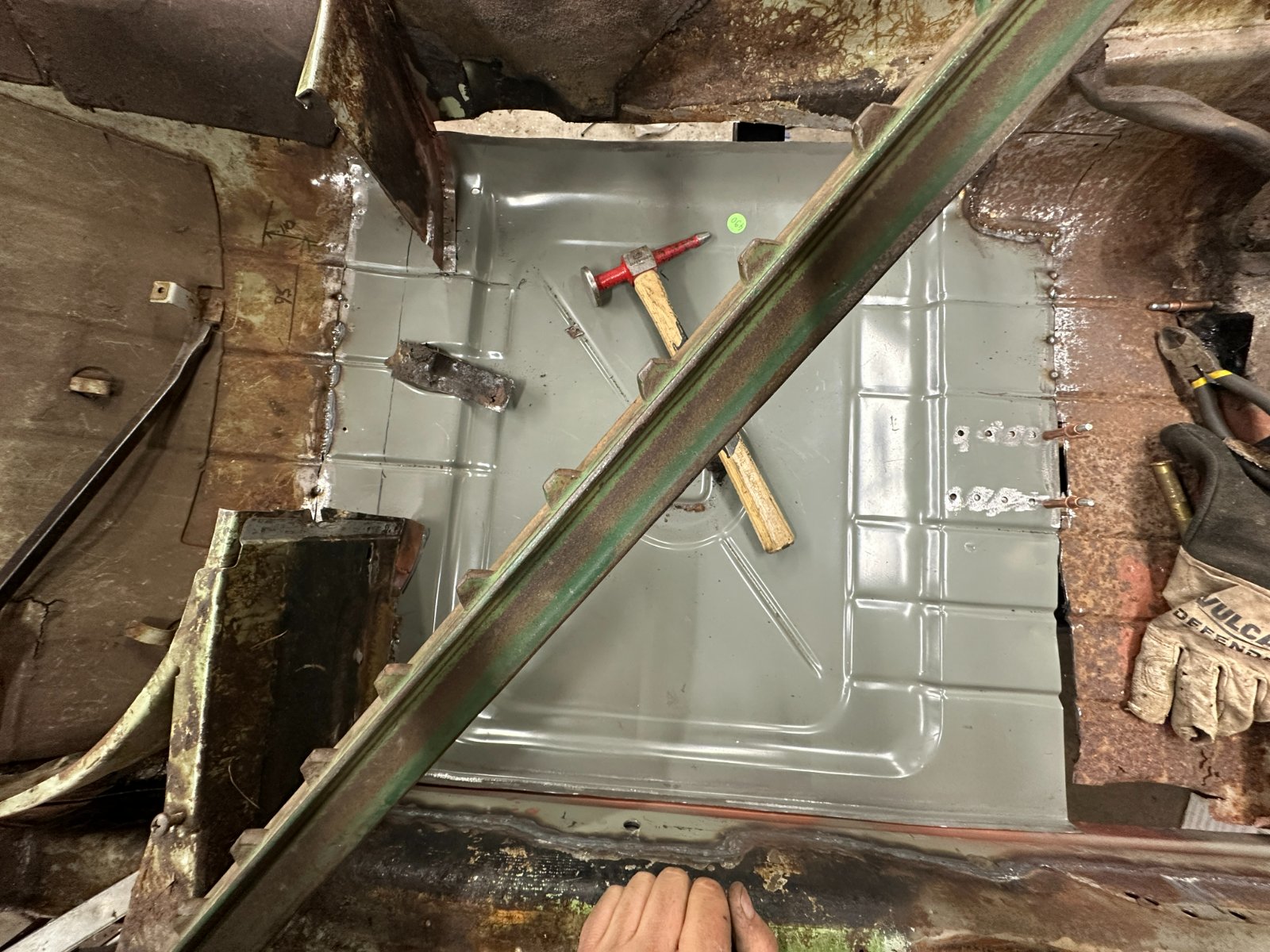

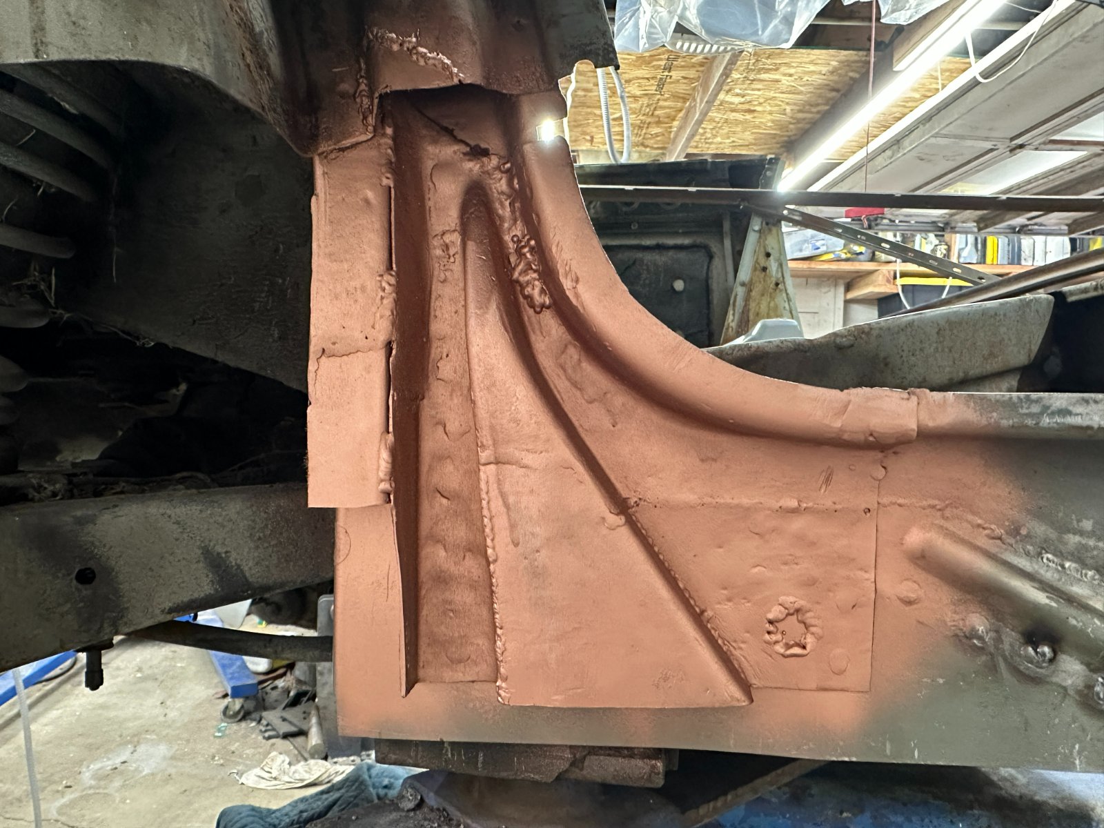

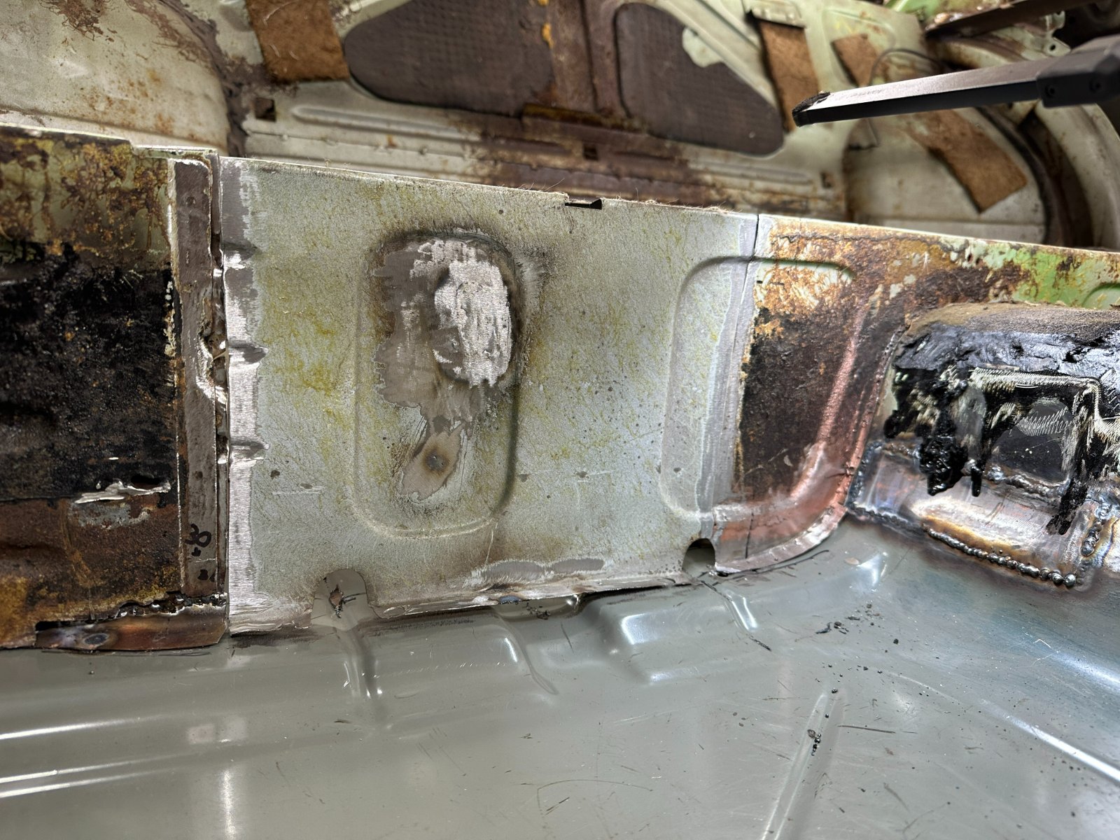

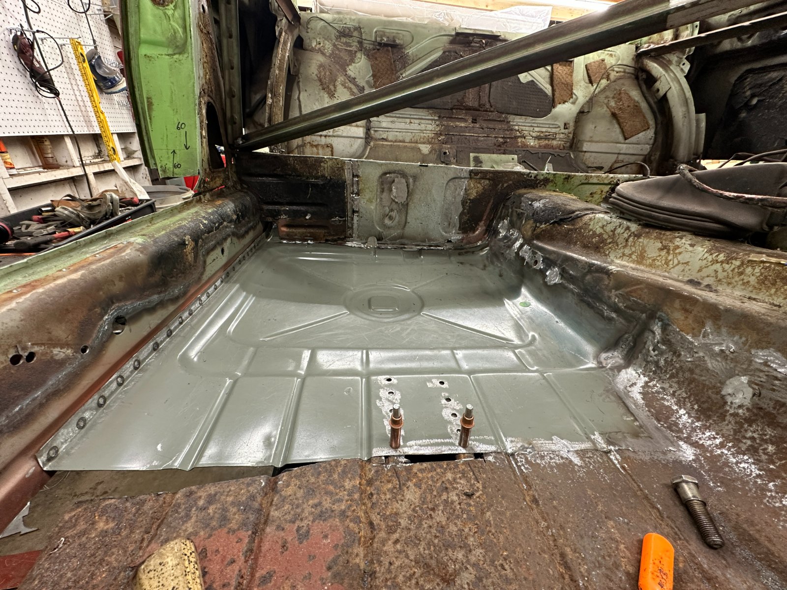

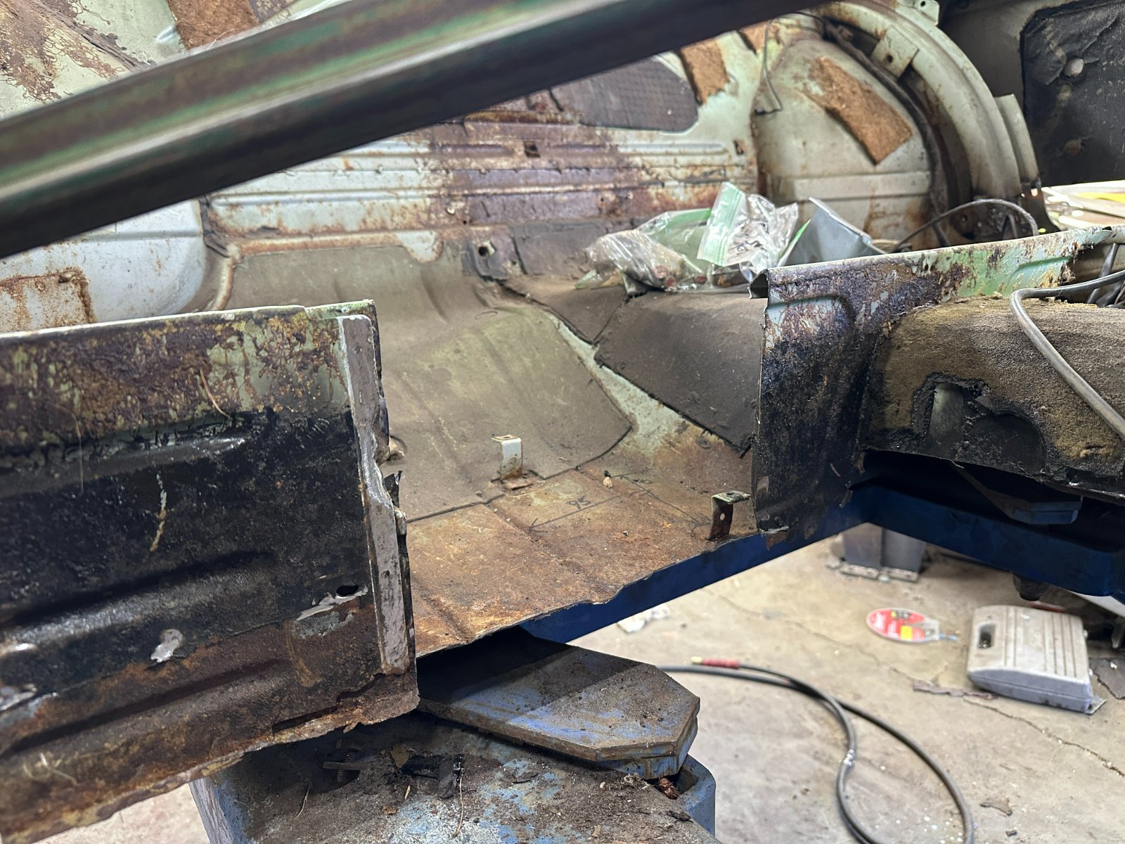

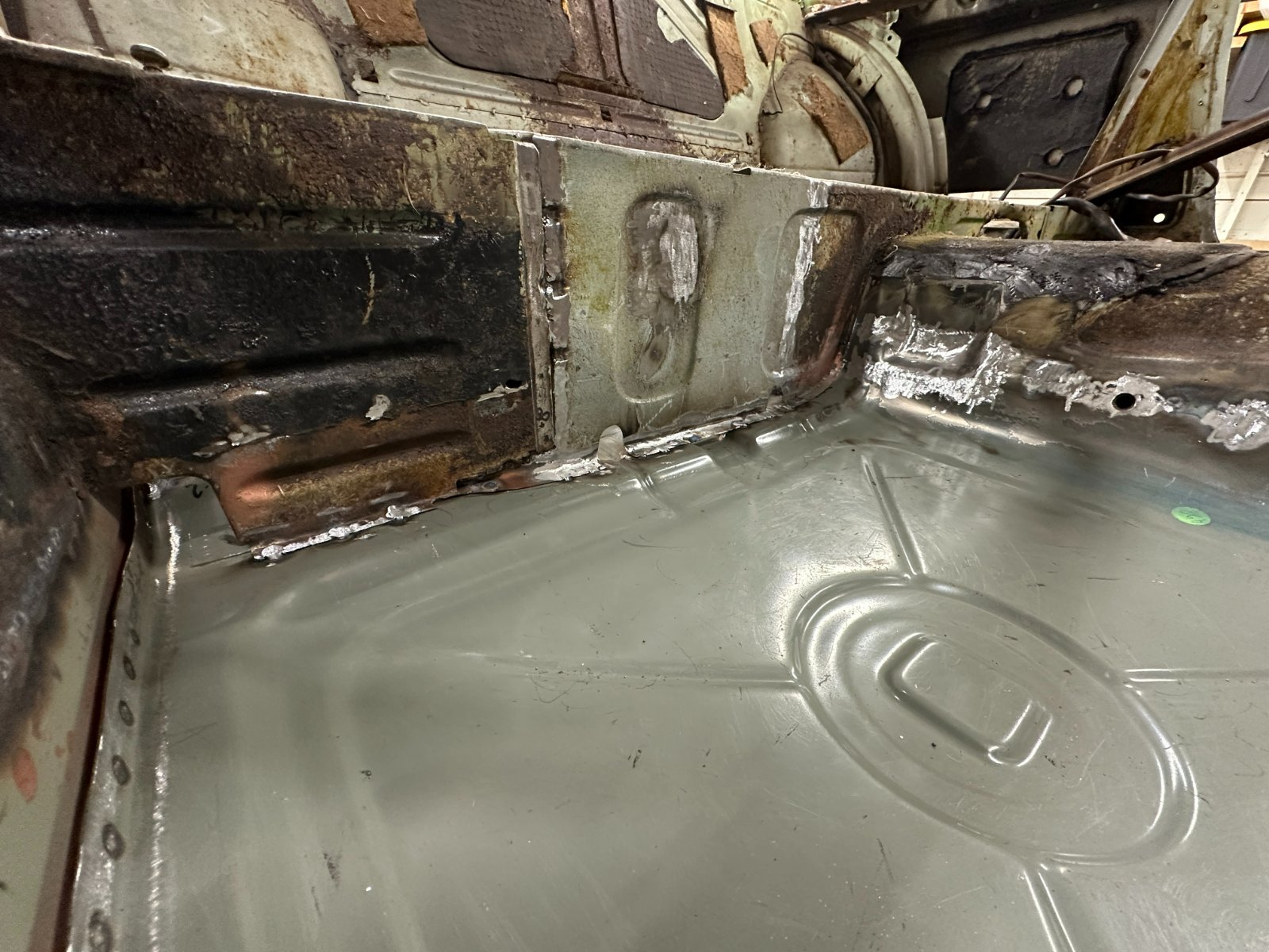

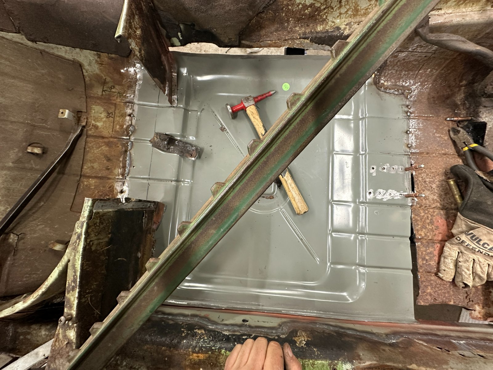

I'm more or less done with the rear passenger floor now. It was pretty involved... After removing the seat support, I had remove enough rusty metal in the tunnel that the gap extended higher than the new sheet metal and eliminated both the seat belt anchor and the lower third of the rectangular stamping at the rear of the tunnel. I also cut out the center of the rear seat support piece to eliminate one of the truly awful speaker holes that were made on both sides, which literally seems to have been made with an air chisel.
I patched up the speaker hole with a piece I'd saved from the e12 I parted out, hammer-formed a replacement for the part of the rectangular stamping that was lost, and patched the remaining gap with a strip of sheet metal. Before disassembly I'd made a tape pattern of where the seat belt anchor hole was, so I was able to recreate that and weld in the boss from underneath. The last step was to drag the spot welder over (thankfully it just barely fits on this side of the car) and finish up the floorpan.

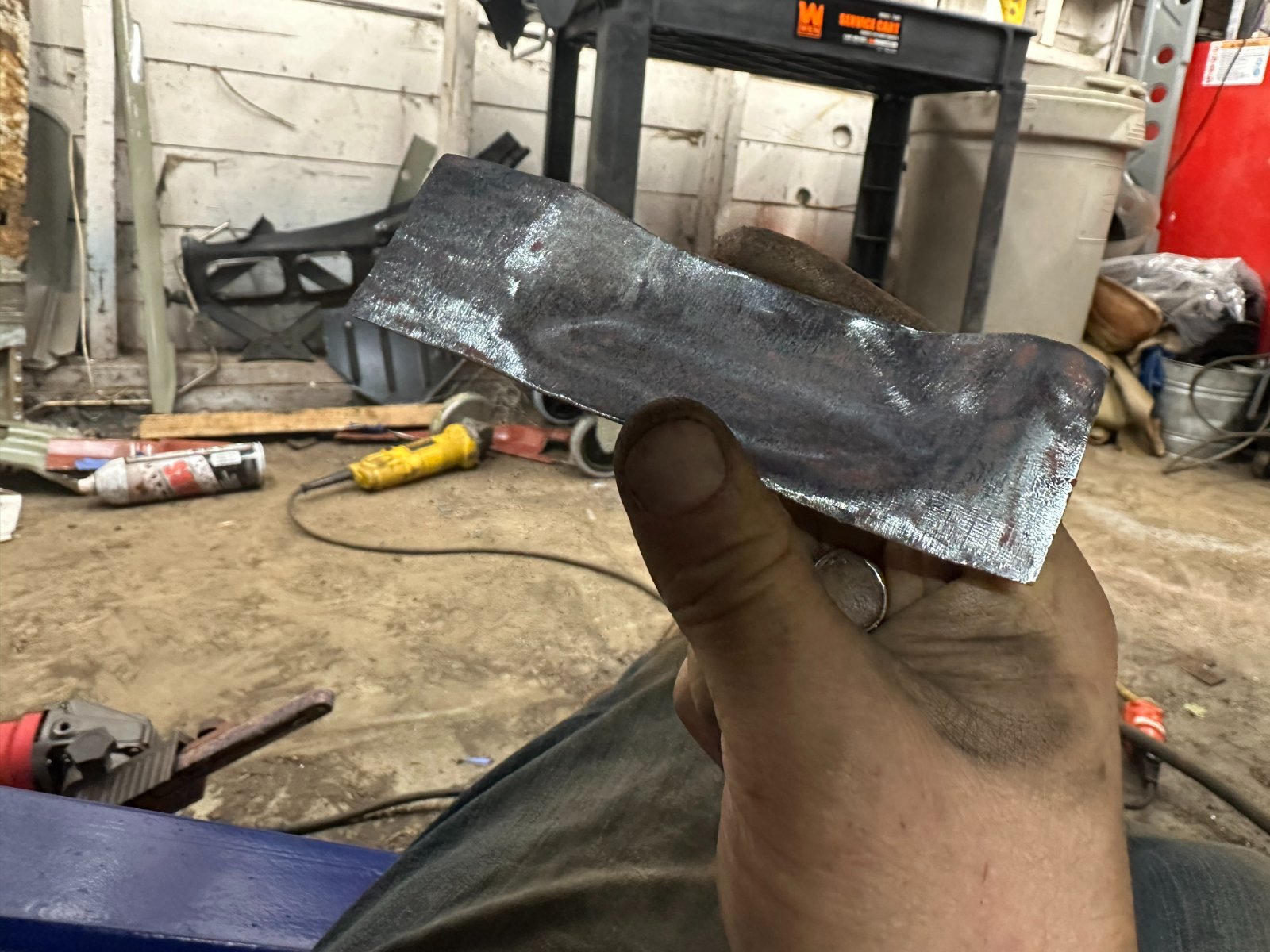

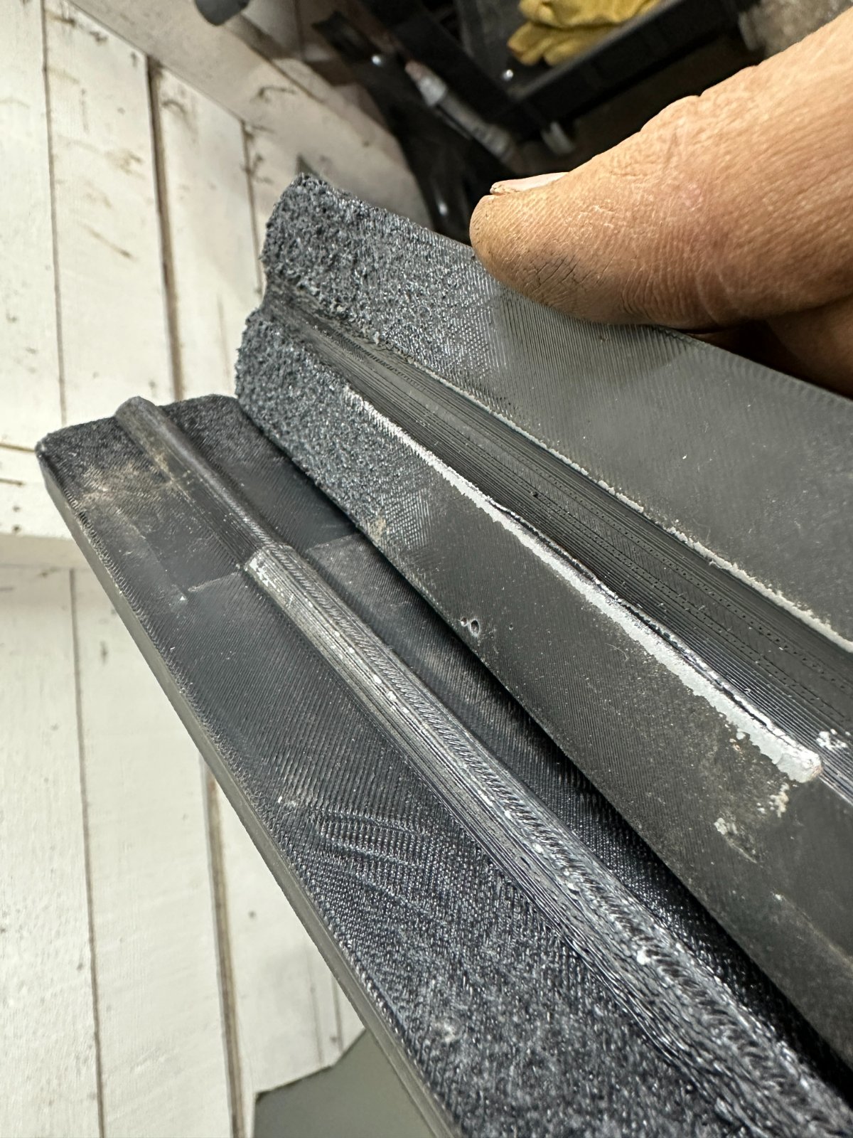

The next step will be the front floor, and I've been experimenting with how to create the strengthening ribs that are absent in the WN part. I don't have a bead roller, so I tried designing and 3D printing (at 100% fill) positive and negative dies. On a test piece this worked surprisingly well using my 12 ton press!

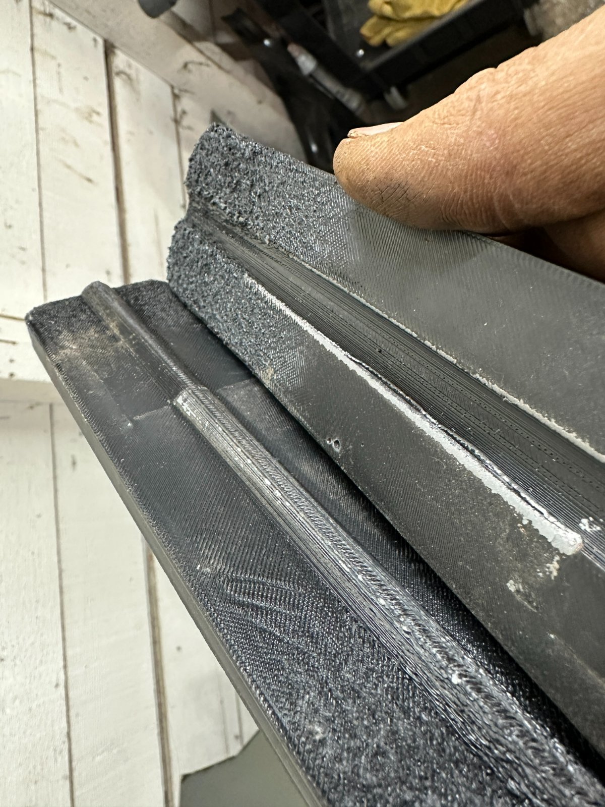

My 3D printed press dies worked really well, but introduce significant warping in the panel when used. I've since gotten an english wheel so I can pre-stretch the metal before doing that again, but for the driver's floorpan I had to improvise and ended up cutting it into sections, pressing the features, and then welding the sections back together. In addition to the dies for the ribs, I made some for the two features / holes that lead into the frame rail and the d-jet wiring harness.
