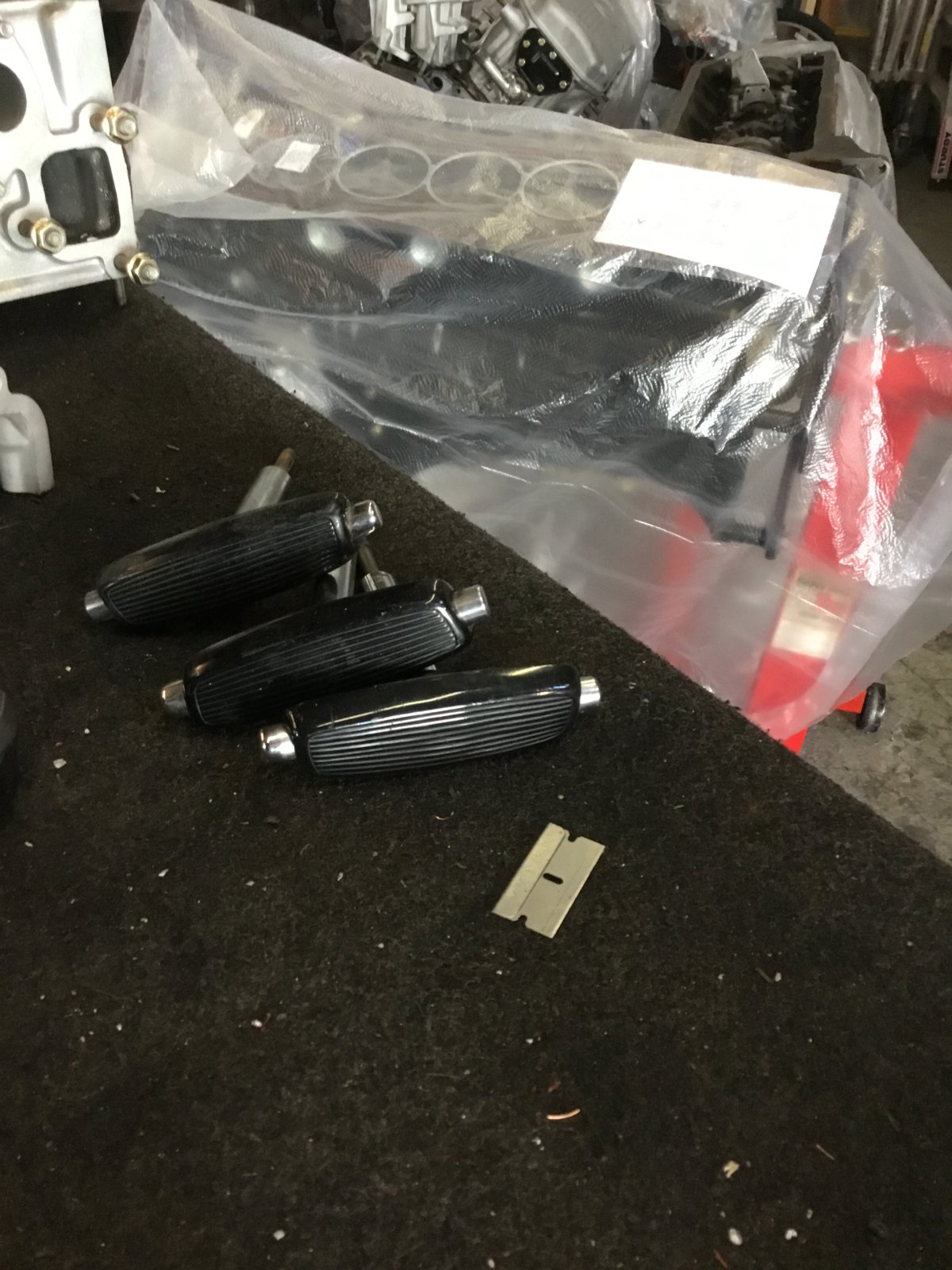

Not easy to install, just did this on a 2002. Looks straight forward but not quite, need to loosen bottom of shaft first and also remove button from driver side. It’s in the Blue Books.
