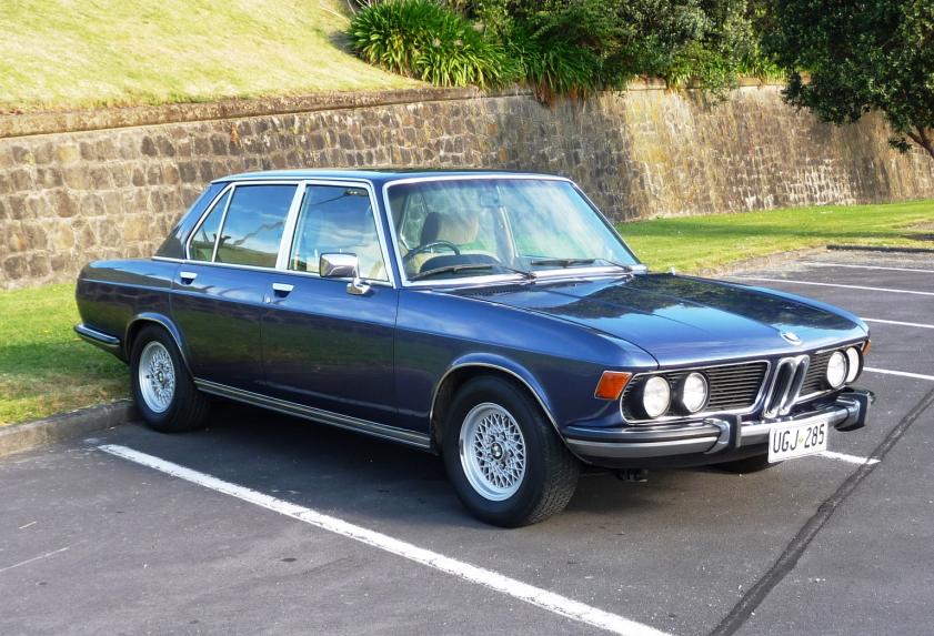

My opinion is it looks clean, but also kind of barren without the trims.
My blue 3.0Si is a case in point.
