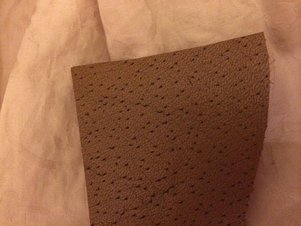

I need to recover the front seats on my coupe.
Looked at World and GAHH and they have nothing that matches the original tan pigskin?
Anyone have any luck sourcing through suppliers or upholsterer?

you are correct, they don't come close to matching. the GAHH colors are terrible, but the leather is nicer than World. World's color was better, but the leather is just ok as the color is. unfortunately KHM doesn't have seat kits for the e9.
its tough ...

I am no leather expert but I believe that the original leather is pigskin and that the small depressions/holes are remnants of the hair follicles. The holes are only seen on one side and do not go all the way through the skin unlike mechanical perforations made by a machine.

Yes... Pigskin leather was used for the 2800CS. Traditional calf leather was introduced at the beginning of production for the 3.0CS I believe. Practically all original 2800s had the "follicle dimpled" pigskin hides.

the removal of the hair from the hide doesn't always result in seeing the pores in the finished leather. it depends on the finishing of the hide after tanning as to what you see. it also depends if the leather is full grain or top grain. often, the exposed texture of leather is embossed to give you the texture that you see. different parts of a given hide can naturally have a different texture
the texture can be large, medium or small ... it can be heavy, light or smooth. the finish can have a sheen or a satin or flat finish.
i don't think calf skin was really used on the e9 ... the hides average 15 sf, and don't forget that that includes the unusable leg portions of the hide. calfskin is very soft + supple. calfskin is also a whole different pricepoint than your nice cowhide leather. whether or not they used pigskin is an unknown to me. my comment is don't confuse the presence of texture as pigskin ... just as don't correlate smooth with calfskin.
Chris, sorry I don't have any printed info to back up my beliefs. It's purely based on my casual observations throughout the years of studying various 2800cs interiors. Also, by reading various old publications on the 2800 coupes, many of these articles do referred to the unique texture of the pigskin hides. Cowhide leather was indeed used and not calf leather as I had mistakenly mentioned.
Most 2800CS leather interiors that I've seen do look like the pic as provided by Bez.

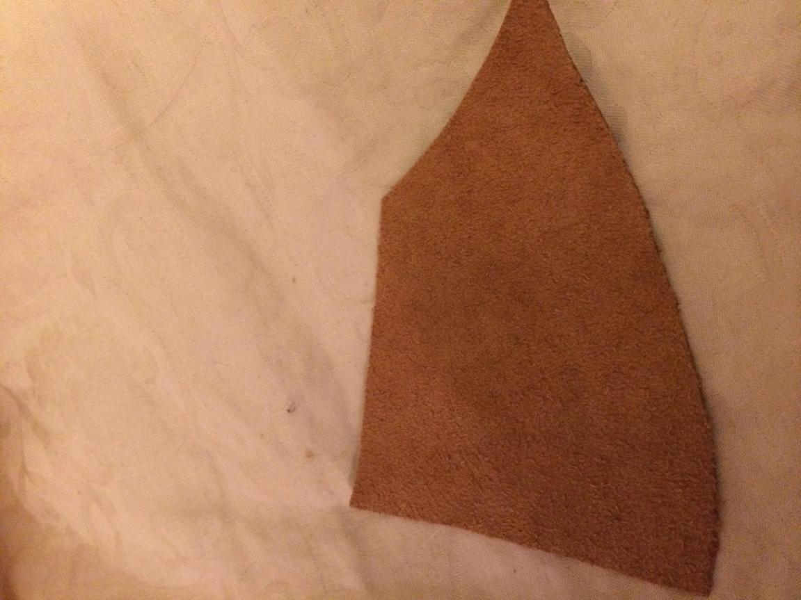

you might want to show the back side of the hide. does it really look different than cowhide?
Backside of leather
As you can see, the holes do not perforate the entire thickness of the hide
