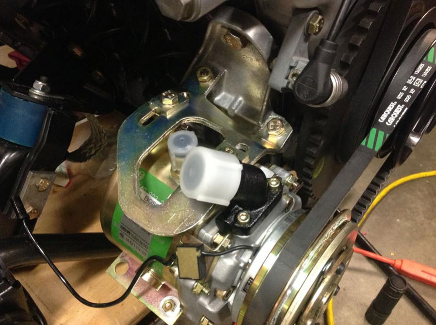

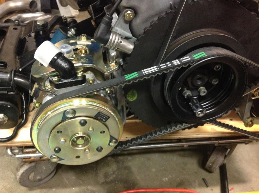

For further reference, here are photos of the "wing-cell" Bosch compressor just installed (round bottom ears and square top ears).
Sven, This is a different set up than the photo in Rob's post at the start of this thread. Why did you change? Do you mind sharing the cost of that new wing cell compressor? Is it from BMW? Thanks.
Luis,
I am still running the original set up on my coupe. This one is for a different coupe I am working on. We are doing a complete rebuild of the engine and suspension. We had intended on using the same set up, but when the compressor arrived with the square top ears, we changed directions and went with the appropriate brackets. The compressor was about $480 from BMW of Atlanta. It is a new Bosch unit (PN 64.52.1.374.558 ). The brackets I found used on ebay.

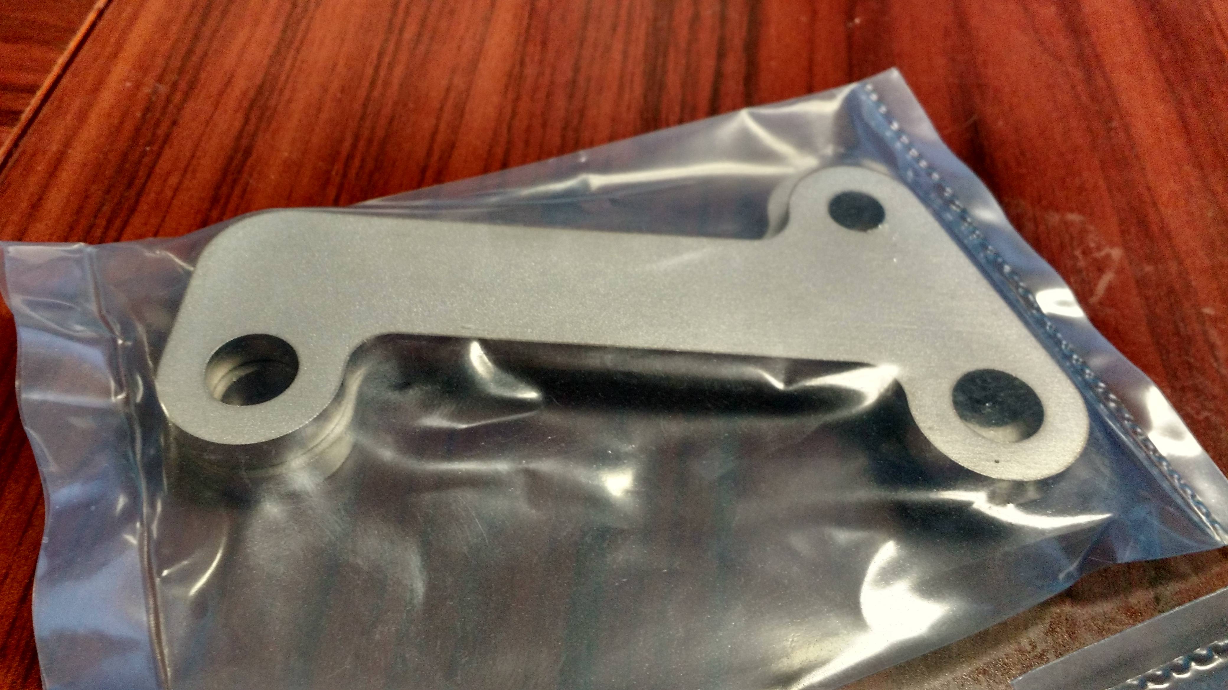

A solution!! Order-able adapters to fit a Sanden to the wing cell bracket!
Hey, folks, I was revisiting this issue and following some of the leads on myE28.com. If you read this thread:
http://www.mye28.com/viewtopic.php?f=3&t=126830&start=175
Youll see that a gentleman -- Will Nolan -- has adapter plates made in small batches that allow you to fit a Sanden to the standard E28 wing cell bracket.
I just swapped messages with Will, and while he says they're not exactly click-and-buy, he DOES sell them.
They're $50 shipped. He says you can e-mail him at [email protected].
I just ordered mine. Happy days!
