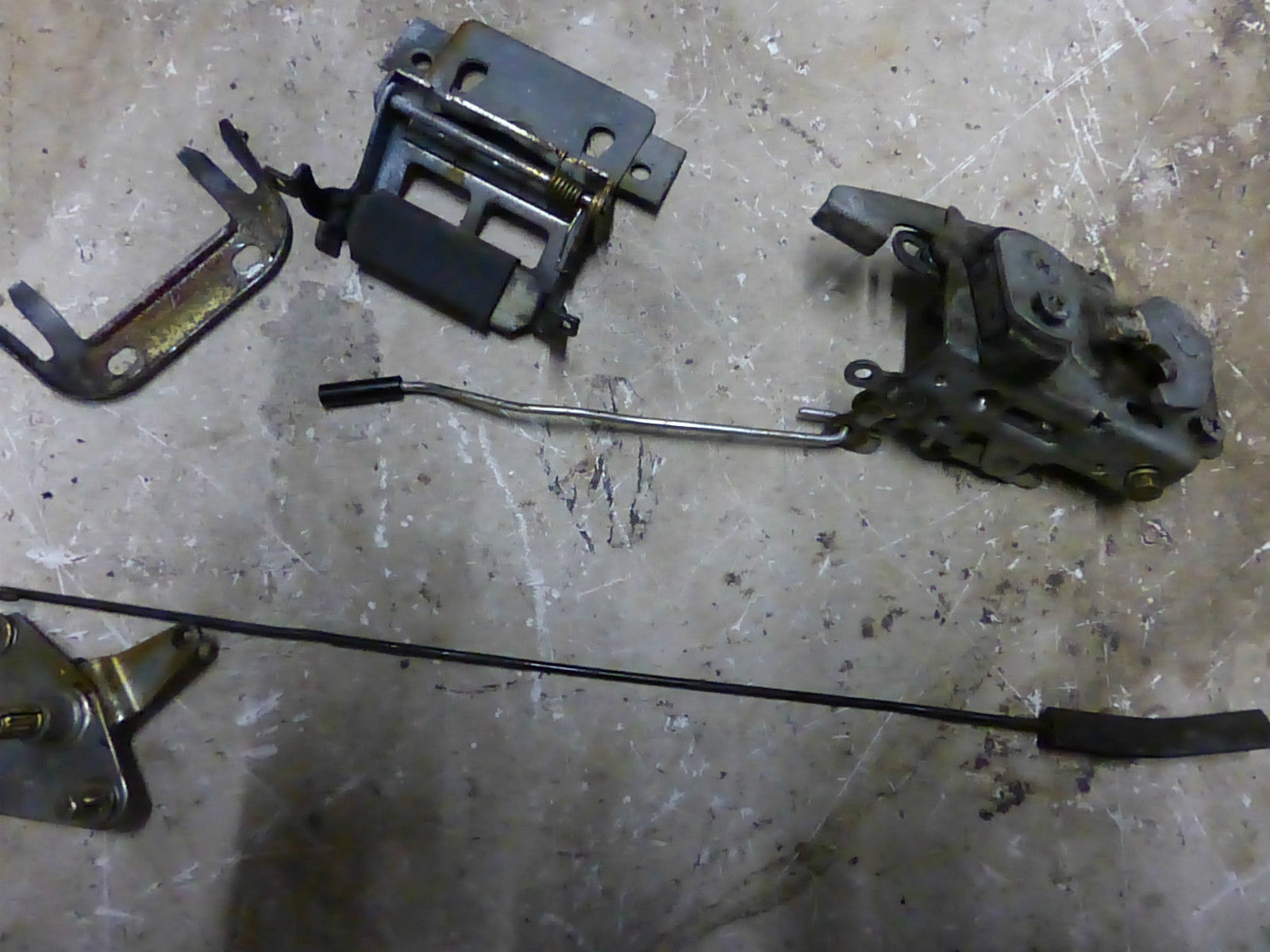

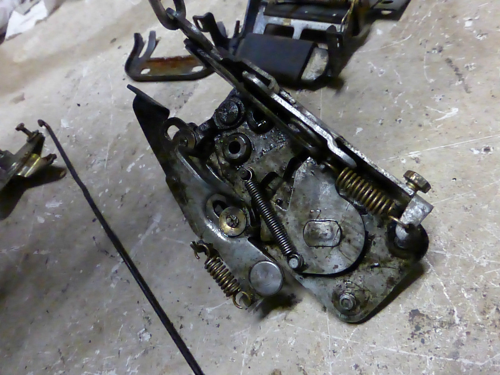

Wladek
1,321
811
Gdansk, POLAND
If the inside handle work it probably mean that the main locking mechanism is ok, something might be wrong with outside handle & it inner lever.

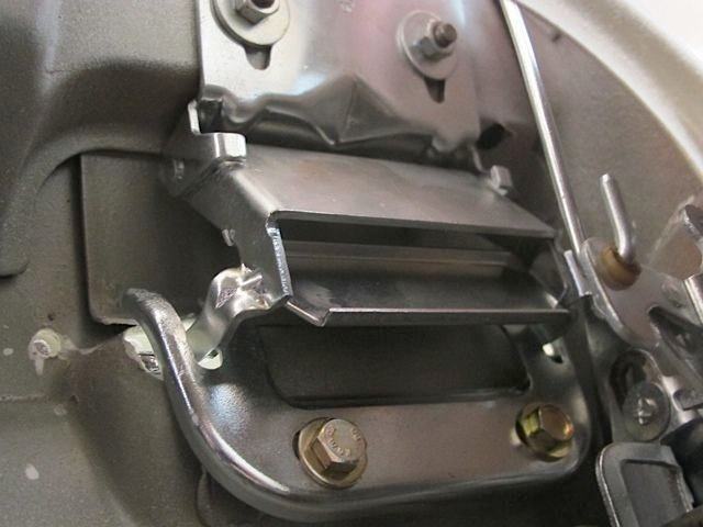

My lock mechanism has a bent plate that prevents the handle from closing. It is also very dry and needs lubrication. The lead counterweight was laying in the bottom of the door.
I am missing the cover that is held on by the 2 yellow machine bolts shown in @Wladek top photo above. His bottom pic shows the cover in the upper left.
Does anyone have an extra cover? I need it by Nov 9th. My car is in a big show on Nov 12 and I need to have the door completely assembled.
Please let me know--Thanks, Drew
