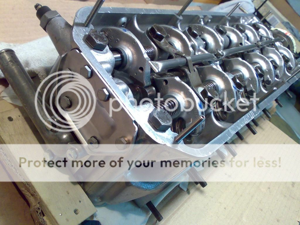

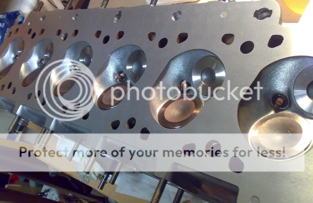

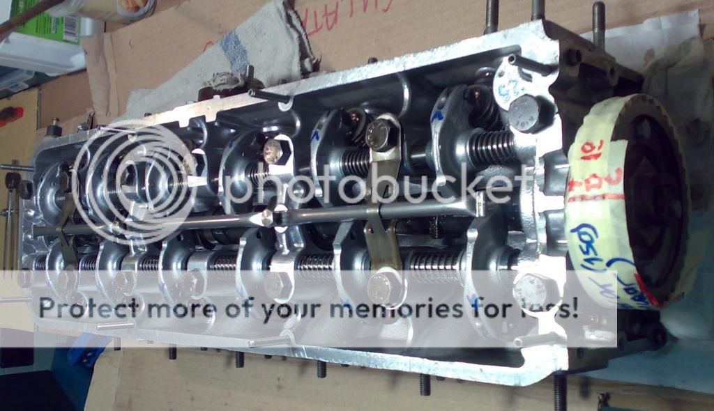

my experience, all prices in euro
a used +83 head from germany empty and not checked 300 + 60 shipping
clean, machine and test 150
new valve guides installed 200
new valves 600
new shafts 200
new gaskets 20
new seals 24
new adjustment bits, including eccentric wheels, bolts, nuts, springs, washers,...170
assembly, self job
this is it:
