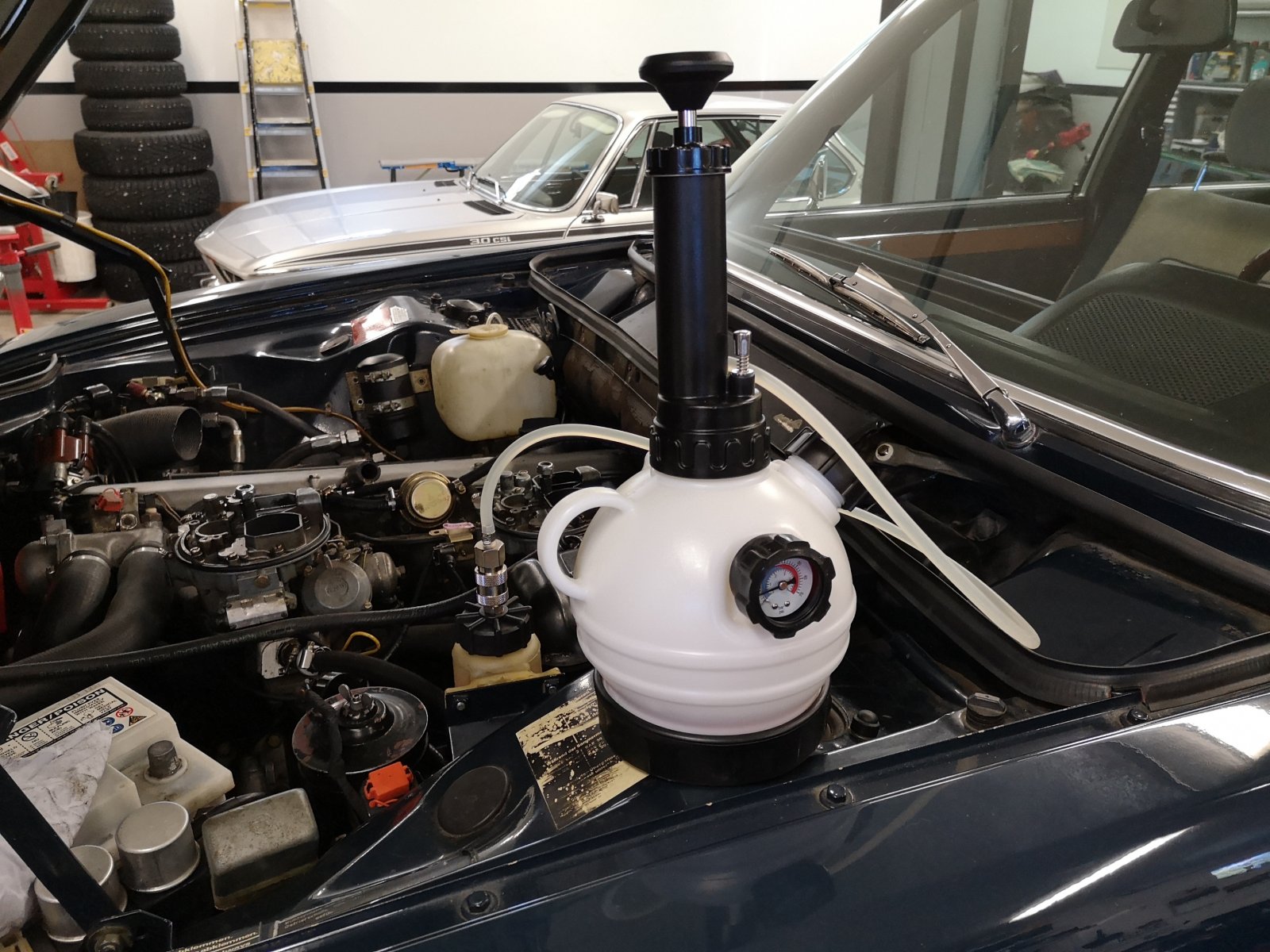

I always resort back to the old fashion 2 person manual brake pump and bleed to get the best brake feel even after using the one person methods (vacuum or pressure).

For about 20 years, I've used a pressure bleeder. I apply about 10-15 psi pressure to the master cylinder reservoir, then proceed with standard bleeding. I check reservoir level after each corner, removing pressure and refilling reservoir to maximum mark, then re-apply the pressure. Never had to bleed more than once, and no 'assistant' needed.

Absolutely agree, tried one once and after that I just had to buy one (they're relatively cheap). I have the version that you can put about 1L of brake fluid into, then apply pressure and then you can bleed out alot before refilling. Works perfect when you're alone in the garage and so far I've never had to re-bleed afterwards, and no brake pedal pumping needed. Highly recommended.

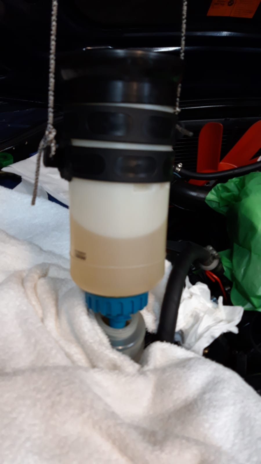

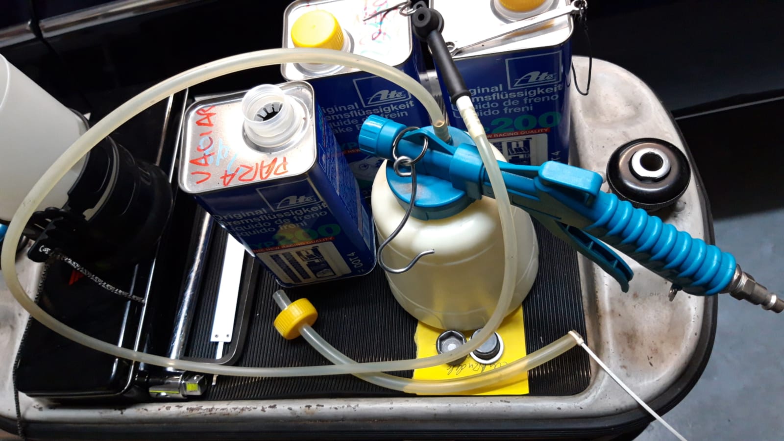

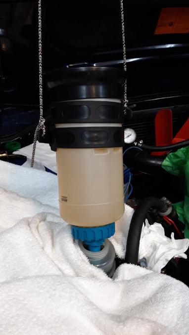

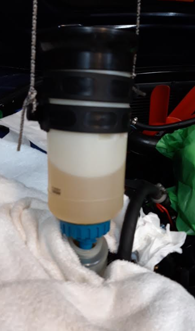

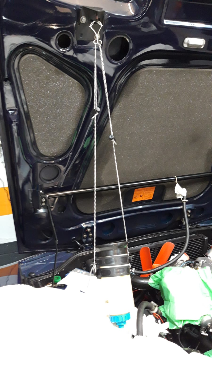

i really do not understand why so much fuss;
this system is perfect and very clean
understand only drawback might be that you need an air compressor

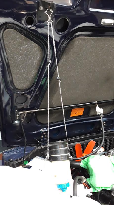

this big bottle has a harness to be able to hang it from hood elements, juts to place it vertically with the tip inside the brake fluid reservoir
you fill the bottle with new fluid, and you place upside down; as you might know the level is maintained and defined by the position of the tip (you have probably experienced this by puting a bottle full of water inside a glass
at the beginning you have your big bottle full:

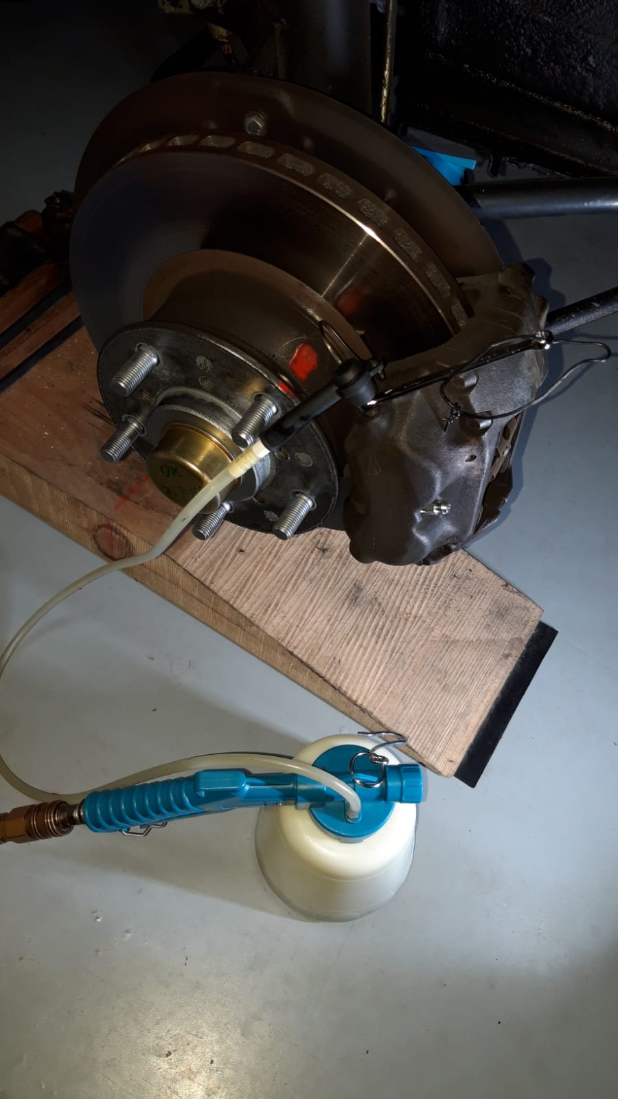

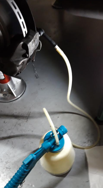

you start your bleeding, and at the same time you let it suck a lot more of fluid to renew it, i mean, you suck fluid in the lower bottle until you feel the system contains new fluid, then while keeping the suction you close the bleeder stud
you can forget about the big bottle, there will be enough with 1 liter, and you can do the clutch in the same round, first rears, then fronts, finally clutch
i see that there is not a better system than this (once you have an air compressor)
you check you big bottle and if you feel like, you make a second round, as the remanent fluid will not be stored again.
so, it is not only a bleeding tool, but it works well as flushing and bleeding
my 02

I'm sure both systems works very well, it's just diffucult to hang a bottle over the brake fluid reservoir on some cars as the hood and hood hinge is usually right next to the reservoir cap.
In the case of an e3/e9 it's not a problem as you show us. Didn't mean to go offtopic, sorry.
