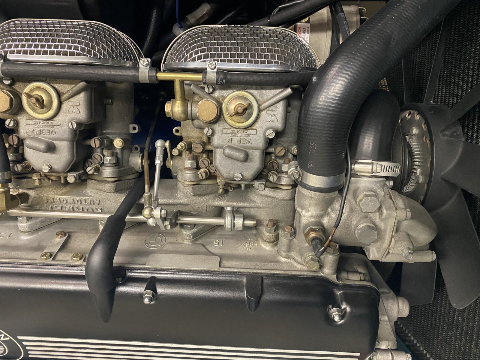

Here are 2 pics of my Korman engine with their T-Stat housing and their intake manifold with 40DCOE Webers. They built this engine for the PO back in 2005.

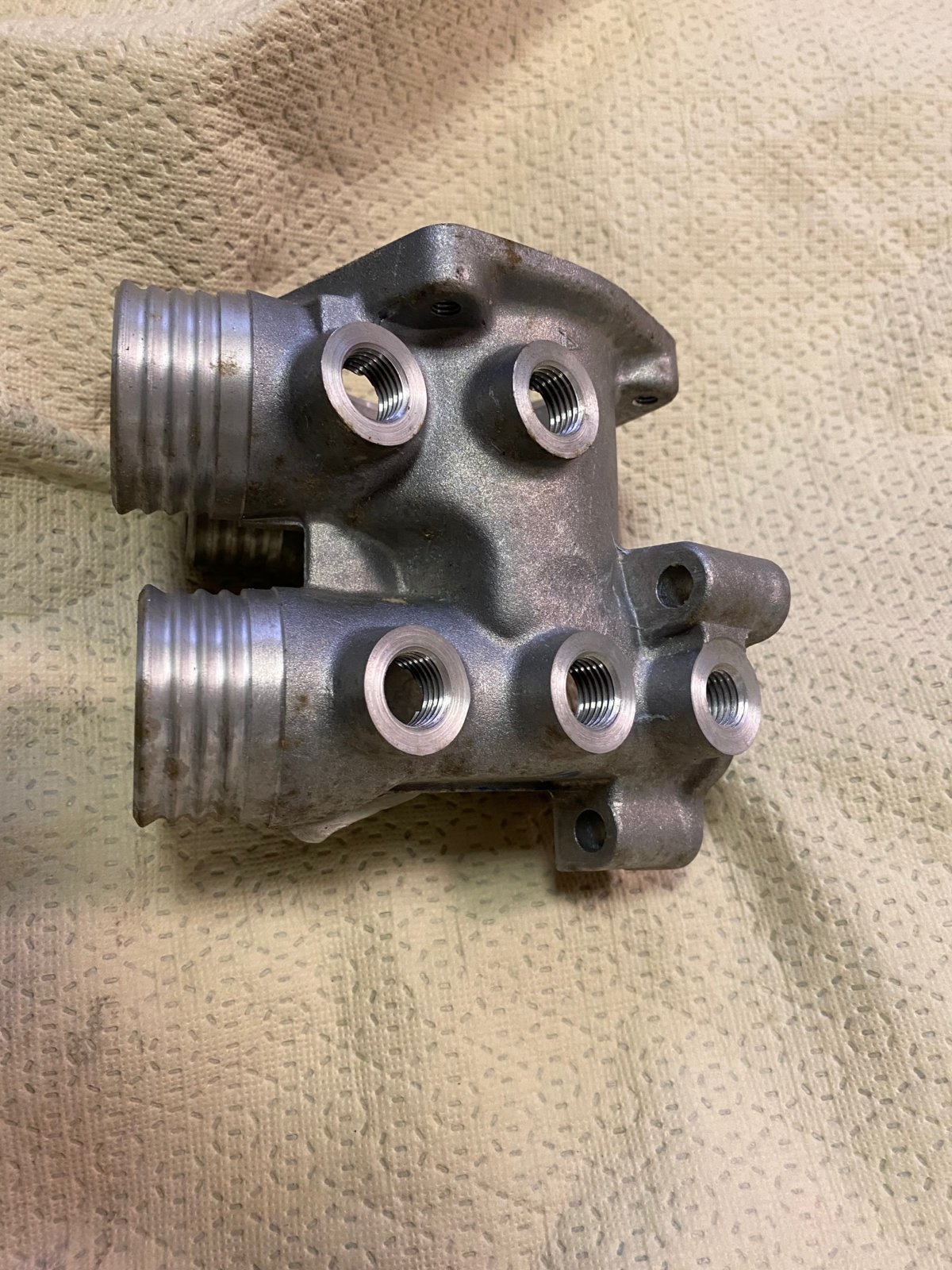

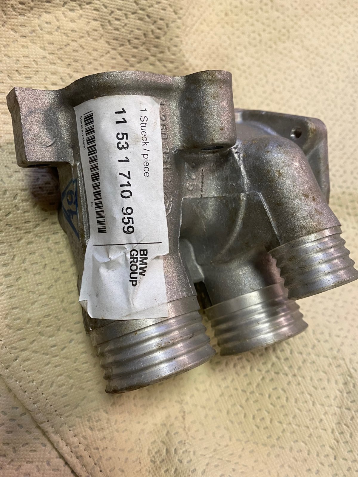

Unless I'm mistaken, that later model thermostat housing is still available for around $50.
Correct. It fits and doesn’t protrude as far. That puts the hose against the #1 carb and not aluminum. A worthy first step in fitment if you don’t mind the eleventy-billion sensor ports.
