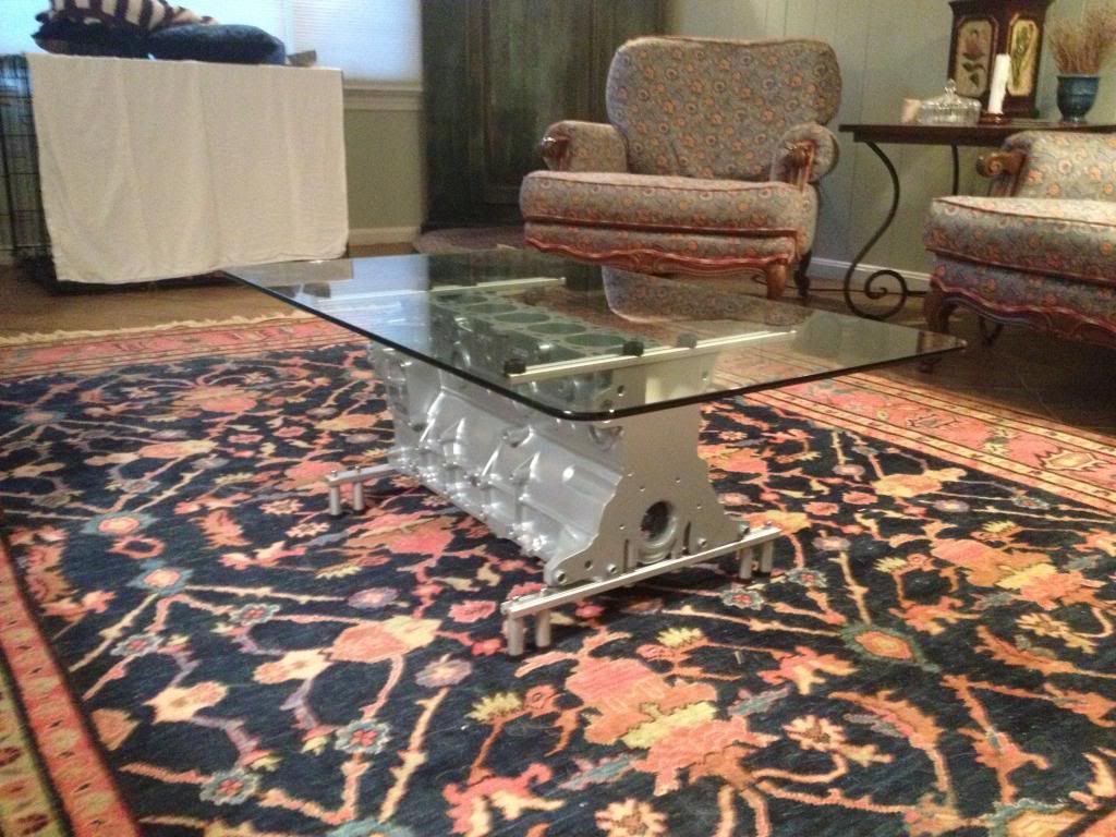

Decoupe definitely has the right idea. But heck, for <$1000 I'd buy it just to have the world's coolest coffee table if I didn't want to rebuild it. I would not have out an S38 in my car if it hadn't fallen in my lap, but I don't regret it for one second.
BMW engines make really cool coffee tables. Here's mine (well, actually, the one I built for my son):
