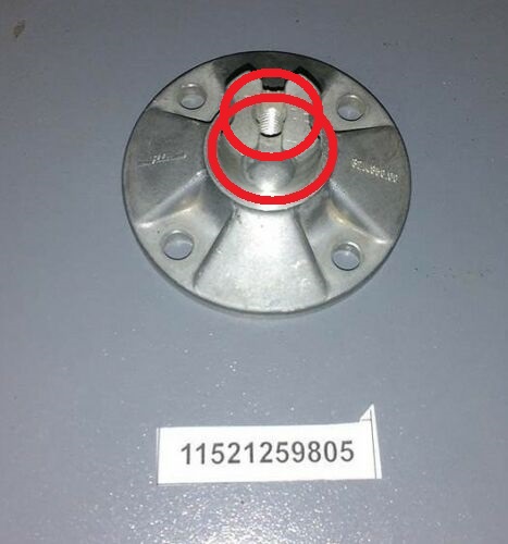

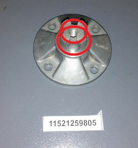

Pic for you to offset radiator forward
It's more complicated than just rubber mount cut, but fan mount, part that goes into the fan clutch can be also resurfaced couple mm in marked areas; after resurfacing it will go deeper inside.
