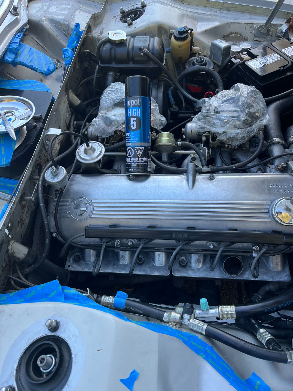

All good thoughts - found a HVLP gun and figure with the compressor I should be good to go. And Don, I will spend a lot of time prepping and I am also a Simple Green cleaner guy. My hope though was that the dry ice blasting will do the yeoman's work for me and I will just be doing the last bit clean-up. I'll make sure to take pre-post photos. Thanks for all of the tips so far. This week will be peeling off the bitumen and disconnecting everything in preparation for lifting out that engine this weekend when I can get some help. Lots of photos will be taken to make sure it all goes back together correctly! I also very much appreciate the photos in Steve's thread since he has it all laid out so nicely.

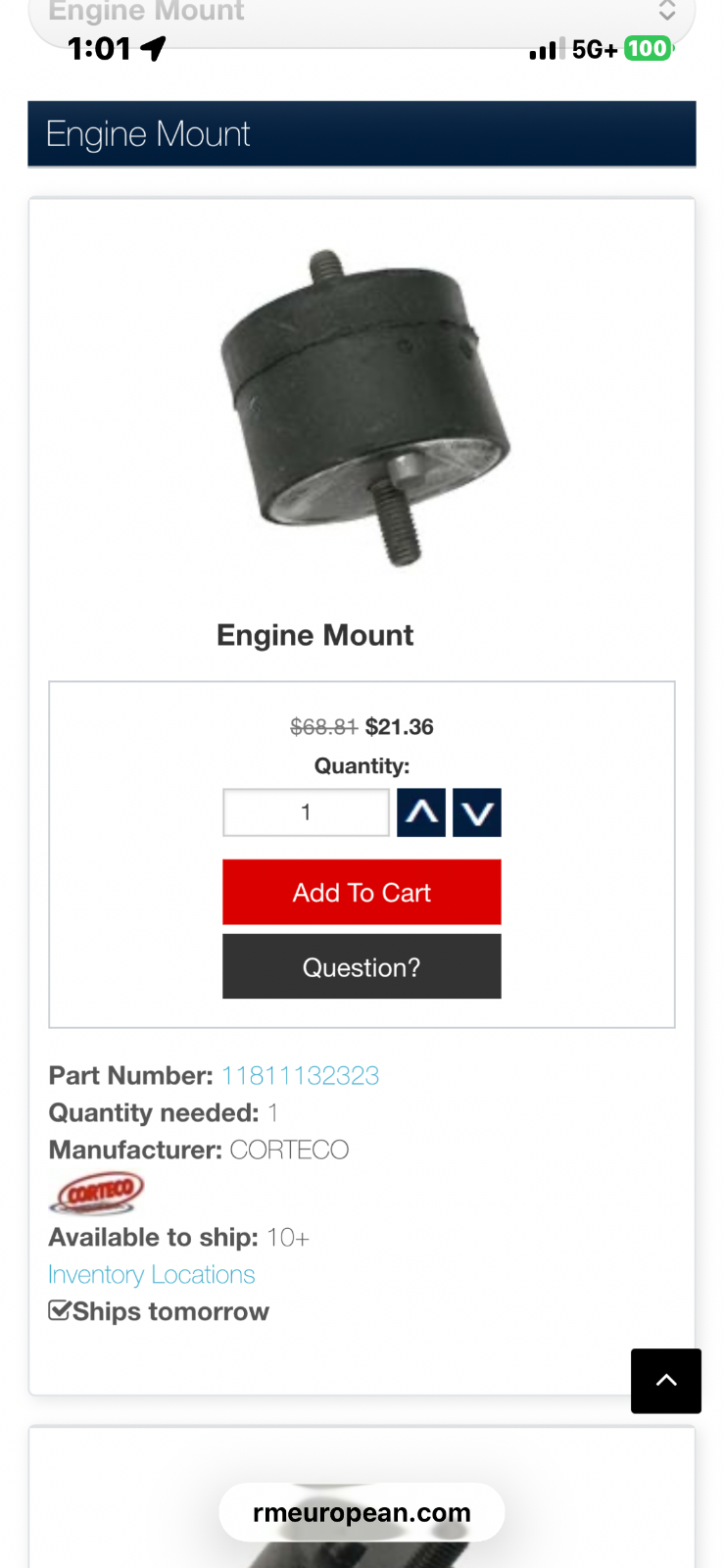

Well, I think that this will end up being one of those circumstances where I can go easy or I can go hard and I may end up just taking the plunge. In another question, why are rubber engine mounts $100 per mount and also totally unavailable?

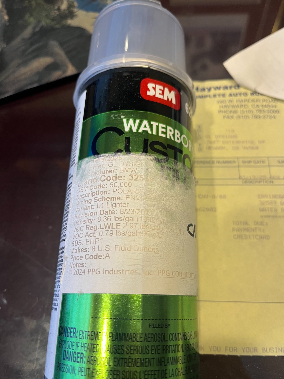

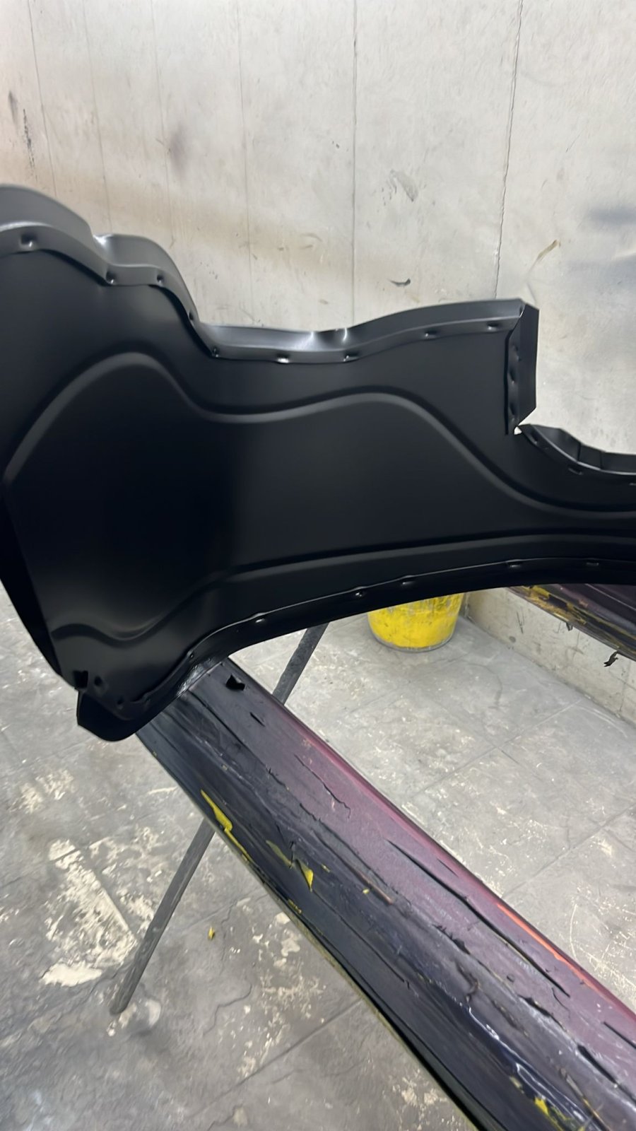

I was very please with the paint my local PPG shop had mixed up and put in a can. I got 3 cans and it was $58/per can Polaris same color my painter used to paint the rest of the car. Make a huge diffence and really easy to do.
color code was 32589 Polaris 60 And I love the high 5 priper

that's good to know - i was thinking of painting my lokari fender liners in ceylon. that could be a good way to do it.

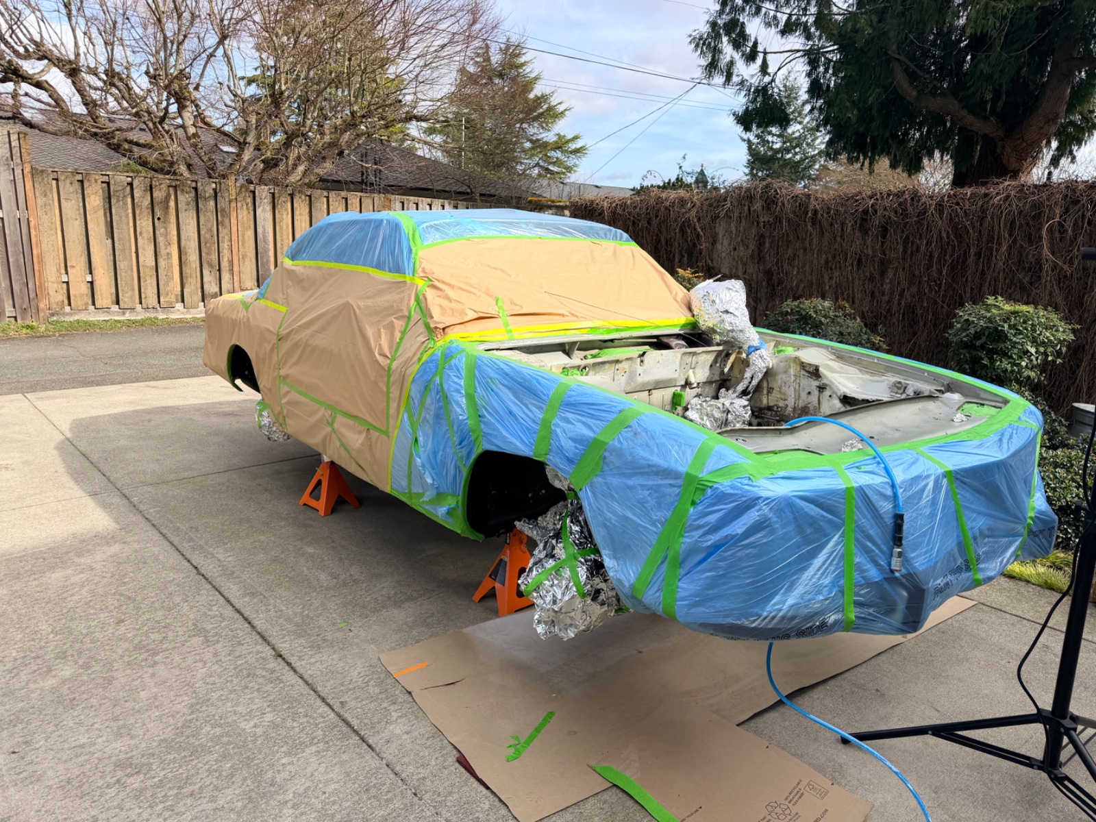

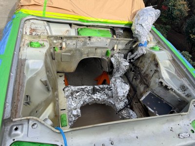

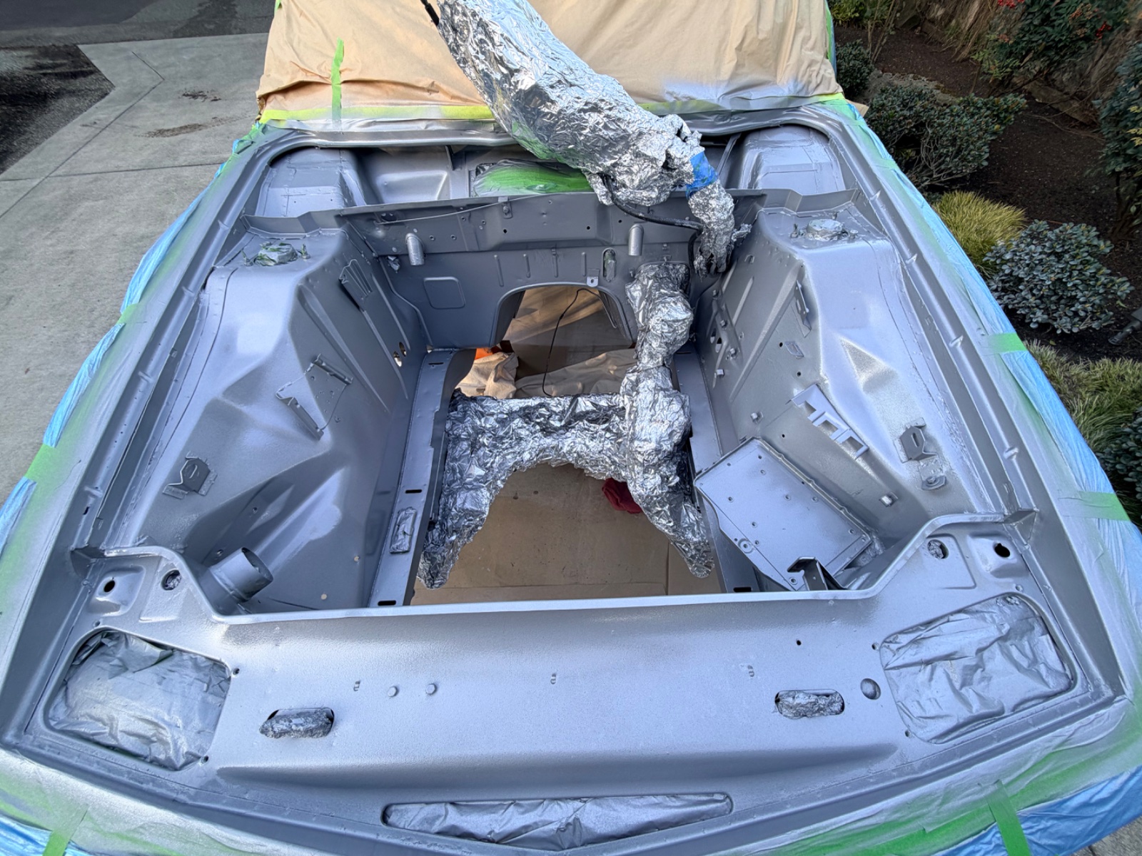

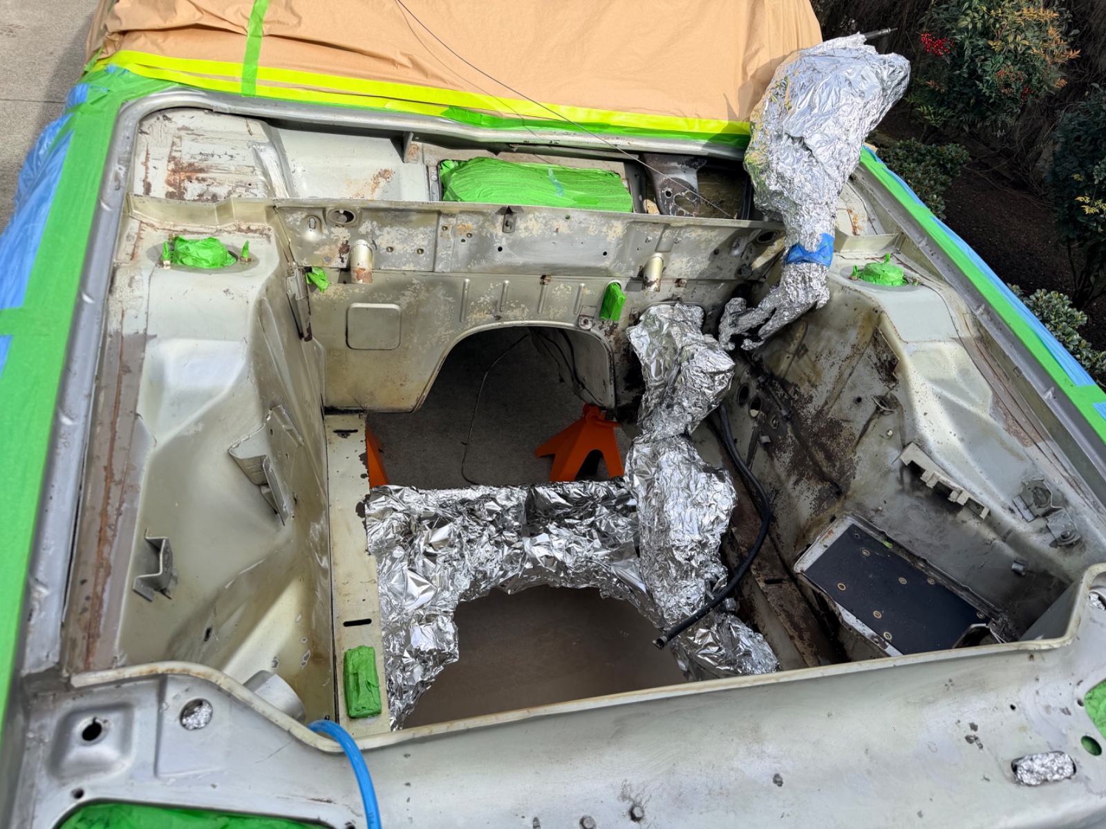

Since those of you who responded to this thread had motivated me to go for it, thought I’d post an update - this weekend it gets done! Engine is out and the whole car has been wrapped in plastic for protection. I have two days of good weather so will be tackling the engine bay, wheels wells and underside. Figure I’ll rustproof engine bay with rust-negating primer, then spray the 2-3 coats of body color on the engine bay and wheel wells followed by the clear coat. I’ll do some seam sealing in between primer and body color paint. I’m planning to apply some new Wurth stone guard to the underside and then will rattle can that a more dark gray. I’ll post some after pictures once it’s complete - wish me luck…

I was planning to do RustBullet first to have it counteract any of the rust spots, then will scuff and paint over that. I think that it serves similarly to an etching primer
