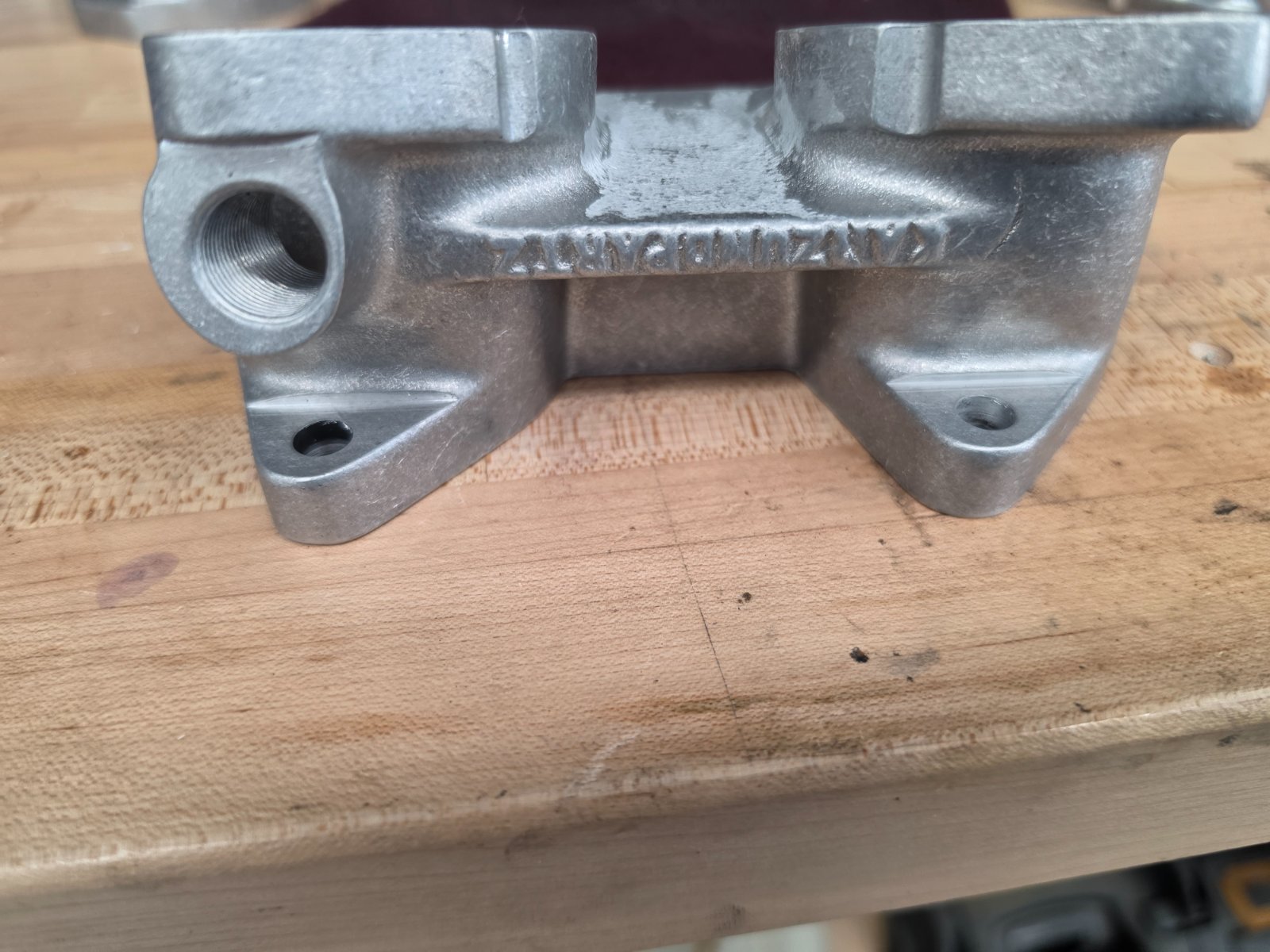

Anyone know what size these threads are? I assumed they were pipe threads, but they are not 1/4 or 3/8th NPT. This is the vacuum source for the brake booster, right?
I had the same question a few weeks ago. @StephenZ shared his measurement for the smaller holes and I found it to be a match.
smaller are 3/8-24, I can't remember the larger size, I think 5/8-18...
I would assume that these need to have some sort of barb fitting attached to them to connect the vacuum hose. What would be the proper slant to use? Teflon tape?
I'll hit the store in the next day or so to find a fitting for it. I'll be plugging mine, so I'll get the size soon.
