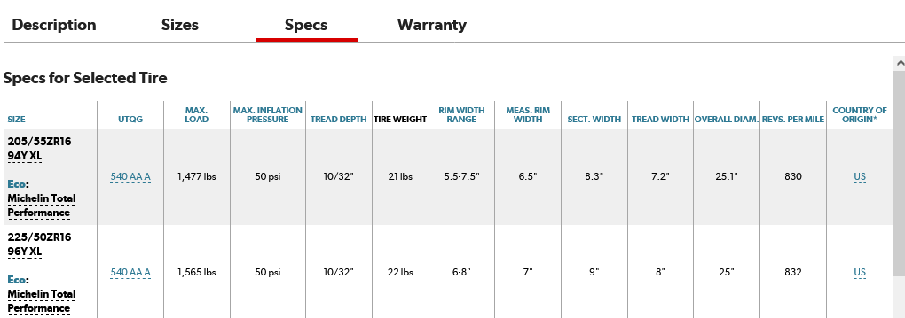

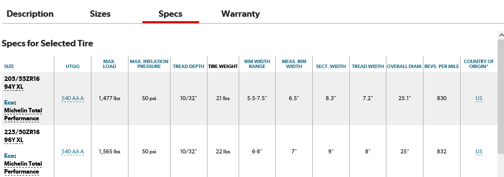

225/50-16 is the same diameter as the 205/55-16. this is listed in the referenced FAQ.

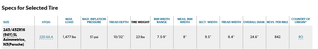

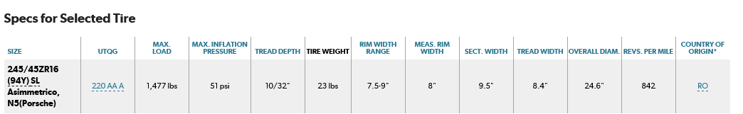

see below for a screenshot from tirerack.com. the 9.5" rear is going to give you trouble with the 225/50-16. there aren't a lot of wide 16" tires - i have included a pirelli p zero rosso in 245/45-16. the tire section width is 9.5" and the rim width range is 7.5" to 9". i think you are going to have all kinds of problems with a 9.5" rim on a coupe.

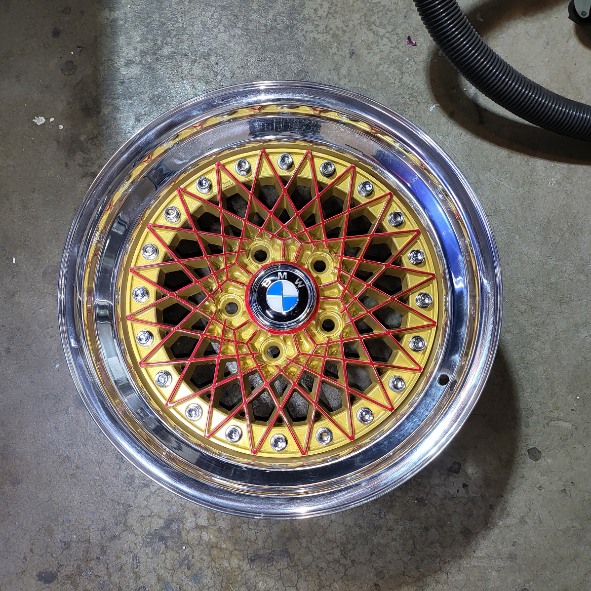

thank you again, I choose a 245/45/16 for rear and 225/50/16 for front I have a E46 engine and Wilwood big brake system I hope all this modification will work right the reason back rim is to wide thats how it came it is epsilon wheel that I restore it it is very nice wheel I look all around to fine a drum 9.5 is to wide but I couldnt fined any I hope that will not give me a problem if it dos I have no choice to spend another 3K for BBS
good luck, don't think the 225/50 is going to fit in the front. you better tightly roll the fender lips and have camber plates. i caught both fender lips with 205/55-16's. no idea about the rears. i have heard that 245's fit on 17" x 9" wheels - with a few mm to spare. that's not much room. you have to remember that when shocks / spring compress, the clearances get tighter

Hello I couldn't fined a barrel If I could fine 1 inch shorter barrel would be the best front is 7.5 inch and it is ok back is the problem that is 9.5 inch wide
