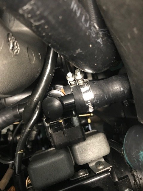

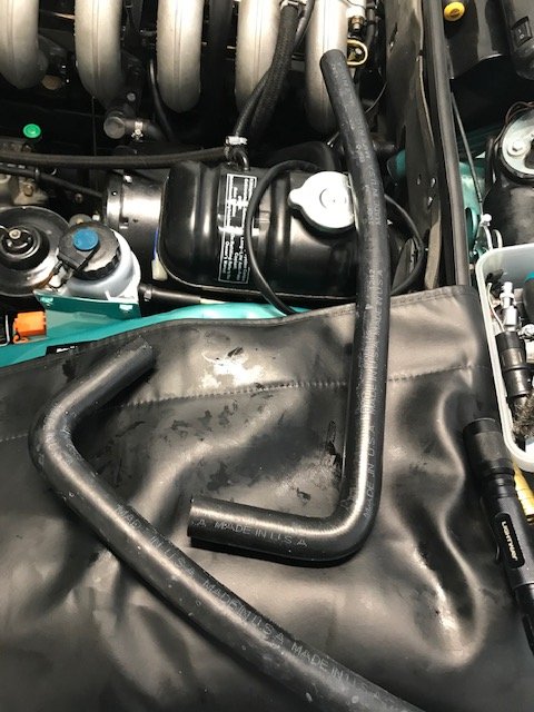

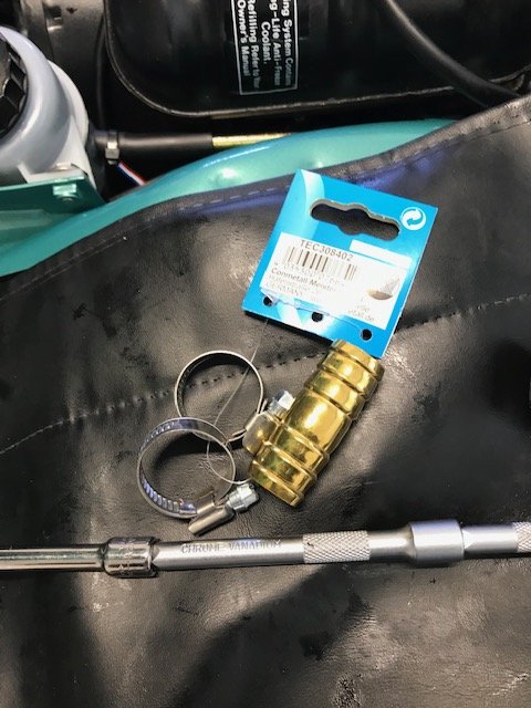

You can also install a heater bypass valve to avoid hot heat in the cabin
I agree. You might try this easy mod for a season before deep-diving into the AC mods.
Rob Siegel also did a great write-up on the bypass mod. I followed his direction, and it makes a world of difference in the summer!
A couple of angled hoses, clamps and the bypass valve... done in an after noon (not counting getting the wires into the cabin ;) )
