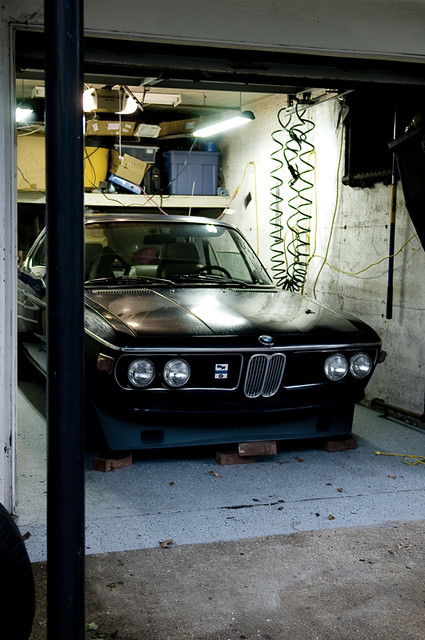

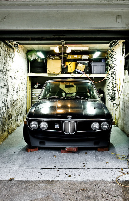

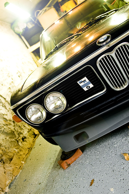

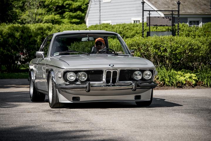

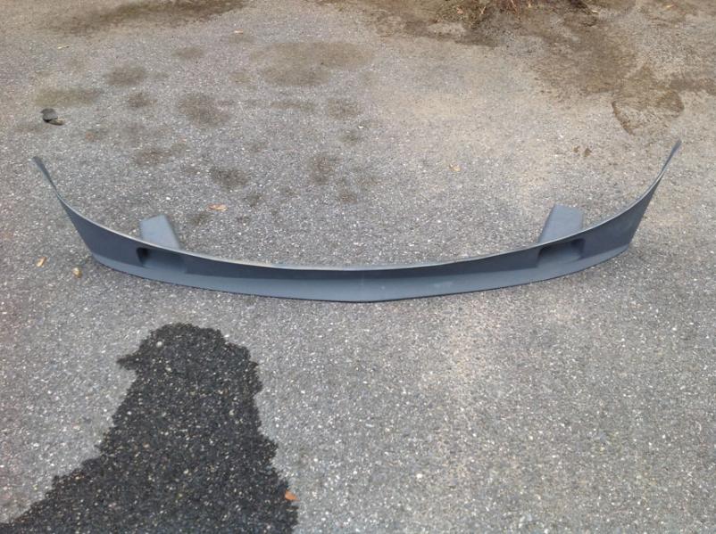

Here are the pics i have at the moment of it test fitted prior to paint. will try to find more later:
DSC_5860 by J_Otte, on Flickr
DSC_5861 by J_Otte, on Flickr
DSC_5863 by J_Otte, on Flickr

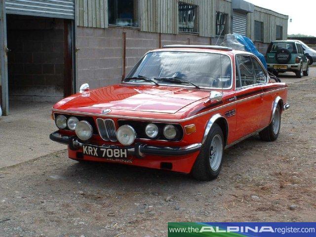

duane_sword
592
5
Boston MA

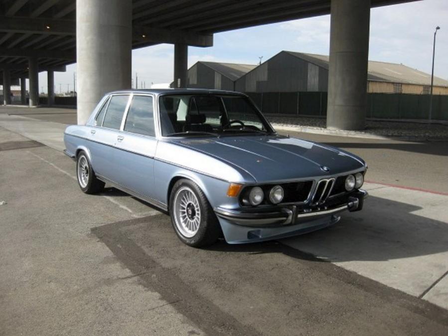

duane,
close but not exactly the same. take a look at this pictures. The part mounted on the Bavaria doesn't have the same profile at the edge and there is no vertical surface on the fender to mount through. Also, the edge of the 'e9' spoiler has a slight return toward the wheel well as it wraps - in other words, when looking at it from the side, there is a significant surface that is presented to you. The one that I have (and the one shown on the e3) has no return or wrap whatsoever, just an edge. Also, the mounting lip or edge along the top of the piece is much shorter - cant see this in the picture but its probably 1/2 the width of the 'e9' sample.

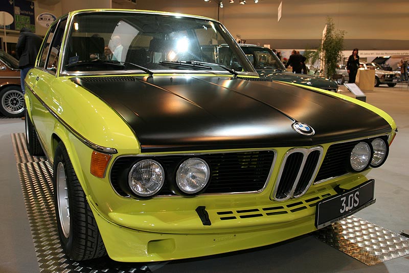

a few more pictures...
completely different profile, edge contour, and attachment.

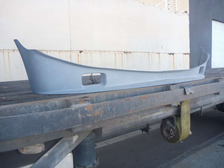

This is my E9 spoiler as sold by the H&B BMW (Hardy&Beck back in the day). Have not mounted it since it was bought about 2 1/2 years ago. Most definitely this is an exact and original Alpina copy as Hardy&Beck was a Alpina car and parts distributor back in the 1970's and 80's.

mystery solved. The spoiler i have fits both cars, but is made for the bavaria. There are, from what i can tell, at least three versions of genuine Alpina spoilers. One earlier version contoured for the E3, an E9 version and another without the vent openings - not sure whether E3 or E9.
Major difference between E3 and E9 is the contouring of the ends of the spoilers, the e9 spoiler is actually molded to fit the sheet metal contour of the coupe front fender (there's an indentation just aft of the junctions between the valance and front clip / fender - this indent matches exactly the shape of the wheel well mounting tab at either side of the spoiler). the E3 doesn't have this indentation and thus the E3 spoiler has no tab to mount to the surface of the fender, only a return that allows it to be screwed to the inside of the leading edge of the wheel well sheet metal. It still fits nice and snug, just not 'custom' to the E9 sheet metal.

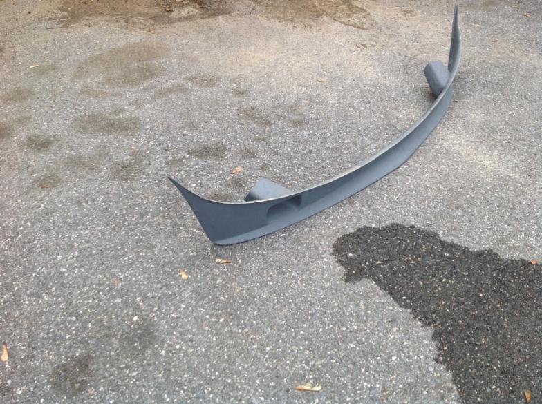

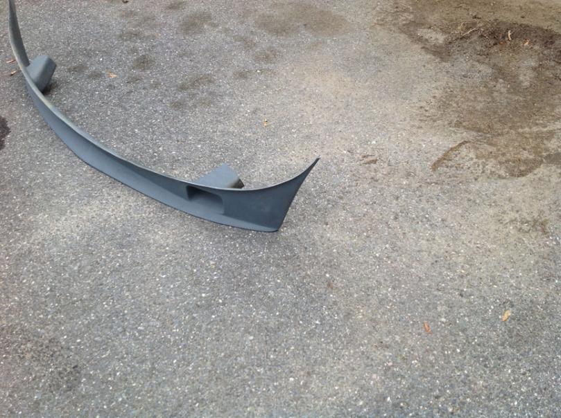

Early / E3 Spoiler
Obvious difference in the shape of the ends...

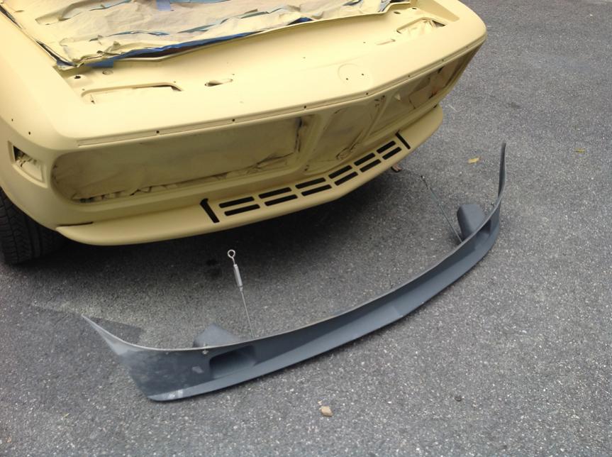

mounting it
thanks for all of the input. I made some modifications to the spoiler so that it fits nice and snug and parallel to the ground (2 turnbuckle adjustments that tie back to the frame rails) and came up with a method to mount it that doesnt require any additional holes in the body. priming and painting tonight. fingers crossed
