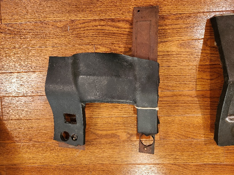

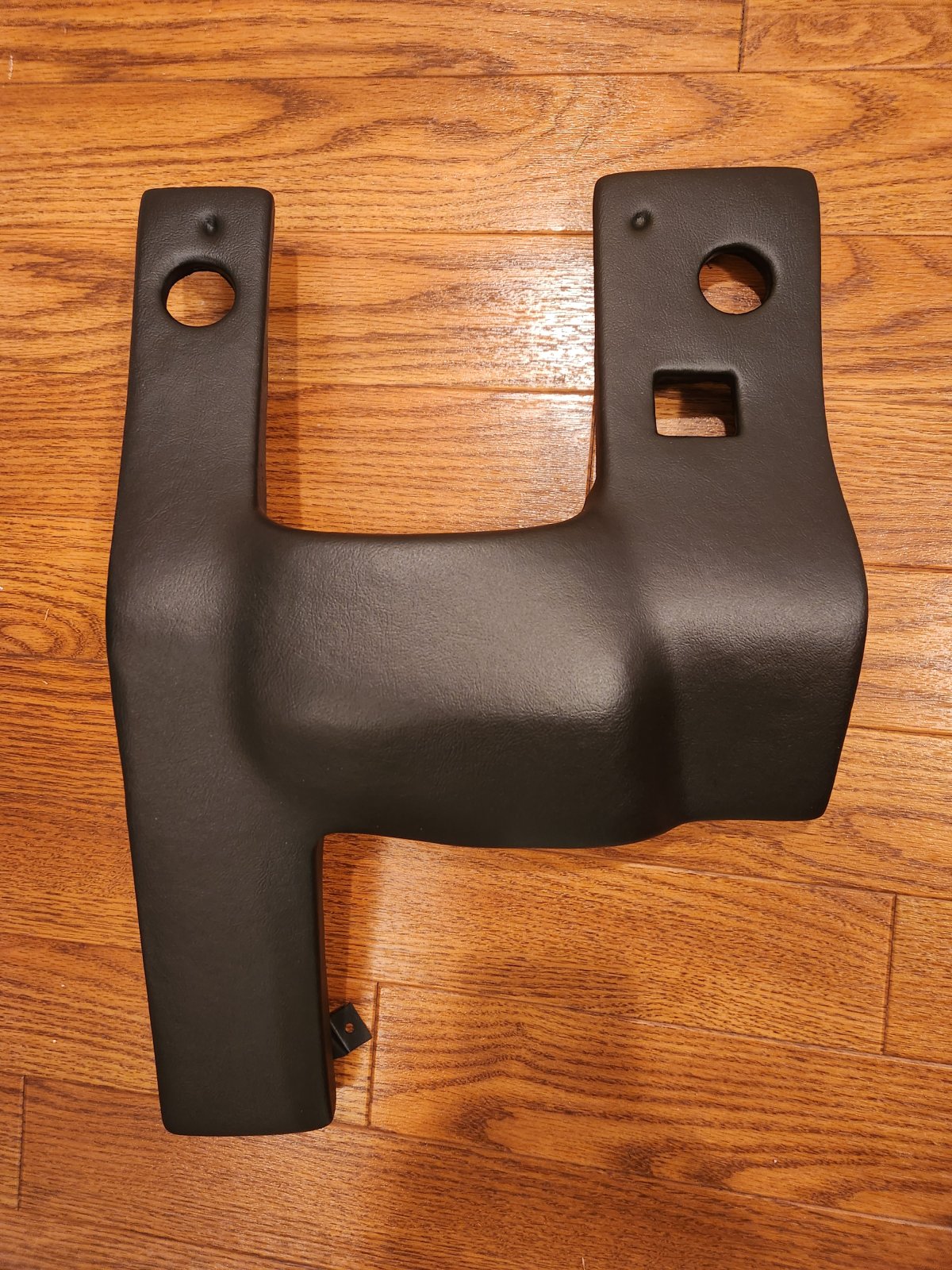

My adjustable steering column cover was trash and never did I see another for sale anywhere. I'm redoing the interior now and so contacted JustDashes with pictures of the piece and they said they could fix it. I was a bit skeptical, but see here the before and after >>
The other pieces look great also.

8 weeks was the lead-time. The glove box foam had delaminated quite a bit and you saw the steering column cover mess. Communication was excellent.

edges not as crisp as OEM, but looks 1000% better
Is that an effect of the process they use?
I'm guessing shops like that will wrap your part with a new skin, on top of the old one. Thus increasing the radius of corners with the material thickness. Especially sharp corners will loose their "definition" , a 1 mm radius will become a ~2 mm radius, and that will look distinctively different.
Plus it think it also means the parts 'grow', possibly making for a tighter fit. That can be a good thing if the gaps were fairly large to begin with, but if the gaps were zero to start with, it'll be a pinch to get the part fitted nicely.

I recall comments here from Paul Cain that the dashes did indeed "grow" when recovered and required some trimming to fit.
