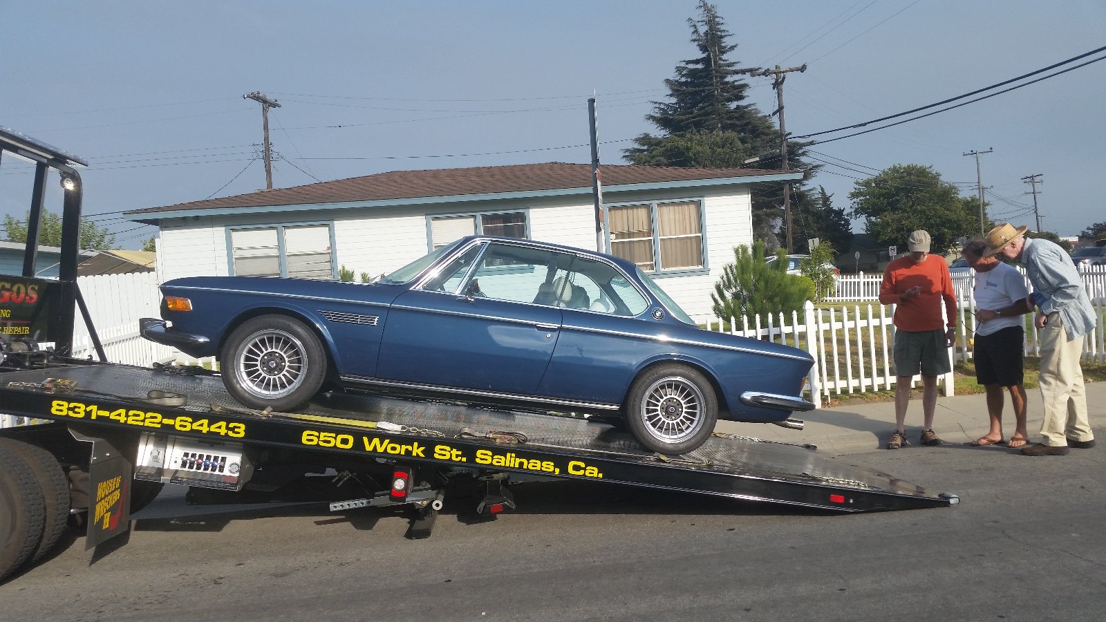

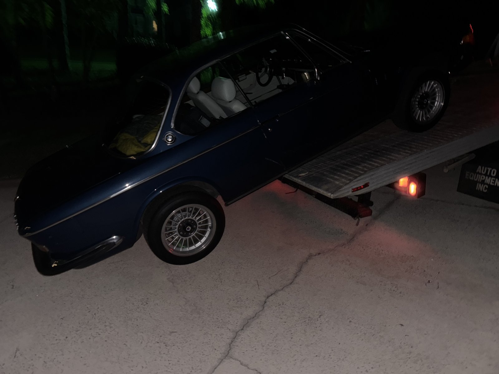

We drive 4 hours together (over some bad roads along the way) back to Aiken to Tom/Chris' garage and arrive around 10 pm. While the tow truck guy is raising the bed to angle the car for releasing from the chains, the rear tow hook breaks off completely and the car sways to the left and somehow gets away from the front left chain anchor bending the front bumper and rolling back on the bed of the truck finally grounding itself a few feet before tipping completely over into Tom's driveway. Picture attached shows how center resonator and bottom of chassis prevented a full rear dive off the truck and hitting the driveway!
Clearly the old rear tow hook was partially at fault but also the tow truck driver who was probably in too much of a hurry to offload my car...and the next morning we noticed a crushed center resonator against the driveshaft and dislocated driver side front bumper. Ok, these will be straightforward fixes after American Classic Insurance gets involved...
But the bigger topic here is where to attach the three hook anchors on most tow trucks to our E9s. After the fact it seems, for the front, that the factory tow hooks at the front of the subframe are best because that's what they were designed for, but I just had some subframe cracks welded at the tow hook juncture and the tow hooks were now both nice and straight. So when the guy attached those front hooks to the lower control arms on the inner side, I was not as worried even though I just had new arms installed and a full front alignment. That was probably a mistake too.
But the rear tow hook under the wheel well is another matter. That piece is super flimsy and broke right off at the puny spot welds that were done 52 years ago. I will have that rear tow hook reinstalled but both welded and bolted in for greater strength when I get around to repairs -- at the advice of Tom Baruch.
If this is not the best way to secure our coupes when a tow truck is needed, what are the better solutions?

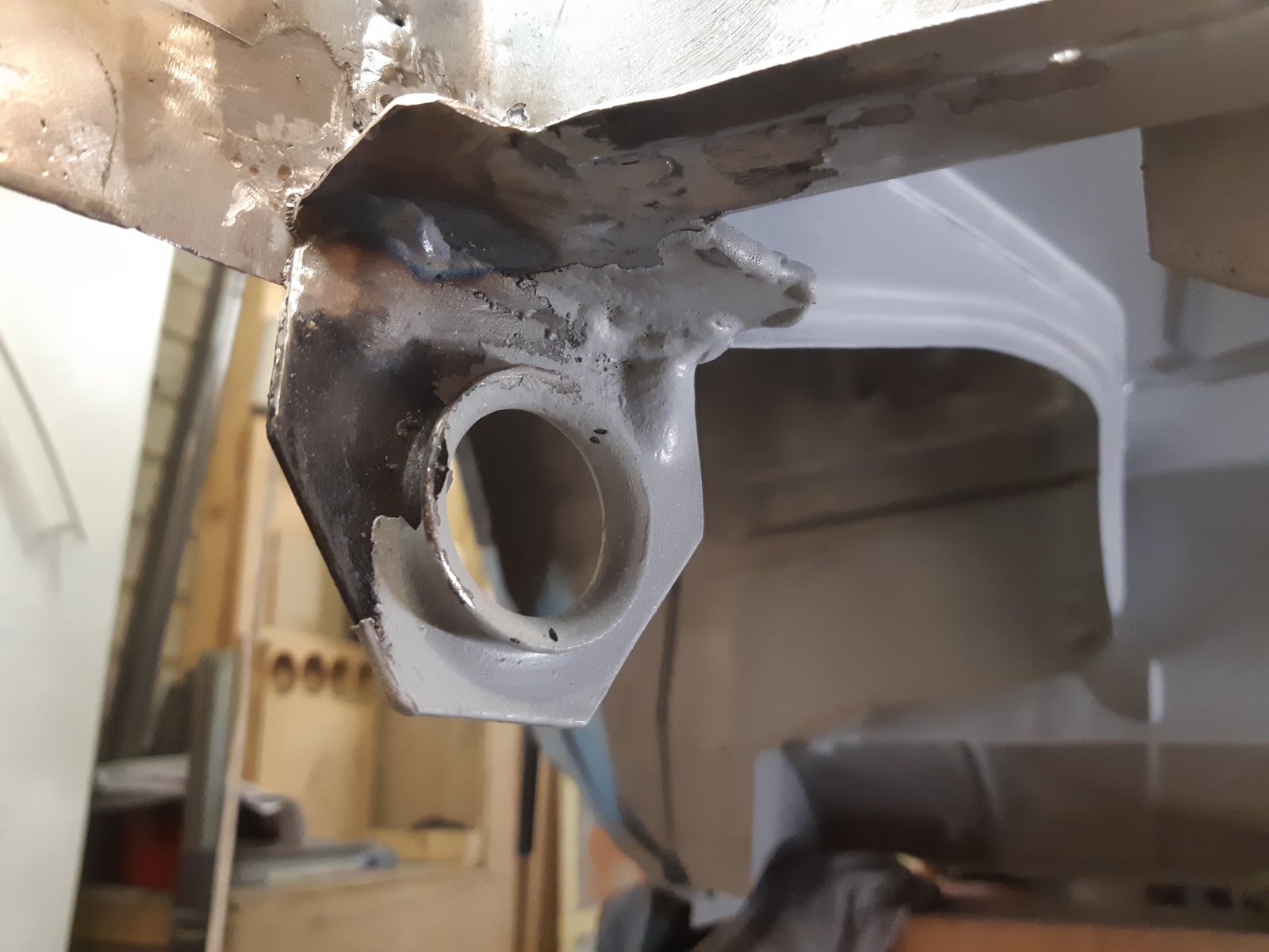

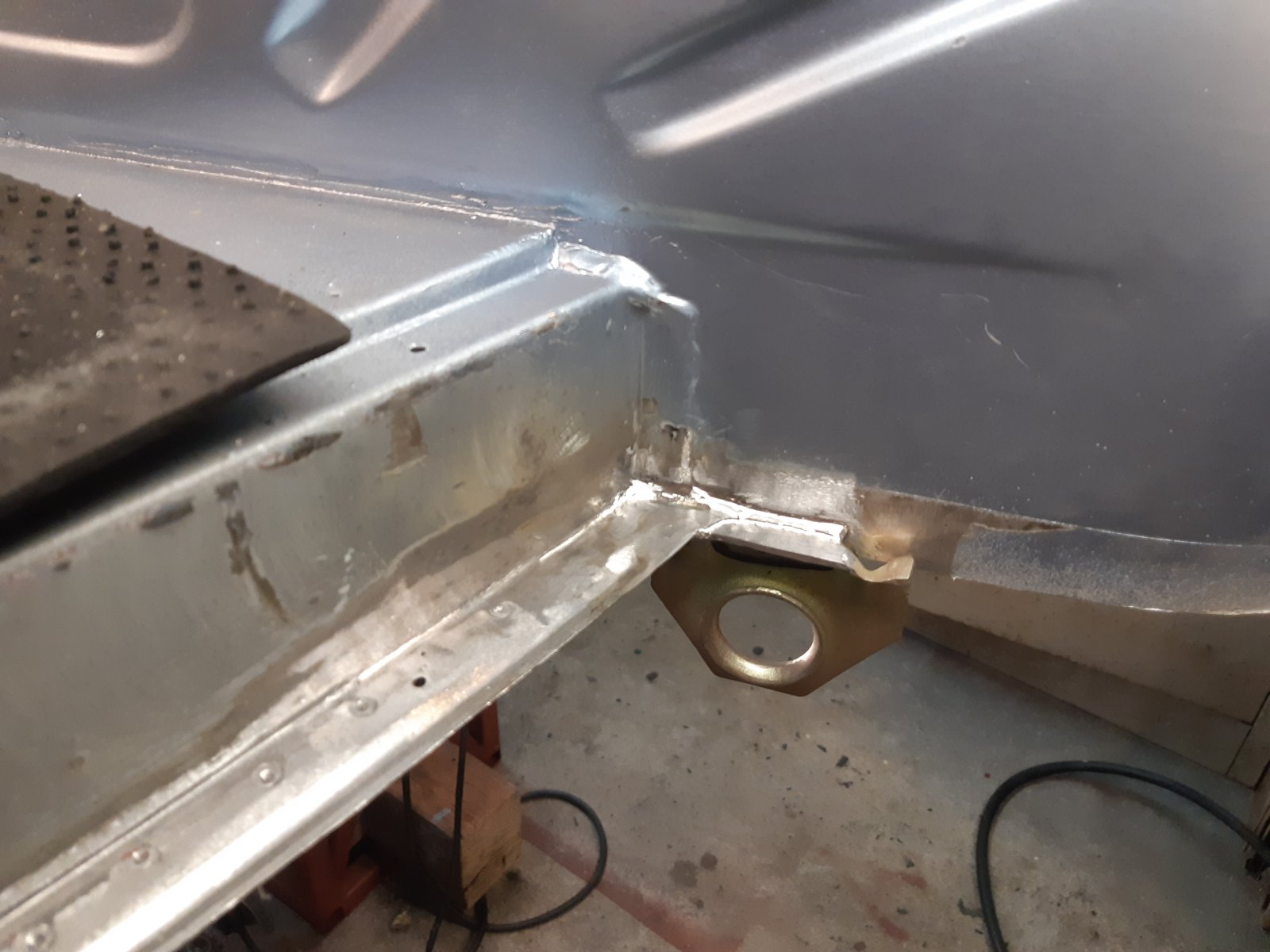

BMW themselves used the eyelets welded behind the rear wheels as tie down points when transporting them, apearently on rail cars between the Karmann factory and the BMW plant. These are oriented straight down, thus they are capable to loaded in (roughly) that downward direction.
I think these can also be used if for some reason the wheel strap isn't doable.
I think the rear tow hook is designed to take only purely horizontal loads; that way all ~15 welds are stressed in unison.
When strapping an e9 down on the rear tow hook, it is being pulled downwards, thus bending, thus loading only 1 or 2 of the spotwelds that are at the bending line. They'll snap, and the hook bends further exposing the next 1 or 2 intact spotwelds. It continues snapping them until you have effectively ripped the tow hook off.

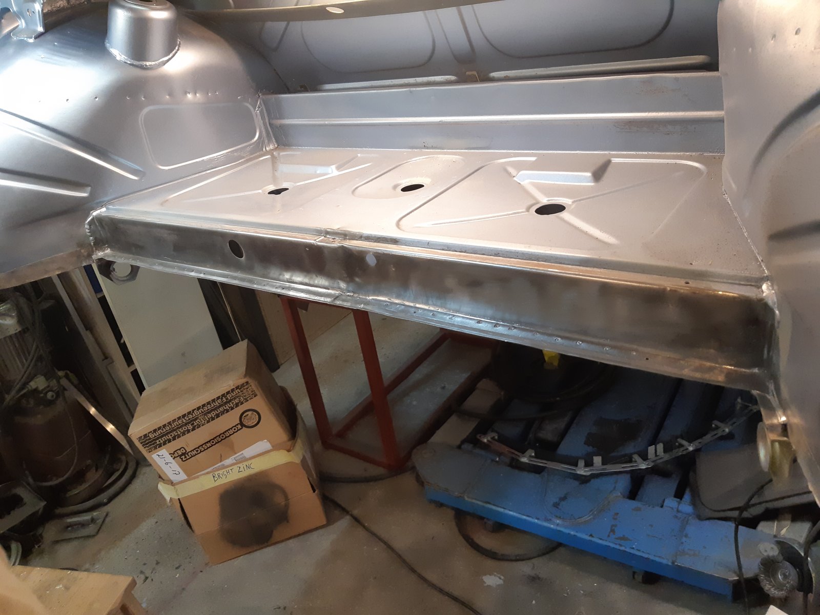

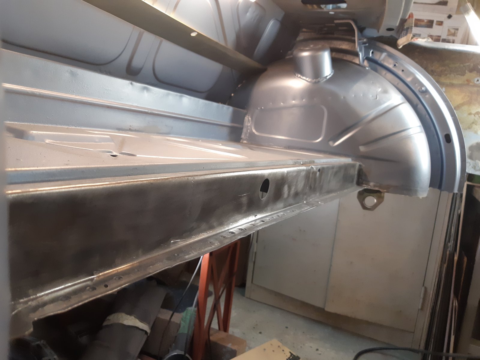

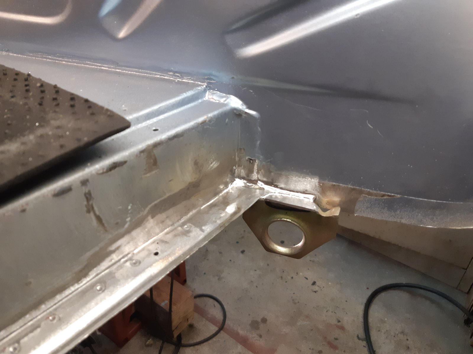

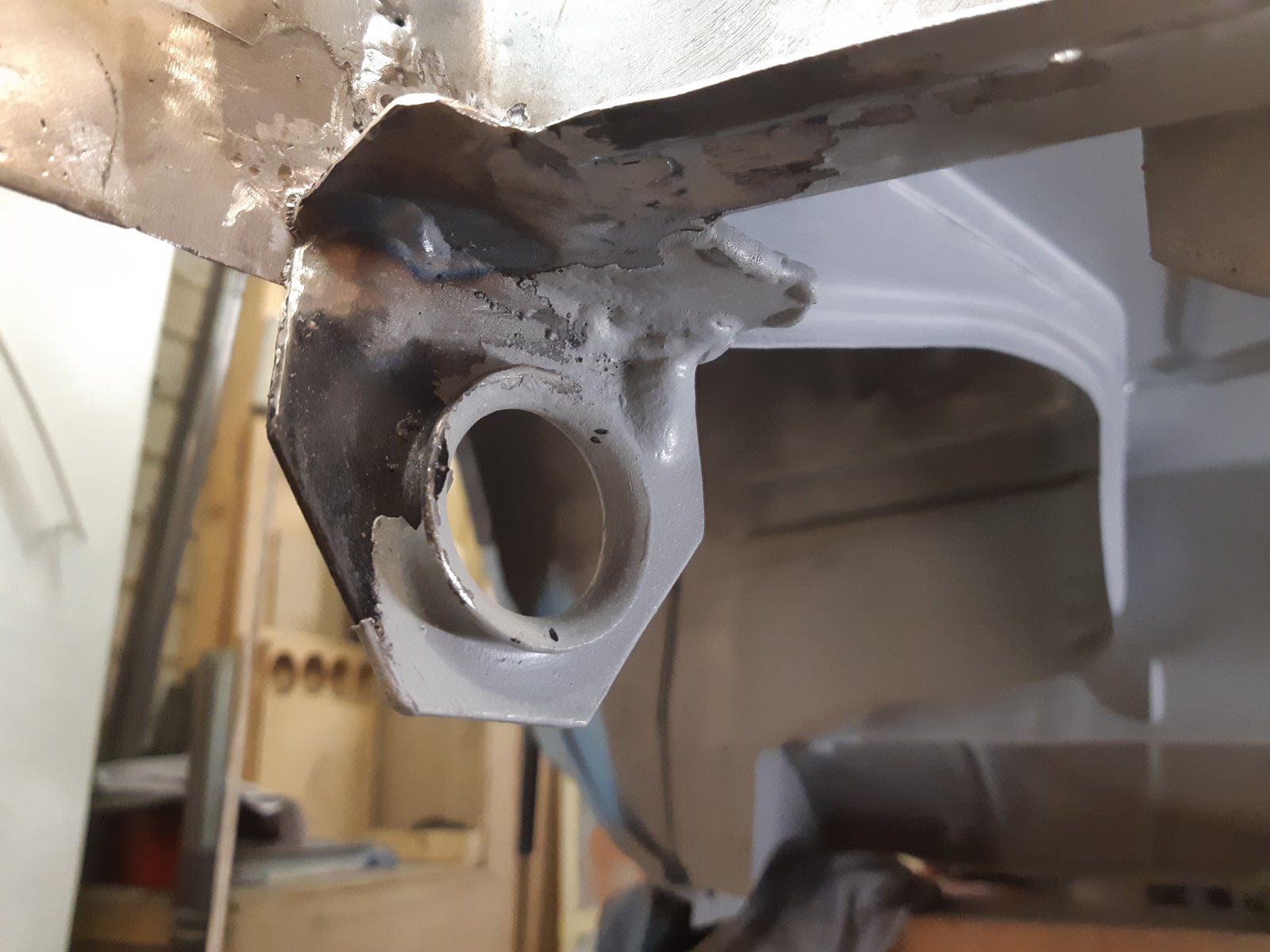

some details of the tie down eyelets on my E9:
Originally, these are welded in with strip welds in 2 directions, mostly loading the rear wheel tub when strapped down; quite an ideal setup.

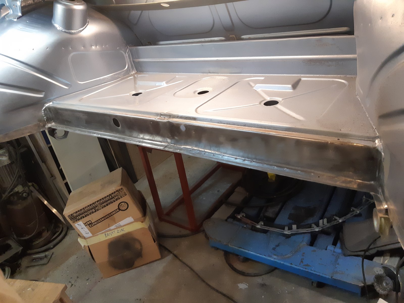

freshly rezinced and welded back in:
left and right eye just visible here as the fuel tank and spare wheel well are chopped out of the car:
View attachment 202748 View attachment 202749
