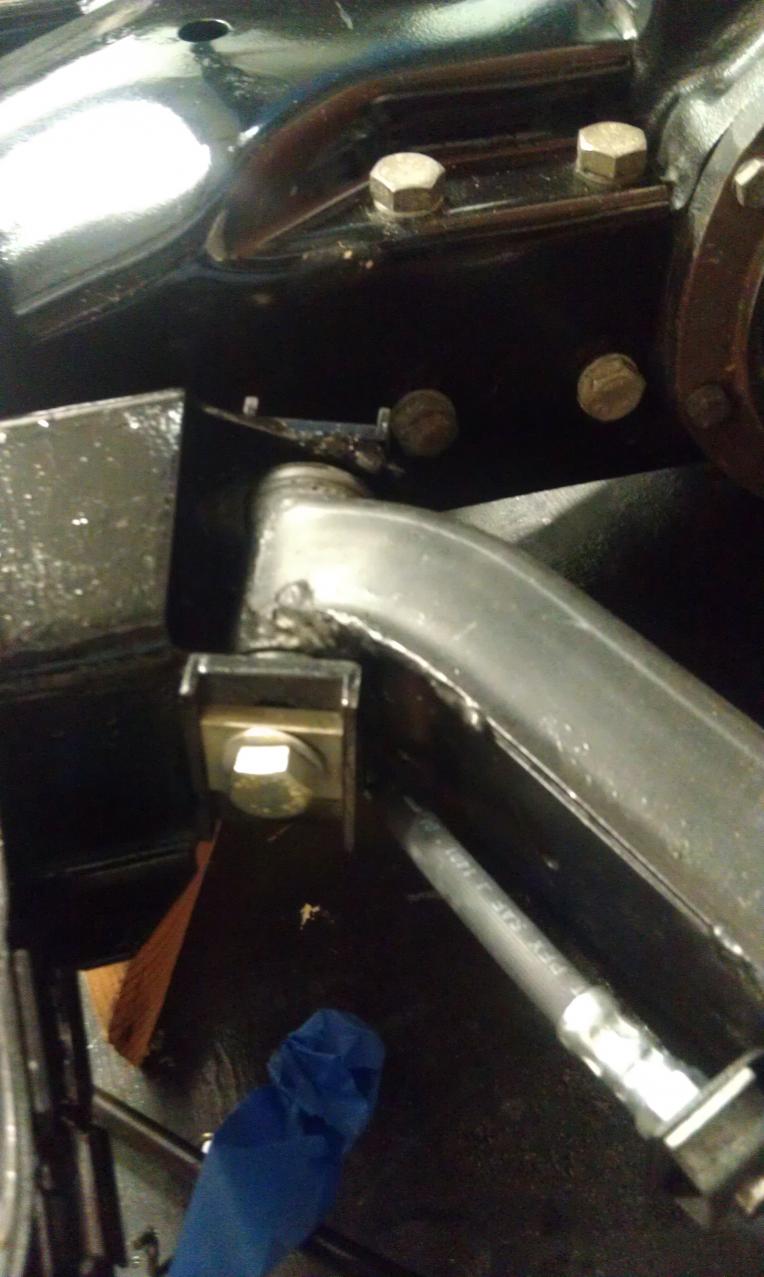

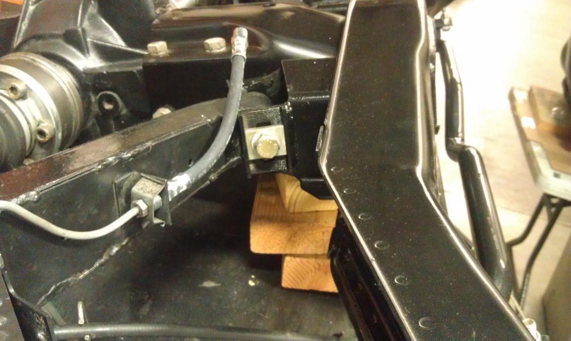

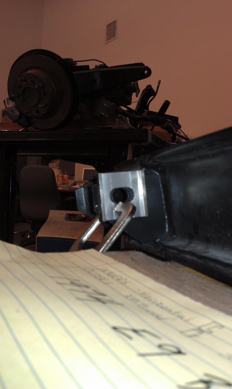

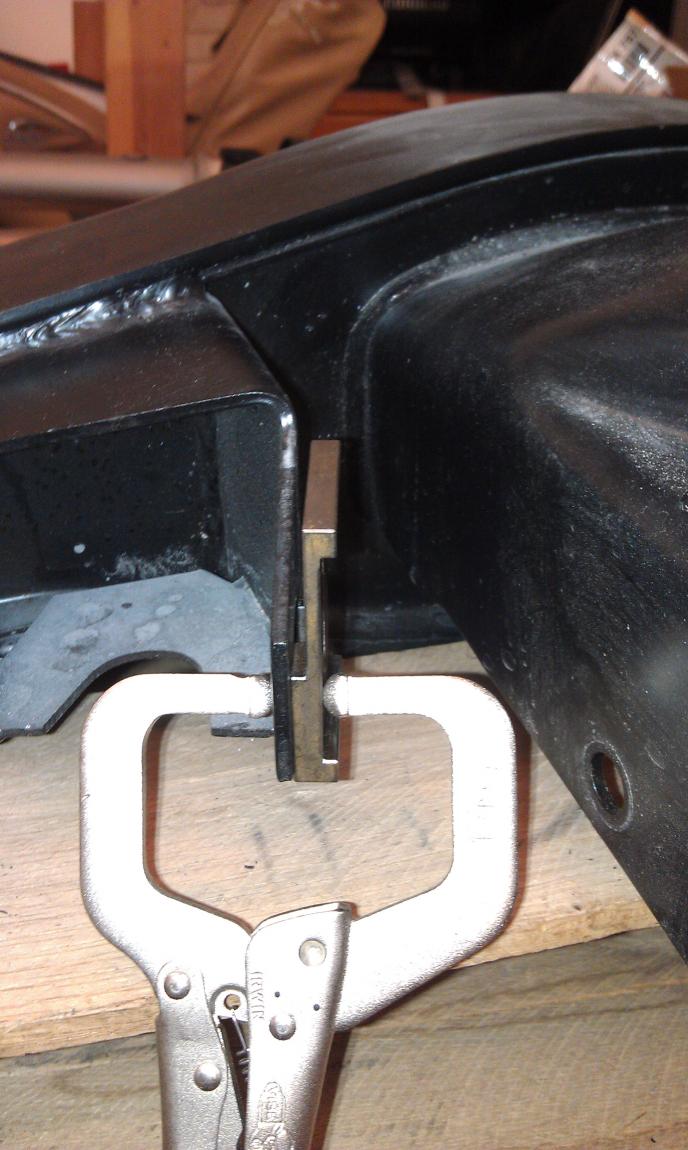

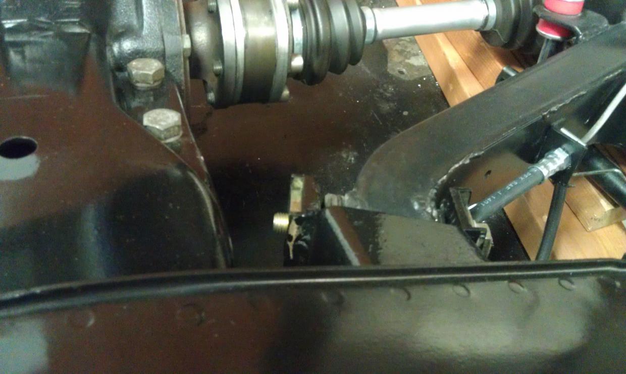

Camber- toe plates
Hope this helps: Guys at IE said no need to reinforce unless racing, it looks thick enough back there for me. Don't worry about the gap in pic 5, just weld it good, and I took everything back apart- just seemed easier. Probably took an extra hour but I wanted to measure the stuff just right.
