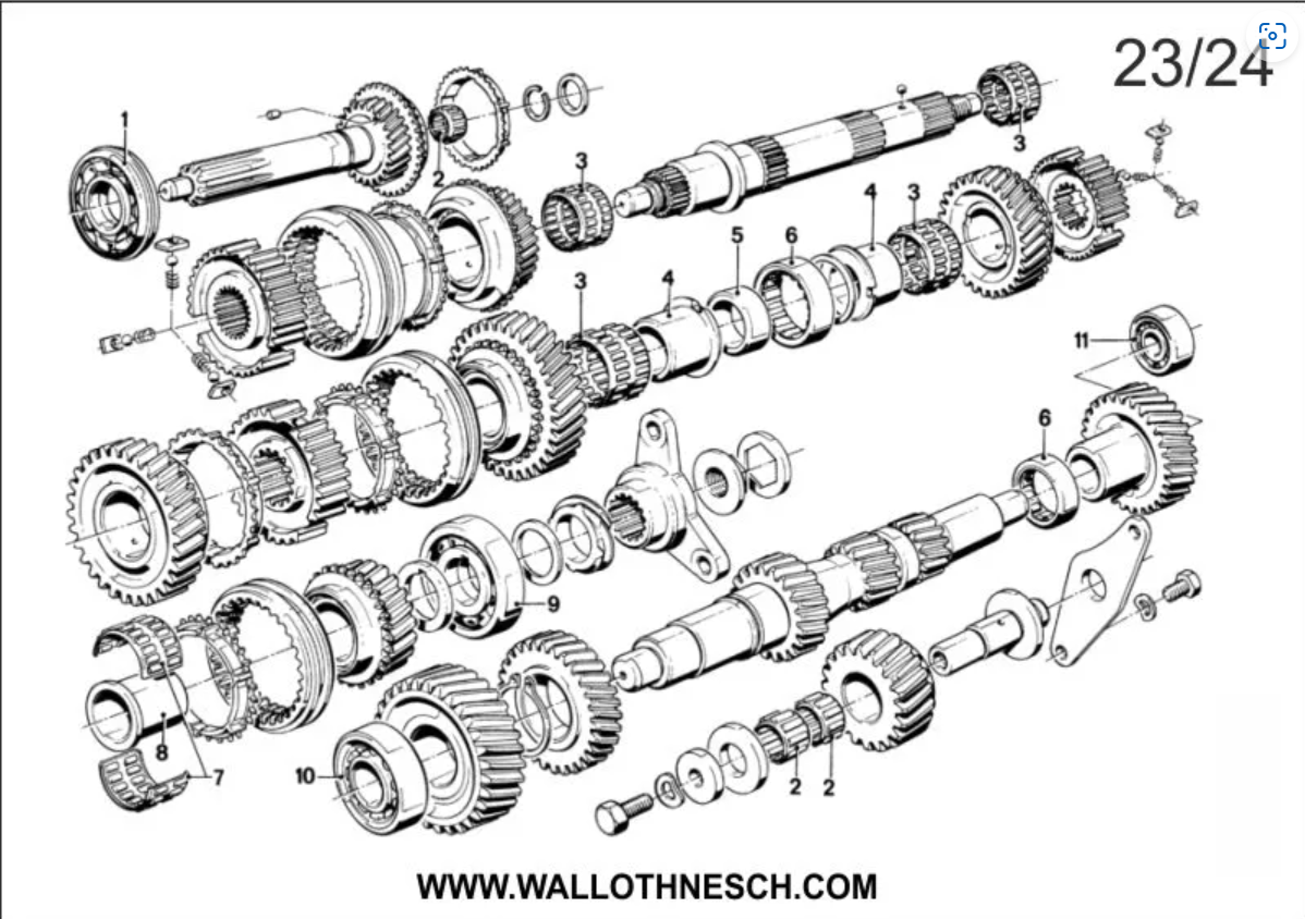

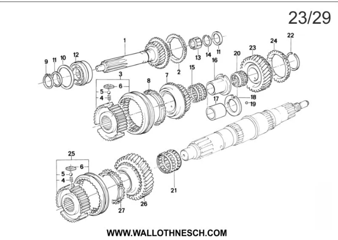

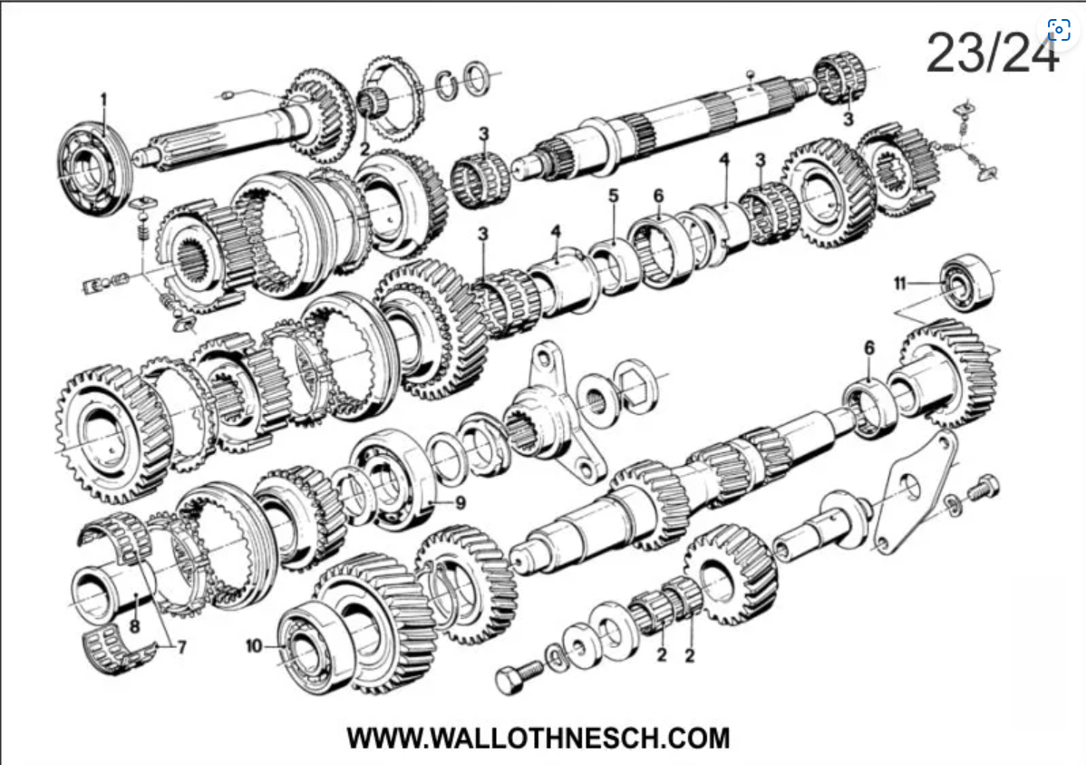

But which is the one on Walloth is it the dogleg or the OD?
position 1
The link you provided is to the 4 speed box
23/24 is the 5 speed OD box; position 1 is the input bearing, noticeable in its absence from the listings
23/29 is the 5 speed dogleg box; position 12 is the input bearing, which they show
