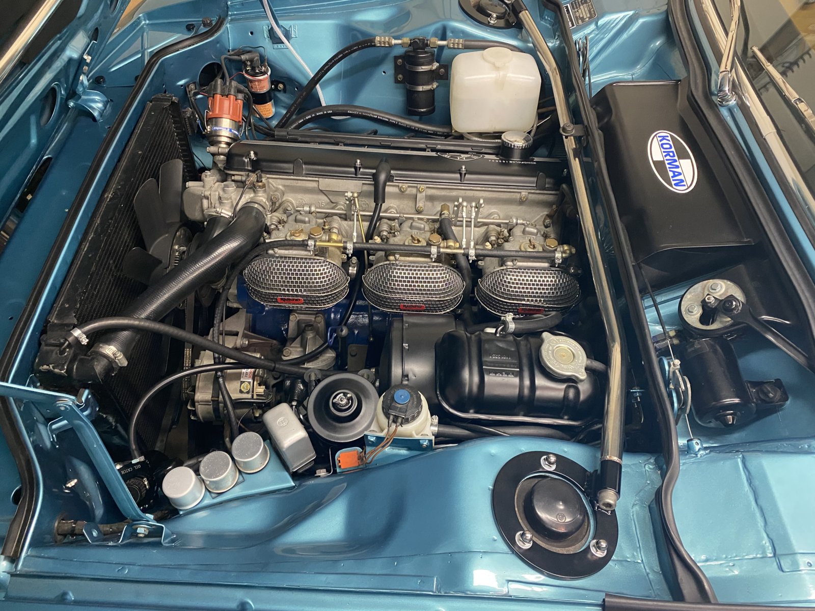

Can you guys post a pictures of your engine bay showing all the goodies?
Thank you
I still don't know how some of them get their engine bays that clean :) Good luck with the swap out

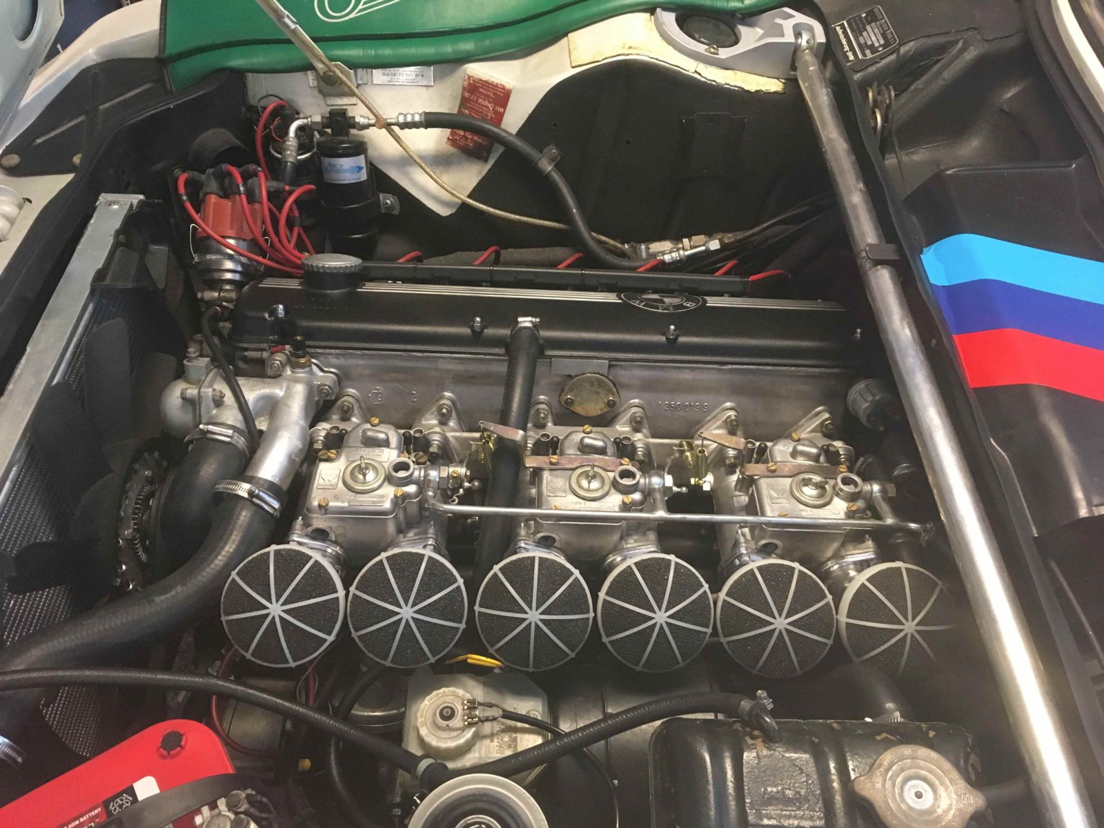

As requested. Everyone's setup will likely vary.
These Weber references are excellent.
The conversion is a journey, be patient.
It's very rewarding. ;)

Thank you Shanon
I bet it is a long journey but I am willing to take this path now and then enjoy it to the fullest
Nice and clean engine bay I must say
Thank you for sharing

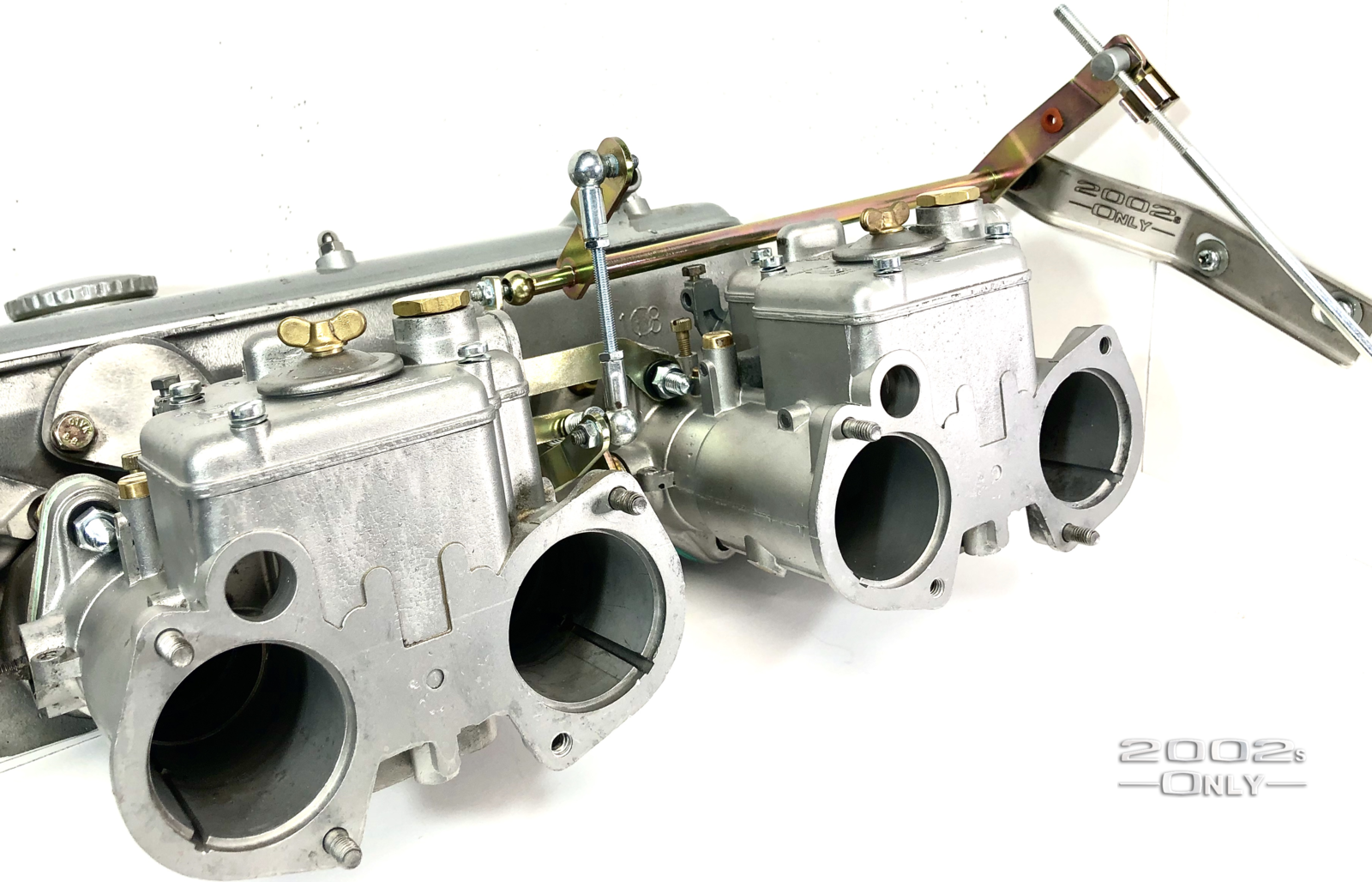

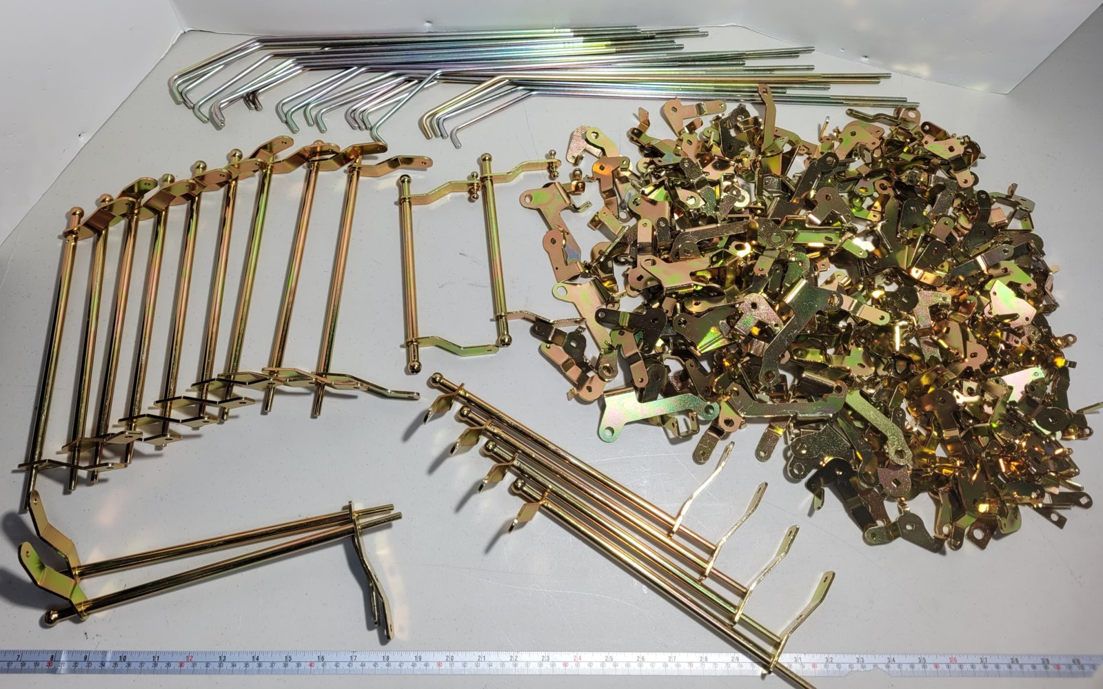

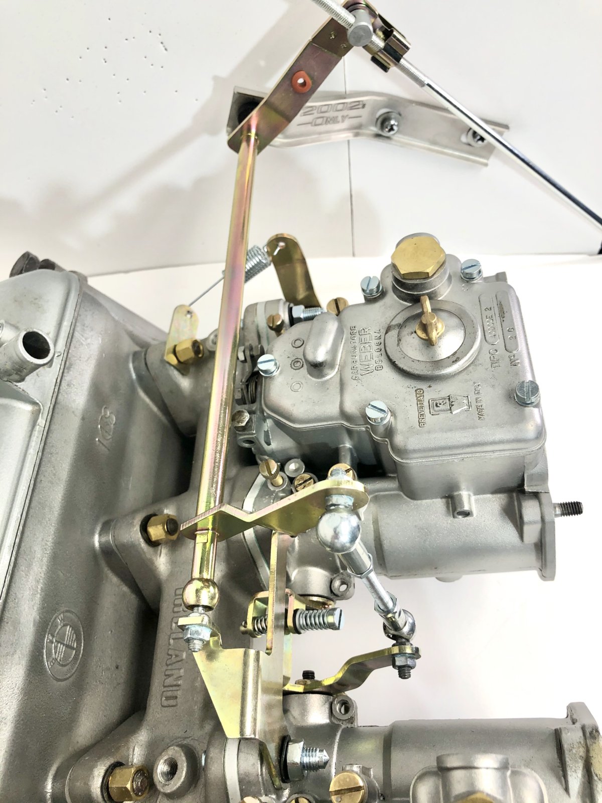

I have just finished designing and producing a triple side draft linkage system just for the M30s you might be interested in. I've already made a similar system for the 2002s based on the original BMW 2002ti side draft linkage system and we have been selling that for a few years. I will post photos of the M30 version soon but here are some pics of the M10 version and our latest batch of linkage parts.

Here's a long and winding thread on my setup:
img_7987-1-jpeg.109799
Steve, love the look and function of your intake system but the German in me is driven crazy every time I see your set up because the air filter housing is not square to the engine. The technical side of me tells me why but, like I said, that other part of me goes crazy Ha Ha
Thanks, Rick
Hah yes totally agree but it's the fender adapter bracket and having to avoid a/c hoses which accounts for that. Were the housings ever perfectly square to the engine?
Thanks, Rick
Steve--Now that you have some miles on your VGS intake system, is the car performing better than before? Don't forget to tell Alejandro that it will take him a couple of decades to get the triple carb set-up that you now have....
I love it, the performance improvement is mostly coming from the euro pistons I installed just prior, along with the VGS/Webers and Schrick cam it makes a beeline for the redline like never before. I take peace of mind knowing that I am getting fresh, undisturbed air to the carbs, so much that I have been able to drop a size on idle jets from 60F17 2x120 air bleeds to 55F17 2x105 airbleeds with better AFR numbers. From previous experiments I have seen, under certain circumstances, the airflow (or lack of) in the engine compartment can affect the timing of the main jets front carbs vs. rear carbs. Mostly from the old 5 blade fan and choice of air filter. The only downside is the intake noise is muffled slightly, but I love how it looks so small price to pay :cool:
Looking forward to your production version, I am collecting parts for a conversion at some point.

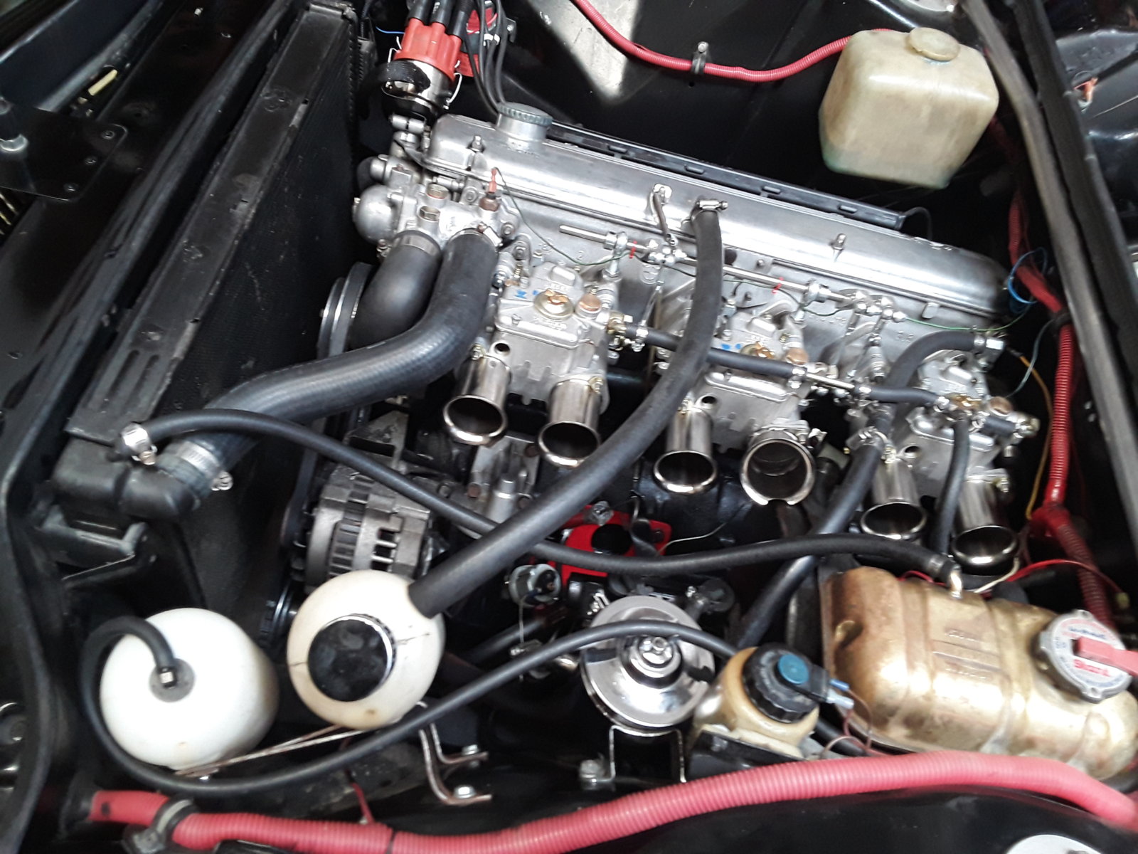

I decided to put triples on mine also, I really like the plenum Steve has
I had side drafts on my 2002 a long time ago and hated the foam filters so that was the one thing I wanted to avoid

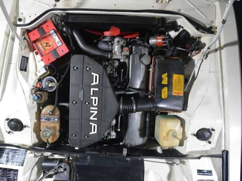

I bought the replica Alpina plenum
Several people told me the stock brake booster would fit, in my case it didn't
You will need to do something with the thermostat mounting, the offset block that @Markos found is a great solution
Some people say use 40s, I went with 45s, I had 45's on the 2002 and a few people I knew had them on 3.0 and they worked well

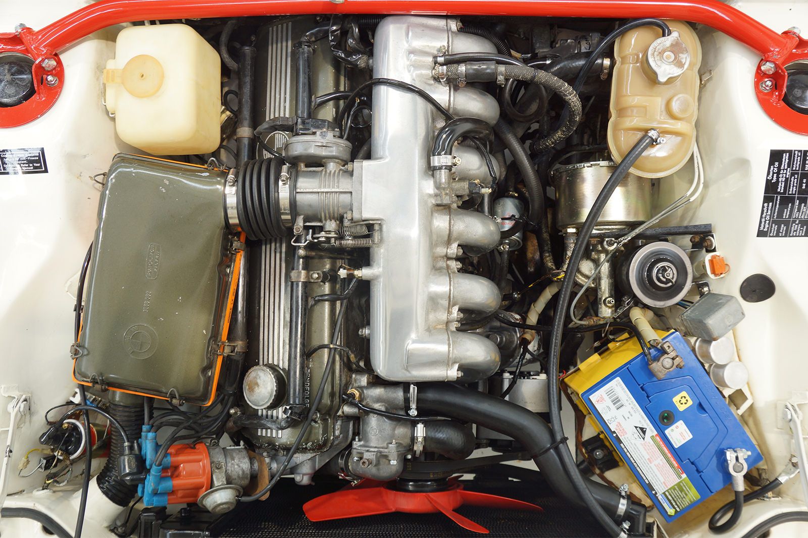

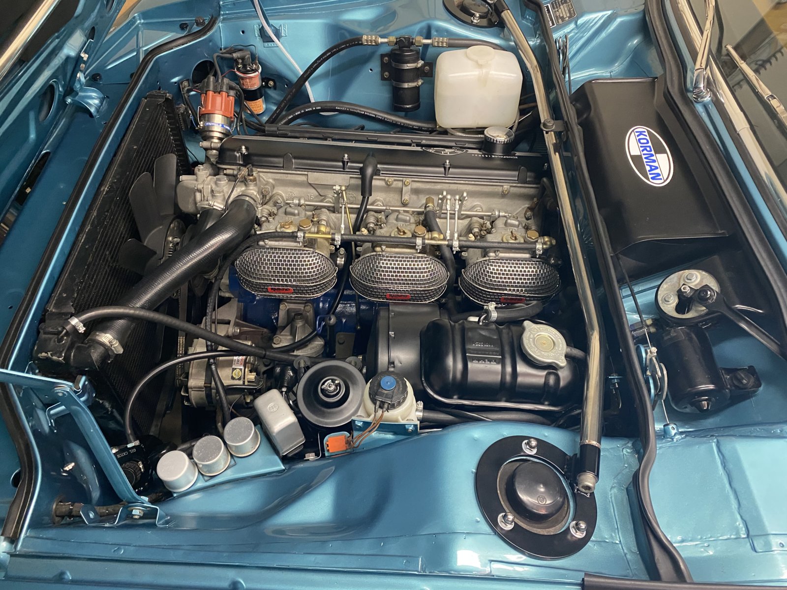

Hi Alejandro - Weber DCOMs, Korman intake manifold and tstat housing, tii brake booster, and reproduction Alfa Romeo GTA air horns. This is not entirely up to date: I no longer have the return springs and/or the fixed fuel rail.
Why did you decide to take off the artisan fuel rail?
