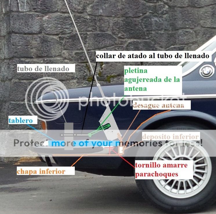

I had one with the antenna like deQuincey's...since it ran into the trunk, if it has a problem, it's easily accessible, except drivers' side (US) so no fuel filler interference.
I agree with the period visual lyrics as deQ mentioned, but Dr. Robs' logic is spot-on.

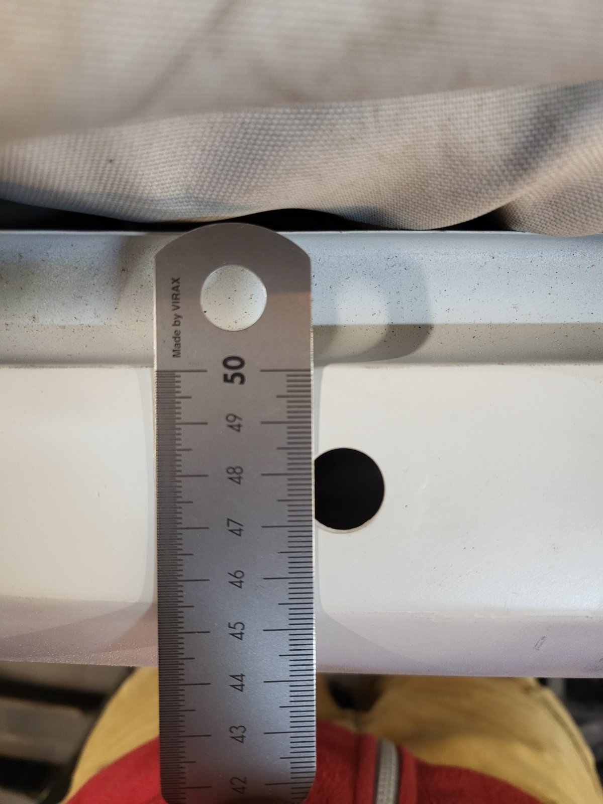

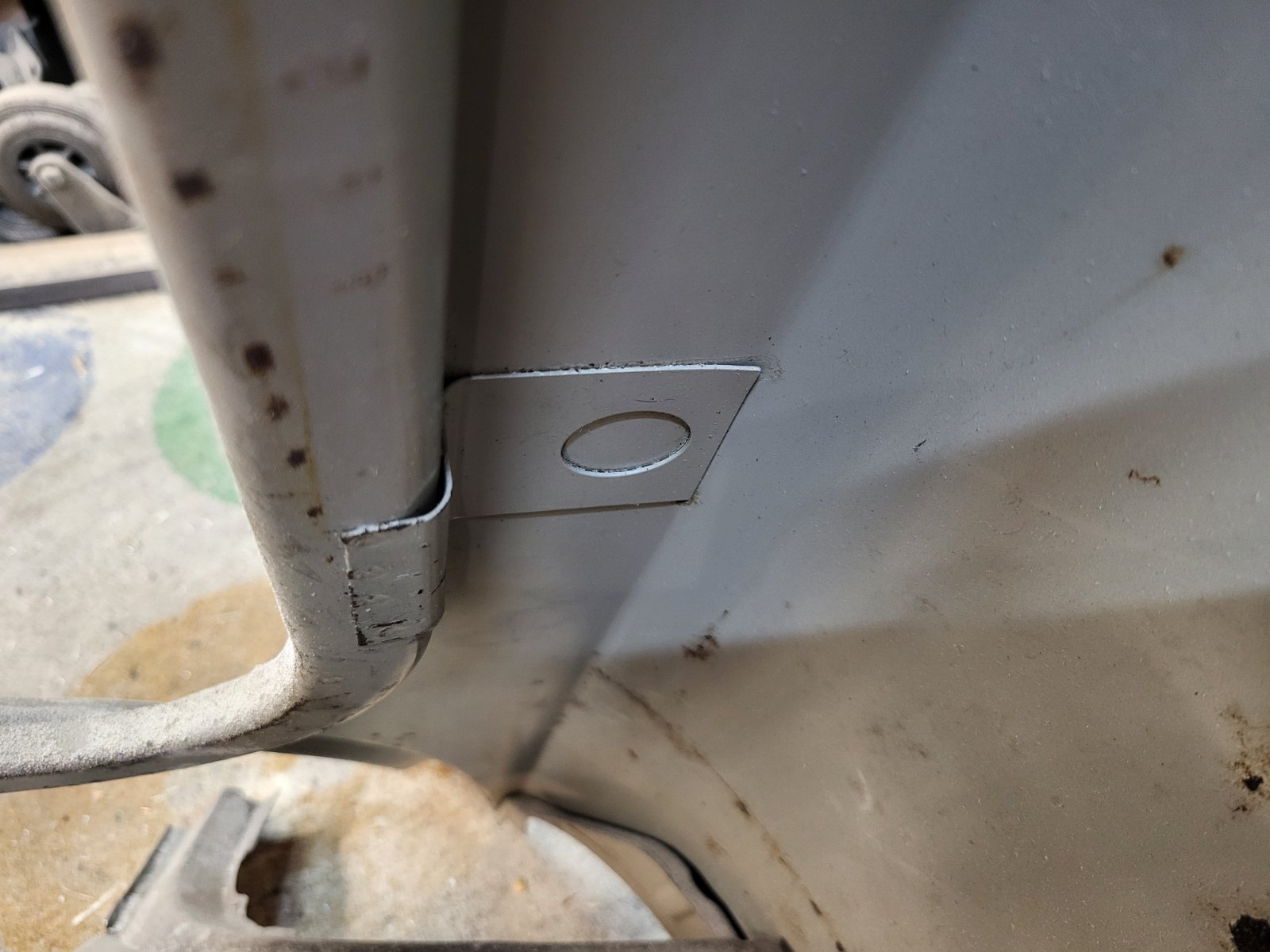

This dimension is a little too far forward. The antenna area is tight and the mast goes straight up.

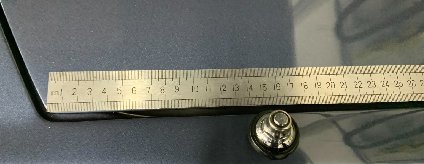

On driver side rear. I have a switch to turn off the antenna motor as we rarely use AM/FM. Wish I had the hole filled in before paint.

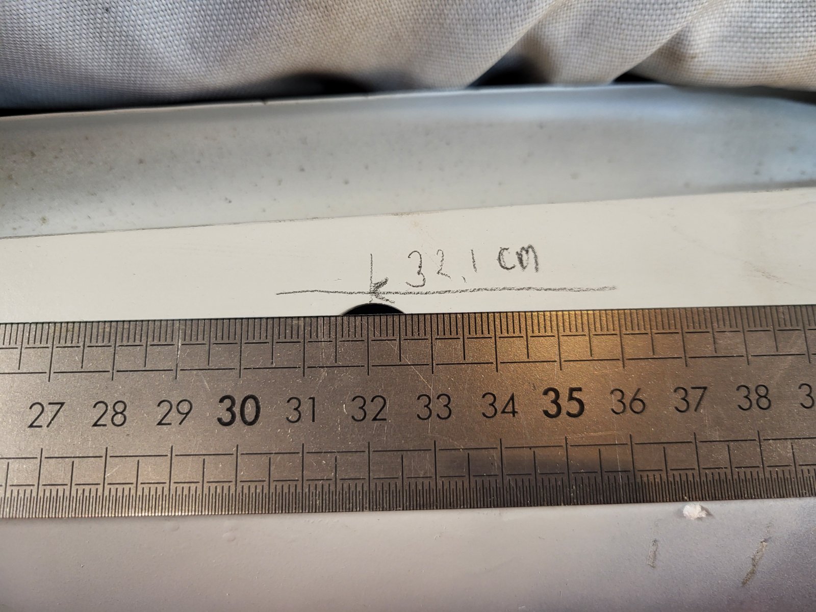

Perfect! Thanks Erik and everyone else for their input.

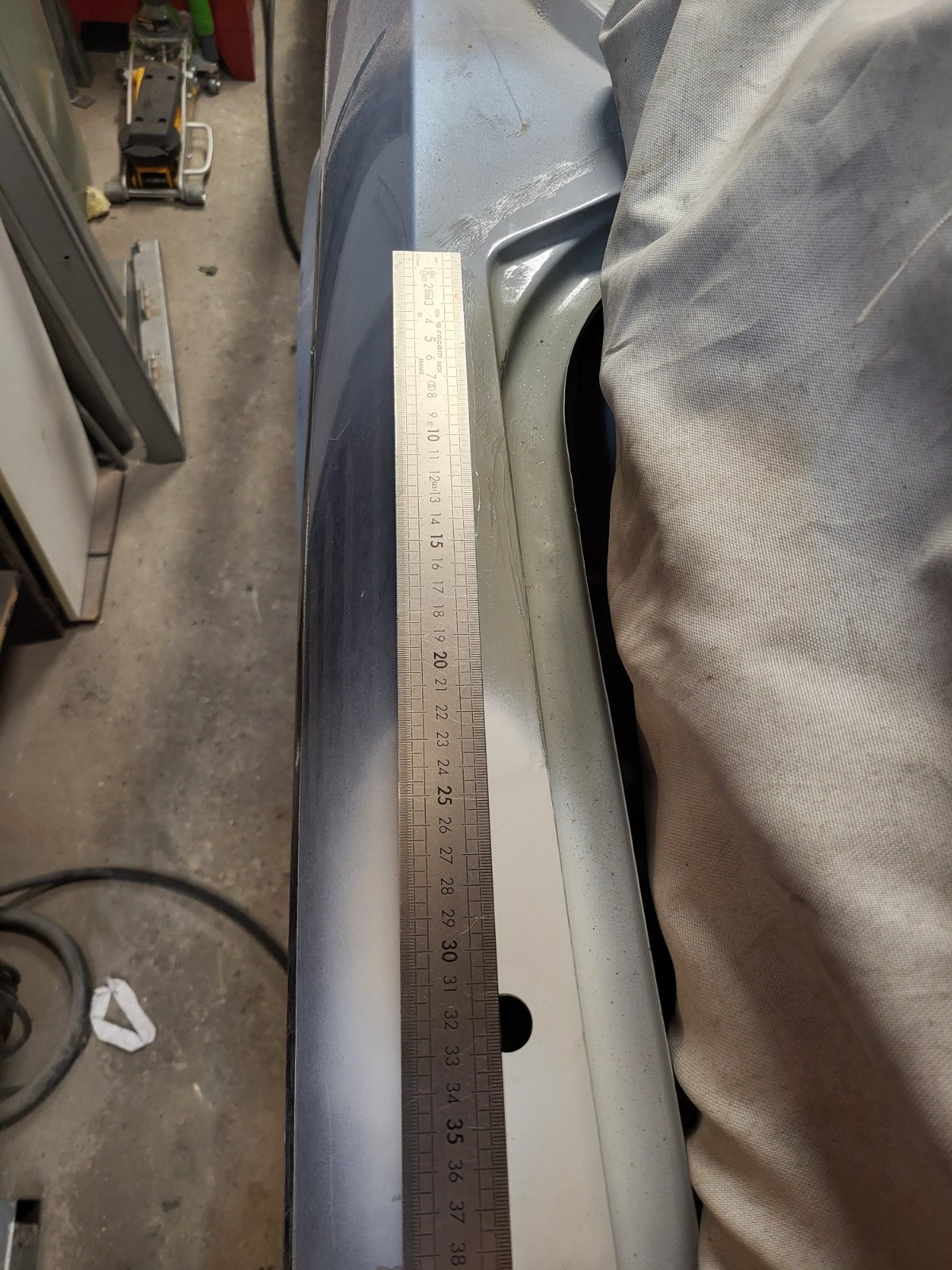

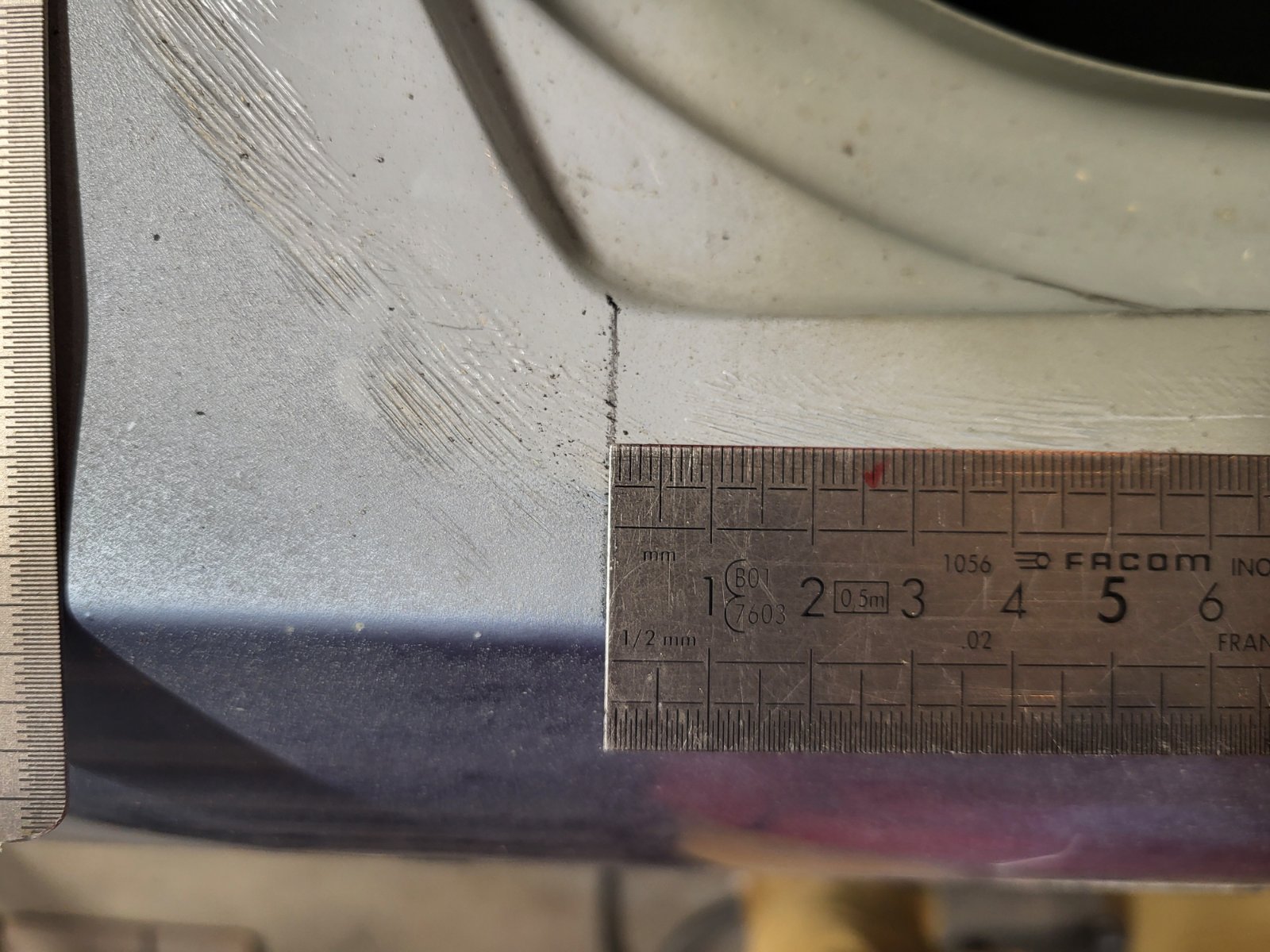

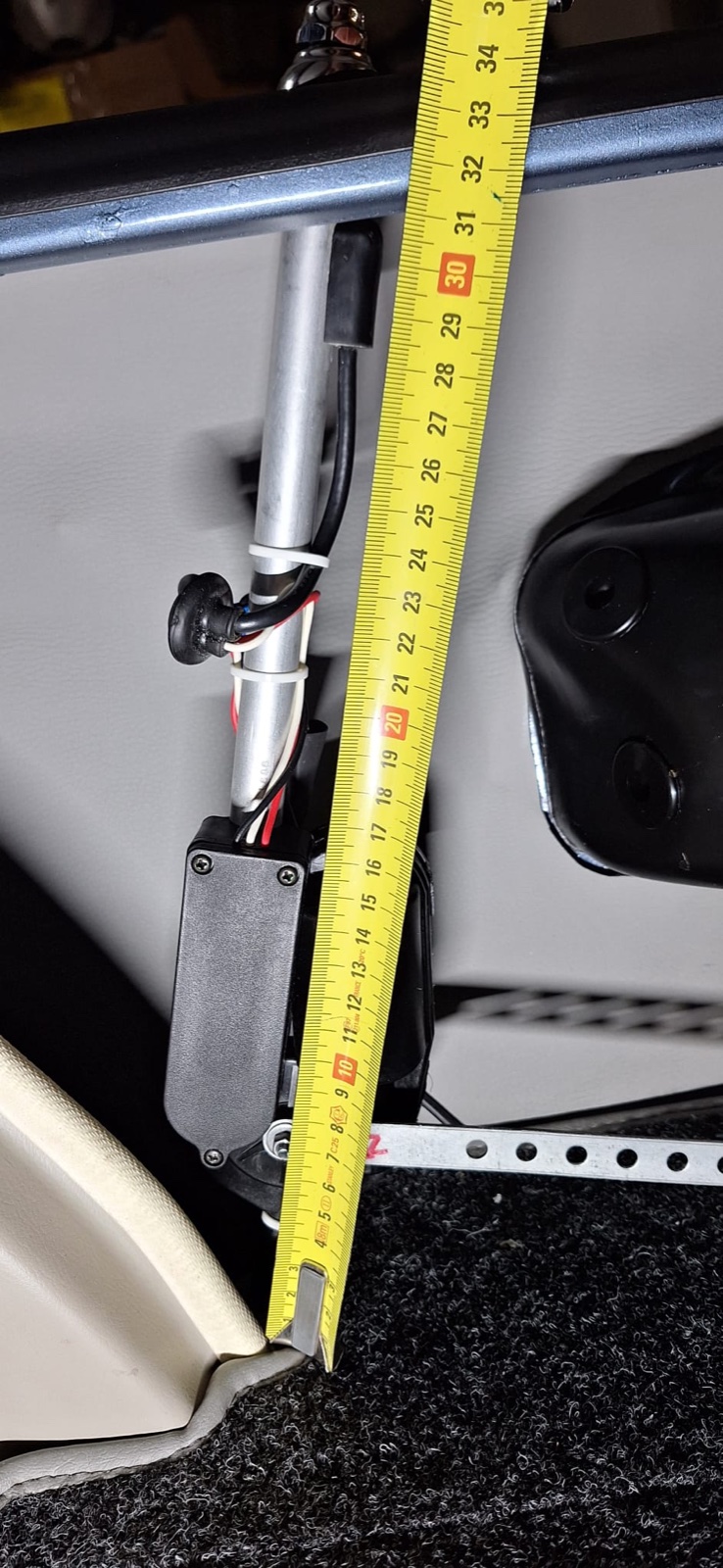

I have the same position hole as @eriknetherlands but in my case it is 310mm from corner, and in the contrary fender rear RH

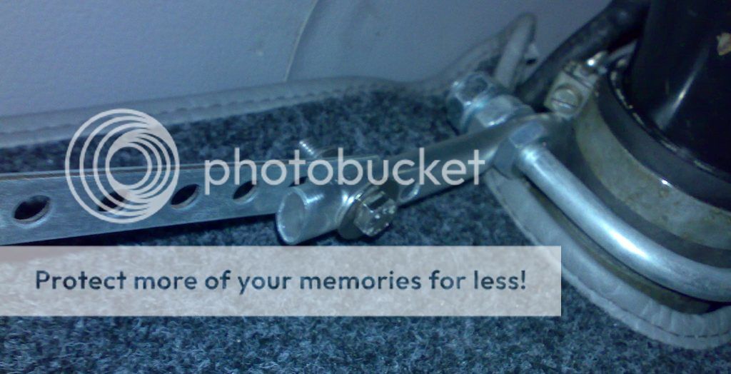

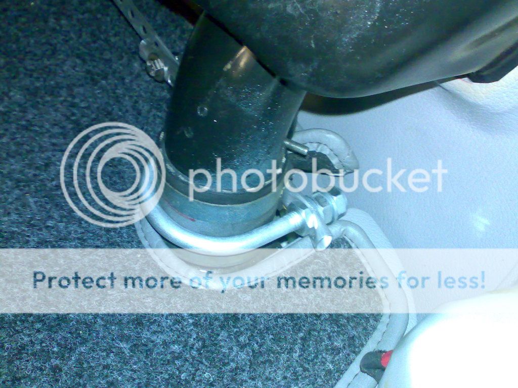

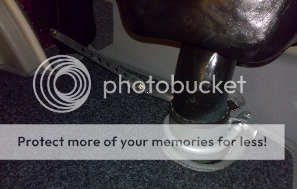

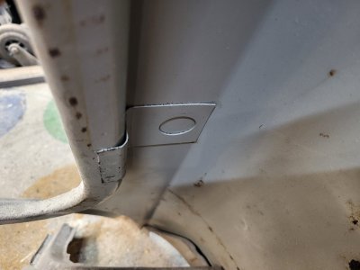

My setup seen from inside….
