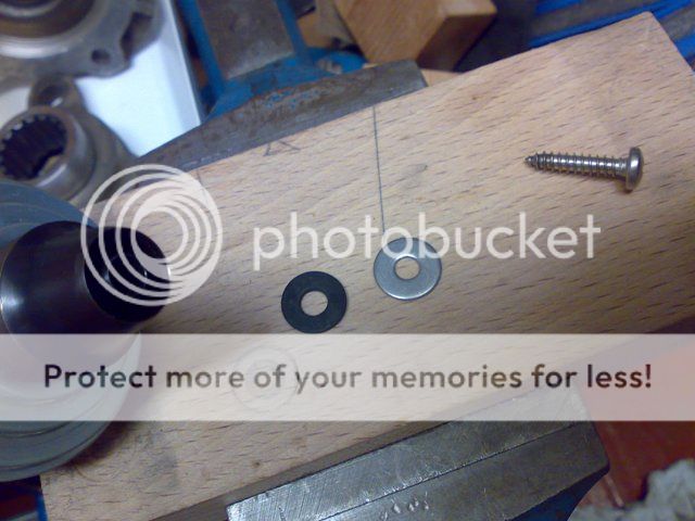

i have a good number of these metric sheet metal screws, in many different sizes, and when that finishes, the industrial hardware store is located next door
lets say that i remember using sligthly bigger screws for a better and stronger fixing
to tell you the truth i do not remeber which ones i ended up using, and that counts on the length also

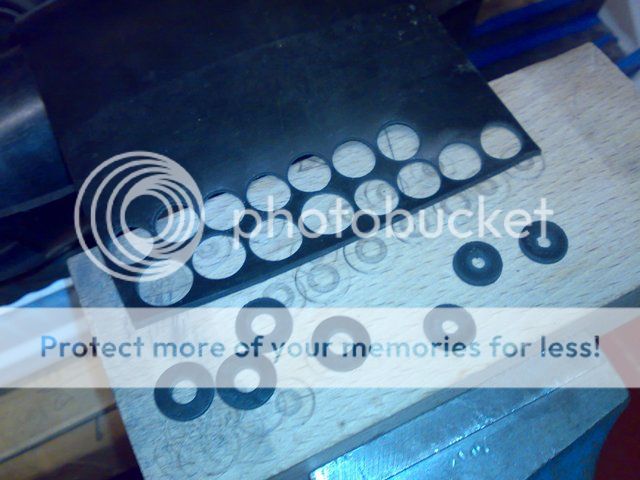

those were ss screws with rounded phillips head, together with professionally home made 2mm thick rubber washers and ss washers on top, to respectively spread and accomodate the force
yes i will meassure them, and if convinient to you i can prepare a set

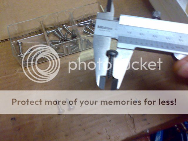

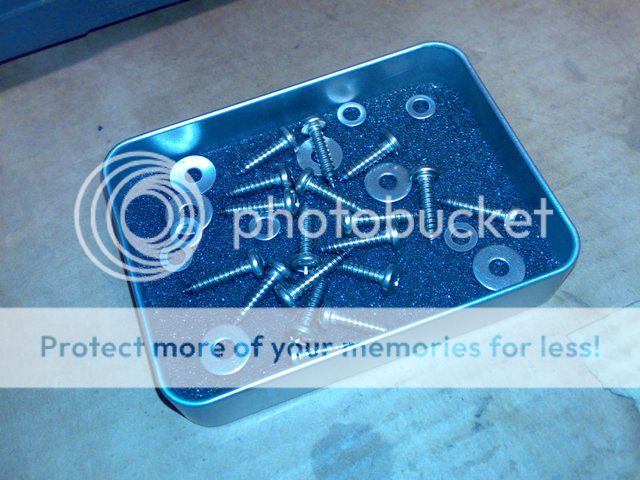

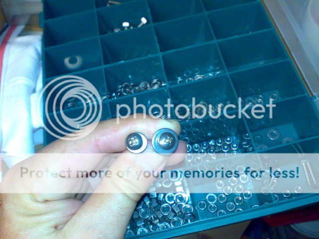

finally after some checks (mr ecchappe checked a 4,2mm hole in the sheet metal) i can confirm that the right size is a metric screw 4,5mm external thread diameter plus 20mm lenght
it can be fitted with small or big ss washers, i recommend the bigger ones for a better support
Hey deQuincey, thanks for putting the kits together for your fellow coupesters. One word of caution though, I suppose many coupes' tool tray fastening screws have been replaced at one time or another throughout the decades, just make sure the holes have not been enlarged already with bigger screws being used. It will be pretty frustrating to get the kit and find that the screws are too small.

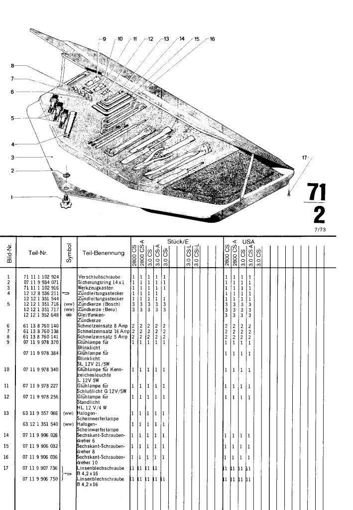

Found two part #s for the screws in the orange parts book:
07 11 9 906 750--LIN BL SHR B 4.2X16mm
07 11 9 906 752--BL SHR B 4.2X19mm
Some revisions in the current white binder parts book.
