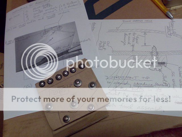

this was originally prepared for a forum friend that confirmed the size of his holes
yes, in any case the user of the set should check that his holes are 4,2 or up to 4,5mm maximum, that was also my case
if they are larger i would propose other screw size
i am including two length sizes to take care of the extra thickness of the six lower screws,
i am providing a metric size drill bit of 5mm also to accomodate the holes of the tool-box to this new screws
it works !
the first set is ready:
even with instructions

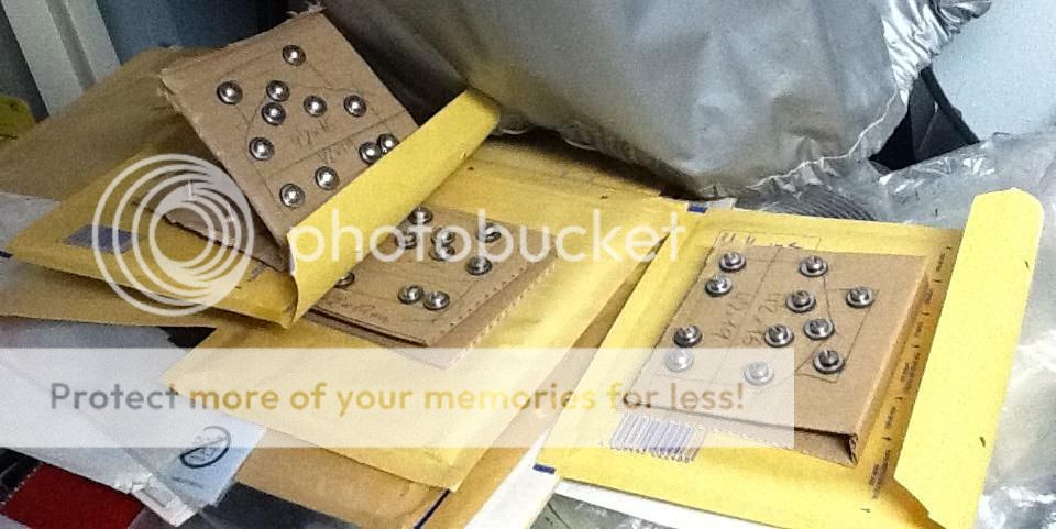

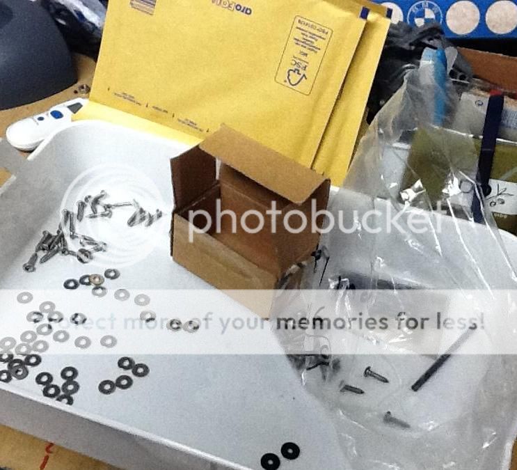

hi, three more sets are on production now, but i would prefer not to come back to this almost every week or so
i would appreciate if anyother is interested to tell me this week, in which the shop will receive a new shipment of screws
regards
the final ones have been produced and ready to go
it has take a while to set aside my duties and to go into this, to be able to finsh them
so the last sets have been finished and the address writen in the envelops
they will depart on monday, everyone that has ordered a set will receive an email with the tracking number

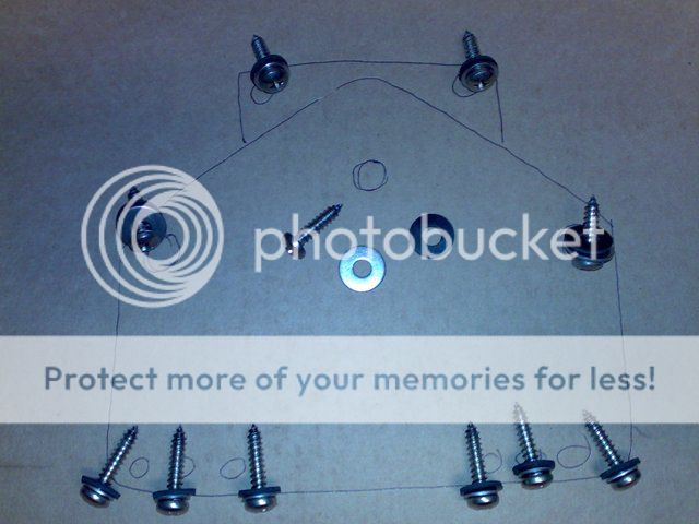

the set comprises short 16mm, and long 19mm bolts (exact according to the specs of the orange books, thanks to bert, now we are following the specs), as you can see the bolts are presented in a cardboard, please use them in their position, they are ready to use, with the washers on
