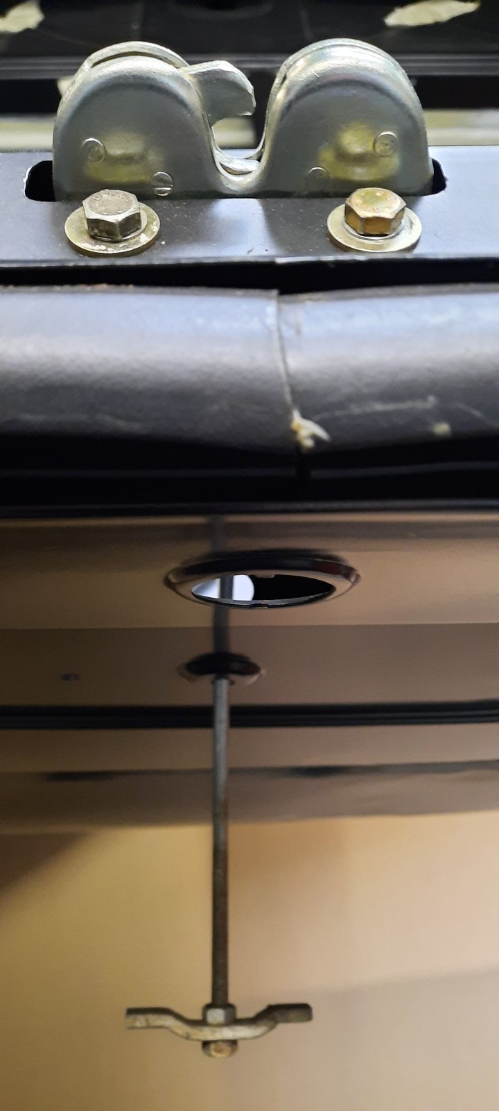

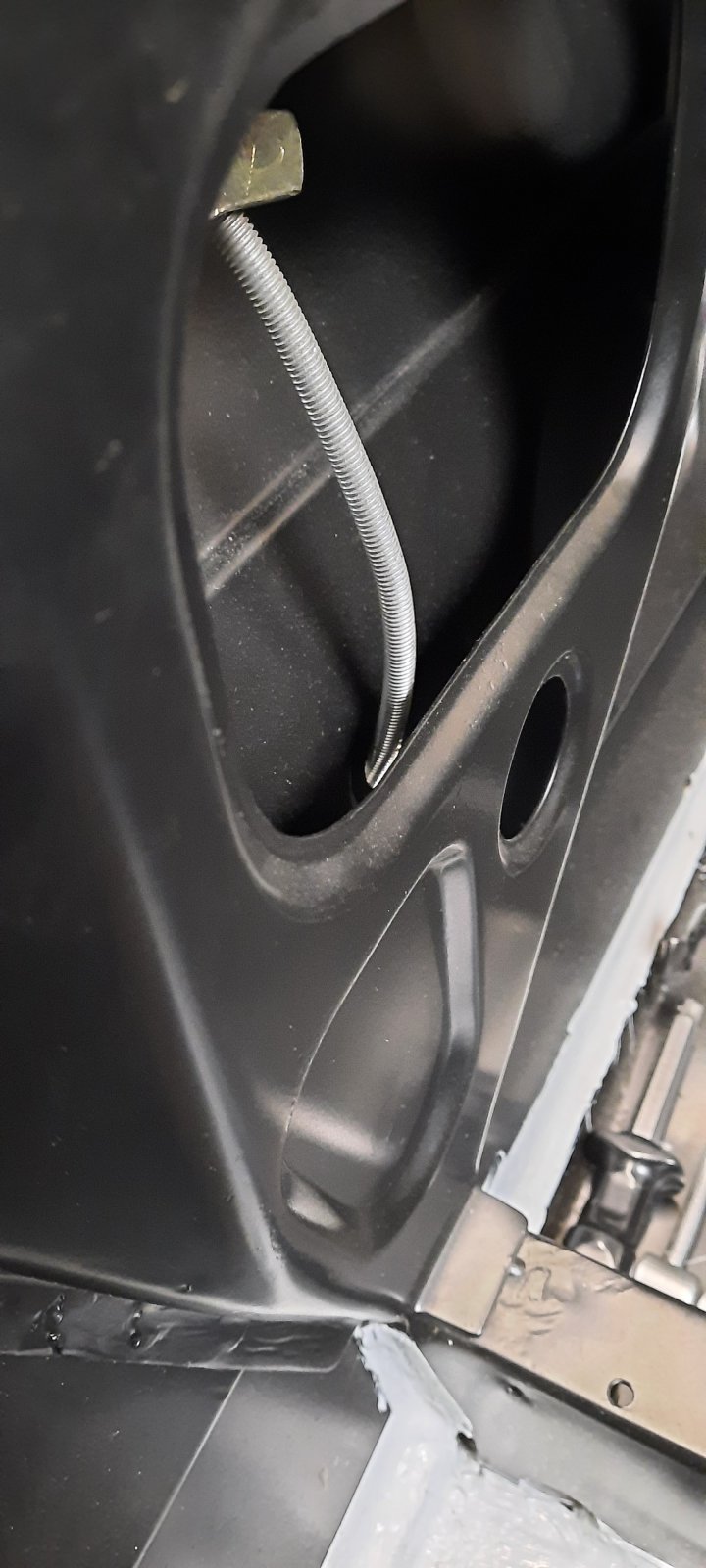

Well, "geht nicht? gibt's nicht!" as we say.

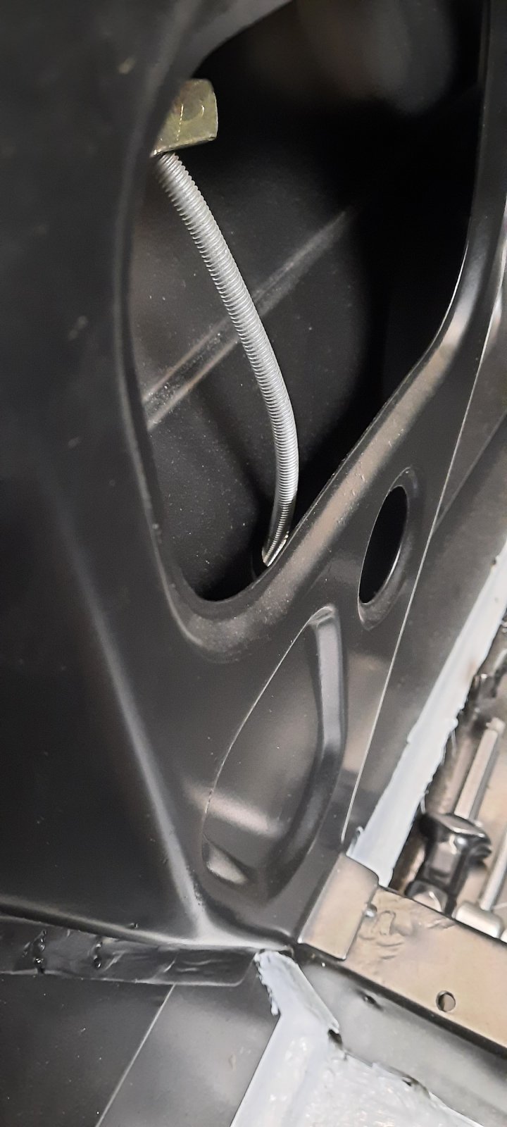

There is a small hole below the lock. It's used to fix the number plate's mounting frame and it''s cover. If you manage to dismount that you get access to the inner side:

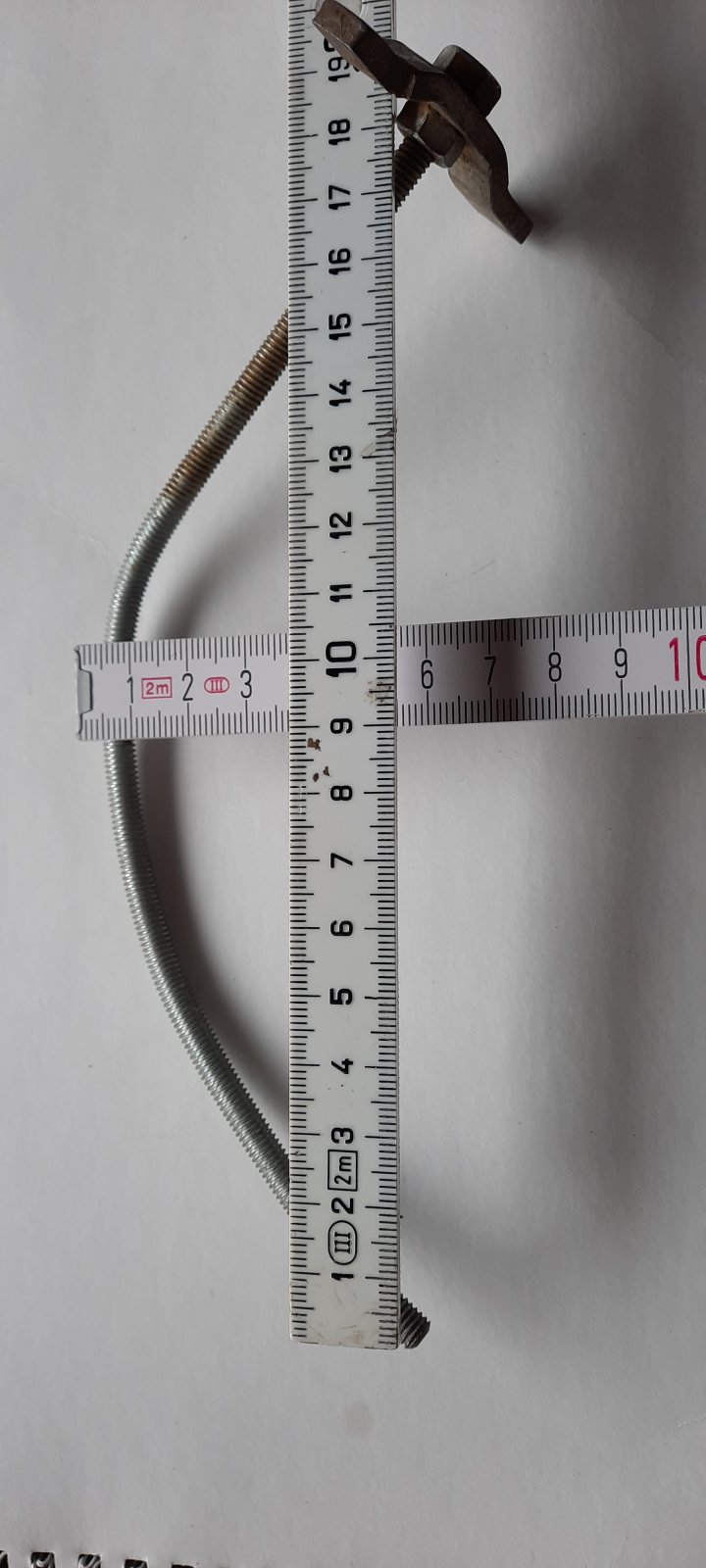

I used a M6 threaded rod to reach the position of the lever, bended as shown.
It may take a while until you reach the proper point to press the lever forward, but: good luck!

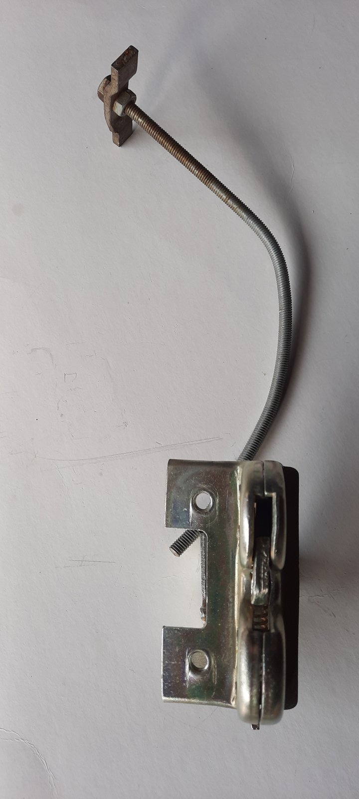

Thanks TomHom! Great info! I’ll attempt later today and post results.
I can see through the gas filler recess (with the rubber inside piece pried aside) where the lid attaches to the latch mechanism, but not much more due to the trunk interior covers. Between the photos and an extra latch mechanism i should be able to figure it out without any damage.

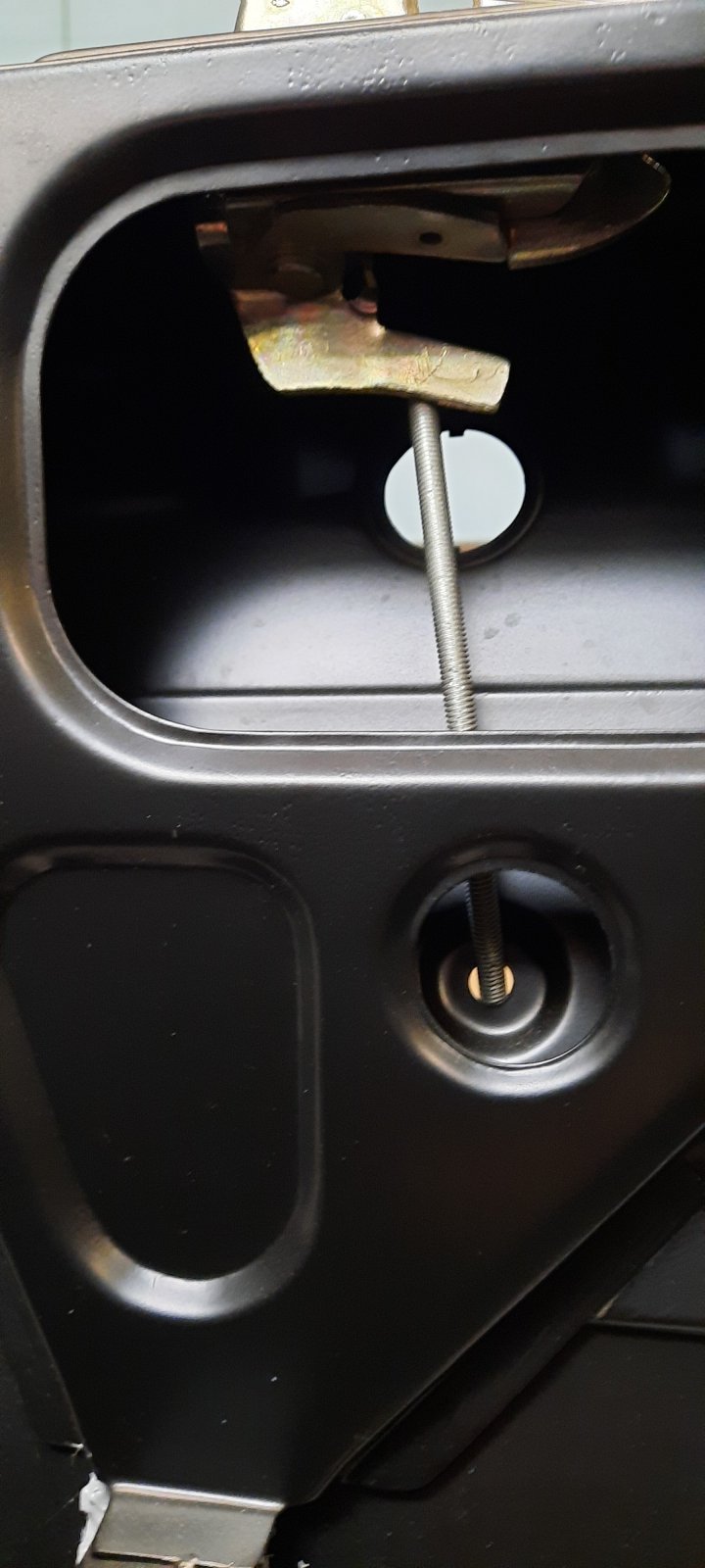

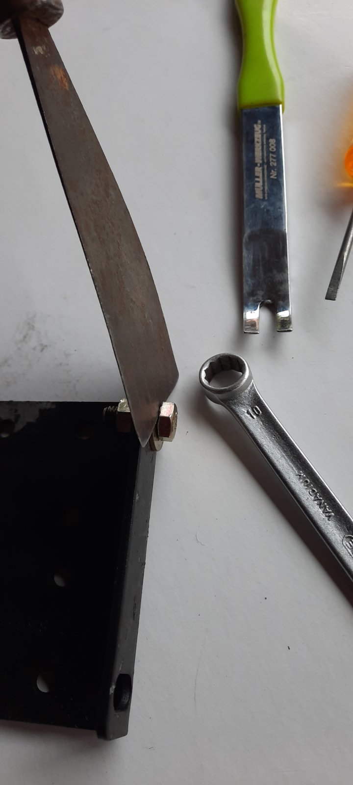

Hi,

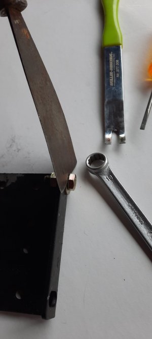

you might have problems removing the screws
because you cannot reach the nut. Try to force the nut to the housing (so it is not turning freely) by putting the screw under tension:
20231024_163019.jpg example picture
First by using e.g. a fine putty, then a fine flat screw driver and so on
Good luck!

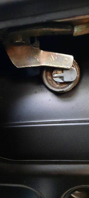

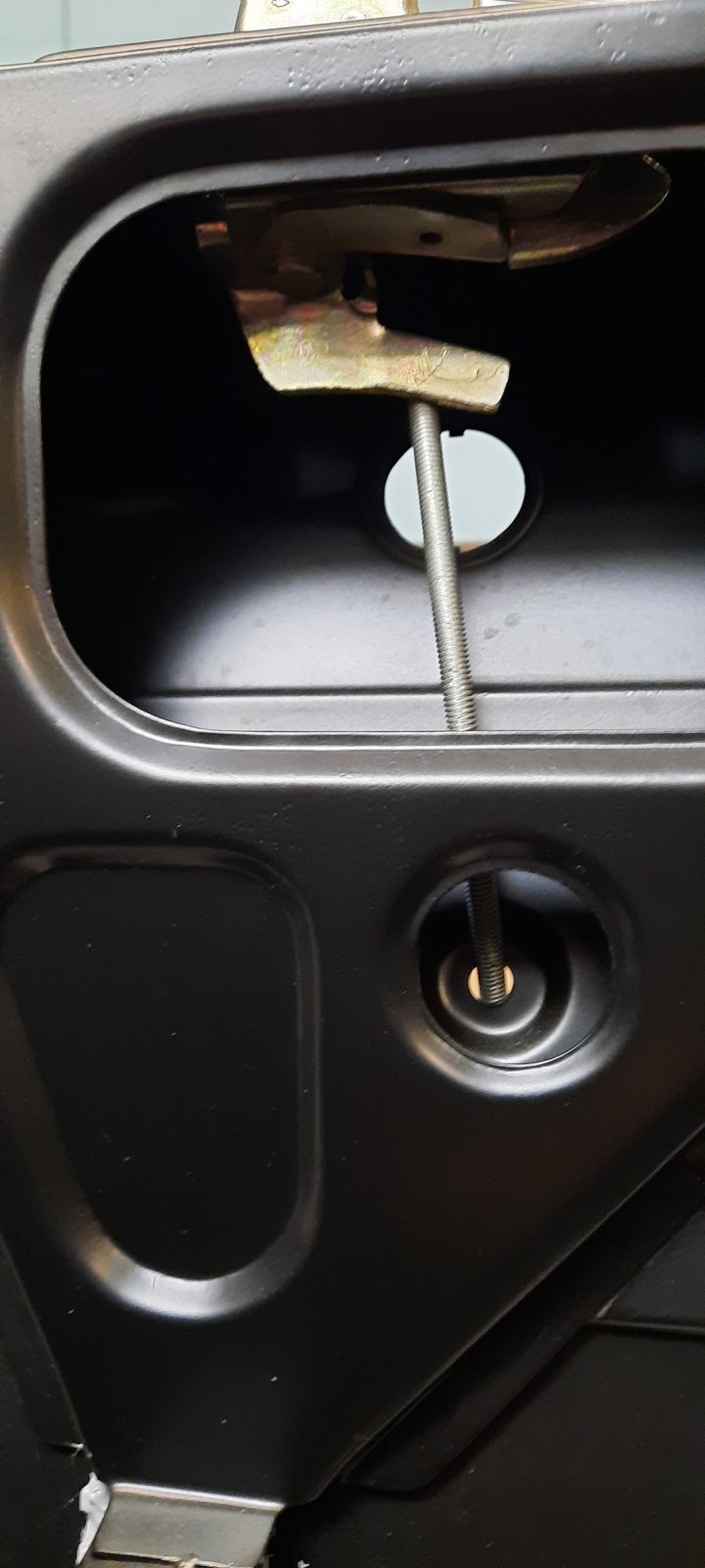

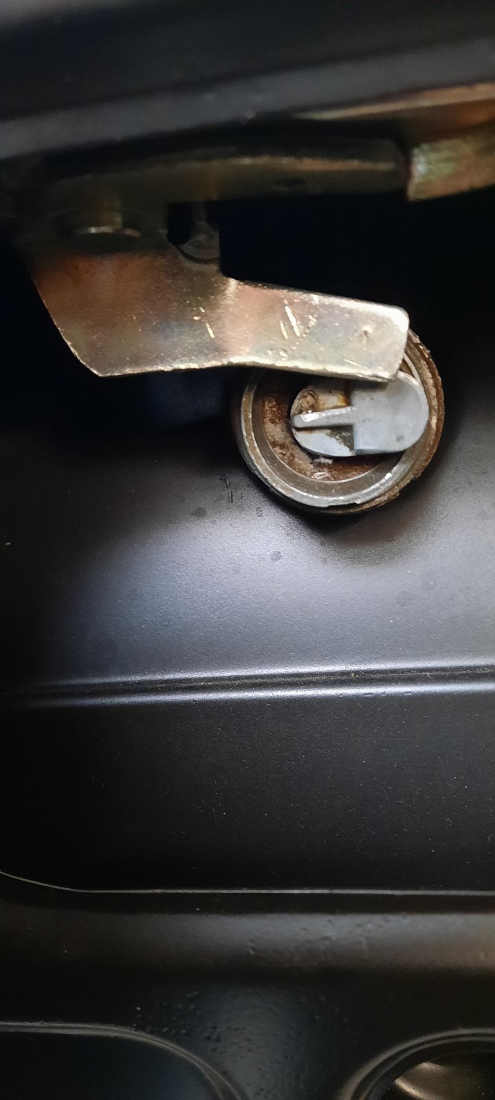

Hi,

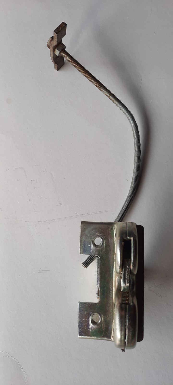

here you can see the small nose which is supposed to push the lever forward. The position shown is 3 o'clock for opening. If this nose is broken completely: no chance! If its broken partly try pushing at positions between 3 to 6 o'clock.20231027_114116.jpg
Good luck

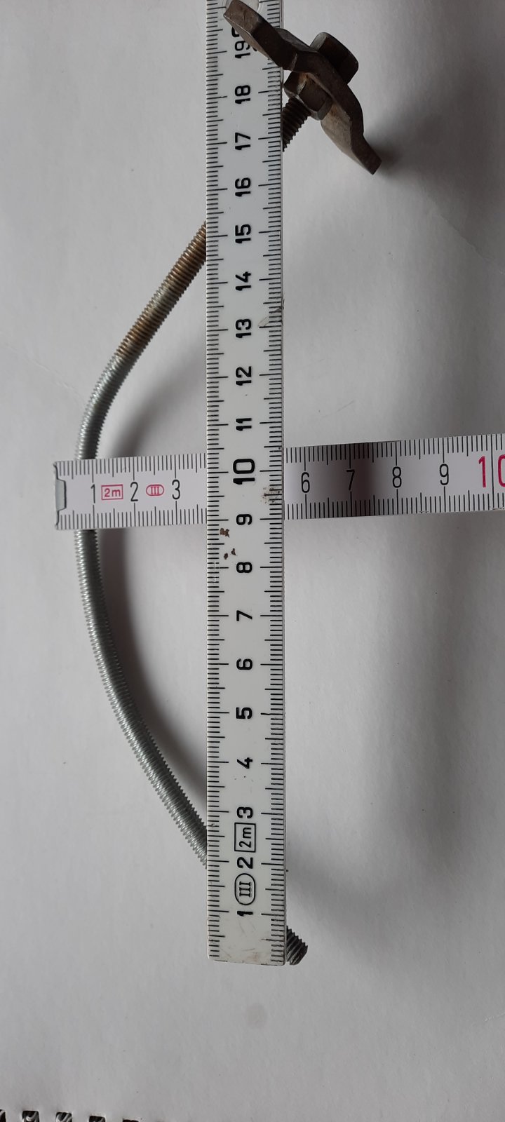

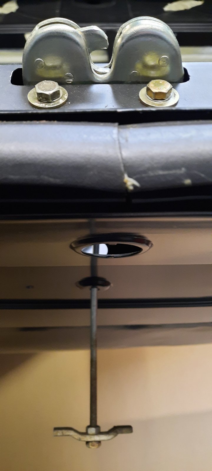

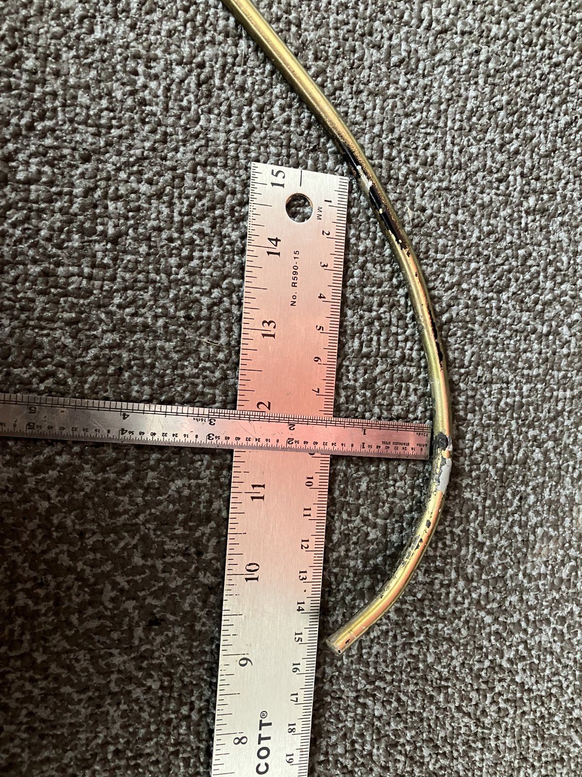

Well I did what Thomas recommended, removing the bolt that secures the chrome license plate mounting panel, and using the 0.5cm rod as shown below I adjusted and wiggled and waggled until I could reach the latch release tab, pressed it forward by lifting up the rod, and it released.
For my car this was caused by both a finicky lock and a loose latch mechanism.
