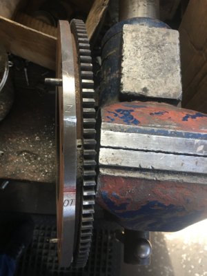

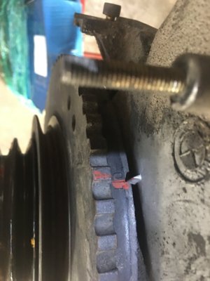

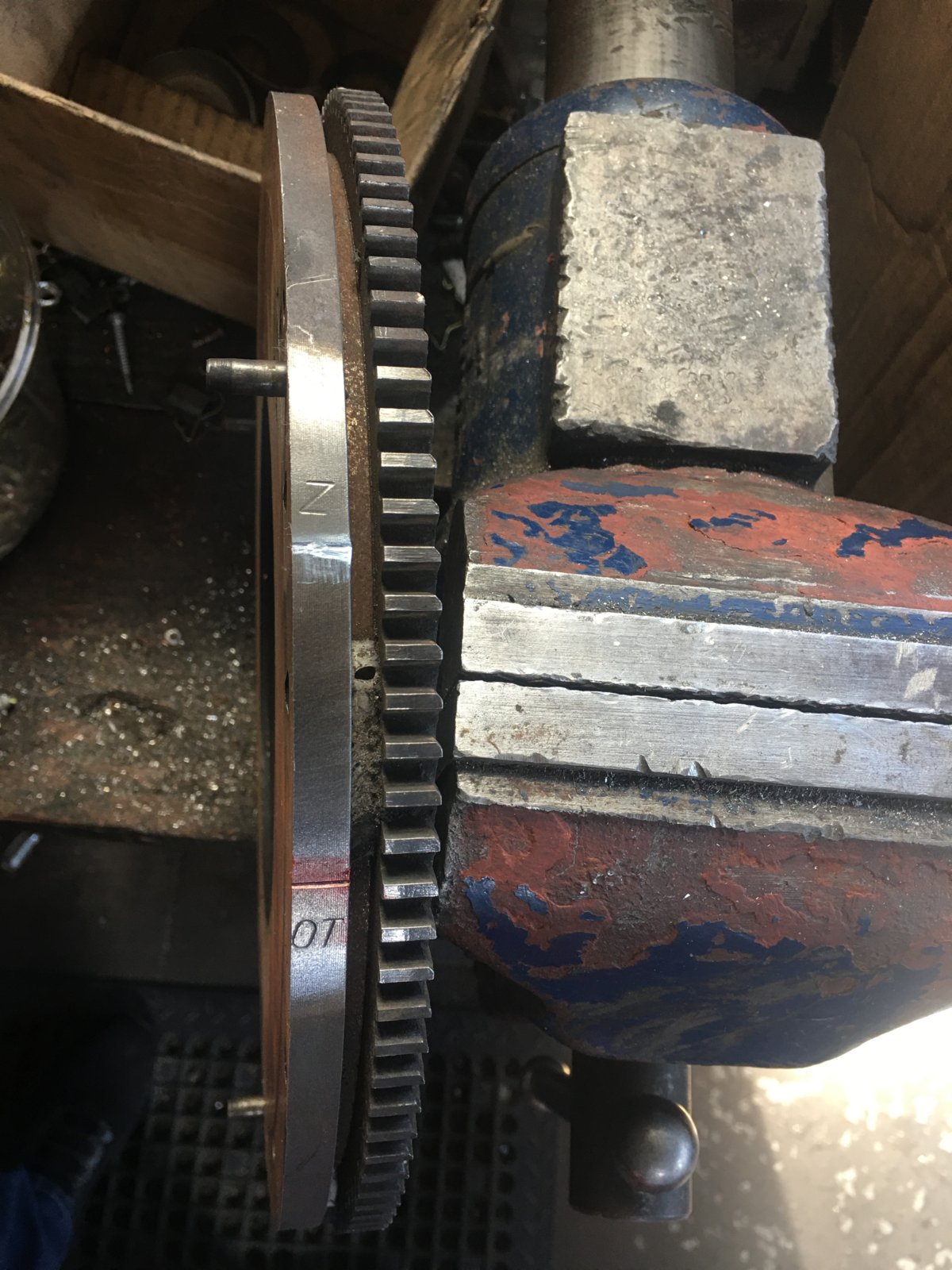

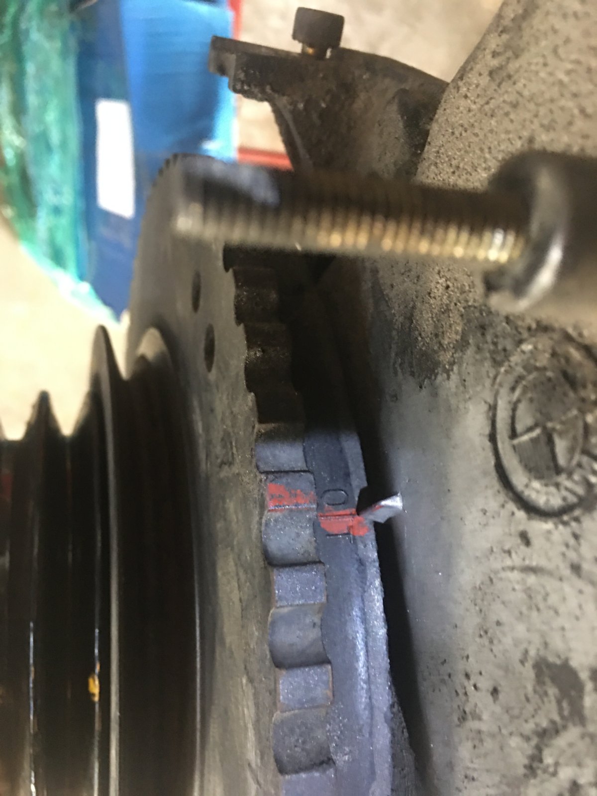

sfdon I need to clarify the timing marks. At OT on the crankshaft damper and flywheel, the ball mark for timing is 7 teeth BEFORE (CCW) not after, if I push the car ahead from the OT marks in 4th gear nothing found. Please verify.
TO on dampener matches TO on flywheel
Always verify for Top Dead Center.

Z mark appears in bellhousing opening when properly timed (7 teeth, 22*, 2000 rpm)
