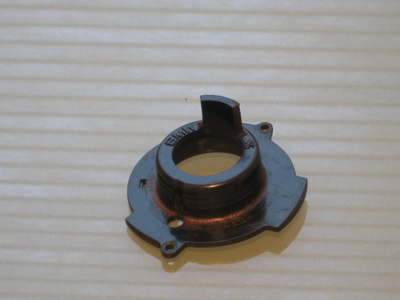

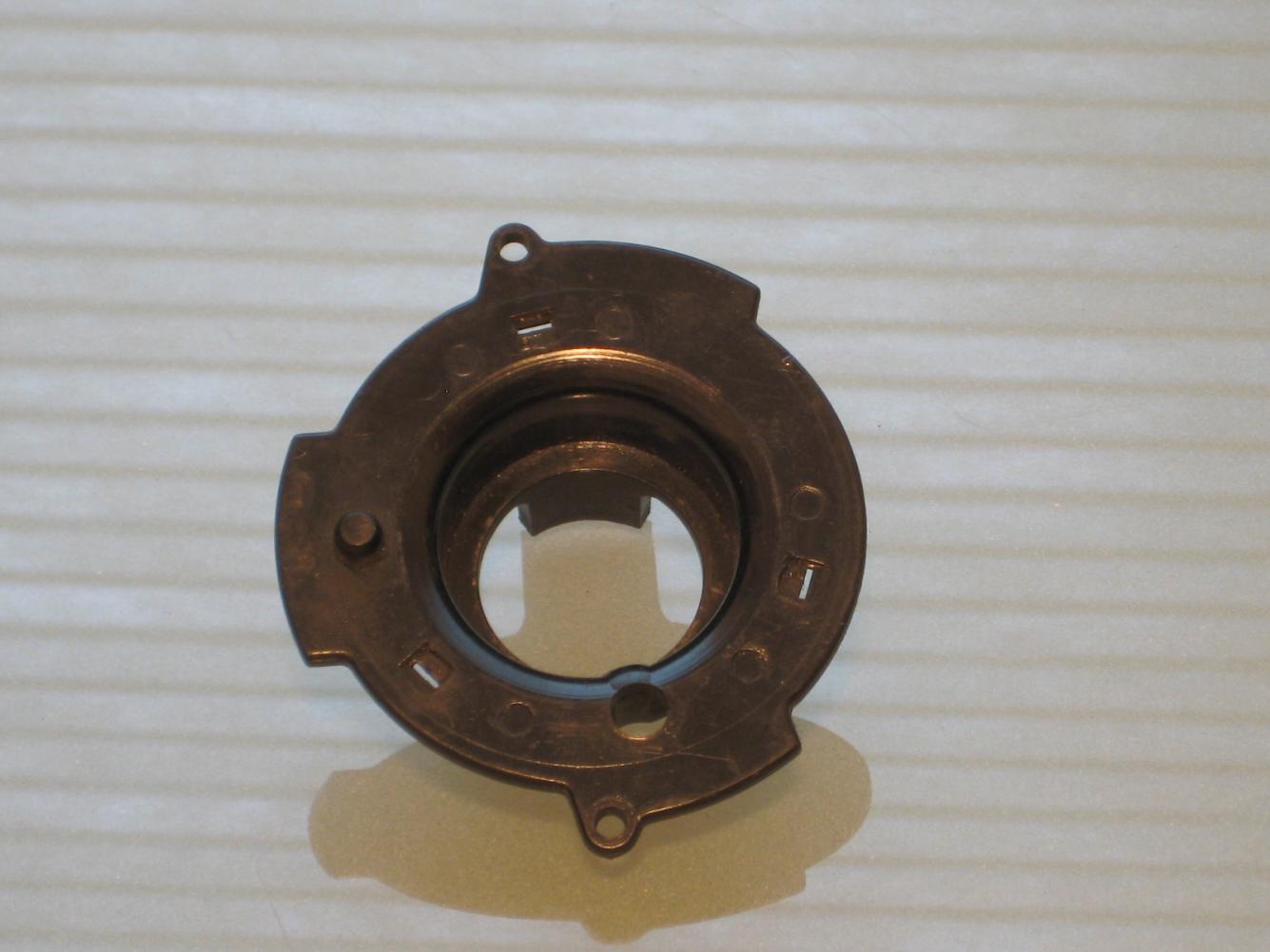

I had this one on my 2002, I am not sure it will fit but if we can verify the dimensions, I can send it to you.
Cheers,
MF

Let us know if you can't find one- I don't think the one from the 2002 will work but you could probably make one real easy. I have to pull my wheel off - hopefully tomorrow and I'll post some pictures, it's pretty thin stuff, kind of like a washer with a tab on it so one could be made pretty easily.... I think :-)
Peter,
I think mine was an aftermarket from another year/type of BMW (320?). That's why I advised to check dimensions....making one would be ideal.
MF

OK, learn something new everyday. I didn't notice the indent at the base of the Nardi hub for the stock slip ring/cancel tab/#8 thingy. But for future reference, my hub came with one similar to m73's photo where the tab is molded to the horn ring. The part number is 1.118.810.2 but this does not come up at realoem or other sites that I checked so I'm not sure what model it was originally made for. Here is a photo:
The metal canceller is press fitted onto the hub. For the pre-74 coupes, it should be rotated to the 3 o'clock position.
