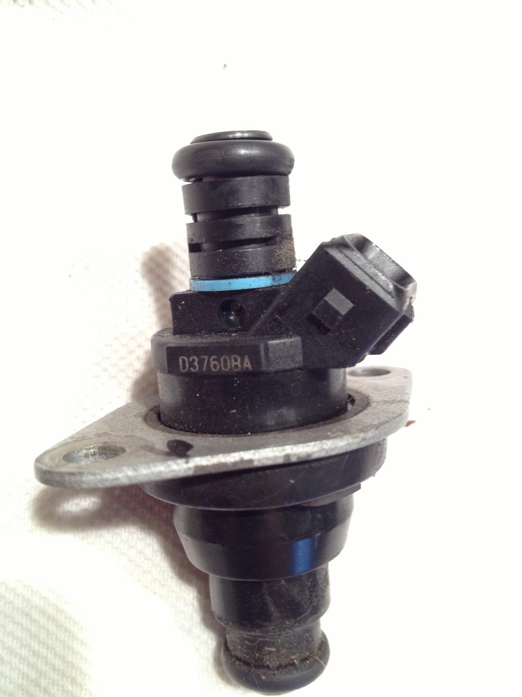

Alan, as Coachkel says, Brody will have a map for you to start with that should get you 90% there that incorporates Paul's cam and their MAF (Paul supplies his cams to them). Before you do anything, make sure all of the ignition and fuel delivery are in tip top shape. After the install, find a long hill on a highway and do 4th gear pulls listening for pinging and adjust the ignition as necessary trying to to get a ticket in the process. Not scientific, but it worked for me. After that, get a wideband or go to a Dyno for an hour (bring your laptop) and get the fuel dialed in. Are you using 19LB injectors or 24s? Mine tended to run past the injector capacity at the upper RPM ranges so I migrated to 24s.

my injectors are the bosch/volvo ones cn uses in his 3.5 motronic motors (pic below). re ms conversion, already made this decision, just a question of time (especially as have sven's help and vast experience close by).
you mention below you went to a 'larger throttle body'?? which one did you have and which one did you change to??
