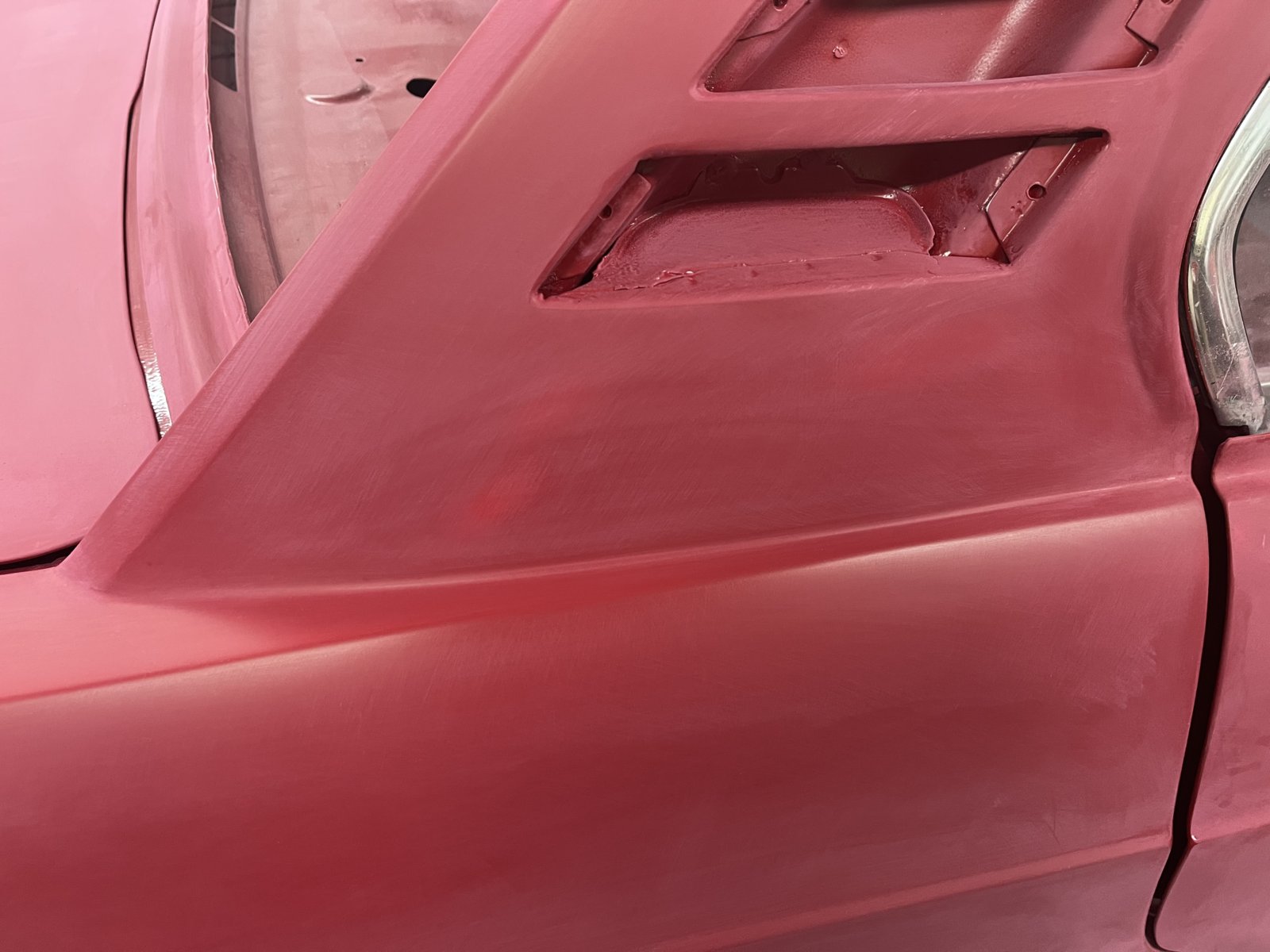

Not underbody but.. How is this area on the c-pillar (slots for the vents) sealed? Anyone got a picture?
