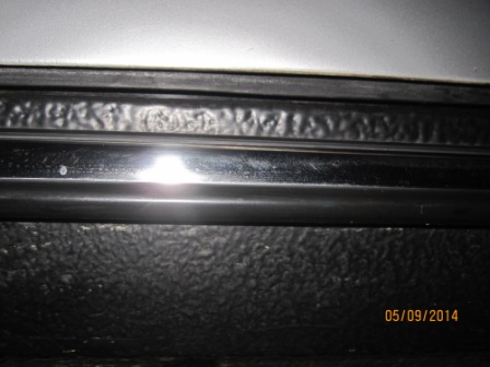

Posting a close up picture on original texture of the outside rockers (from above polaris door and rubber sealing)
Somehow soft surface, but not at all sticky as you could understand :-)
I guess this must be from start the best rust protected piece of metal on this car.
So, when you see rust holes trough this rocker piece you surely could figure it all out what's behind ;-)

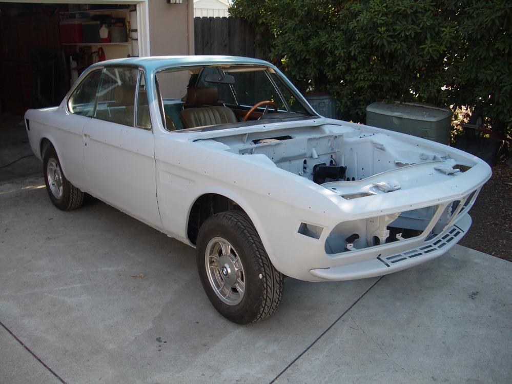

Thanks everyone for your inputs - it's consistent with my observations as well. To summarize: undercoating prior to paint on rocker panel covers, front and rear valence panels.
Here's a shot of the car just prior to delivery to the body shop.....
