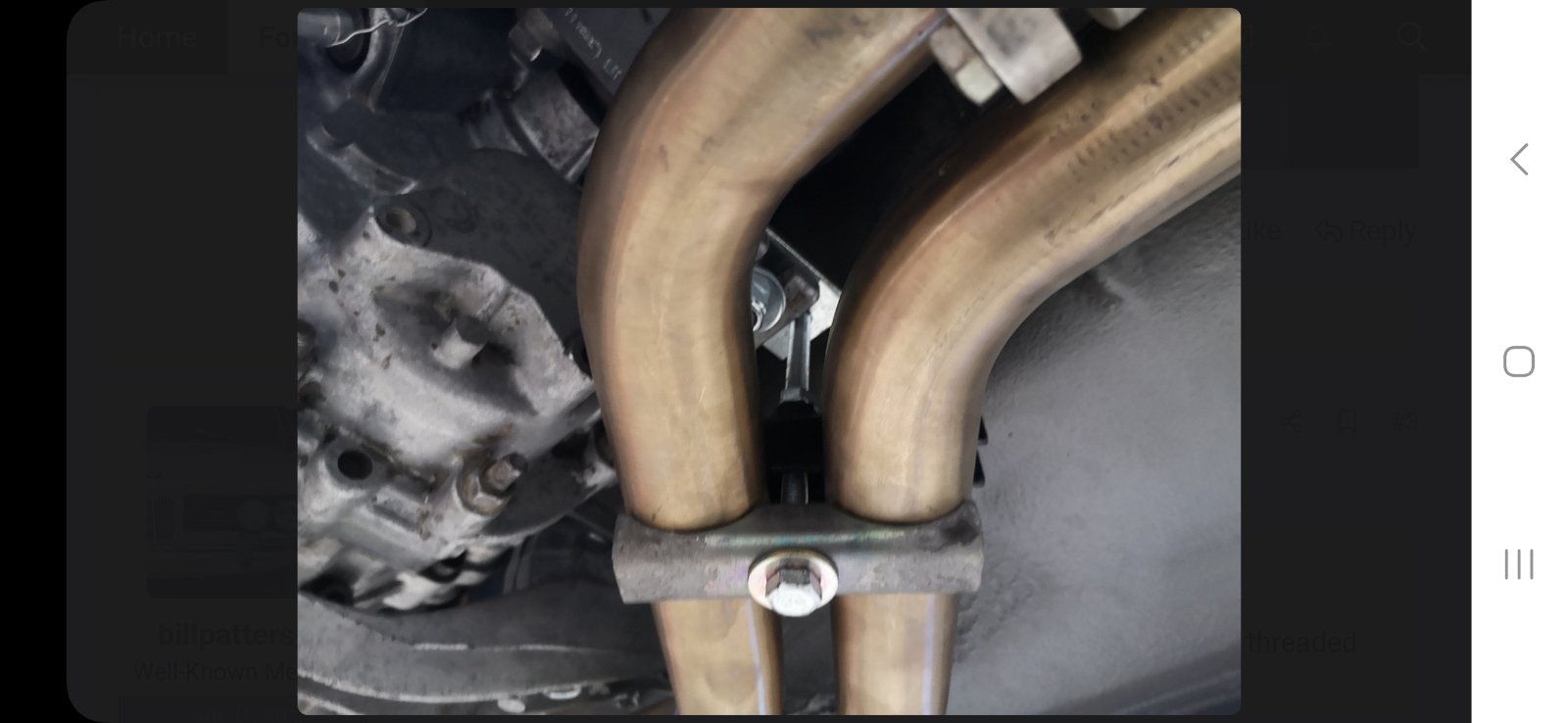

Isn't that just about equal to the pitch of the 2 short pipes on the center resonator?
I quickly searched through google and found this pic. Distance seems to be around half a pipe's diameter.
And I think that with some light force you can find a 2-3 mm's easily, and with more force I think a quarter of an inch isn't a problem.

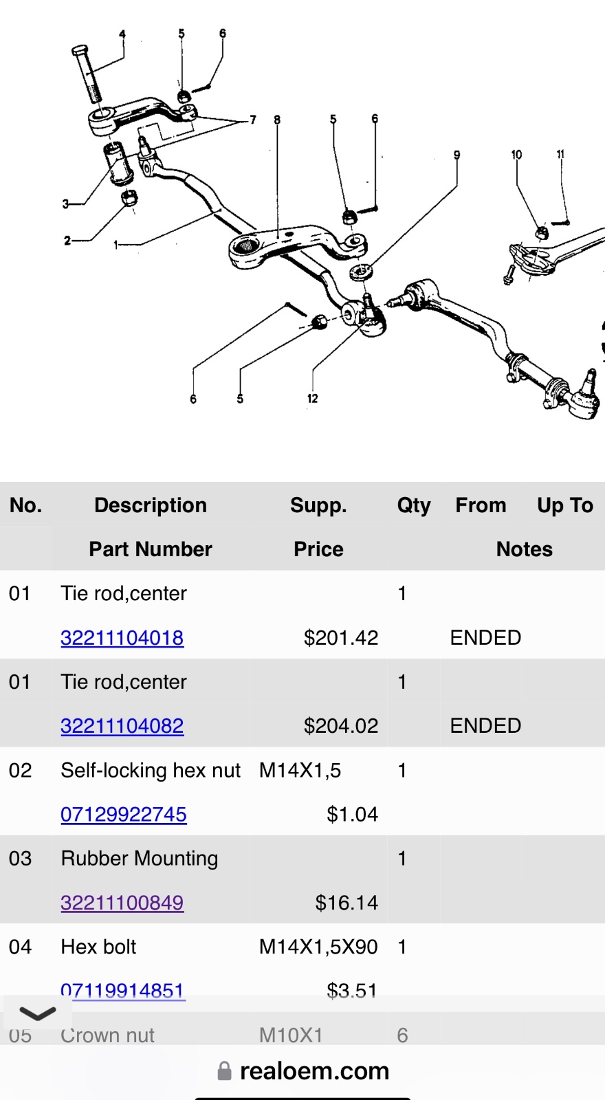

I found that the Idler arm bushing is a little giving. It is just a rubber in a tube so it’s not the most durable part

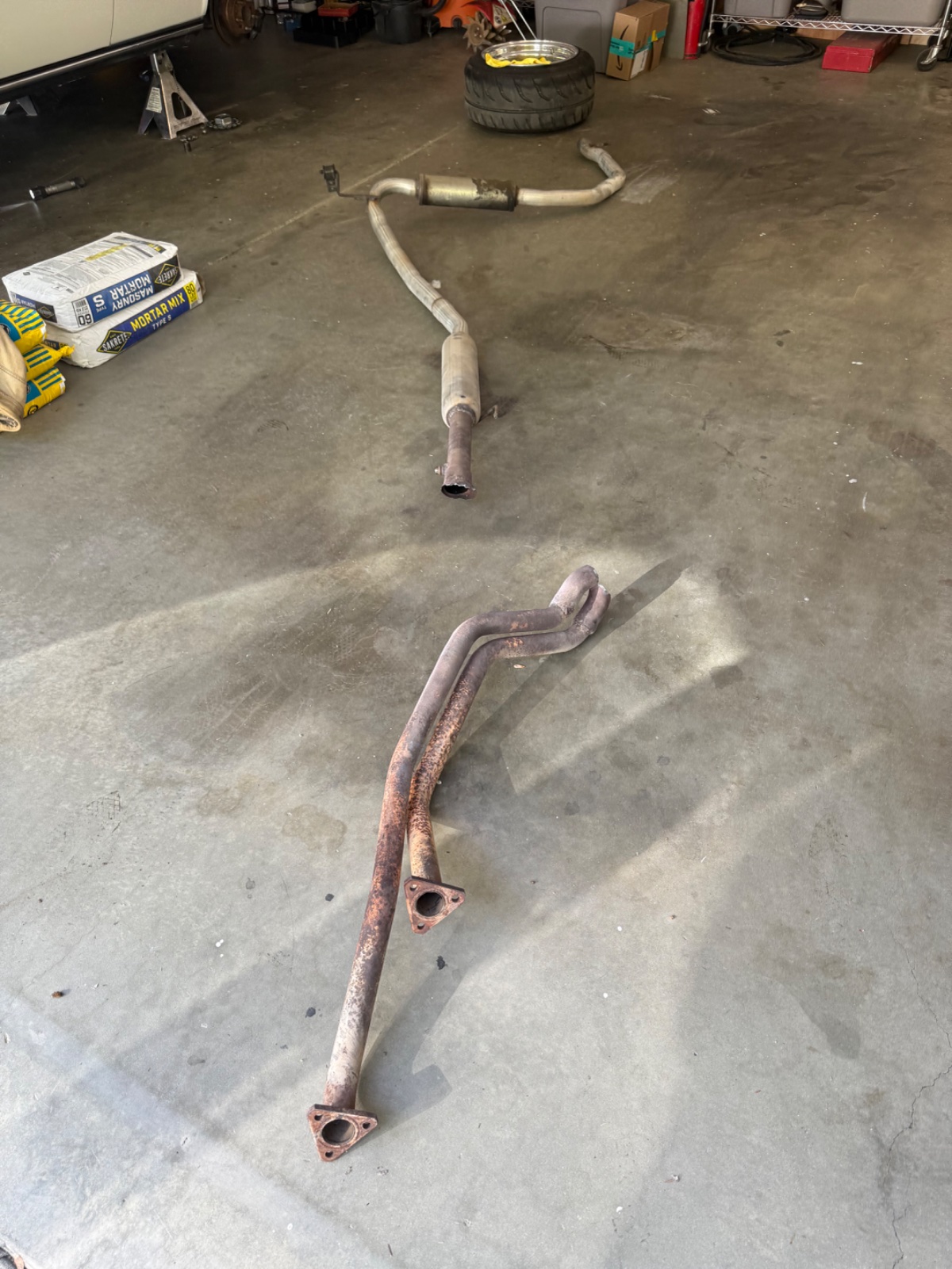

I pulled the complete exhaust off and it was in bad shape at the collector where the noise was coming from.
Pretty funky but hey it worked
