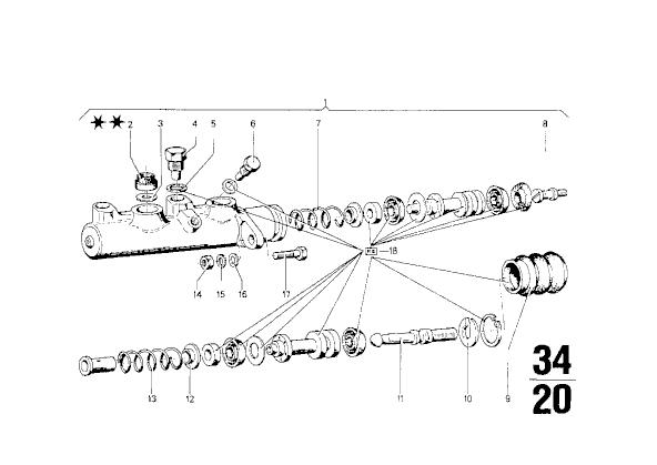

So with the MC on the bench again we took a closer look at this extra fitting between the MC and the rear brake pipe, after comparing it to a MC housing from a 1972 3.0CS which does not have one. See photos at the end. Top is 1972 MC bottom is 2800 with valve removed.
Took the fitting off and saw what looks like a ball and spring. Realoem #34314650332 calls it a pre-pressure valve. We cleaned the valve exercised the ball and spring and it seems to allow pressure one way (to the rear pipe) but not the other. Thus it acts like a check valve. Interestingly the 1972 MC housing does not have this fitting so the rear pipe attaches directly.
The valve is no longer available. So we are wondering if ours was stuck and thus did not allow any fluid to get to the rears. So on goes the MC and the fun begins again.
So what is the purpose of this valve? If we end up having the same issue can we just drill out the ball and spring effectively making the MC like the 1972 housing. I suppose we could clean up the 72 housing, hone it and use it.
Why is this even needed? Perhaps it was only fitted to the cars with rear drums?

As far as what the valve does found this thread on a 2002 site
Here are a couple would would be explanations from the thread
"That is a residual pressure valve for the rear brakes. It keeps a little pressure in the lines for the rears only."
"From one of the 2011 postings--why this valve is interposed between the M/C and the rear (only) brakes:
It helps equalize front to rear brake 'timing' The wheel cylinders have to overcome the spring pressure before contacting the shoes, while the calipers simply slide into contact. Leave it in unless you are converting to rear disc or very bad things will happen
So yes, it's necessary; otherwise there will be a noticeable pause (and a very disconcerting sinking feeling in the pedal) before the rear brakes start working when you press the brake pedal. They don't usually go bad; it may be that the internal valve is stuck and some cleaning with spray brake cleaner will get it moving again."
So in my case it must now be working because when I go to crack the rear bleeder valves (with no pedal movement) fluid squirts out; as the explanation says some residue pressure is maintained at the rears?

Another note for 2800 owners. If you ever have to replace your MC (ref the photos) the 2800 MC has to have a bigger thread opening and machined flat to accommodate the valve and copper seal.

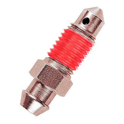

I have ordered the speed bleeders and if we need to do another go around we will give them a try.
Jjs2800cs
Doubt the speed bleeders will help here, but let us know what happens, nothing like having a shop assistant!

They leaked like the normal ones for me.
They sounded like a great idea, but I will keep extra beer in frig and whatever other necessary spirits for car buddies who don't mind pushing the pedal a zillion times.
After trying for days by myself, in an hour or so down up worked, so the speed bleeders go into storage.

Did not even try to use the speed bleeders as we received them after ( delayed in shipping to me) our successful bleeding using two people. If in the future I need to bleed the car again, I will give them a try, but based on others saying they had little luck with them, we will not spend a lot of time getting them to work.
