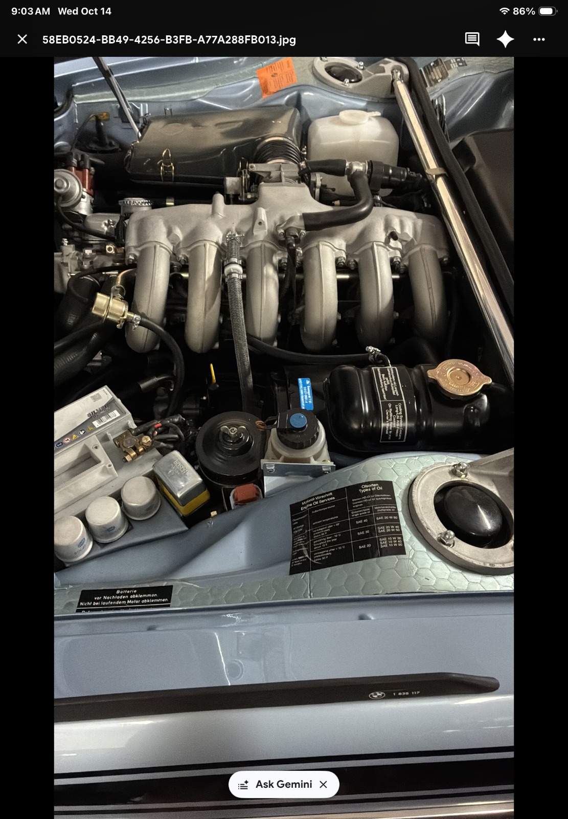

I have a fully restored E9 imported from Germany. I have been thinking about upgrading the engine to a modernized set up. Two questions:
1. Who is best to advise
2. Should it be done
Love opinions
Talk to @sfdon. What engine do you have currently, give us some more specs on the car - transmission, carb vs injected, etc. Different options for upgrade. What are you looking for - rebuild, more power, racing vs street driving, etc.
Beautiful car! With a CSi your upgrade options are a little different since you already have more power than the US base carb version. I would ask about the answers to the other questions. Debate can ensue but for many of us the first upgrade is 5-speed and diff change to make the highway cruising a bit more comfortable with lower rpm. I am also considering an engine upgrade and have a CSi, it then becomes a question of upgrading to a 3.5L engine like the M30b35 or an M90 (rarer and more expensive).
Great looking car! Good question on the upgrades. In addition to what E9L says, I notice you have a 5 blade cooling fan. You can easily upgrade to an 11 blade fan to help make things more efficient in that department. Regarding upgrading to a 3.5L, that's up to you. You already have a CSI, so that's great. My ride has an M90/B35. It's a torque monster, not a revvy engine. So it really depends on what you want for a driving experience. Food for thought!

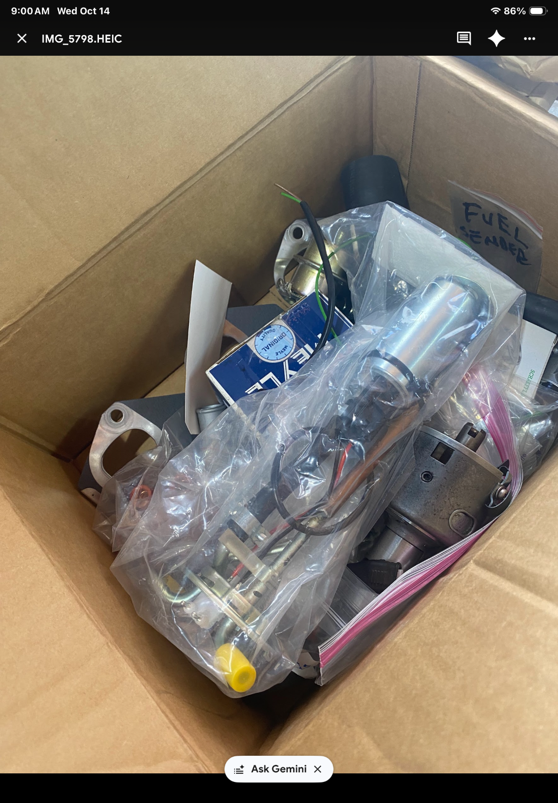

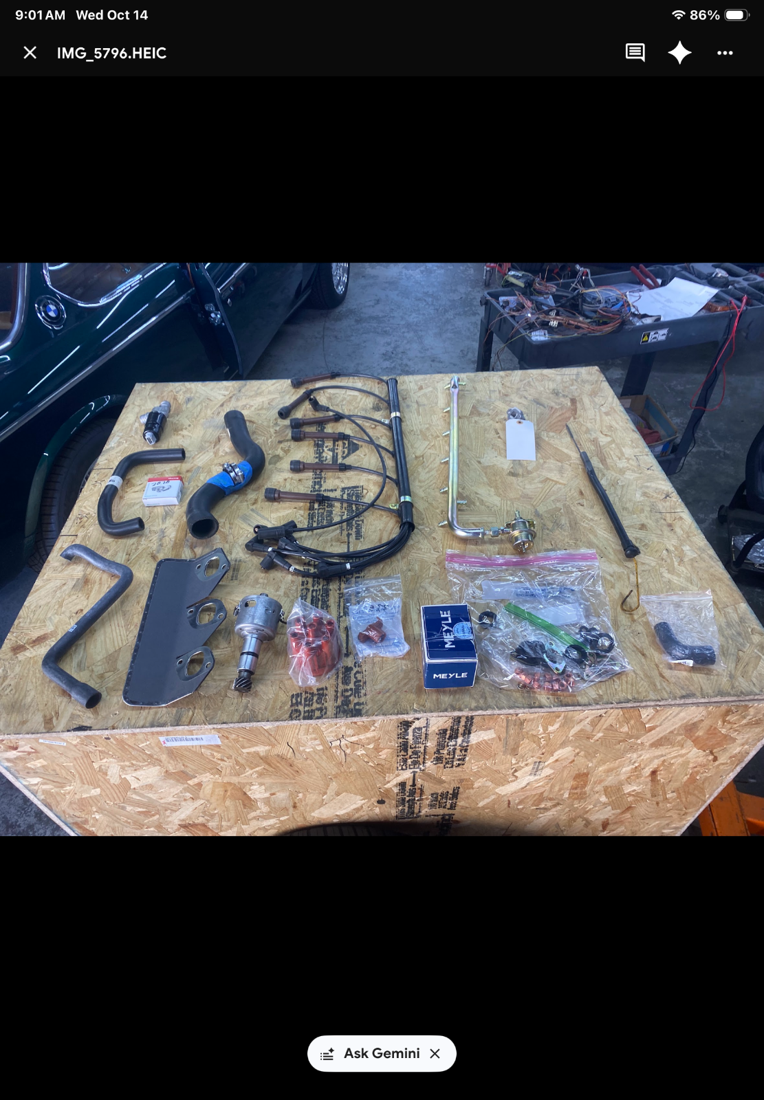

Your package arrived yesterday from Germany-let me know what to do with it!

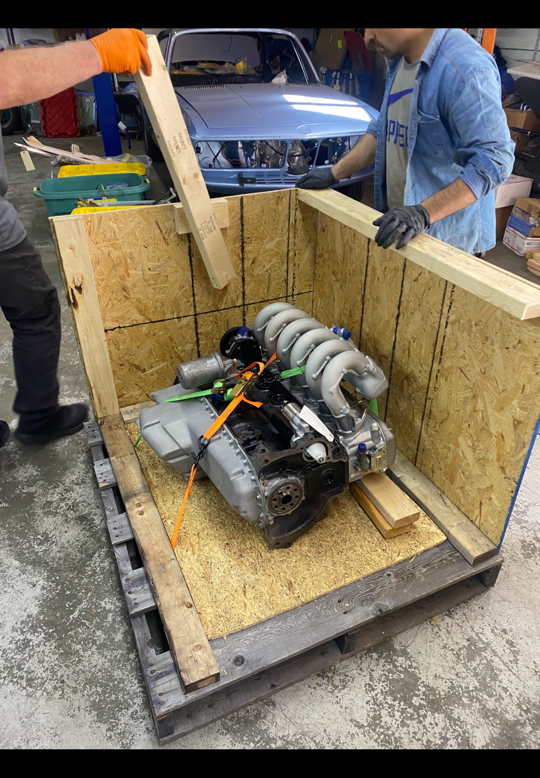

I just finished a job in Spain, where I took out the Csi Engine and put in a 3.5 L euro engine with mega squirt. The results were great, but the cost was high.

That's a pile-o-parts!!!
Look before you leap!
