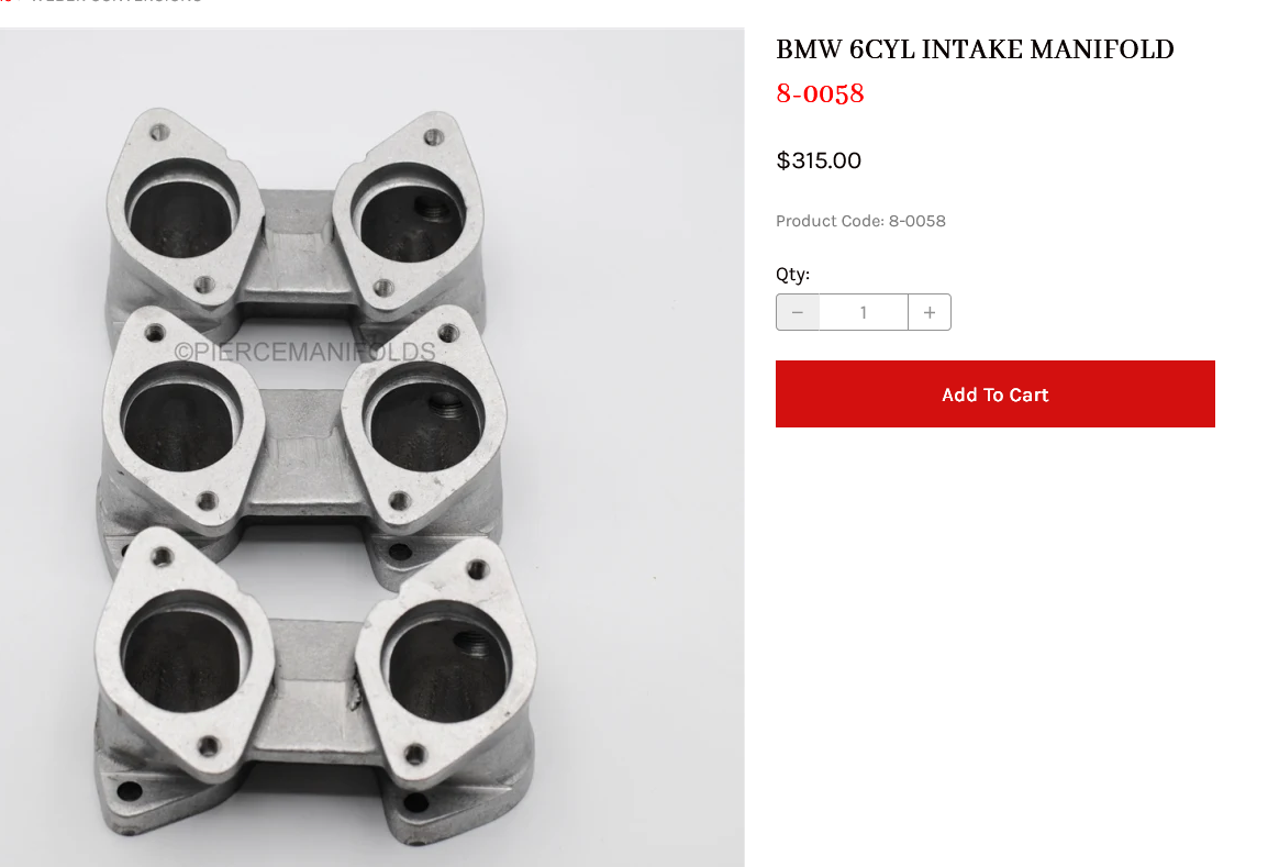

Yes , the Pierce has a threaded opening for vacuum.Yes, knew about brake booster vacuum but wanted to know if I should keep vacuum advance in place for the distributor. Sounds like I do. Anyhow, does anyone know if the Pierce manifold comes with a vacuum port off the front manifold section, or will I need to install a fitting?
