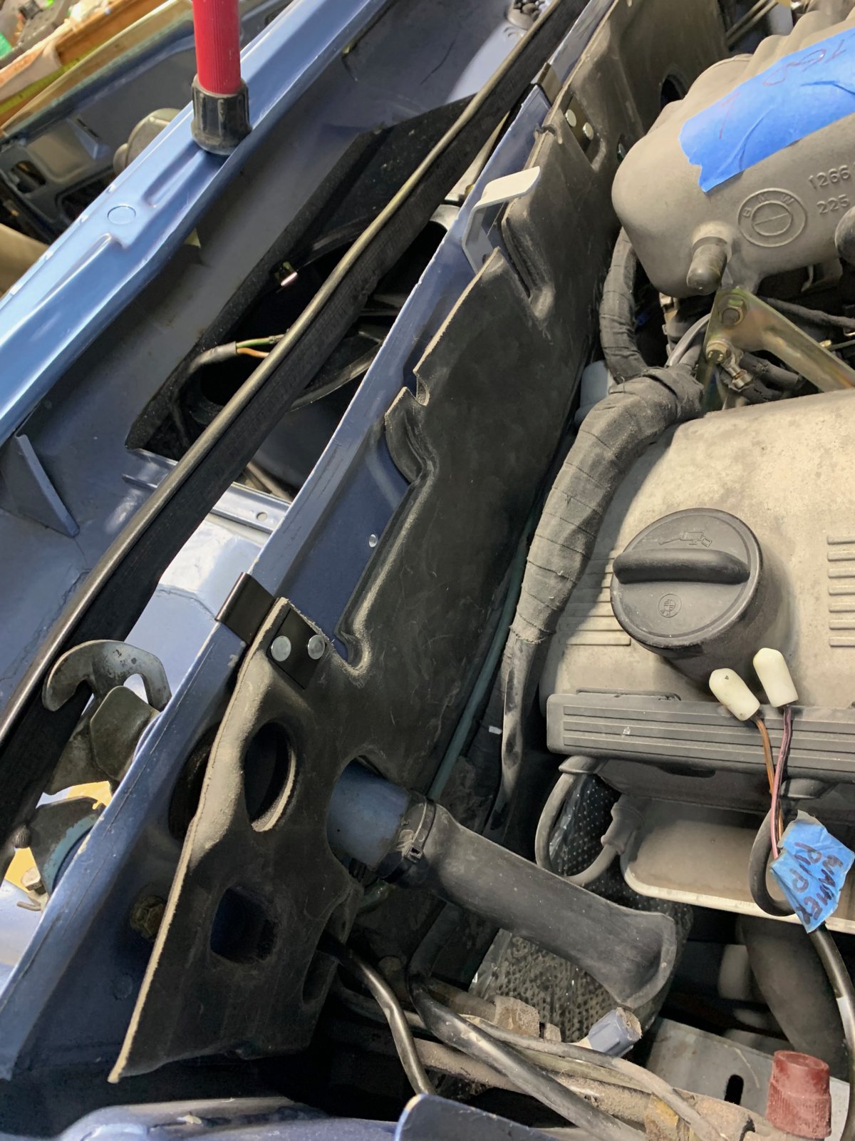

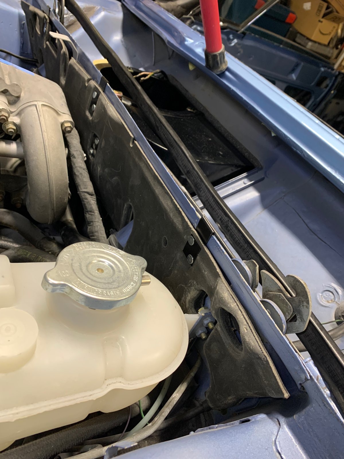

I removed my original insulation that was in bad shape many years ago and I remember having to remove adhesive from the fire wall.
Finally just got a new replacement and was wondering how others have attached it other than just hanging it with the top clips. I was thinking maybe just a few strategically placed dabs of weatherstripping sealant?
Also just realized I will need to disconnect the A/C lines.

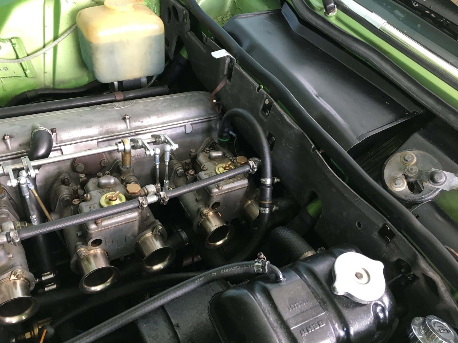

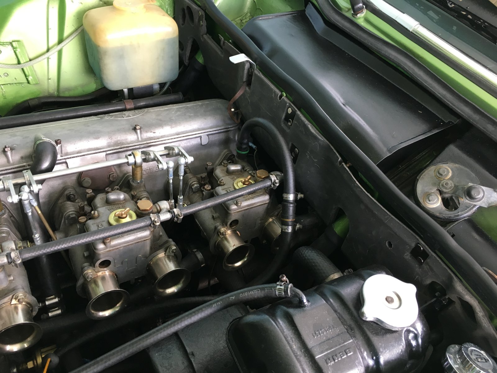

Reviving this older but good thread... what did you end up doing @DWMBMW?
Is there a consensus? Does that piece of insulation need to be glued? I imagine it does, otherwise I can't see it doing much of anything just hanging there. Wurth contact glue? 3M spray glue?

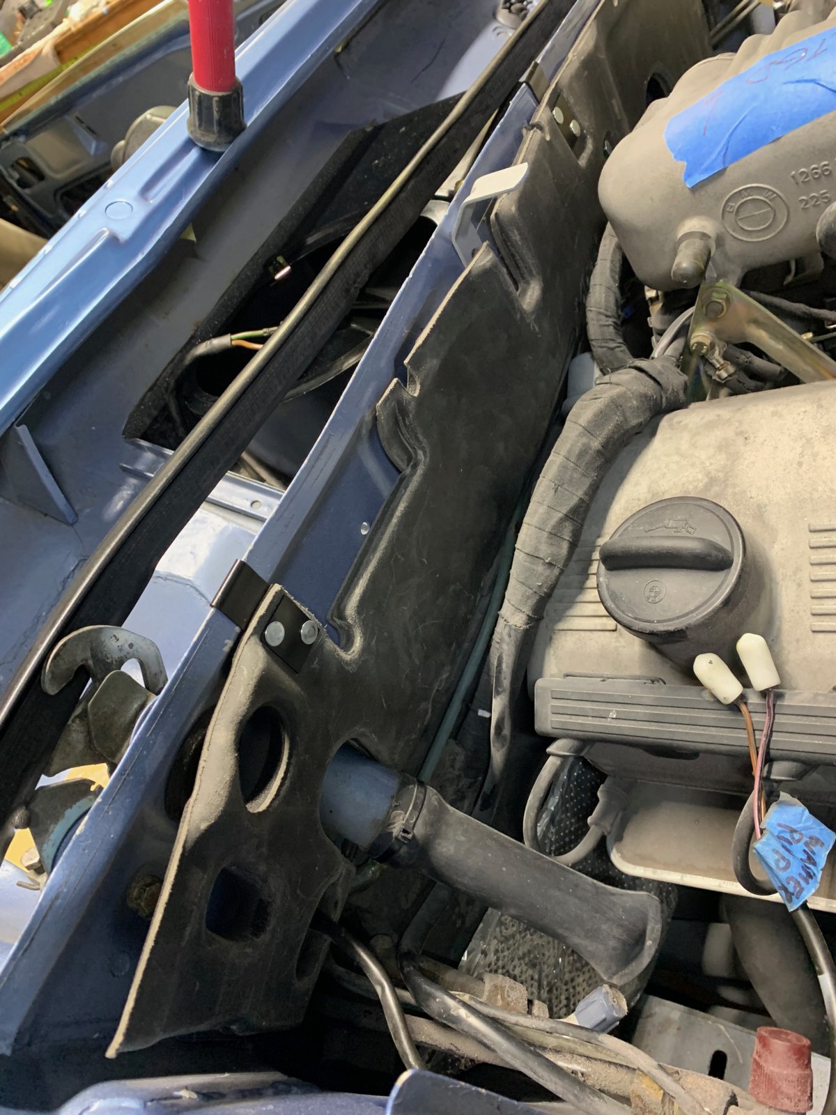

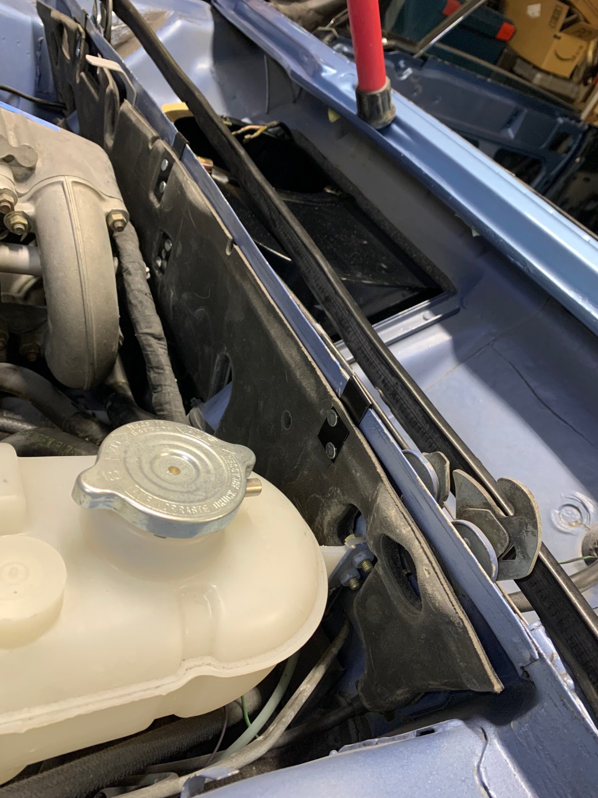

Hello My friend, What I did on mine I spray glue on fire wall and insolation after hanging glue was holding well but I use 4 screw incase glue comes of that was my idea to use glue on upper and lower fire wall insolation right or wrong don't know but I don't see any other option

Bo, I applied various line beads and dabs of 3M weatherstripping adhesive on the back of insulation.
