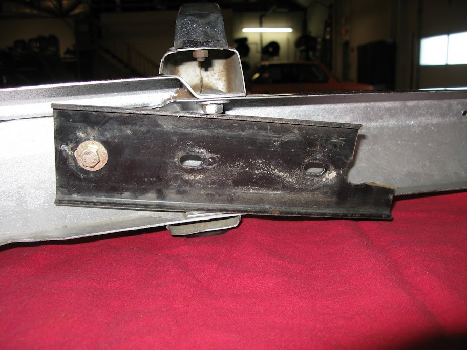

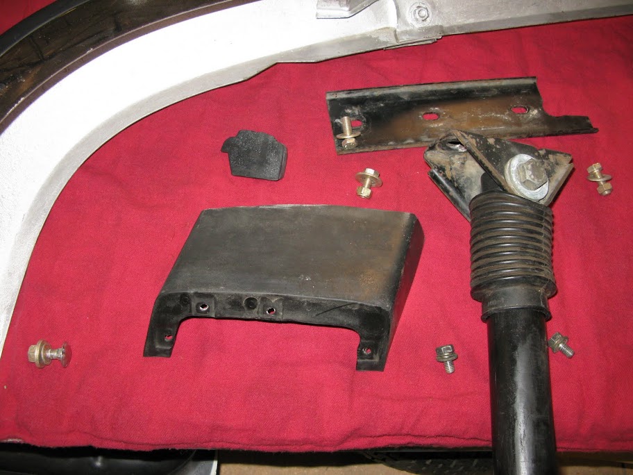

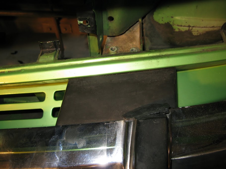

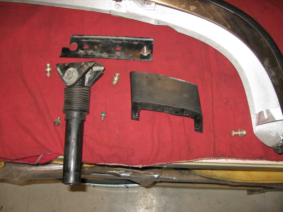

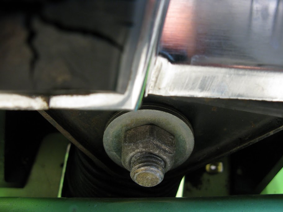

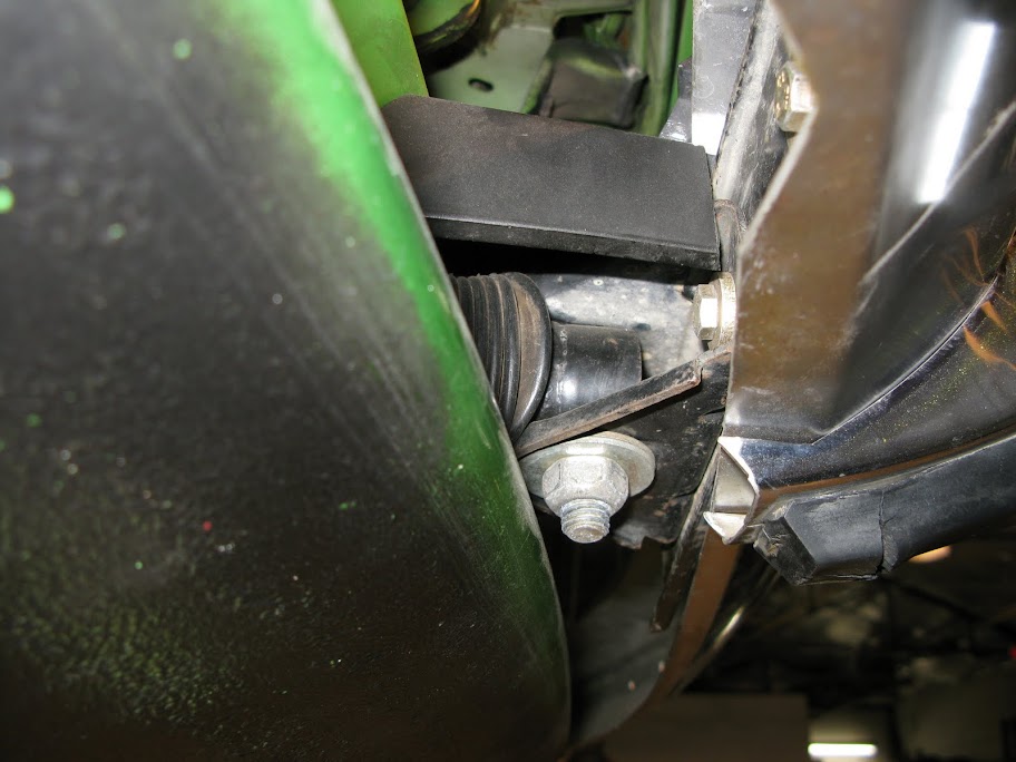

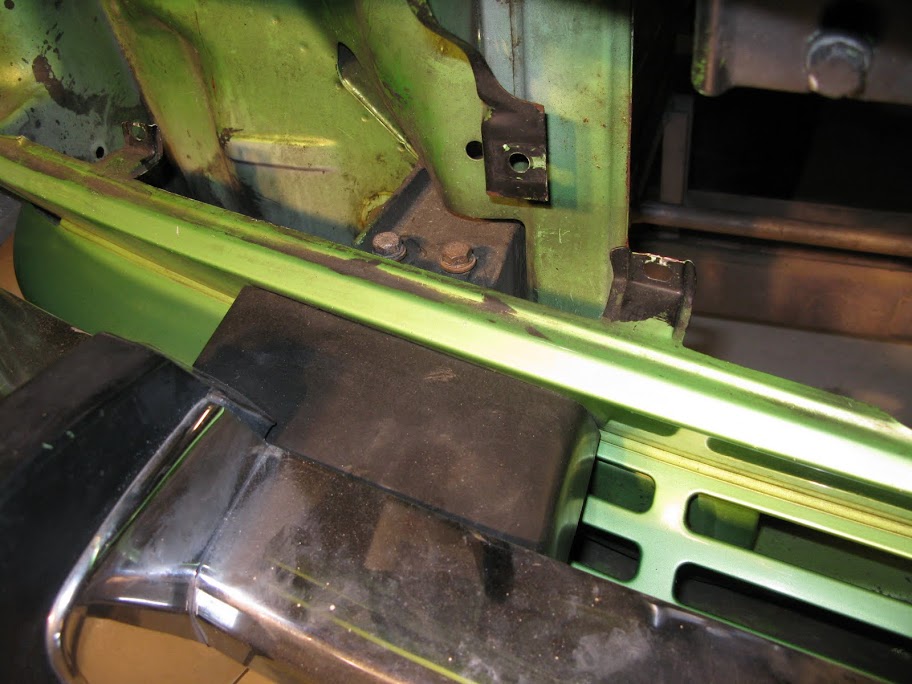

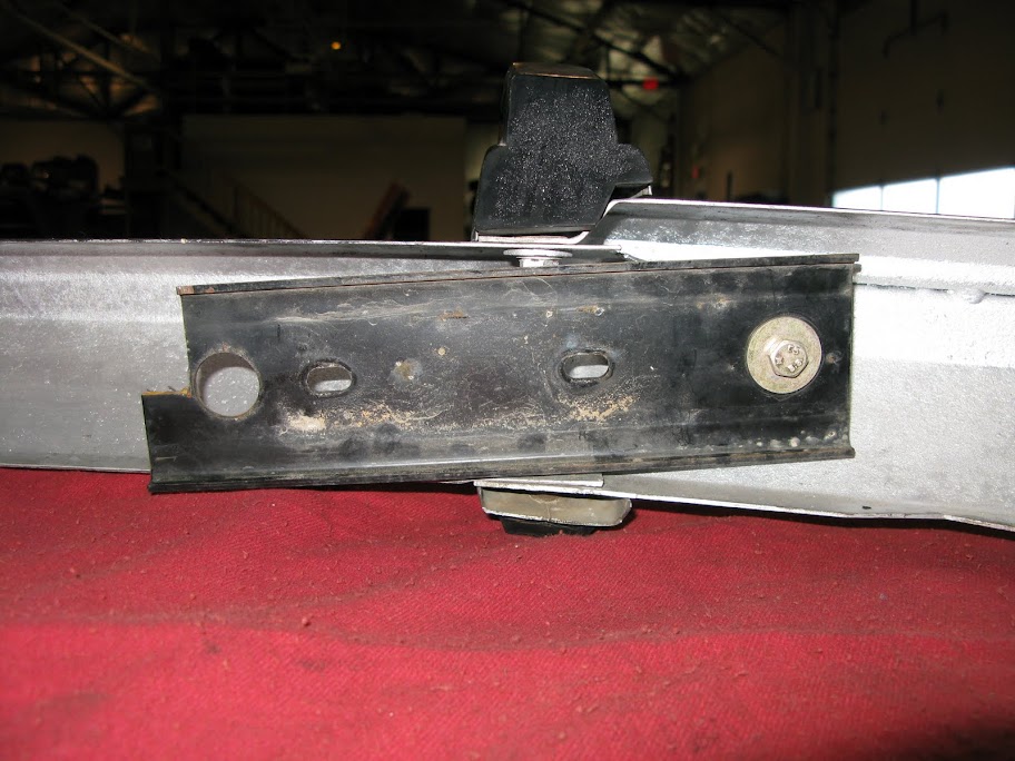

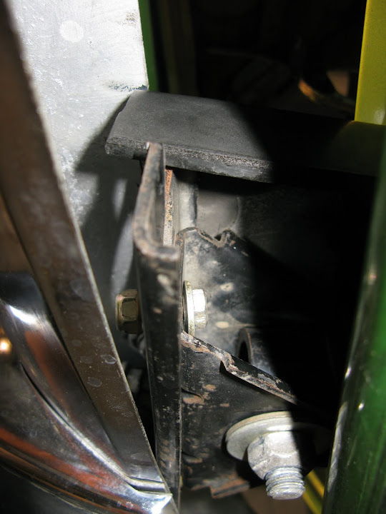

Matt, below are some pics of how I had the Euro bumpers mounted on the car (by Ron Perry). It retains the original mounting shocks, cut for length, as well as the sock covers, also trimmed for length. It's a bit klugie but it's likely the most expeditious and budget-friendly way to do this. I later had the body shop modify the sheetmetal to mount them the correct way.
