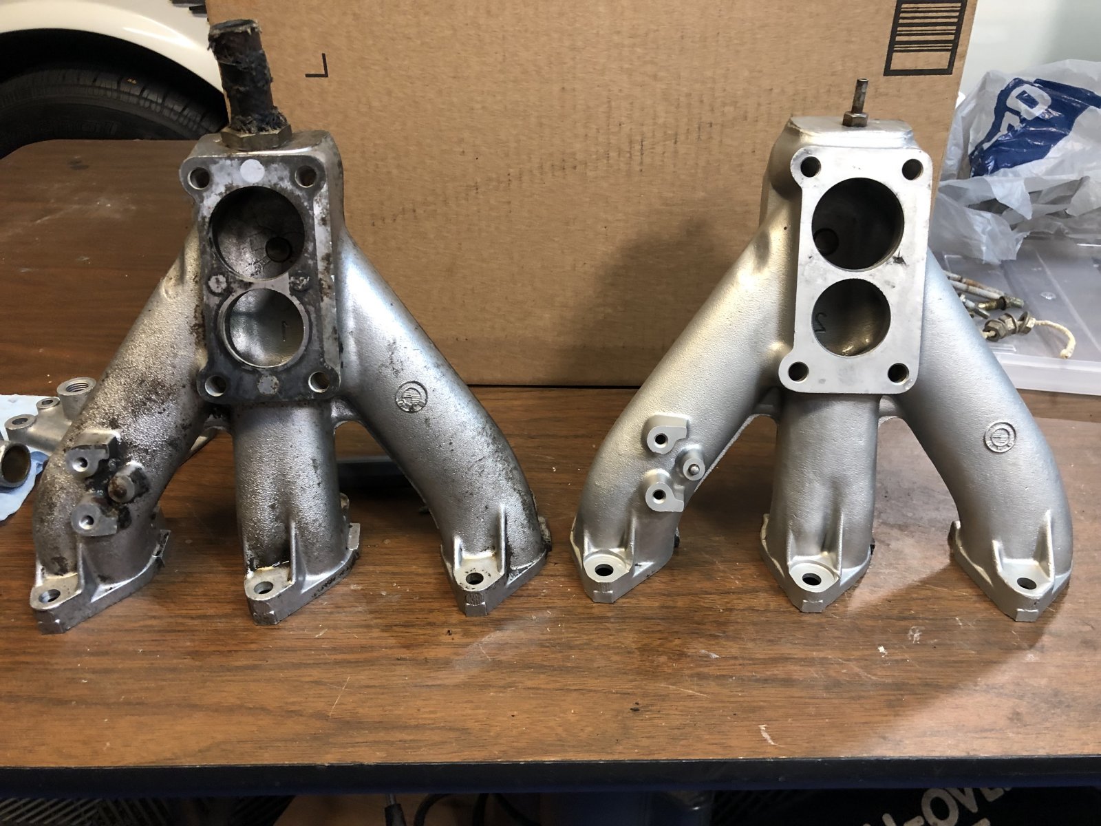

I converted my dry blast cabinet to vapor hone and am very pleased with the results that I get.
I am able to use various media, but for aluminum parts you would want to use a fine mesh glass bead to finish properly. The results are striking. Here is a pair of BMW 3.0 intake manifolds before & after.

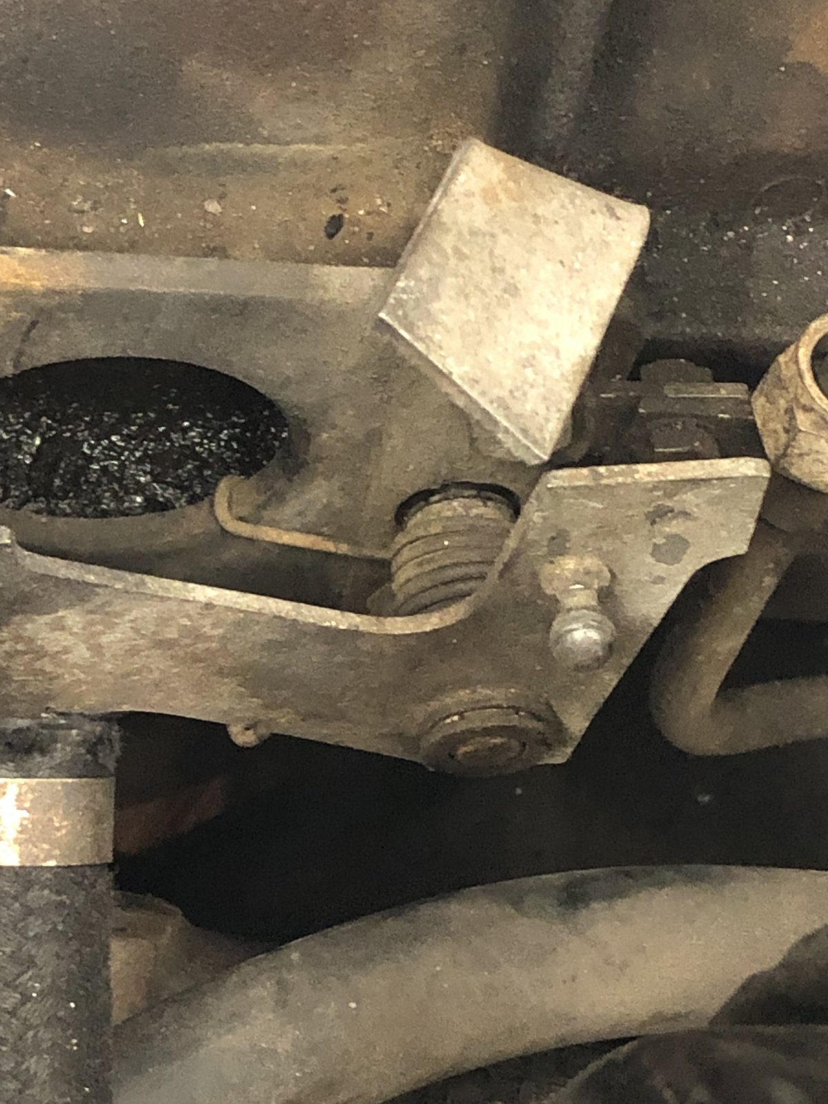

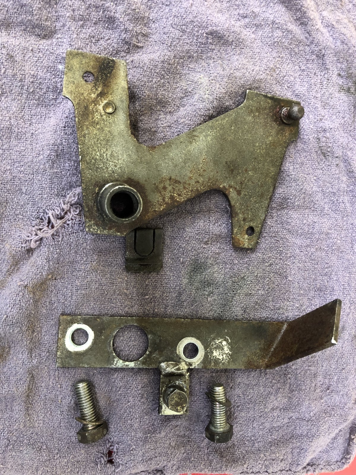

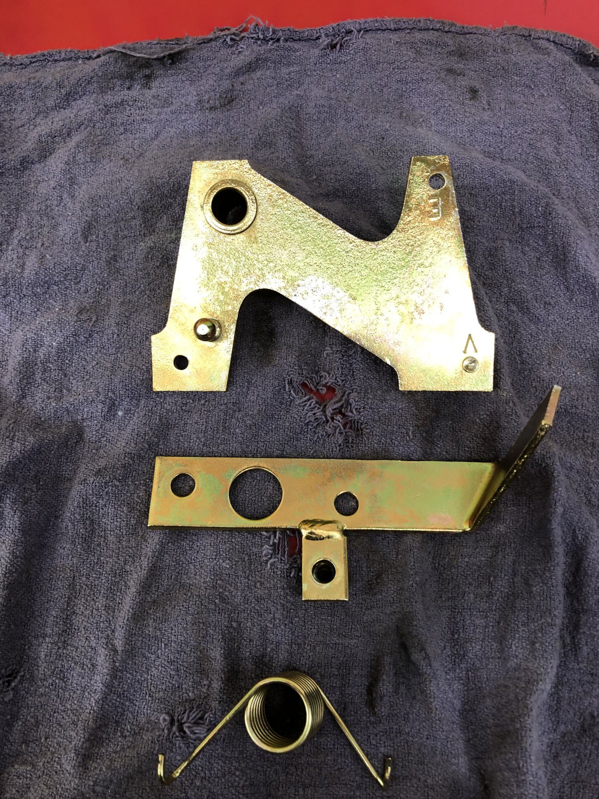

I have also been vapor honing the other steel parts to clean them and prepare them for zinc plating and yellow chromating. Here is before & after on the throttle linkage pivot (down low on the engine).
First image: As Installed
second image: cleaned of grease in solvent tank
Third image: after vapor hone, then soaked in grease remover, then acid dipped, then zinc plated for about 30 minutes after which a yellow chromate (passivate) dip for further protection and to match original finish.

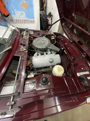

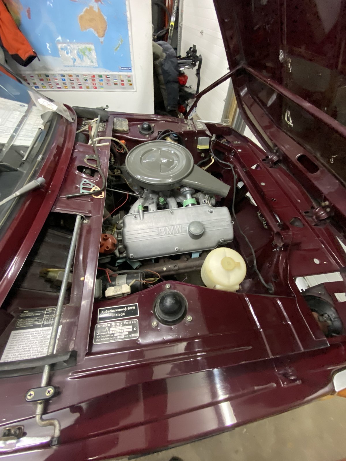

On my 2002 I have given the intake manifolds and valve cover an Alodine coating. From what I believe this is how they came originally. This is used on aircraft to keep aluminum from corroding and it was what we did to all the aluminum parts even if they were to be painted at an aircraft museum I used to volunteer at (Lancaster FM104 restoration)

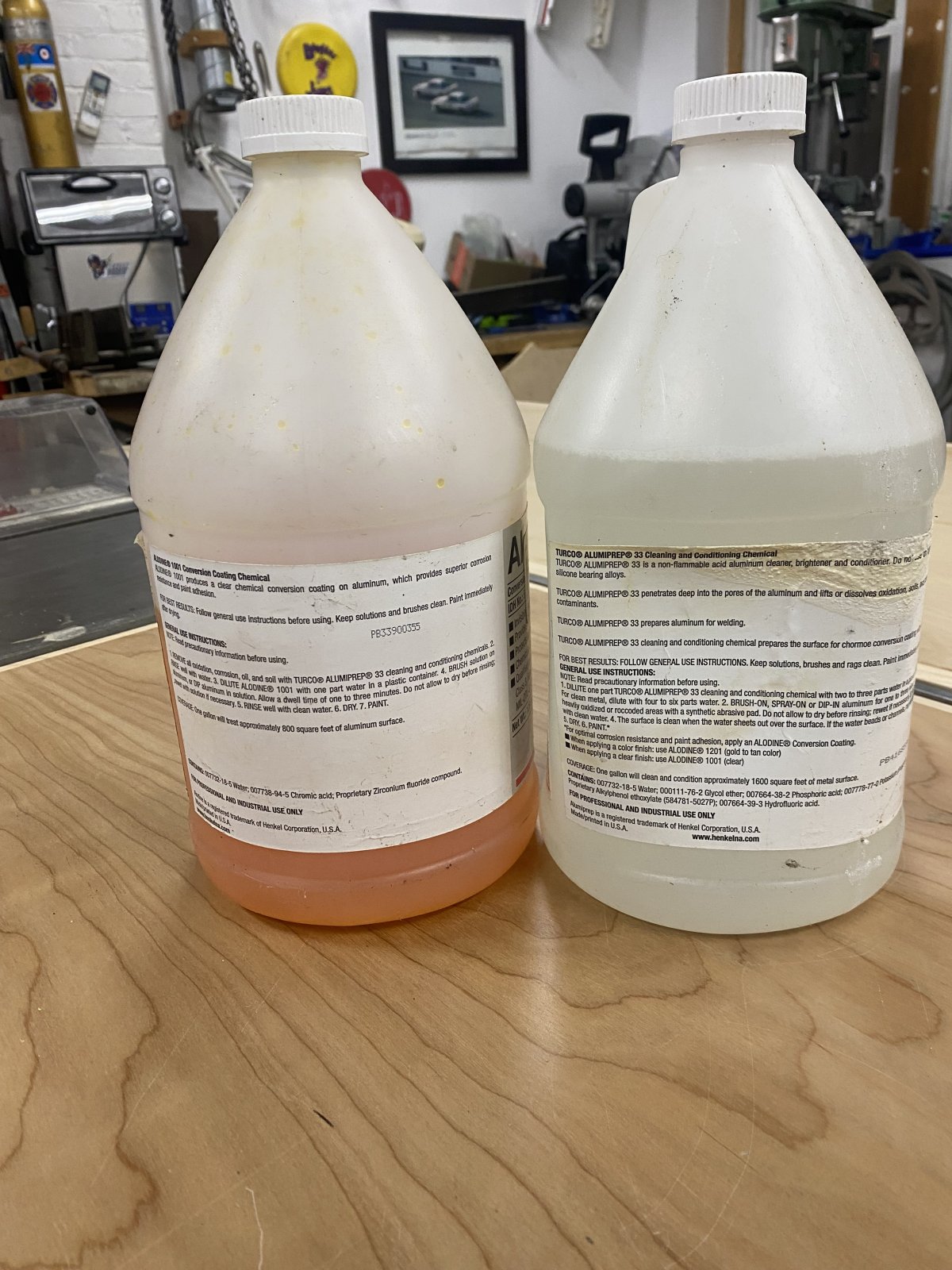

It is really as simple as can be. Best practice is to start with an etching acid called Alumiprep 33, then soak or brush the part with the Alodine and water solution for a few minutes, then rinse well. Not fumey and relatively safe from what I remember.

No, the finish does not have a Yellow component when using the Henkel Alodine 1001 solution (Clear).
From the company "Henkel Bonderite M-CR 1001 Aero, also known as Alodine 1001, is a nonflammable, chromic acid based, coating chemical that will produce a chrome conversion coating on aluminum and its alloys. The coating formed by Bonderite M-CR 1001 is clear in color and it becomes a part of the aluminum surface."
I don’t remember where I bought it, but it was online and shipped to me. If you are local I have plenty you can use.
