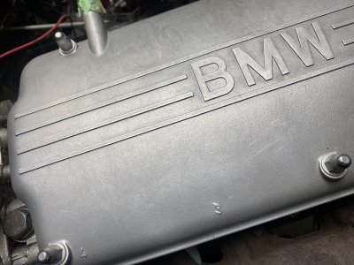

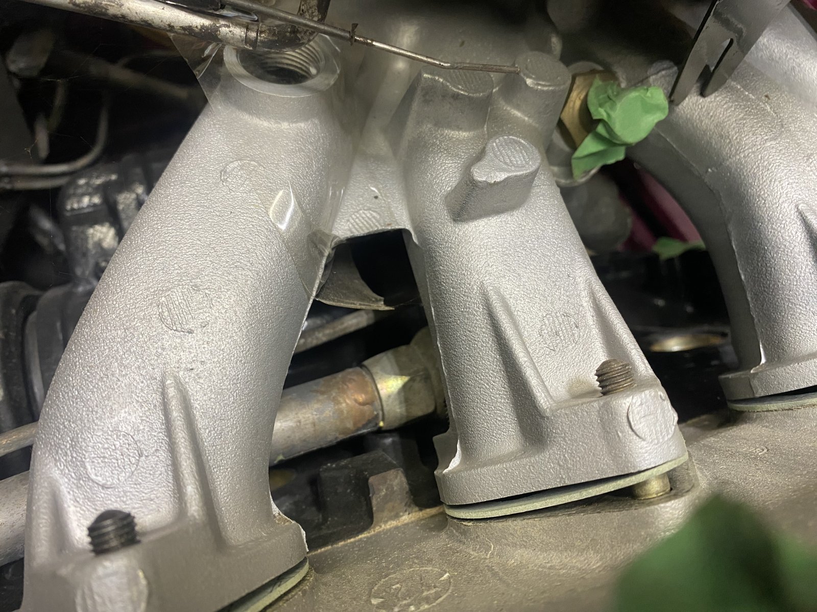

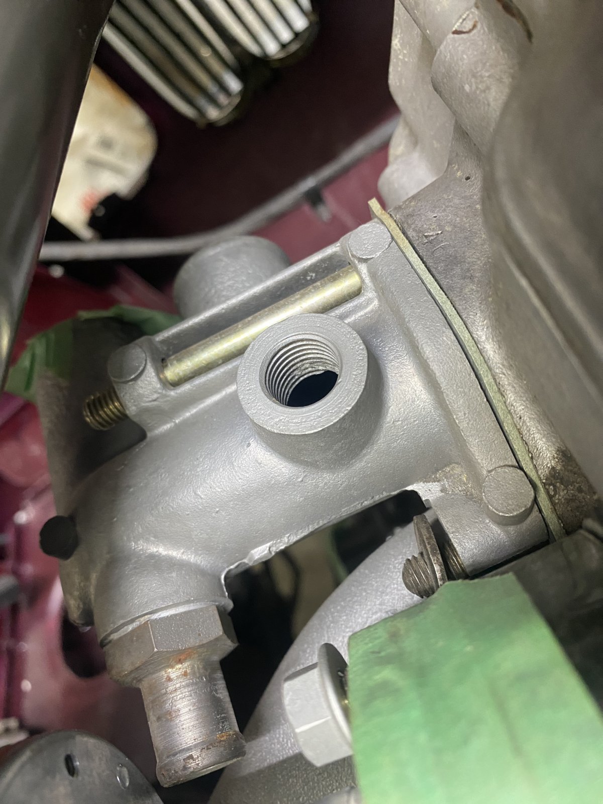

Here's some better shots of Alodine finished parts. I bead blasted them first (Have since read about problems with bead blasting valve covers). I washed the heck out of these, so hopefully no lingering glass waiting to destroy my motor on startup.

I would grind the rivet heads off the protection plate on the inside of the valve cover by the breather nipple. I have cleaned lots of them and flushed the hell out of that area and you would not believe what you still find in there. I drill small holes and tap them out to put a small screw with a large flat washer, loctited in
Looks good
Thanks, Rick

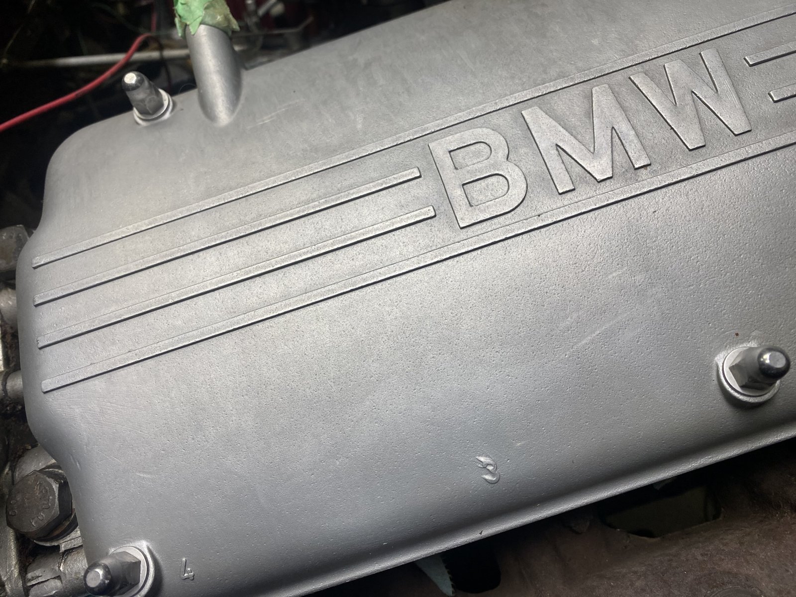

Here's some better view of Alodine finished parts. I bead blasted them first (Have since read about problems with bead blasting valve covers). I washed the heck out of these, so hopefully no lingering glass waiting to destroy my motor on startup.
Looks nicely original. Seems to be the right option after cleaning.

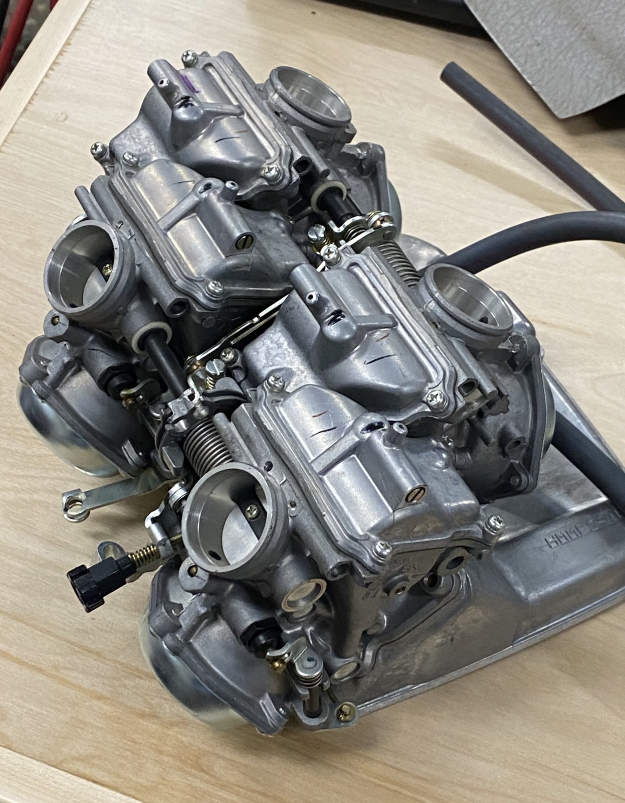

I'm assuming the finish on these NOS 1984 Honda VF500f carbs is an Alodine type process. I like this look. (Came in the mail today!)
