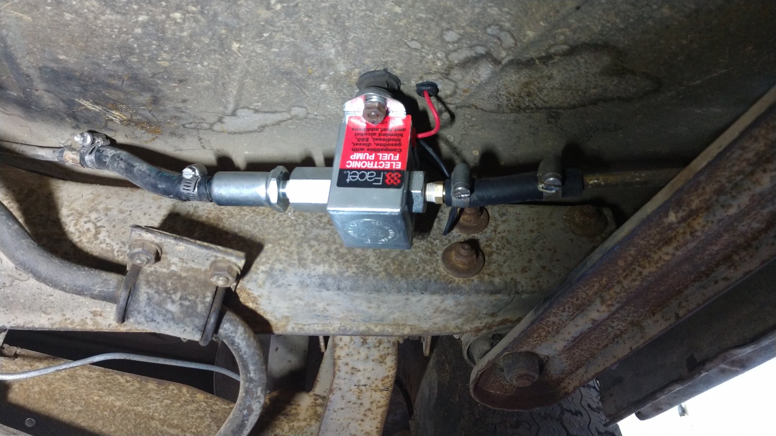

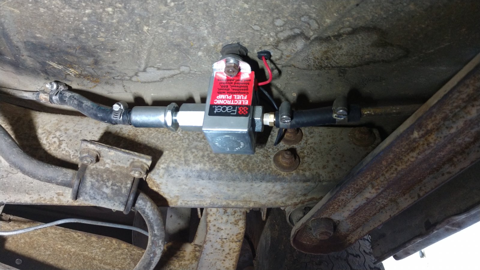

Ah, I didn't get that it was still a mechanical pump. I just mounted my Facet electric pump over the weekend and put it under the left rear seat where the fuel line goes from the center over to the left rocker (E3). Seems like it would get enough air flow there to stay cool, along with the fuel keeping it cool, so I doubt the pump would contribute to the problem.

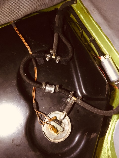

Wouldn't this cause a full-time restriction? Mechanical pump would have to pull harder through it, no?
In theory you're right. And more restriction creates more opportunity for vapor lock. But in practice, a diaphragm-type pump (the ones that go "clickety-click") have two, one-way valves that keep fuel moving in the right direction. Those valves don't create much resistance in the tank --> carburetor direction (though resistance in the carburetor --> tank direction).
With a rotary-type pump, there may be more resistance. You can install a one-way valve in parallel with the pump, oriented with the direction of flow toward the carburetors. That way, the mechanical pump can pull fuel through the one-way valve, but when the electric pump is running, the fuel can't flow back into the tank. See photo below (thanks to whoever I stole this picture from), I have a similar set-up in my coupe, which allows me to just run the e-pump for a few seconds to prime the carbs when I start the car after a few days of non-use, but use the mech. pump the rest of the time.

Why thank you! Note the pump is in parallel and not series. I had a lock in series and the parallel setup is the one the maker recommends.
