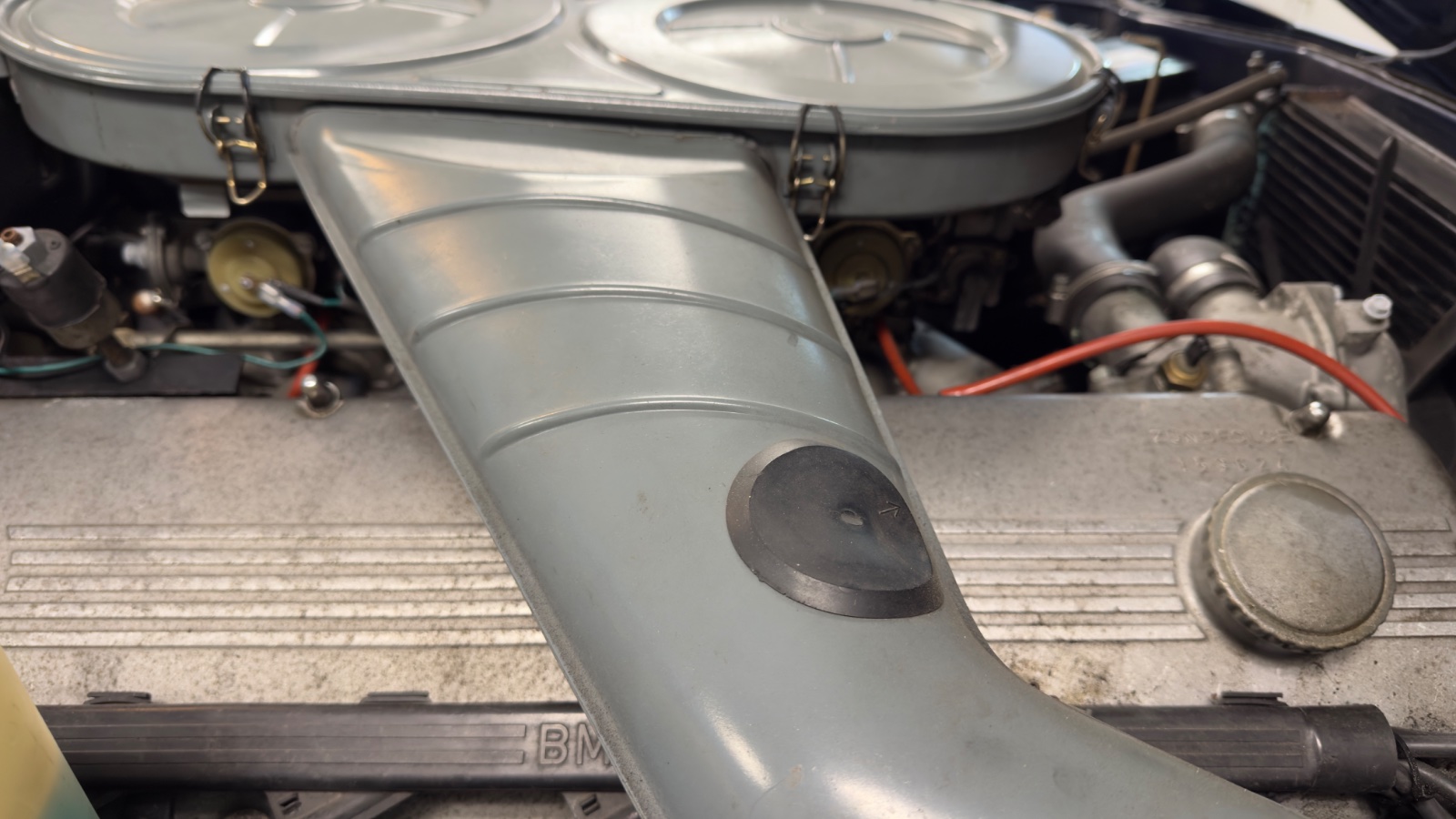

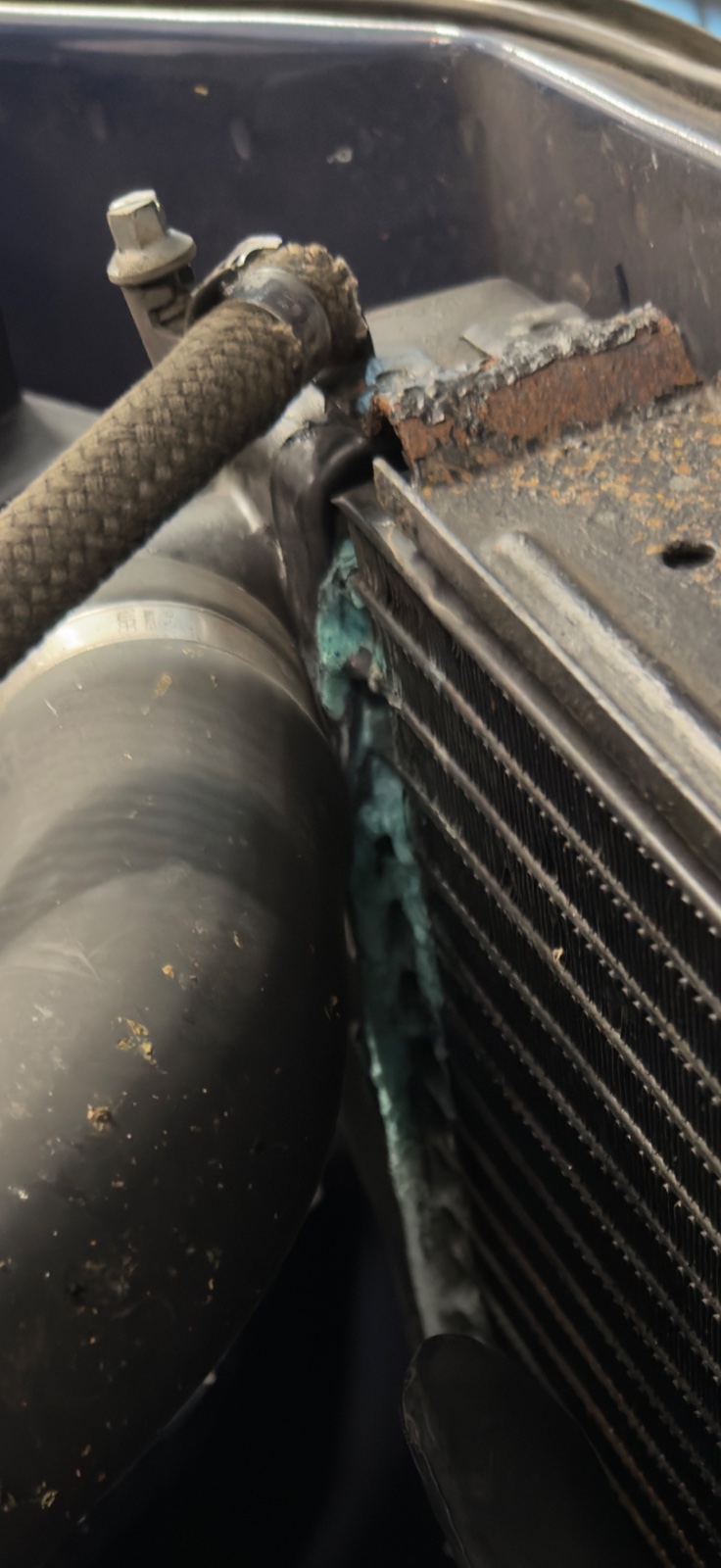

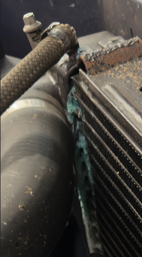

Thanks for the replies. Following up, here are two photos. The first one is the fuel lines. Do these look like they are in a normal position and would putting some thermal shield around them help? The second is the left side of the radiator. It is not leaking from the hose. Does this indicate a slow leak? Would this have something to do with the vapor lock? What would you recommend be done with the radiator? Thank you.

Not seeing your fuel lines. The fuel lines should be on the other side of the carburetors.
The picture below is from your radiator to the overflow tank. It looks like the radiator core is starting to seep as well.

As to the radiator, I agree with Lance - you should pull that thing and have it serviced.
