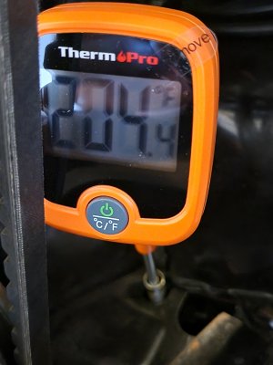

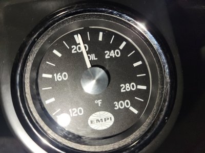

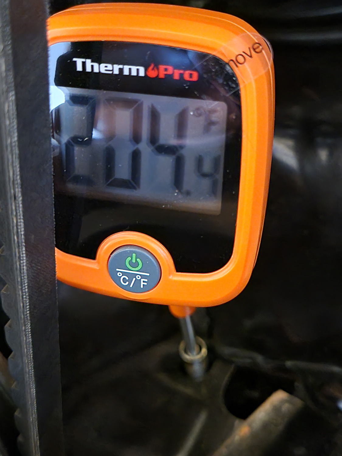

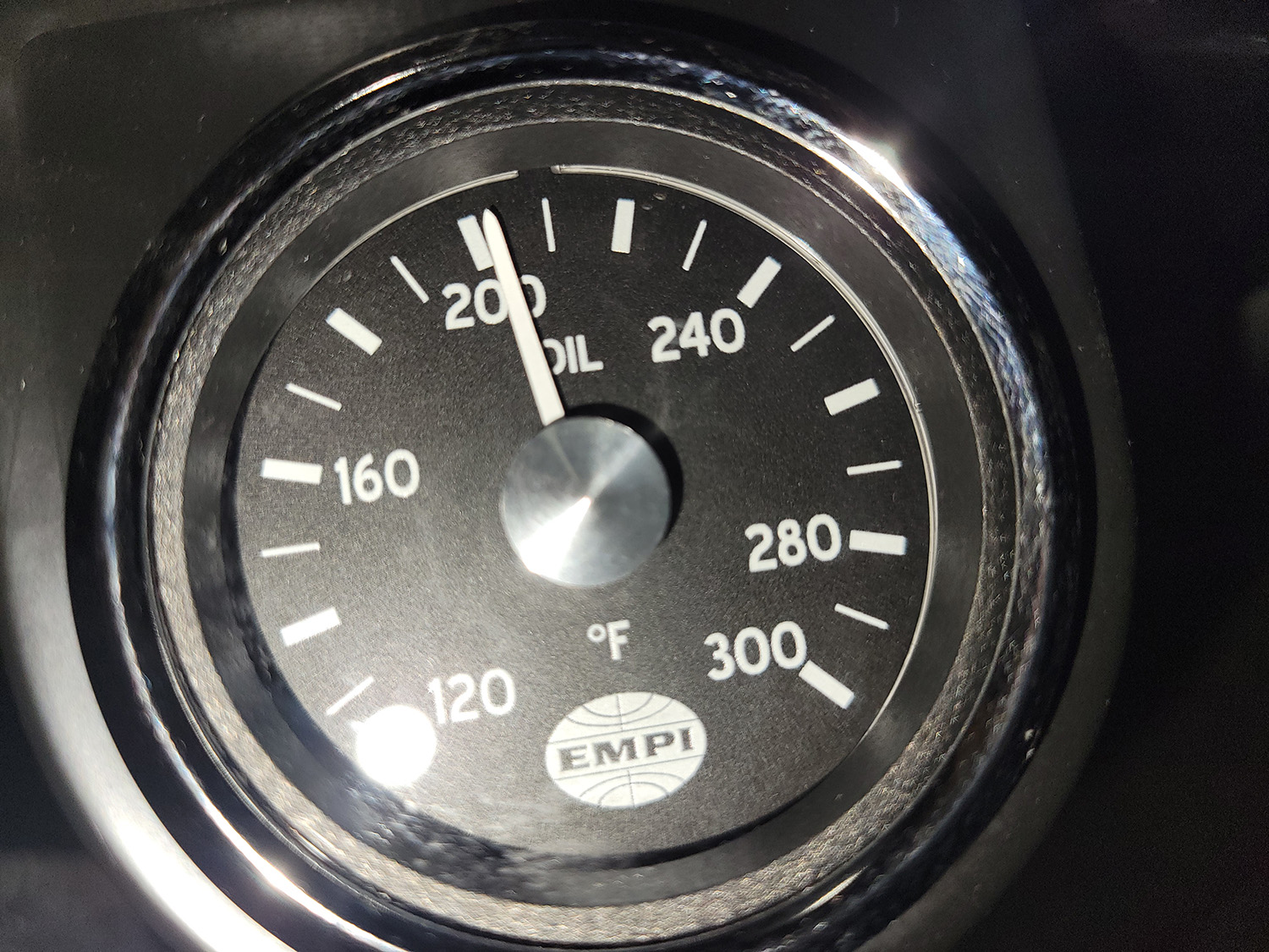

Back on point, the sender is measuring temperatures in alignment with the gauge. I confirmed the accuracy of the gauge/sender by using a candy thermometer directly into the oil sump. (EDIT: I previously tested the candy thermometer and it is very accurate for this purpose). I was getting only a few degrees difference at any moment. I am very happy with this setup and its accuracy. We now have a solid measurement for the heat this beast produces, and can compare metrics as I make edits to the system(s) to provide additional cooling.
