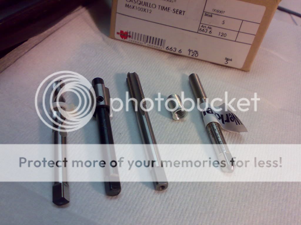

the best system i know for a thread repair maintaining the bolt size
you probably know HELICOIL or similar, but this is better, you will build a new thread with a solid insert without affecting too much thickness of the damaged solid
only con´s: very expensive !

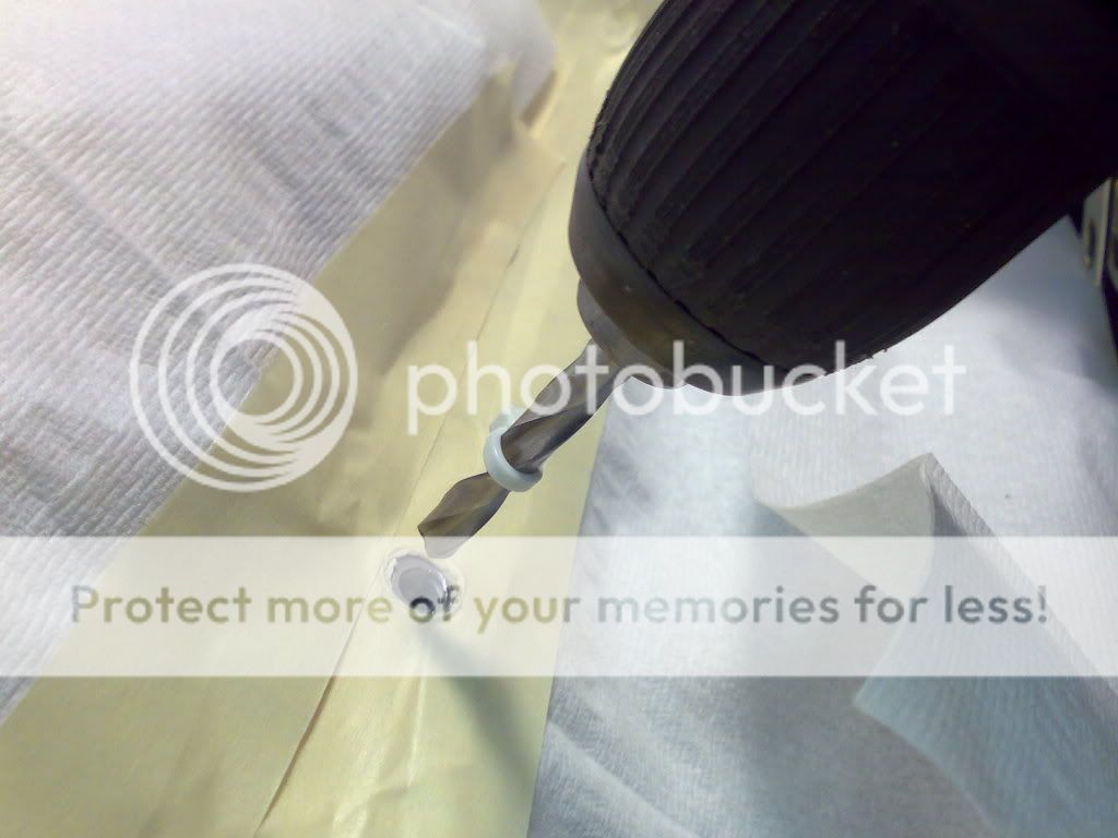

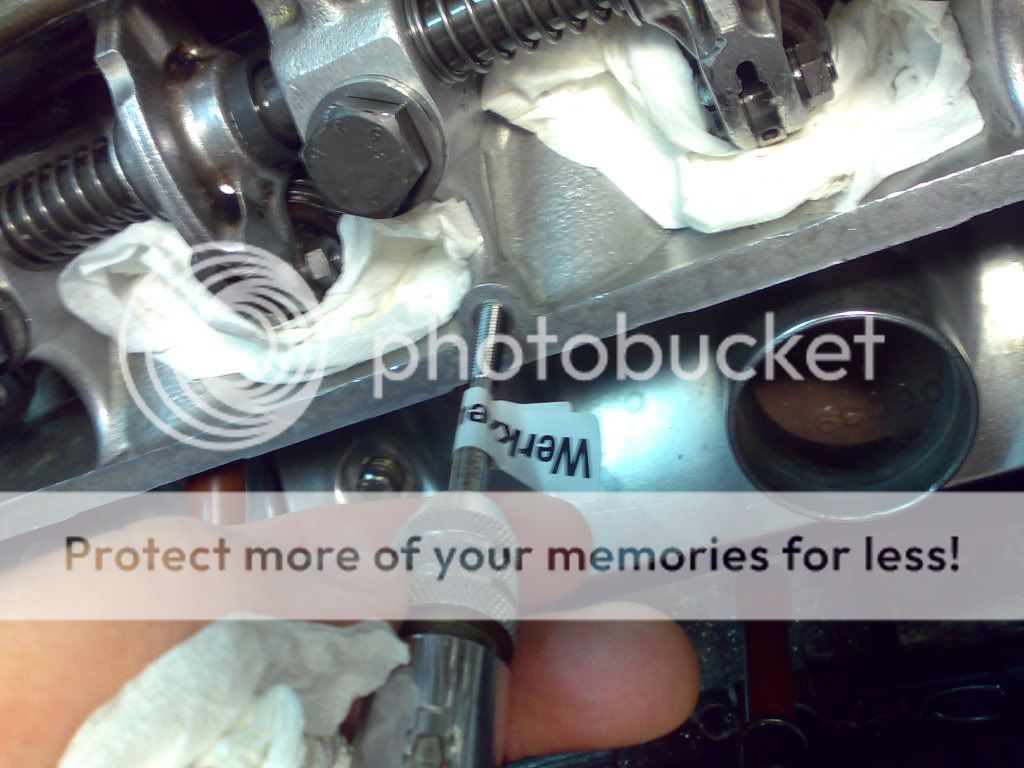

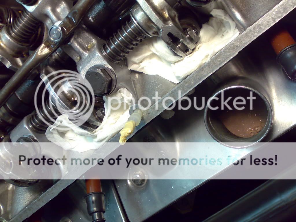

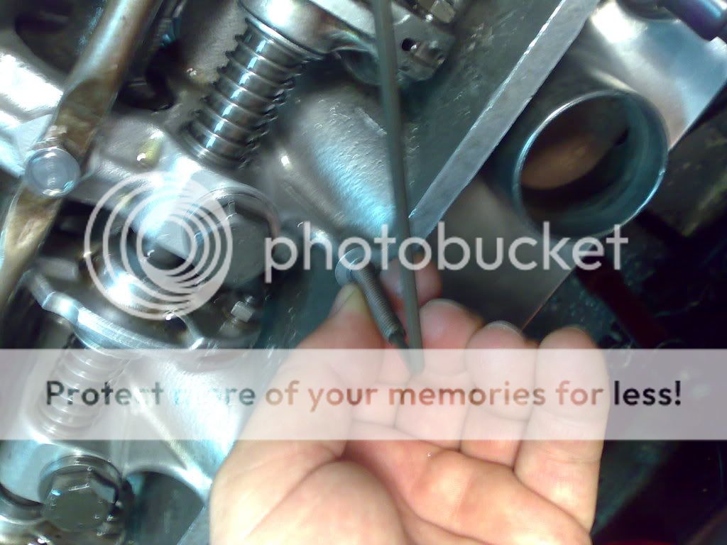

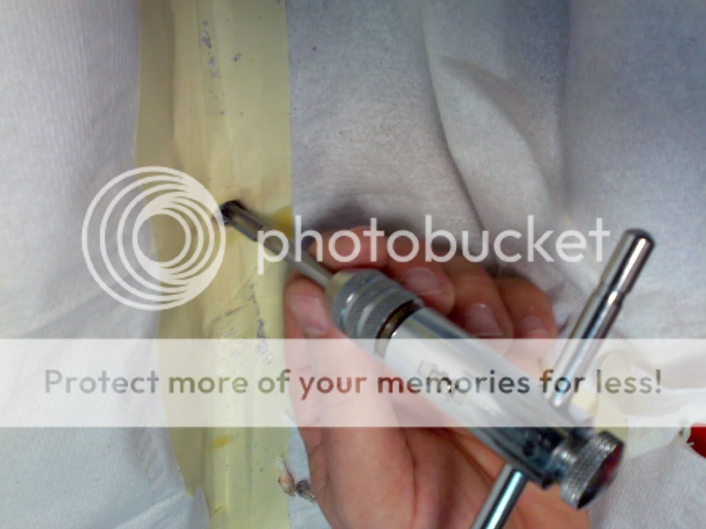

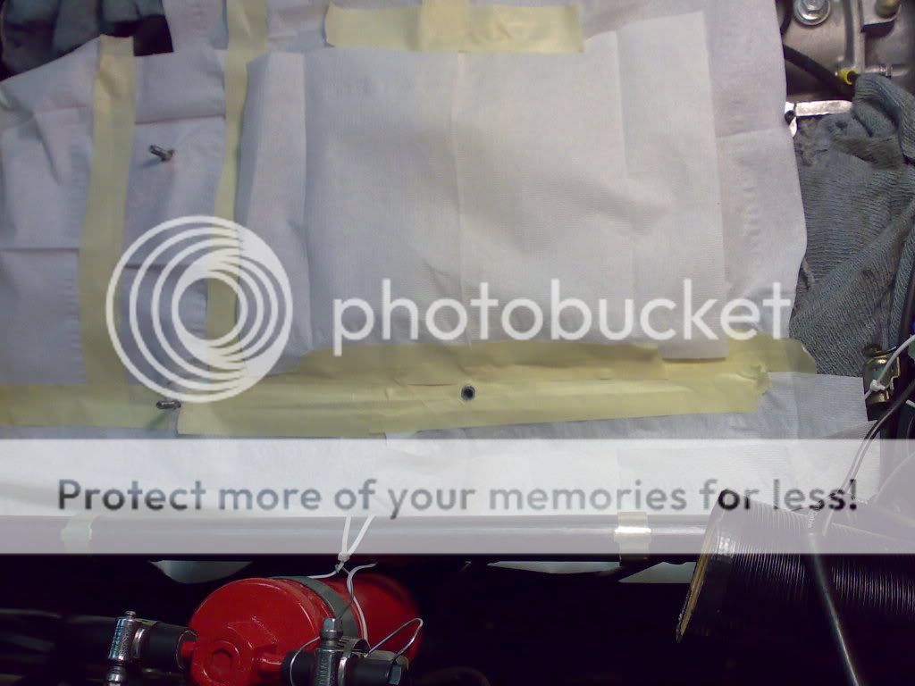

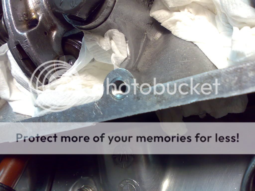

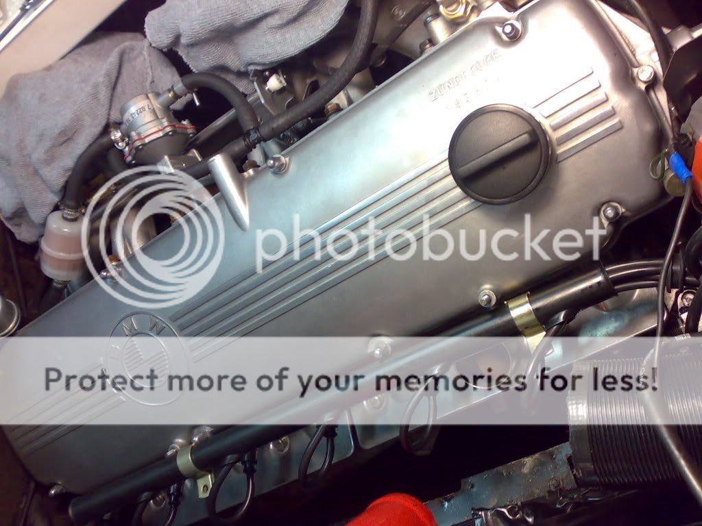

problem damaged thread in engine head
protect the area

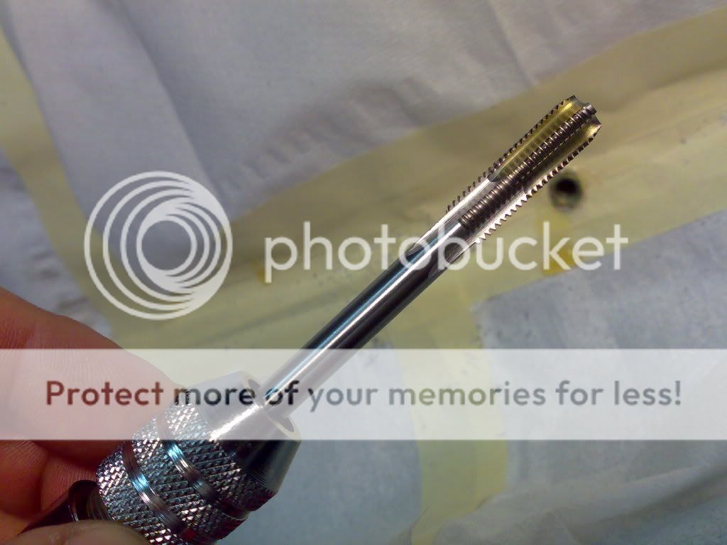

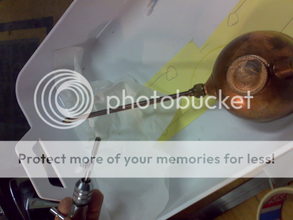

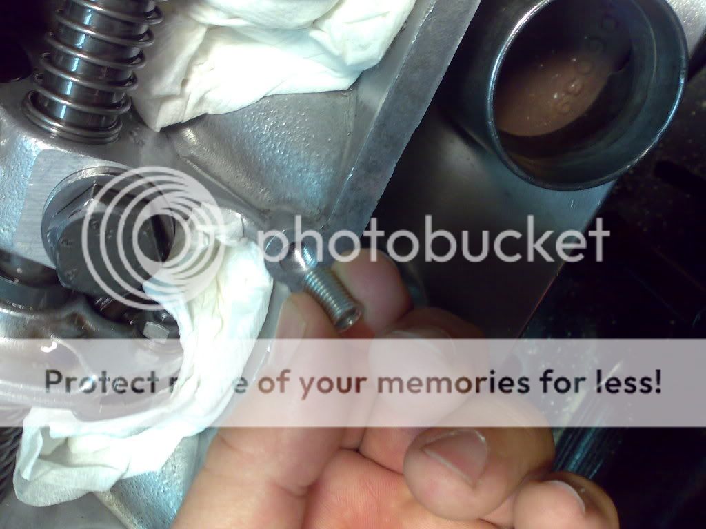

remove old damaged thread

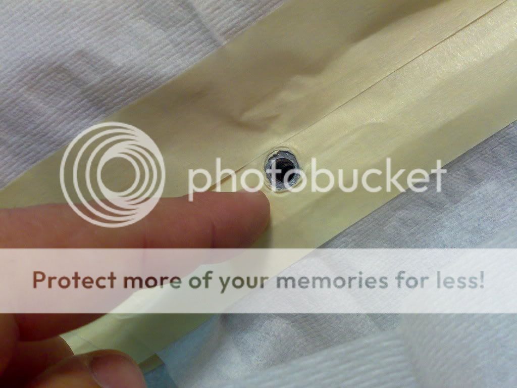

new thread

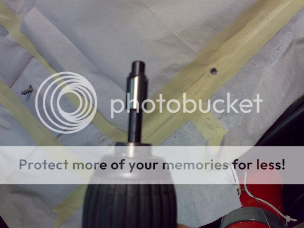

insert
special tool for adapting the insert to the head, and finalising the thread
and that is all

Yup.... Time-sert's are the best solution I've ever used.

mistake ?
ups, now i realized that timesert is a brand itself, so probably the european firm wurth has bought the right to sell it under the wurth name ?
anyone can tell ?
