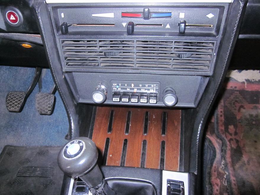

Athena's Frankfurt came from Simon Poynder, Simufly on this forum. He's located in the UK. Very good price, he may have one.

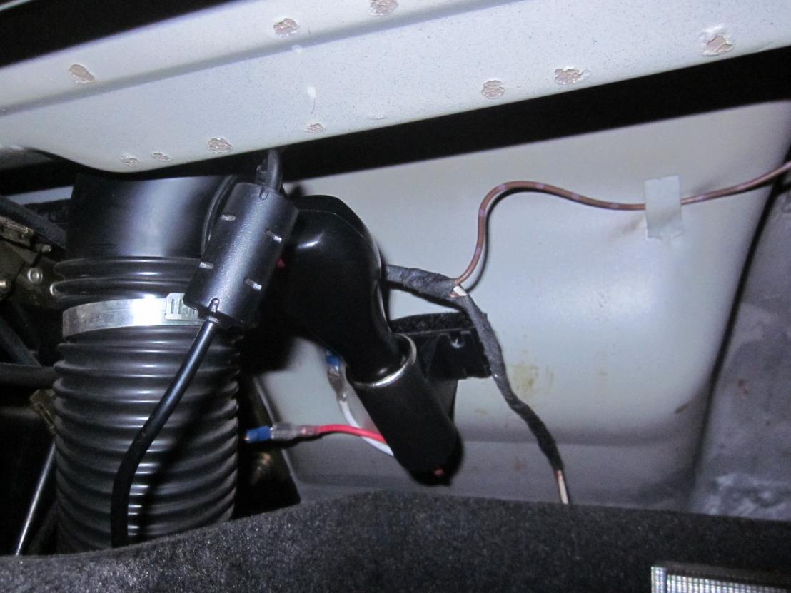

I installed an accesory plug in the glove compartment attached with velcro. I tapped into the purple wire, which is keyed power, with an inline fuse to run a charging chord for an iPhone dock. The dock sits in the lower shelf of the center console. It is easlily hidden at the back of the console when at a show, so it looks 100% stock.
Have the same setup in Vern, with the dock located in the ash tray.
