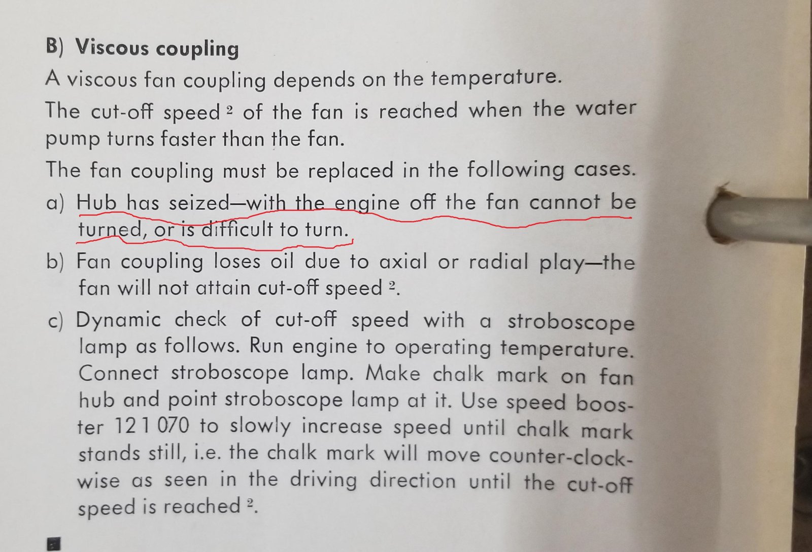

I hate to take issue with someone with as many messages as you have and such a high score, but I am really confused by all of this. Some people say I have a viscous clutch (and so does the BMW Service Manual, apparently) while others say I have friction clutch.
I have the radiator out, I know I could run the motor for a short period without coolant but I am guessing whatever coolant is in the block is gonna come flying out all over creation. (I can find no place to drain the block, either.)
Here is what I see in the blue books (the BMW Service Manual for 2500-3.0CSi). I have underlined why I think my clutch fan is not working.

BTW, your listing from the book mentions the cut-off speed, you can run that test to know if your clutch is still sound

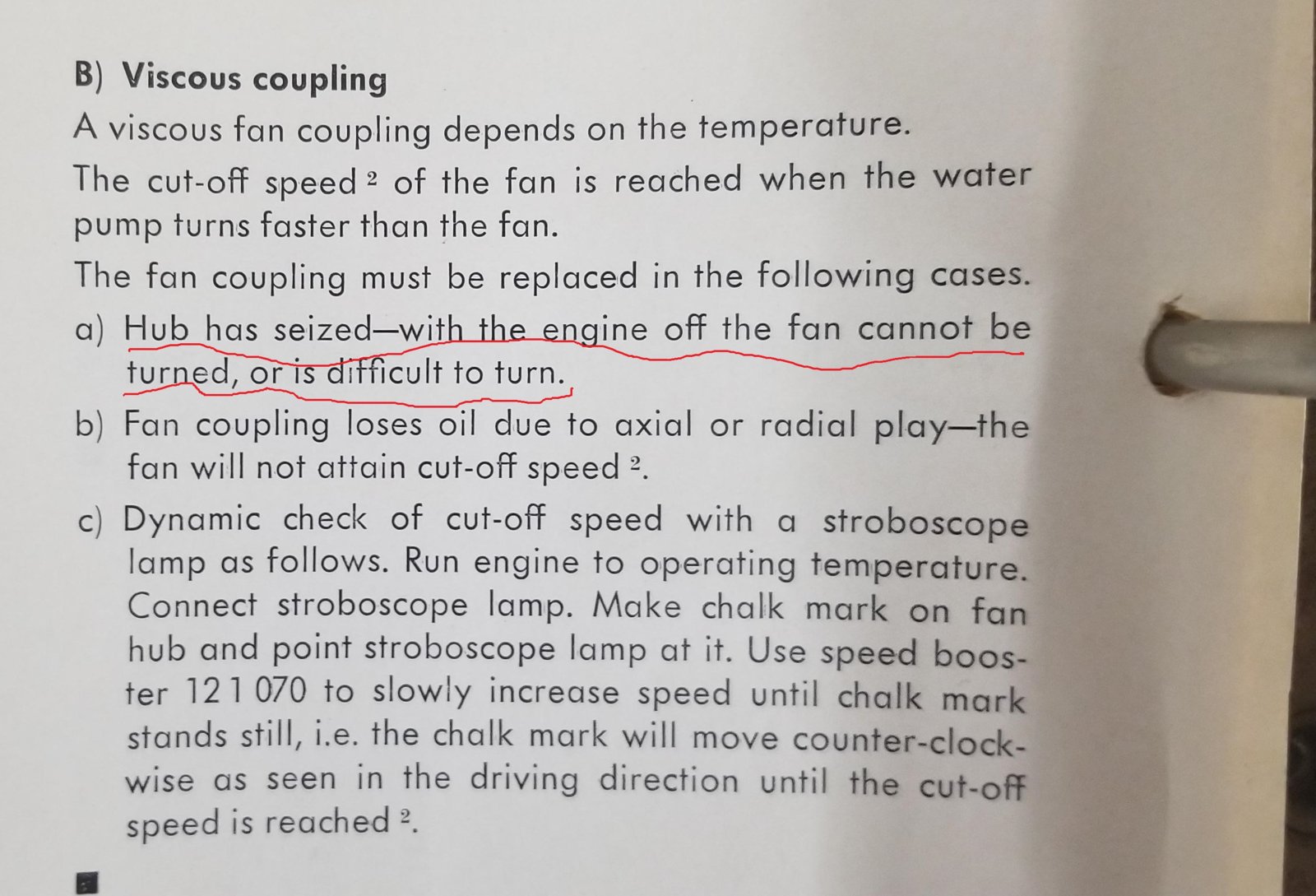

yes, from spin freely to it can not be turned there is a whole world of possibilities, as to address for wrong function
i would say most probably your clutch is ok, but cut-off speed test is the way to check it
He says when he tries to spin it it doesn’t spin freely; it turns the belt and with it the pump alternator pulleys. It IS locked up. Get a new one.
