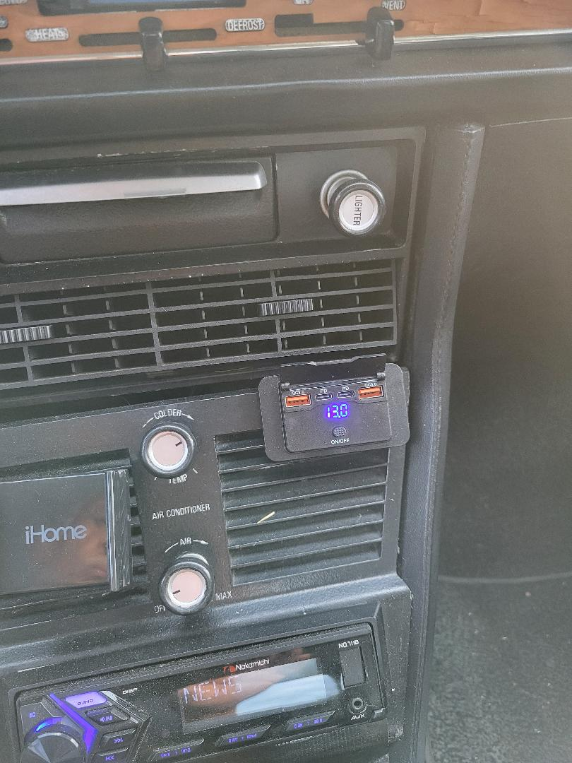

I have a phone charger/voltage gauge wired n my car it was showing the alternator putting out 17.2 volts. I checked at the battery and it was showing 17.2 I installed a new voltage regulator a couple of years ago but I suspected it was bad. I still had the previous voltage regulator (Hella) so I cleaned it up with sandpaper to make sure there would be a good ground. When I swapped it out the two I also checked the battery cables and cleaned them up real good. Now the voltage gauge is showing 13.6. My goal is to switch to an internal regulator alternator sometime in the future like my 71.
